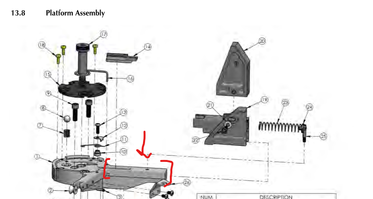

When actuating the press I get a loud and annoying resonance from my press. I have pin pointed it to the screw that holds the case insert cam slide block. How the heck do I quiet the vibration?
The sound occurs in the middle 1/3rd of the stroke as I lower the ram. I know the sound is coming from there, specifically the screw, because if I place my finger on the screw to dampen the vibration the noise does not happen. Does anyone else have this issue?

Yup, you nailed it. I went ahead and disassembled it further and greased up the bar that the case insert slide cam slides on.
That resonance is pretty much gone. After 30 pulls of the lever I can hear the noise come back so I'll need to find a more resilient grease. I'm glad I found a solution. Hearing that sound 1000s of times while reloading 9mm was driving me nucking futs.
