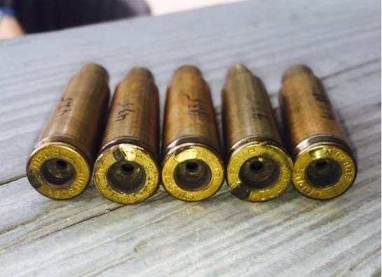

    And here is a pic of some ejector marks. They are very subtle, but sill there. Its hard to see, but it is between the "a" on Lapua and the Lapua logo.

    If it's just a shiny circle then there's no issue. It's when the brass actually flows into the ejector hole that you know you have an issue. Get a micrometer and measure your unfired cases with your fired cases. There are tutorials on how to do this (I think Hornady has one). This will tell you more of the story and if you are actually over pressure.

    An ejector mark by itself is not necessarily an indicator of an overpressure condition, I see absolutely nothing wrong with any of the brass pictured above and would continue to look for a load.
    ^This^
    First, to address your light swipe, Check your shoulder to base of cartridge measurement. It looks to me that you are neck sizing only, which is not a bad thing, but eventually all brass needs to have the shoulder bumped back about 0.002" from that of a fired case. Otherwise, you can get that swipe mark while loading and bringing the bolt down into battery. I've especially noticed that issue with my Savage if I haven't full length sized. It does not create nor necessarily mean that you have pressure. The primers are not flattened at all and I would bet that if/when you measure the diameter of a loaded vs. fired case, that you will not see pressure signs there either.

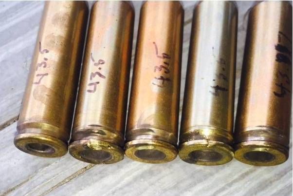

    Now THAT is some ejector swipe, along with brass extrusion into the ejector hole and case rim damage where the ejector ripped through and the case probably had to be manually removed. Yet, this dough-head obviously kept shooting the same load up to 5 times with the same results each time. I'm just glad that I wasn't there in case he kept going. This guy was obviously seeing (or not seeing) pressure long before he got to this load of 43.5 grains of whatever. I'm sure that his bolt face looks like the craters of the moon after this session.
    Another pic, showing the case head damage:
    ^^^^^^^ That load is insanely to hot. When you have to use a hammer to open your bolt and eject a case might want to reconsider your load development practice. It might just be the light but they all definitely look like they have some web expansion. If you can visually see that you are damn lucky they didn't separate. If you see that fellow again be sure to head the other direction and get your phone out for video.
    I agree 100% with you. I am not sure if I saw the fellow or not. It may have been one of the two guys leaving when we pulled up to set up steel and targets. I happened to look down into the brass bucket and one of those nasty blown out primer pockets stared back up at me. That got my attention and I pulled out the others because I could hardly believe that someone would continue shooting after anything even close to this came out of the rifle.
    I remember when Greg from Primal did some testing to show everyone what pressure signs look like, but I'm pretty sure that even he would never willingly subject his rifle to that kind of abuse. That's why I lined them up and took a picture. I figured it would someday make a good teaching moment without my having to destroy an action of mine to do so.
