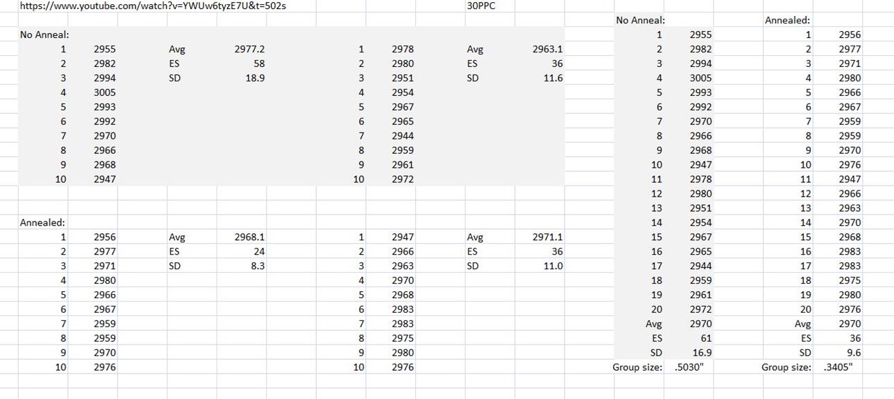

In terms of improvement in performance that annealing might provide, I took some numbers of an annealing test on YouTube and calculated their SD's and ES's since it wasn't done on the video:

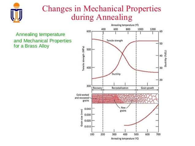

Here's a chart illustrating heat vs ductility an state of the grains (I hesitate to show this as a time factor is not shown, but hope it helps):
