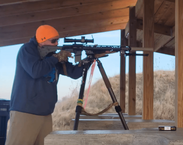

    I've started shooting this system a little more often lately and I'm trying to determine the best course of action to improve the obvious over gassing. When I built it nearly a decade ago, I just started with some basic mil spec parts and ran it 50/50 unsuppressed and occasionally suppressed with a .30 cal can. Ran OK in both situations, but not ideal. Going forward it will be run 100% suppressed.
    Now that I'm planning to run it a little more often and I'm considering some gas gun LR team matches...I'd like to get it rolling a little smoother before next summer.
    5.56 crimped 77gr OTMs at 2630 fps over 20 rounds on the new Garmin chrono
    In the clip...
    DPMS Mini SASS barrel (18" - 1:8 twist, w/ midlength gas)
    Suppressor is a 224 VAPR (better suited for bolt guns) Tight bore, 9" and maximum suppression, but also restricting.
    Takes a .936 gas block so I do NOT currently run an adjustable because it won't fit under this lowpro hand guard.
    Gen1 Magpul UBR is standard carbine length. In the clip, it has an H3 buffer. 5.65 oz and a mil spec spring.
    I've tested Armaspec systems up to H3
    I have tested all the way up to a 10oz pistol buffer with an H5 tube and it's still excessive gas and tossing brass to the 1:30 - 2:00 when running suppressed.
    Underside of the charge handle is vented to the right (similar to a Gas Buster except the opposite direction) But I think a legitimate handle that redirects excess gas on the top and bottom, away from the face would help too.
    Now...here's the 3 options I'm considering. (either way, I'm planning to switch to an A5 system with a Gen2 UBR)
    1) New hand guard to accommodate an adjustable .936 gas block I already have in a box somewhere. This is 17" and I'd like to stay in the 16-17.5" length.
    2) BRT EZTUNE gas tube extra tight (.0635) and then hopefully get back down to an H3 or H2 buffer and TUBB Flat Wire spring...wouldn't be adjustable, but should make more common buffers work again.
    3) Any other suggestions that make sense.

    Well, after some phone calls and suggestions from here...I think I'm pretty close to perfect.
    Picked up a pair of Sprinco buffer springs. Both an Orange (EXTRA EXTRA power) as well as Red (Extra Power) and then also opted for a BRT-EZTUNE Gas Tube (.0635 smallest they make) knowing that if the combo was too restrictive I could always go down to a H3, H2 or even H1 buffer.
    Turns out, that's exactly what worked.
    Started out with the Orange spring and H1 buffer. Perfect 4:00 ejection but I did have a mis-feed and no bolt lock back.
    Went to the Red spring and H1 buffer and it seems to be running perfect. Only ran a couple rounds, but it was amazing how much recoil was reduced as well. Less mass going backward at a slower speed...and a stronger spring to prevent it from smashing into the back of the buffer.
    Might get a video tomorrow.
    The Sprinco springs were recommended by a buddy and I'm glad I went that route. I may actually end up grabbing one more Blue (Enhanced power) just to have on the shelf as a means to test other builds in the future.
    Even though ejection seems perfect...the suppressor still has a pinch of excess gas in the face. MUCH MUCH MUCH less than before...but I think it would help to swap the hand guard, put the adjustable gas block on, and have a slightly lighter spring to fine tune things.
