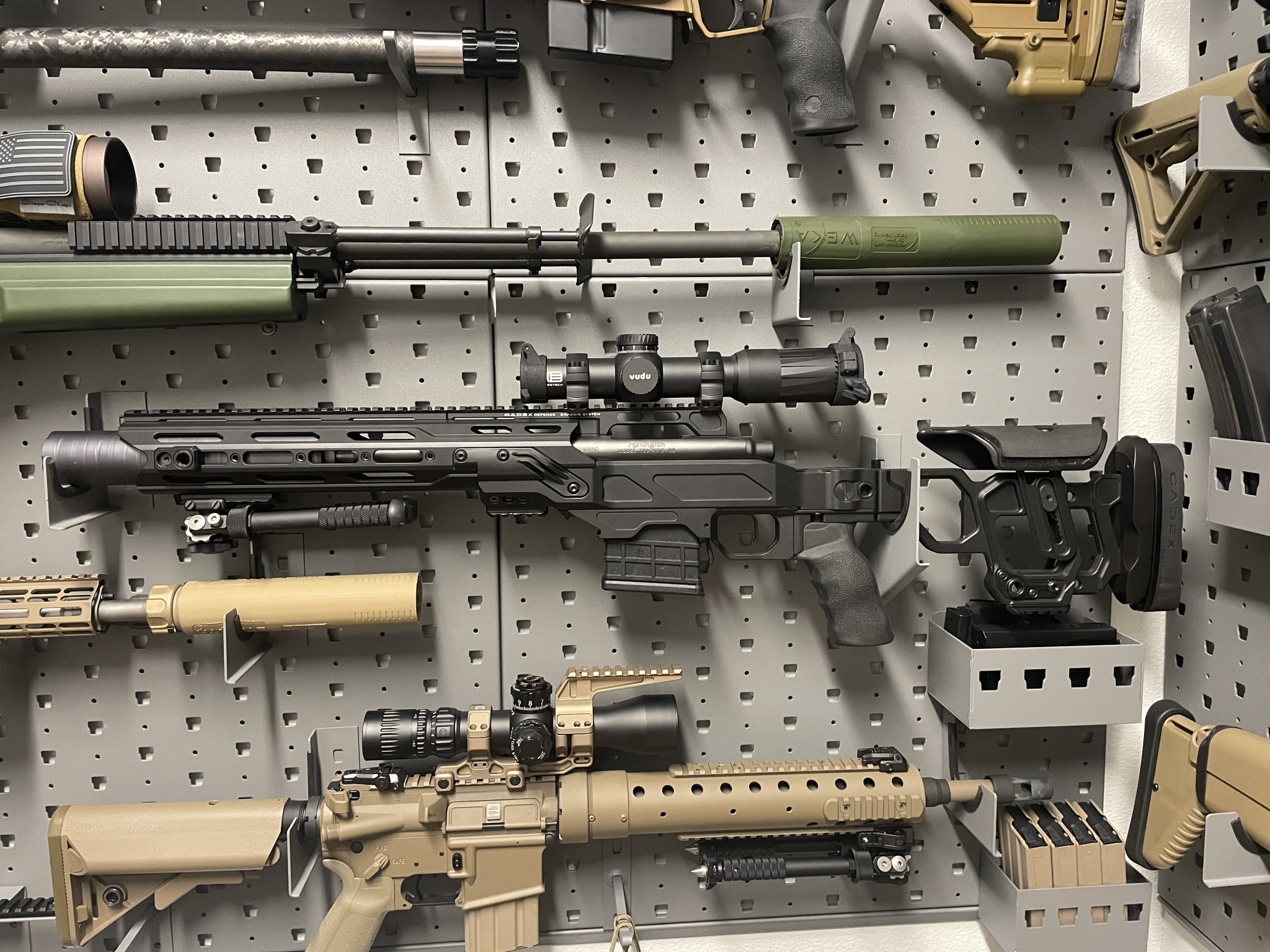

I know it's a CADEX chassis, but what's the chassis model and handguard specs? Got a link? I've been wanting to build another bolt .300BLK and this is exactly what I was wanting to do, except I would be running an Otter Creek Labs Hydrogen-S or Hydrogen-L can.
That's a Dual Strike (with their Lite Comp stock) - the fore-end on the Dual Strike has a significantly greater inside diameter, so if you're planning on having the can be partially covered by the fore-end, that's the model you'll want., I believe all the other models have a much smaller ID on the fore-end.
Cadex Dual Strike. Just like B’N’F stated, I ordered it with the skeleton stock option.
I built mine to semi-replicate the original concept gun that AAC showed off at SHOT show when they announced the 300 Blackout. It was an integrally-suppressed Rem 700 built on a first-generation Remington RACS chassis, using the early Leupold LPVO with the cool tortoise/hare reticle. Cadex helped Remington design the RACS originally and then Remington kinda fucked them over and started making the chassis themselves as I recall.
Since the RACS is unobtainable and Cadex has made improvements to the system over the years, I went with the Dual Strike. They don’t advertise the option, but you can order it with the skeletonized folding stock which looks better, though it loses the quick-adjust cheek height. The wide forend is needed to accommodate a suppressor. I can even fit my old AAC Titan .338LM suppressor which is 1.85” diameter, though just barely (it very lightly contacts the inside of the accessory mounts while threading it on).
I used a stock REM 700 AAC model which was 300blk from the factory. It has a Triggertech 2-stage trigger now. The barrel is 8.5” (had to check the Form 1), cut and threaded by Morgan at Class 3 Machining with the appropriate taper for the Q Full Nelson. I’m brand-agnostic but the Full Nelson is well-known to perform exceedingly well on 300blk and I happened to find it for $399 from a distributor that was going out of business, so I pounced on it.
I could not get it to feed with the metal Accurate Mag magazines. There’s a folded metal lip on the front that catches the tip of the bullets and jams them. The polymer MDT .223 AICS mag feed well. It looks like @michealj88 got his to work with some other metal magazine.
I originally had a Trijicon 1-8 on it, but I really wanted a bit more magnification and a Christmas tree reticle for longer shots, so I upgraded it to a Vudu 1-10 with the LE5 reticle. There aren’t many LPVOs with exposed target-style turrets which is pretty important if you want to lob 300blk bullets way out there. I used APA’s ultra low rings to mirror the look of the original AAC gun but it’s harder to use with my clip-ons this way. Maybe someday I’ll put a 1.5” mount on, but then you have to set the cheek riser a thousand miles in the air so who knows lol.
I do know that it puts a huge shit-eating grin on the face of everyone who fires it. With subsonics it’s so quiet that you can hear the powder sizzling inside the can as the gases vent. It’s not a fun gun to carry around at night; a mini fix or a 300blk AR is far handier. But it has a look that is pretty cool and unique and I think that’s why multiple people have cloned it, which has been fun to see.
How much was it with the lightweight stock. I can’t see prices on their website unless I sign up…
Around $2500, adding the skeleton stock didn’t affect the price or lead time which was about 10 weeks. Depending on what you're after, Eurooptic shows they have the standard stock in stealth shadow available for around $2100.

I really almost did the same thing. Love the look. Whats the internal diameter on the forend of the Cadex?

Do you know if they are all the same diameter? Lite strike vs dual strike, etc?
I missed that on the website, thanks!
Dual Strike is the only chassis with the large ID handguard/forend - everything else is smaller.
EDIT: I can't comment on the max ID of the competition chassis with the bridge installed, but otherwise the above holds true.
As I said above, my 1.85” AAC Titan fits inside the dual strike but it makes contact with the accessory mounting screws. I would not recommend a suppressor larger than 1.75” diameter.
