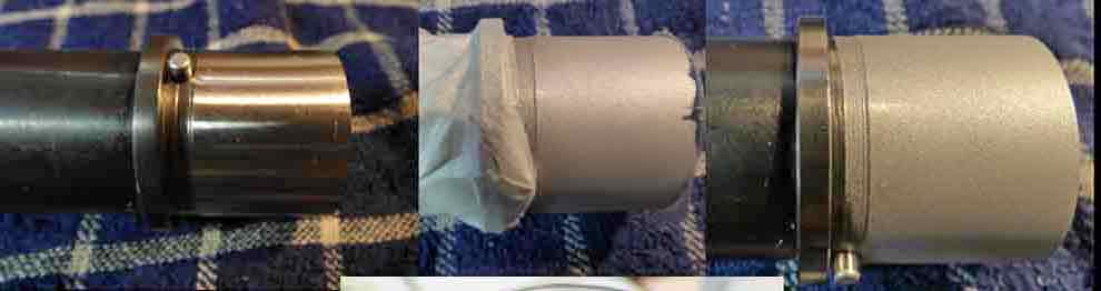

I suggest taking a micrometer to your extension to check for taper. I've run across a couple that have close to 0.001" taper (larger at the flange end). This gives a slip fit until the last 1/4 to 3/8". The extension can be loose except for the very end of the nose. How the threads are cut/rolled can also make the nose tighter than the bore. Feels like a thermal fit but ain't. Hopefully the nose has been squared AFTER the threads are made.
A heavy walled upper gives better support (at a weight penalty).
Look at where the extension goes. Where do you want a good fit?
Axial support is compression of the flange to the threaded nose.
Lateral support is in the receiver body.
I also do a spray on shim and burnish it down to 0.002" over (0.001" per side).
This REQUIRES a hot receiver/cold barrel to slip together.

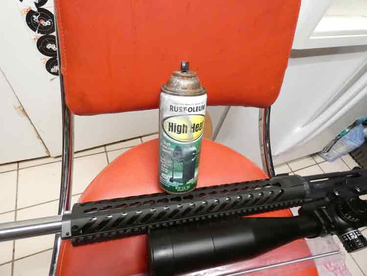

If you don't want to use epoxy / glue on a non-thermal fit combination, High Temp engine paint applied to the barrel extension & sanded to fit works well..........................if you really think your build justifies it.

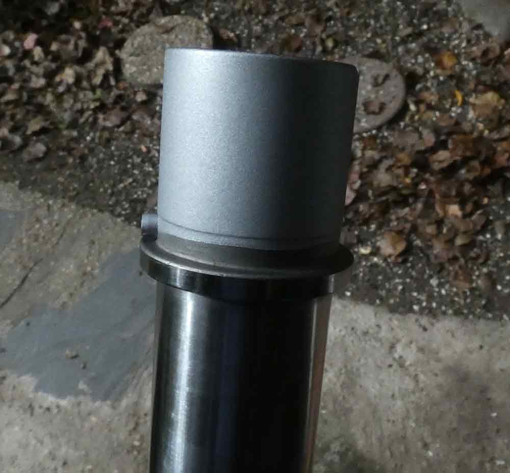

I face the nose with the wheeler tool, spray and cure shim, burnish with 2000 wet paper, Heat receiver in the oven, stand barrel in the freezer.
Slip together and hand tighten a barrel nut. Let stabilize.

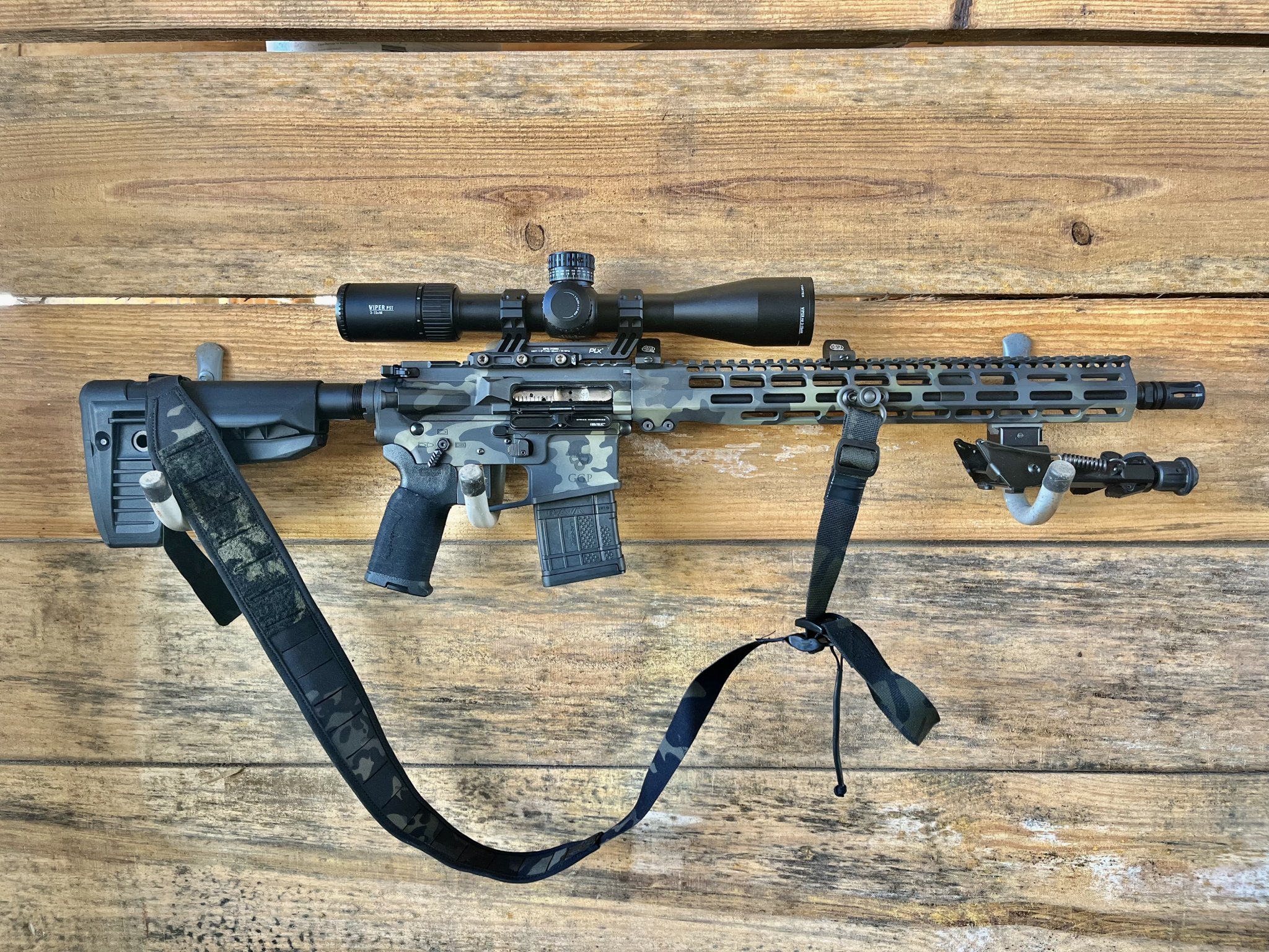

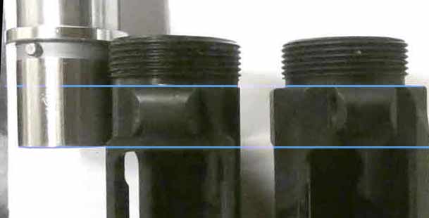

I just assembled two accurate-ized uppers (well, thats as intended, verdict is still out on the outcome...) One was a 308 using a Mega receiver and one of SLR's newer hand guards with the anti rotation pin. This one did not need thermal fitting. Also, I had to use the SLR jig to drill into the Mega. Todd @ SLR was very helpful though I jumped the gun and drilled before realizing the first 1913 lug on the Mega is sort of normal sized. So the pin hole is exposed between the first and second lug. I'm calling it character.
From a fit and finish perspective, the combo looks and feels great.
The second upper used a small frame Mega receiver-rail set, which I really like. The diameter limits what grip panels and such I put on, as it gets a bit big for my hands, but I *much* prefer it to the Aero system, which the Mega was replacing, and which is much too large for me. The fit and finish is really nice, but they are not cheap.
This one, with a V7 barrel, did require a night in the freezer and heat gun, and then some encouragement with a mallet. But the end product is really nice. Its either going to shoot reealy well or... I'll leave it on the wall and say it does.
My feeling is the Mega receiver handguard interface would put up with a lot of use, brace pressure, and such, but I don't have any practical experience to support this.

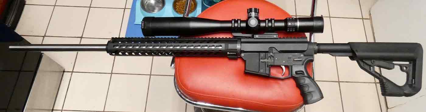

Put together a cheap upper.
$99 BCA side charge (with complete BCG),
$60 Mentium-USA 2 inch diameter handguard 0.936 gas adjustable gas block won't fit under narrow tube.
$350 28" barrel bought as a spare for my 3000 round barrel.
So, got the upper together and why not just slap together another lower from spare parts?
Schmid 2 stage, light trigger spring, mil disconnector spring.
80% plastic.
H2 buffer and standard carbine spring.
Clearance TI-7 stock.
Topped with a Buras 8-40X50 from Midway on sale, on a 20 MOA Primary Arms mount.

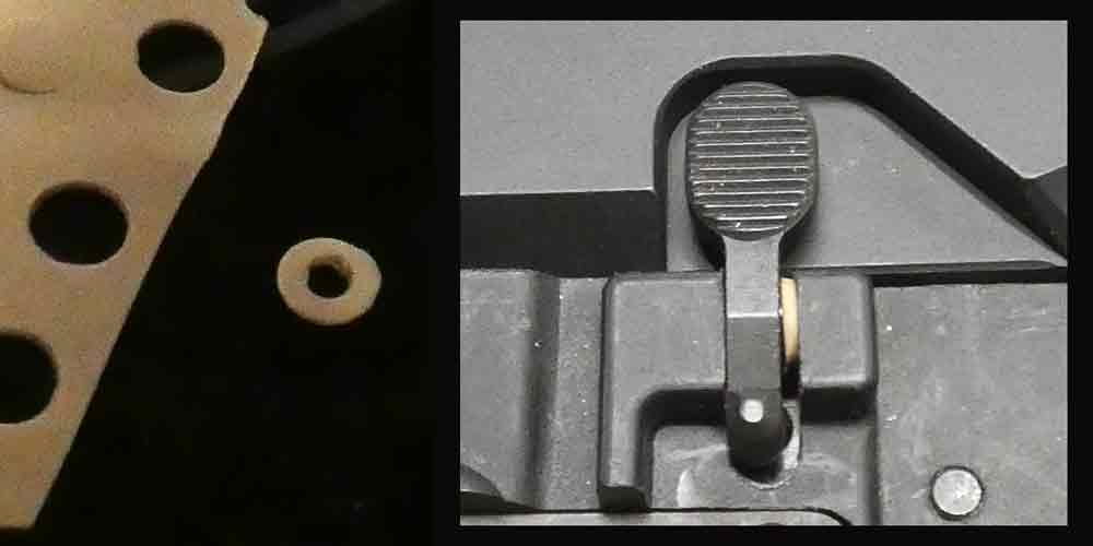

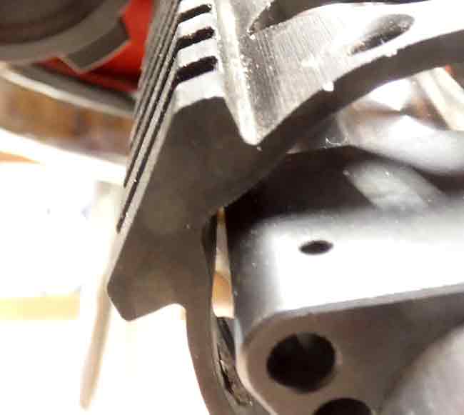

Had to shim the Bolt release. Paper hole punch, plastic, drill.
Dremel to the handguard for gas block clearance.
Still well under F-Open weight. :)

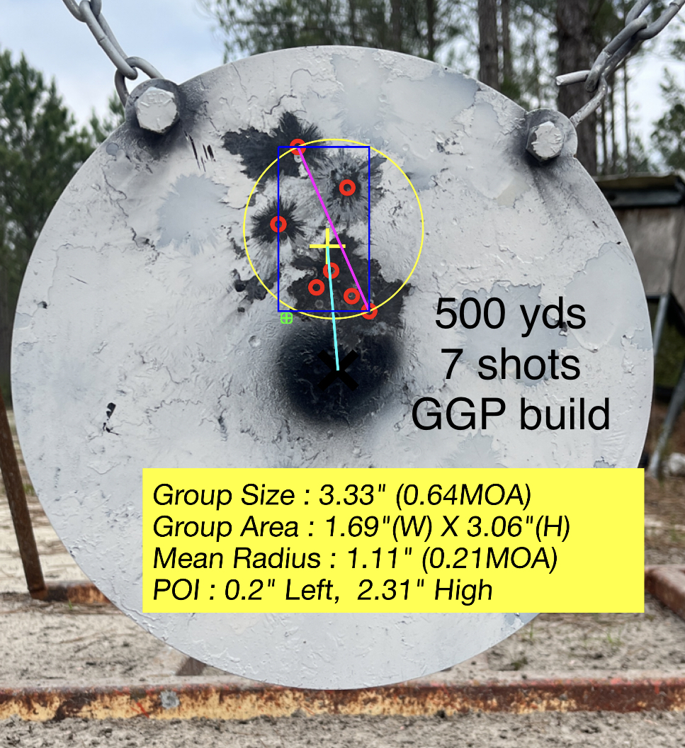

Yes there is a considerable weight difference between my Mega mml build and GGP build. The GGP build is still extremely accurate, especially considering I’m the shooter 😅
The aero enhanced sets are not that heavy either. Just not thermal fit. They are not as thick walled as the Mega or Seekins, handguard isn’t as thick either so it allows some weight savings with the ability of a stiffer handguard without inducing stress as easily to the barrel.
This is my GGP set.
