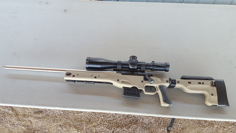

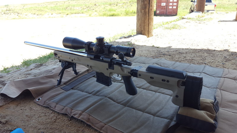

So, rifle specs are:
Rem 700 action
Bartlein (I think) 24" 8 twist medium palma
Timney CE trigger
AICS 2.0 stock, bedded for action
Kahles k624i AMR

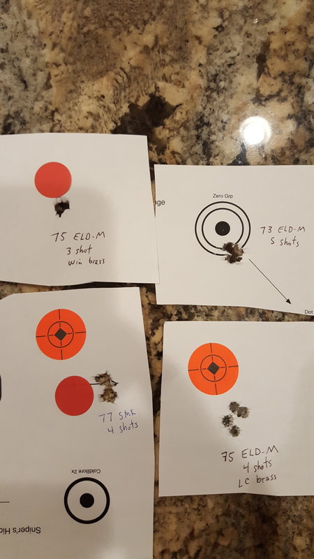

Second trip to the range I loaded some 73 and 75g ELDMs as well as a few Sierra 77s - all over varget. This time I spent a little more effort in getting an idea of how accurate the rifle was. You can see the below pics, but I would say this is a 1/2 moa rifle with VERY little work. As I said, I don't enjoy load developing, so stopped here and bought a bunch of Hornady 75 Eld-m's.

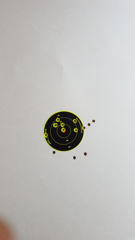

Last trip (yesterday) confirmed at 100 yds this was still on (75g Eld-m and 23g varget), then shot at 500 yds on a 3" paster. I shot 10 rounds (there are 3 dasher rounds in that group for a total of 13) in 2 strings, about 20 min apart. In addition to this I shot around 50-60 rounds at 1-2 moa steel plates at 300-600 yds. I can honestly say this 223 with almost no load development shot just as well as my main match rifle! I couldn't be more happy.
