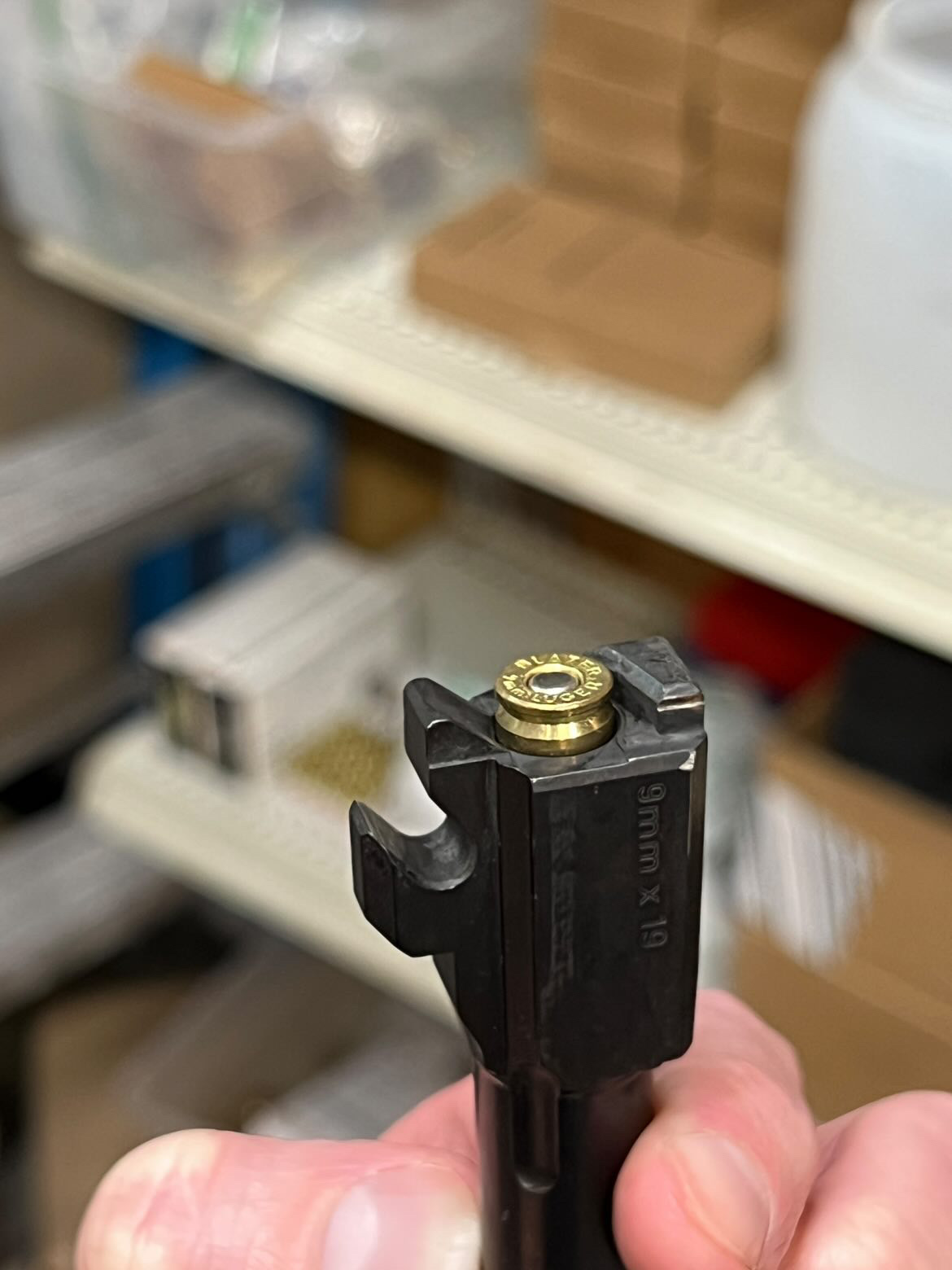

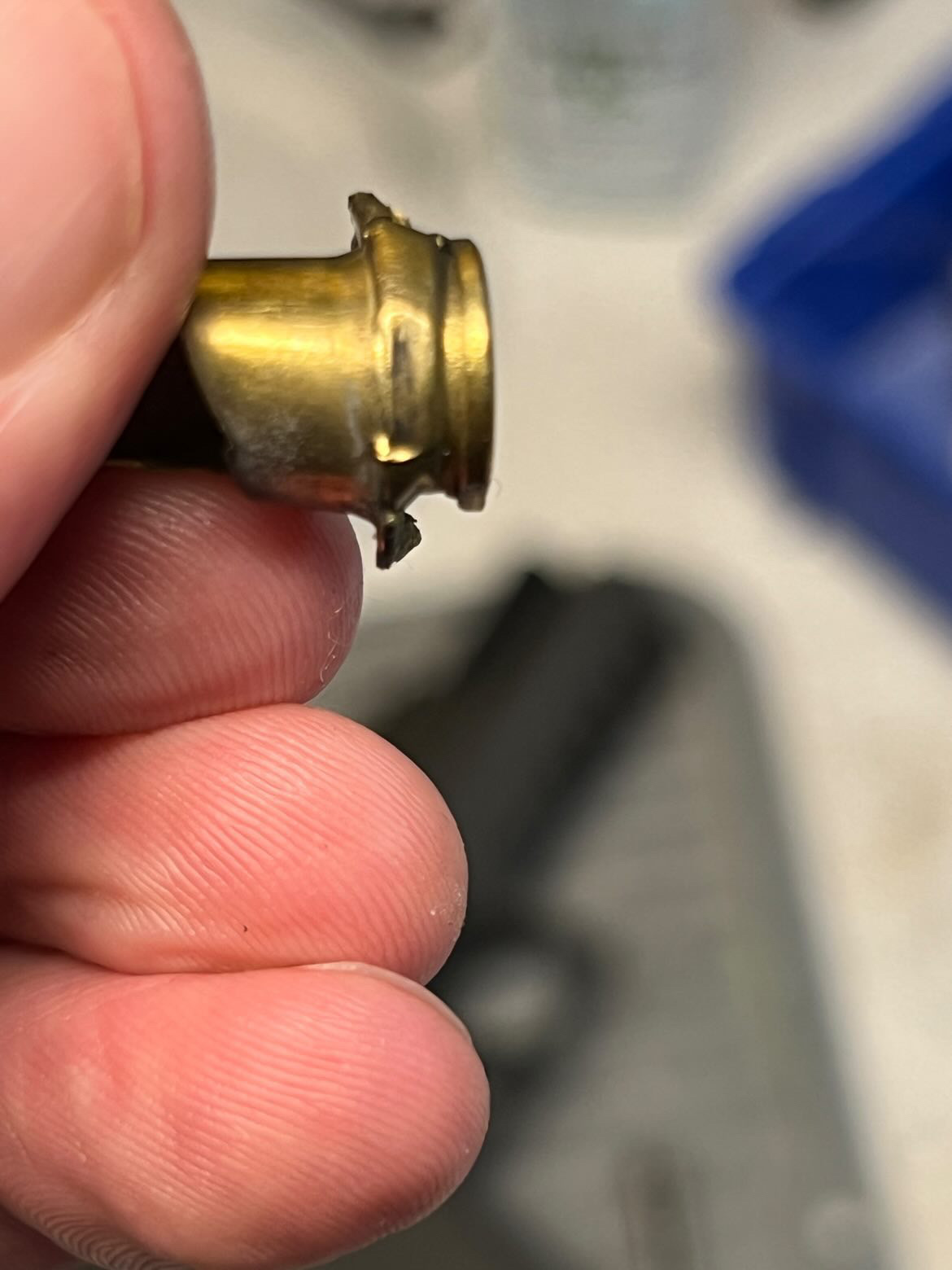

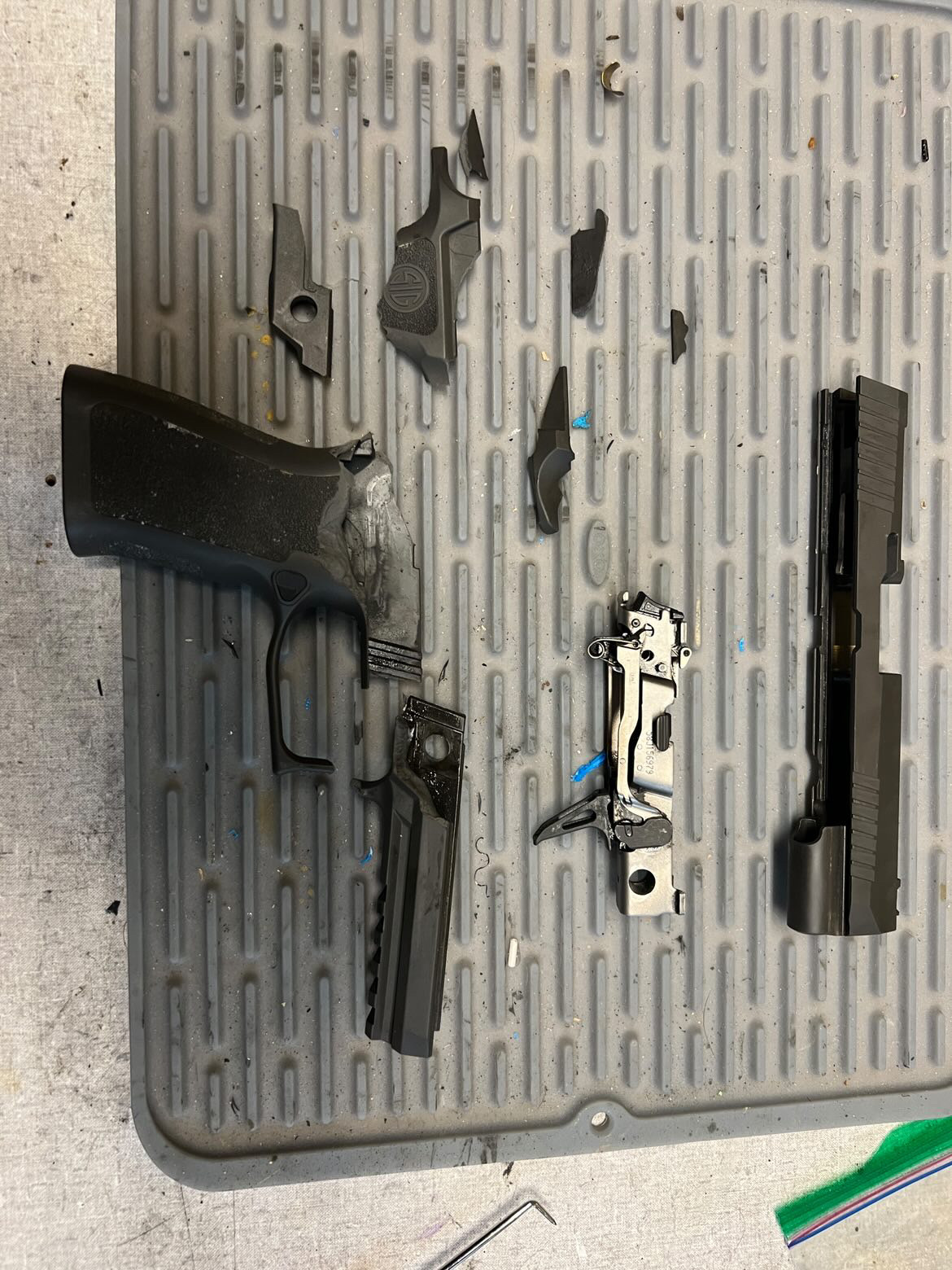

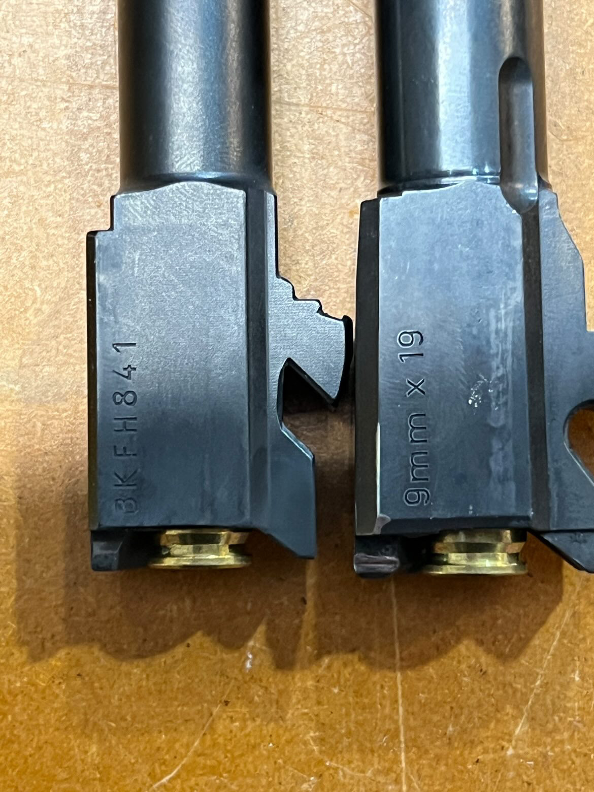

The so called accidental discharges can be worrisome, even though the vast majority of them seem to be user error. However, the exploding guns are real and far more worrisome to me. Just a couple days ago an FFL/Barrel Manufacturer sent me pictures of his exploded P320. Happened during a USPSA match. I have seen numerous pictures of this and now have two accounts from people I know and trust. Both were unmodified P320’s, both blew up from out of battery detonations during rapid strings of fire. Not exactly something to brush offView attachment 8120616View attachment 8120617View attachment 8120618View attachment 8120619
I've heard of a couple blowing up around my neck of the woods too, longtime USPSA guys who know how to load ammo correctly... and have also heard of mysterious intermittent unintended double-taps and guns shooting by themselves when being stopped hard in fast transitions.
All spooky stuff... and I don't believe in coincidence.
Sure seems to be a lot of room in that chamber side to side. As far as exploding goes, most cartridges will explode with that much of the case sticking out of the chamber. Do you know, or can you show, where normal headspace is supposed to be with that pistol?
Bottom line here is I'm looking to see if someone can explain (mechanically or operationally) why these are going off. I've seen a lot of the incidents, but no mechanical or operational reason why they are.
Reactions: Milf Dots

Great, Just Great!
Two weeks ago I bought a used Sig 320.
A week ago I tried it at the local steel match because it has a reflex sight on it. I used those same reloads (about 150 of them) in my wife's Canik earlier in the week with no problems and assumed they'd be fine in the Sig. Nope I had an out of battery BOOM during the first stage! I walked to my truck and left the match right then.
I got home and found out the extractor had blown off somewhere.
Anyone want to buy it, almost free, LOL :ROFLMAO::p:oops:
