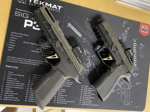

    I have a Legion and I did this agency arms build. I'm really liking the agency. Great shooter.
    I will likely build another in the 3.6-3.9" category. I really like PMM micro comp builds as well so that might be next.

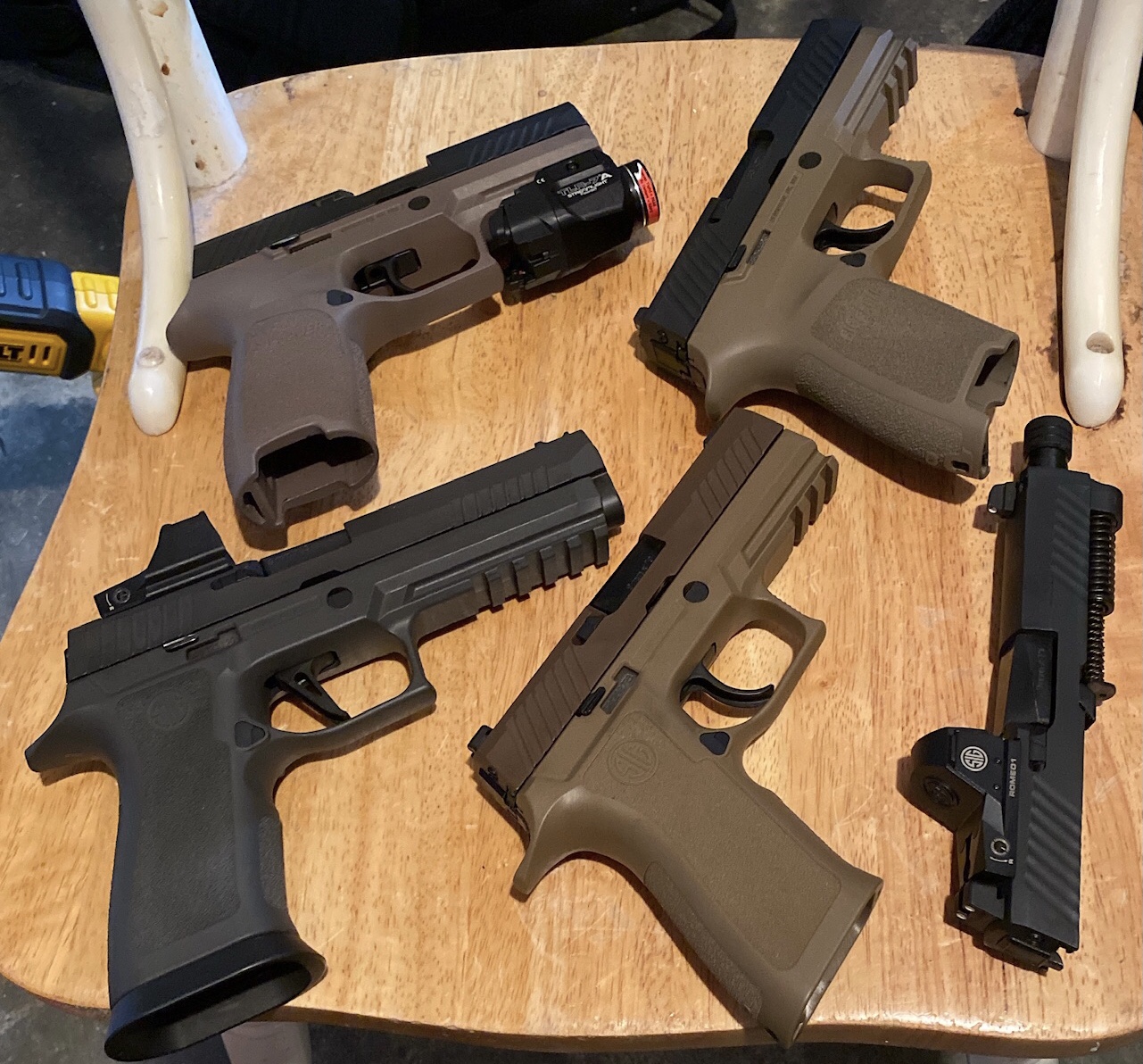

    Here is most of my P320 collection. A home built Legion and three carry in 9, .40 & .45. I considered buying the custom works FCU to do a build but I found a used like new complete gun at my local shop at a good price and sold off all the parts I didn’t want. The FCU ended up costing me $100.

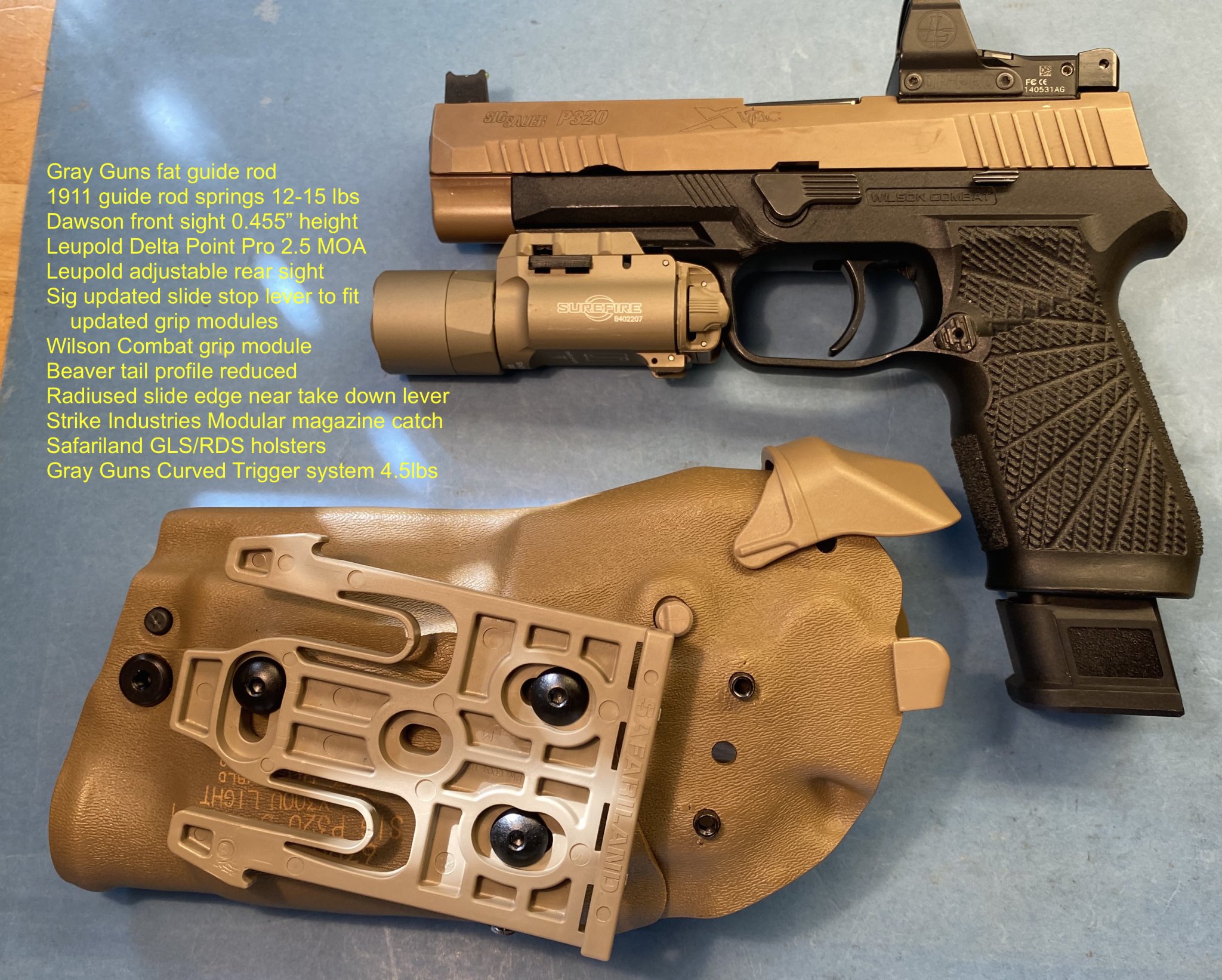

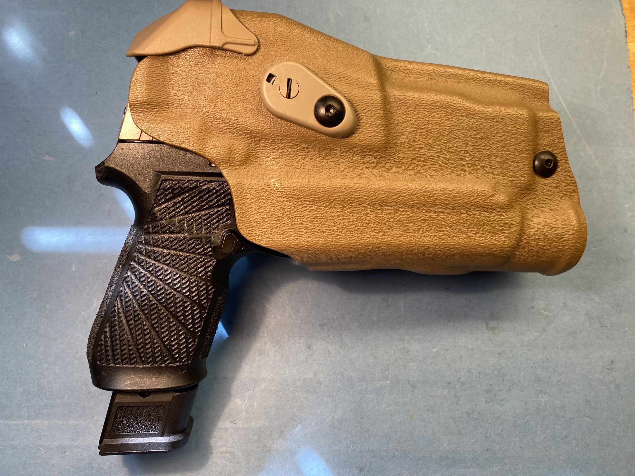

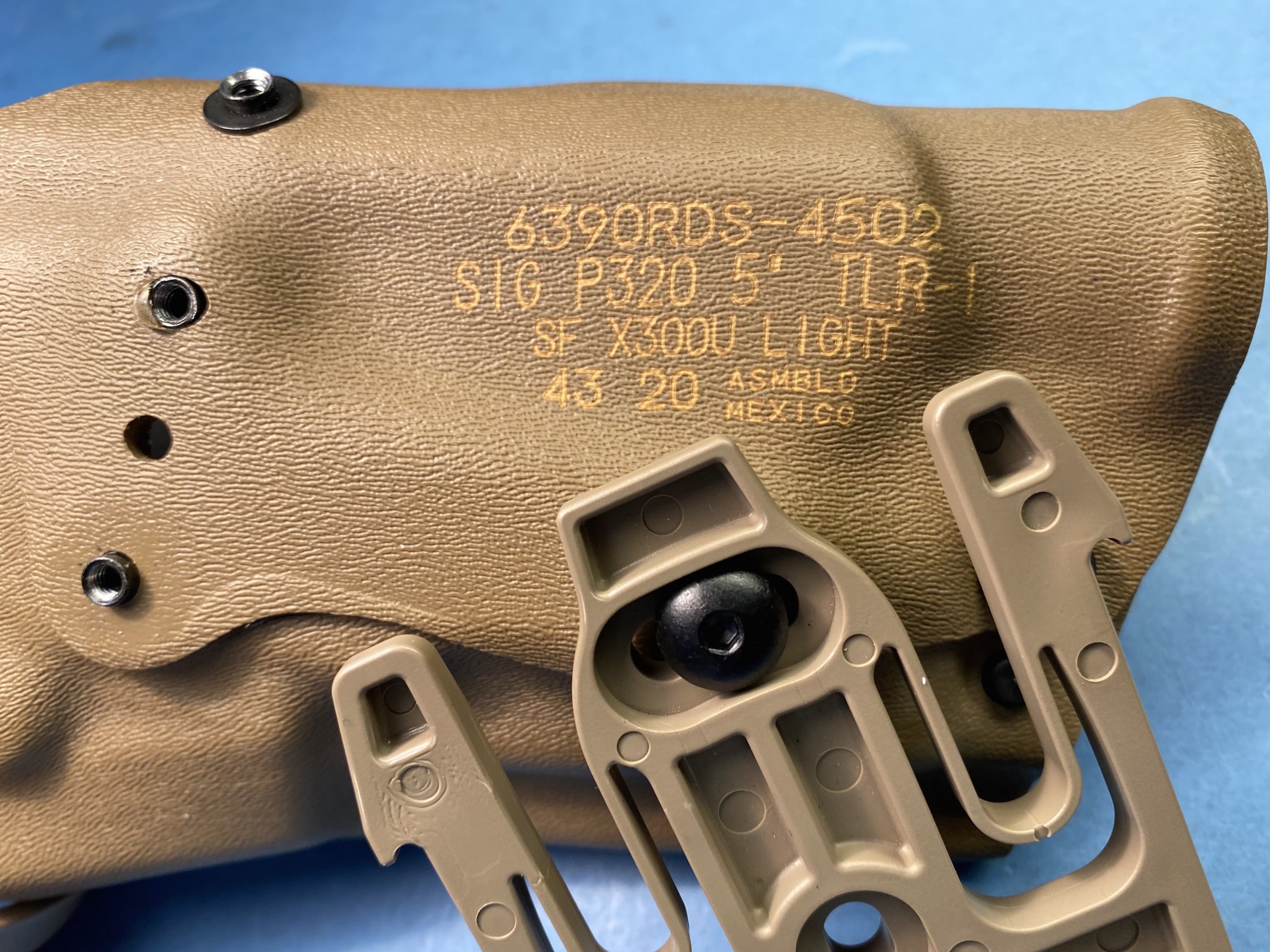

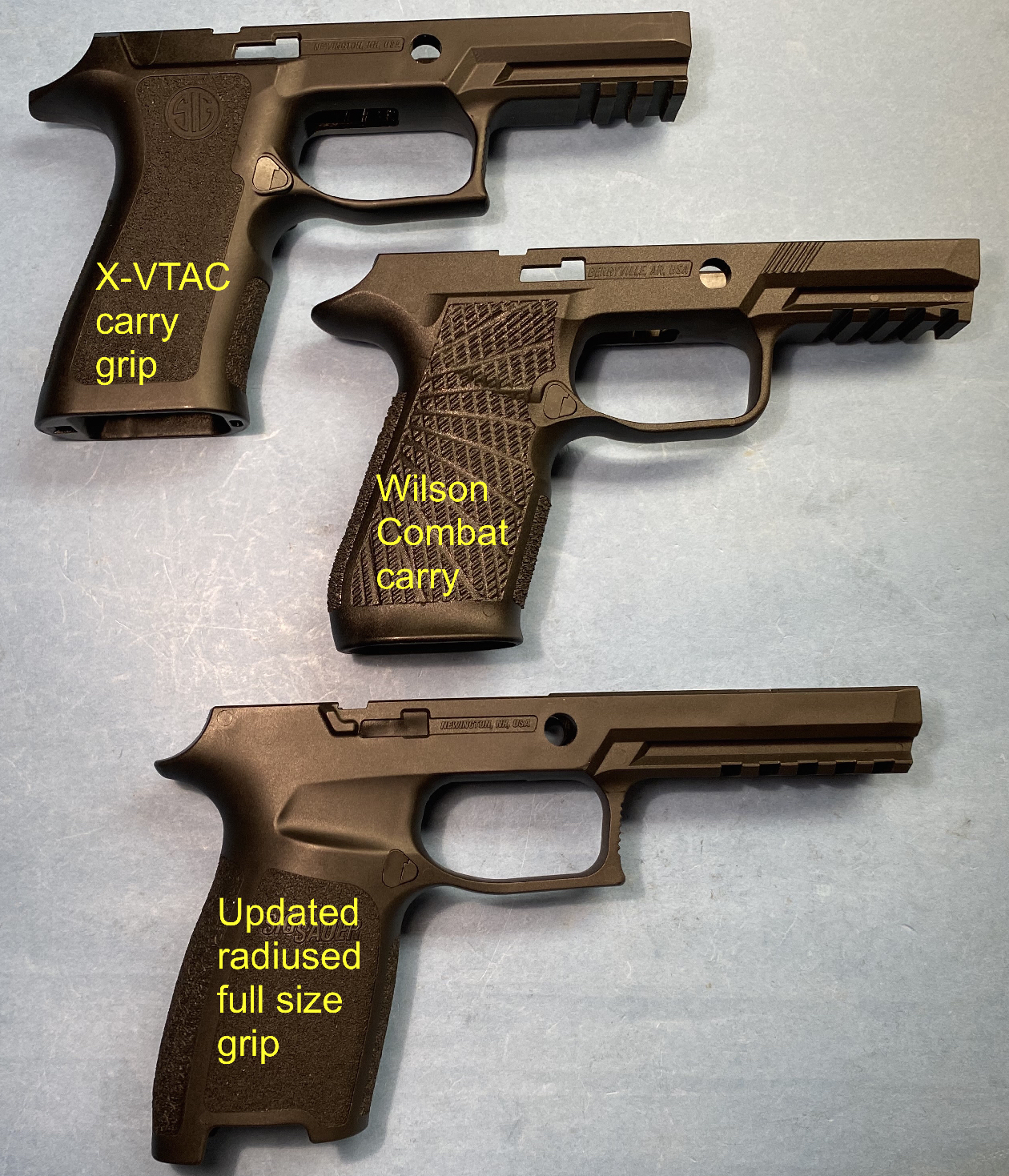

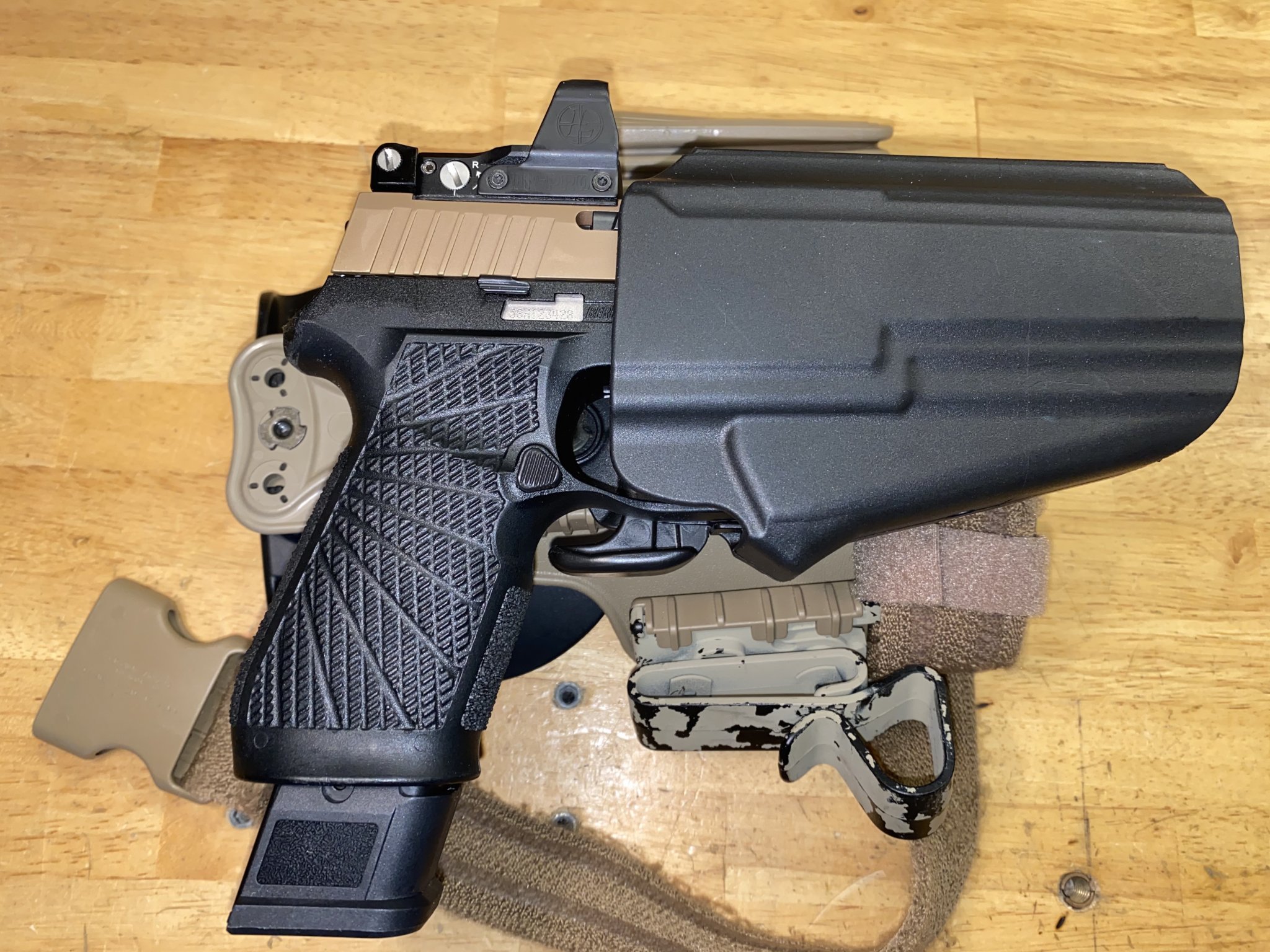

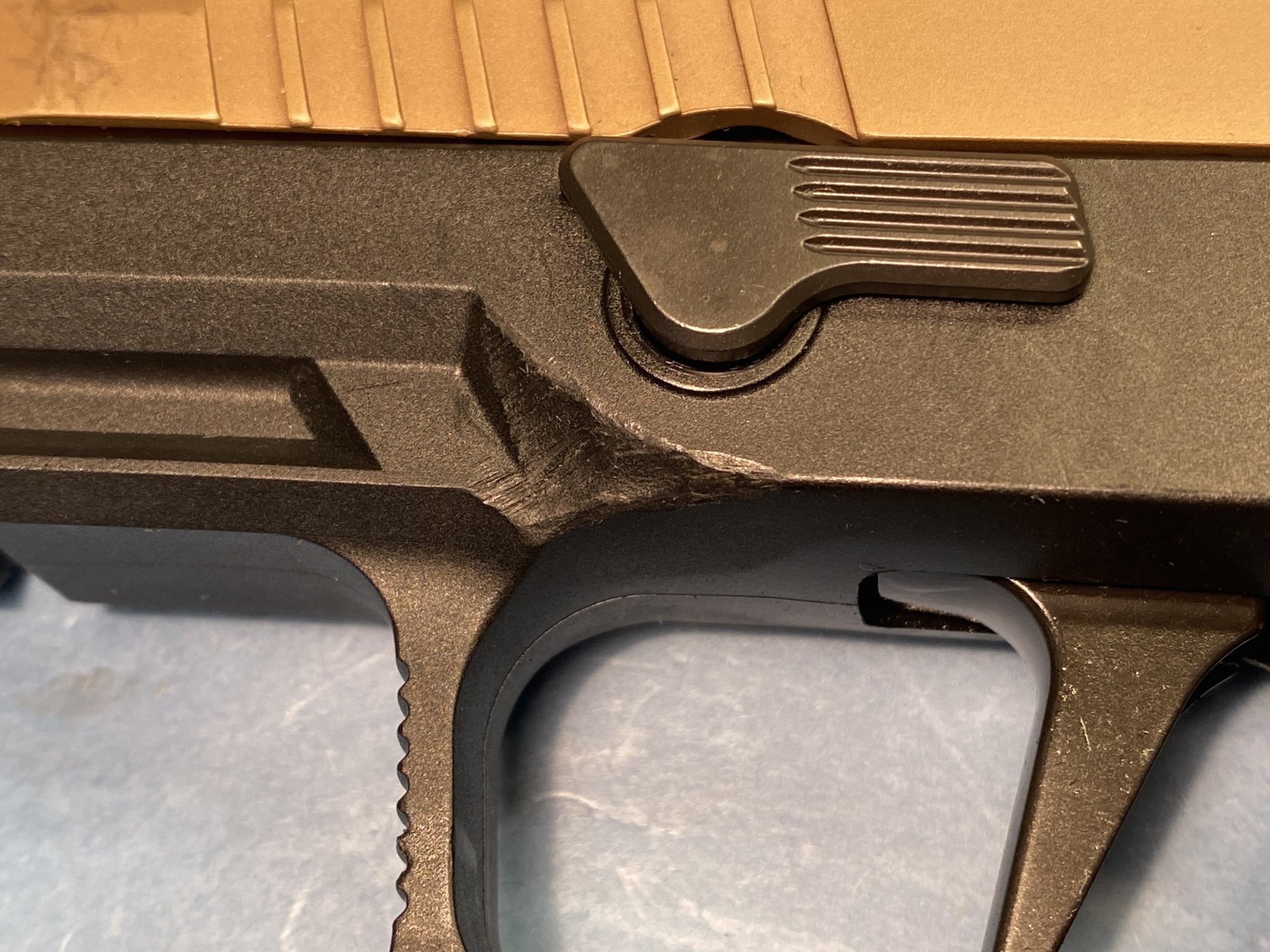

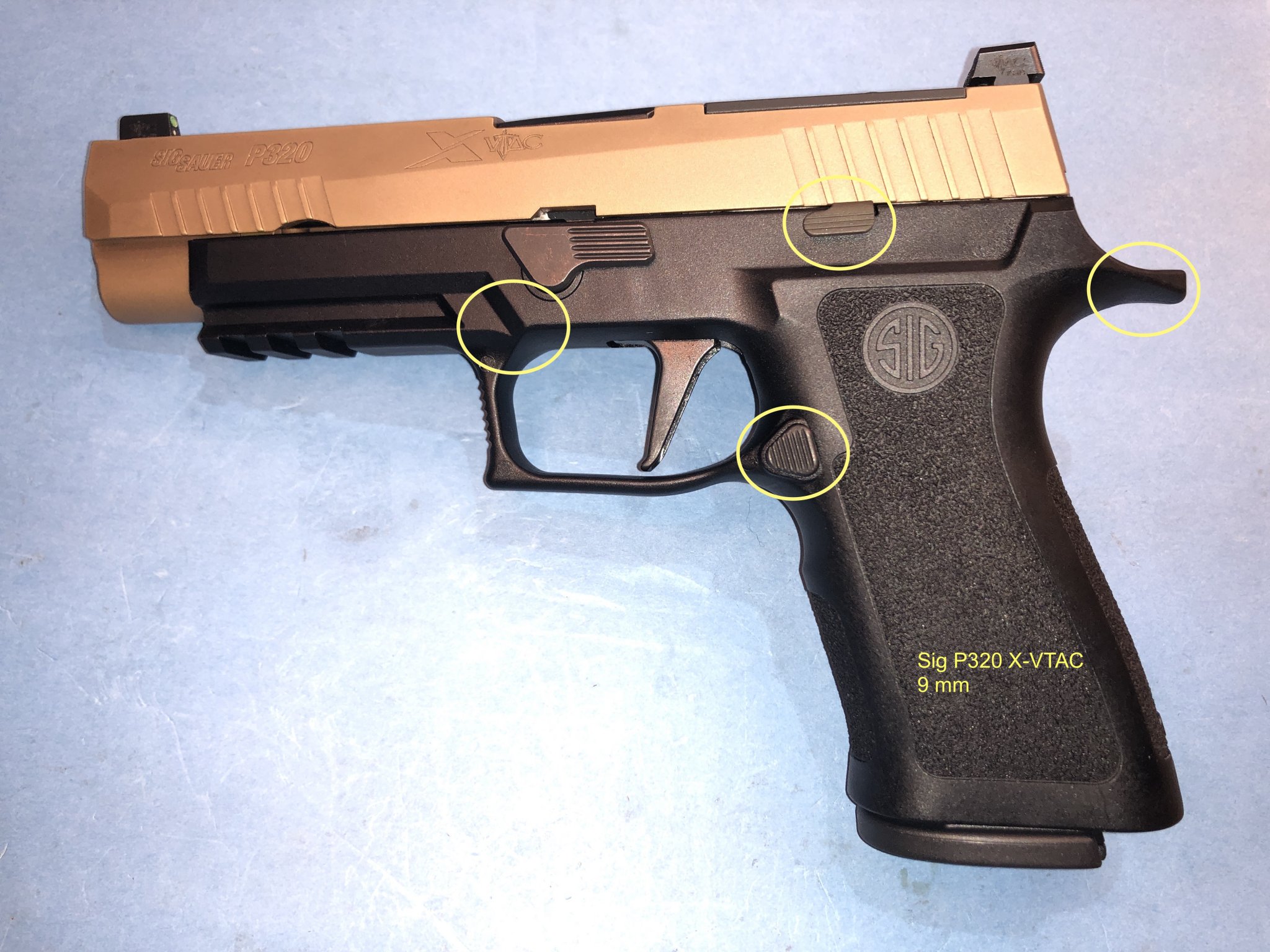

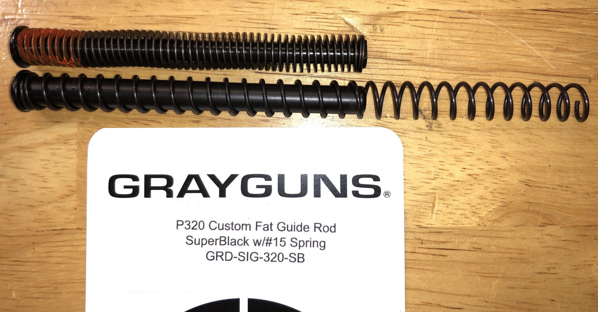

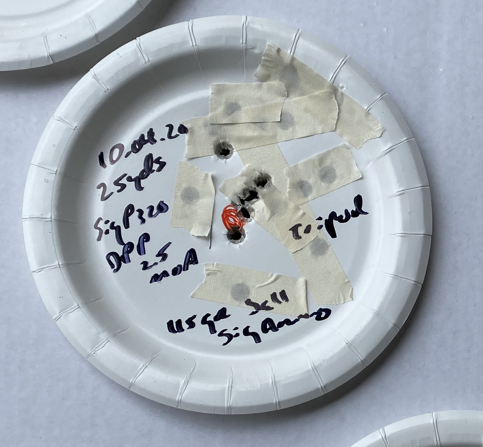

    My P320 9 mm started as a X-VTAC model and now there is little left of the original situation.
    I found the beaver tail to be way too long to rapidly acquire a grip index from the holster and a sharp edge on the left slide side that was biting

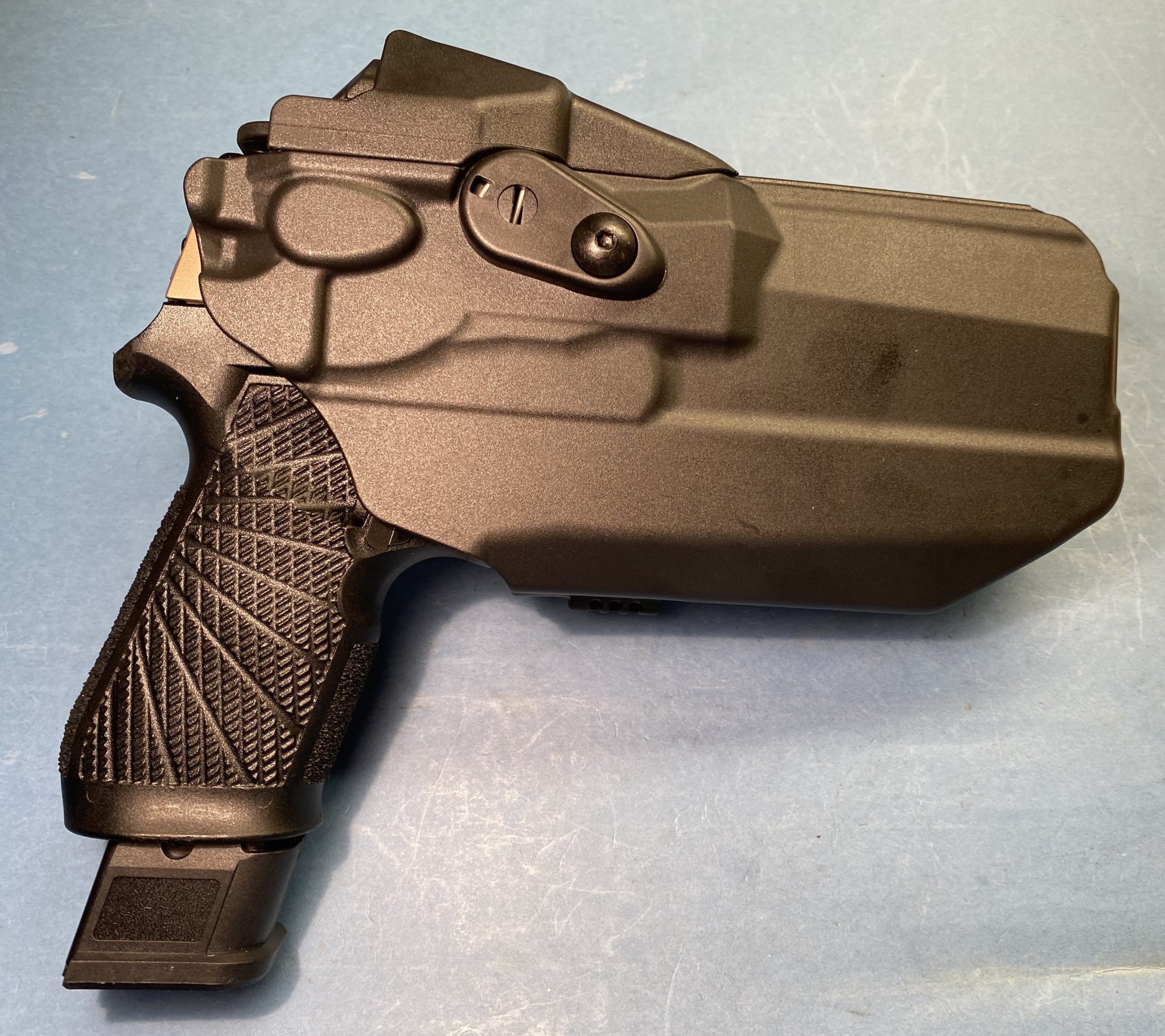

    the support thumb on recoil. The slide catch would drop the magazine upon recoil with a tight two hand grip (similar problem with a Walther PPQM2). Changed to Gray Guns guide rod to adjust spring rates and found the curved trigger better to my liking on this gun. Purchased all the various Sig grip modules, found the Wilson to best fit / grip for me and it is the same style I use on their 1911's. I use a few different Safariland holsters, GLS / RDS models. It's pretty accurate using a stock barrel.

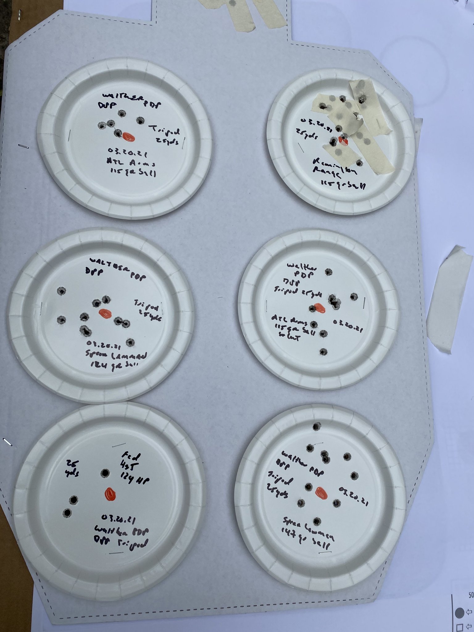

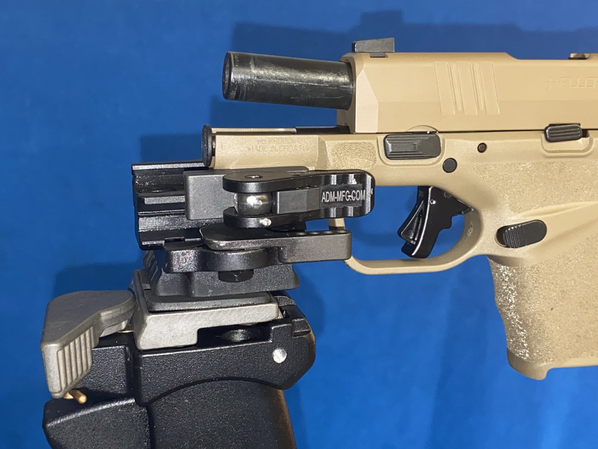

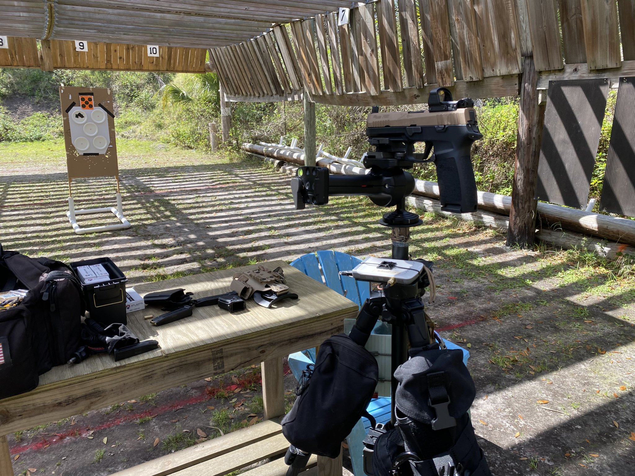

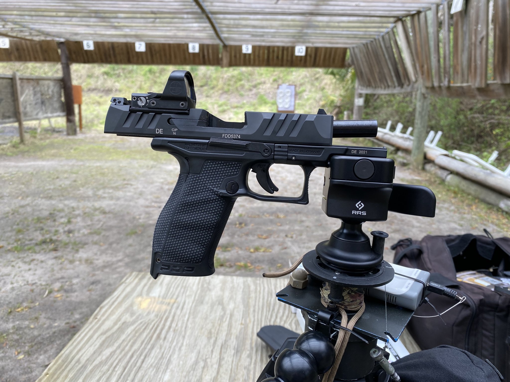

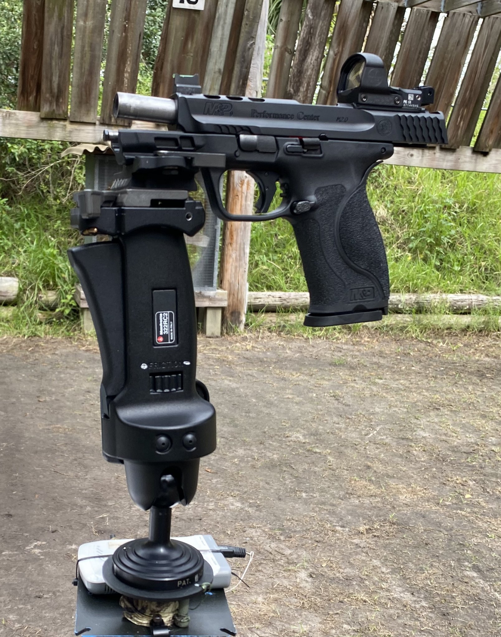

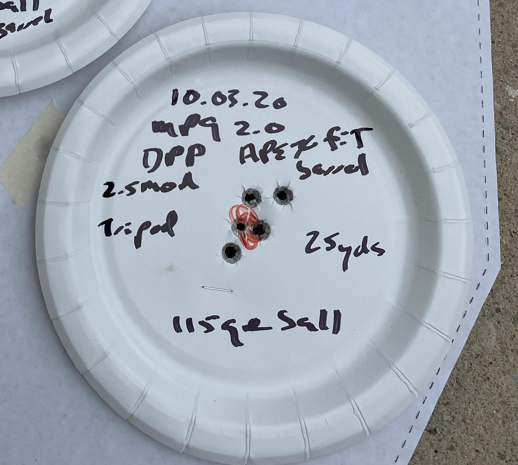

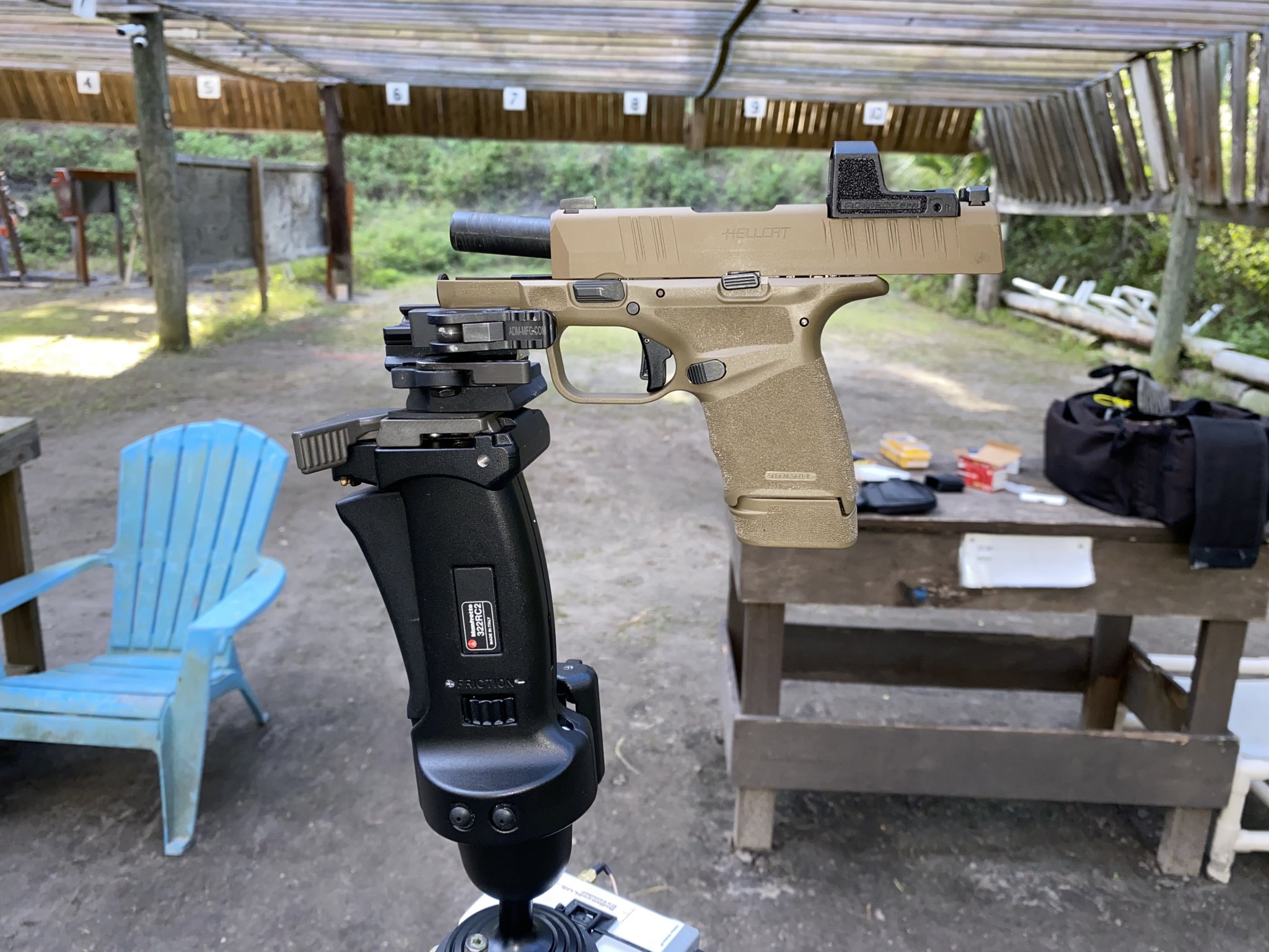

    ^^^^^.....Just like with a rifle, I find more stability sighting in pistol optics and evaluating ammunition with more consistency.

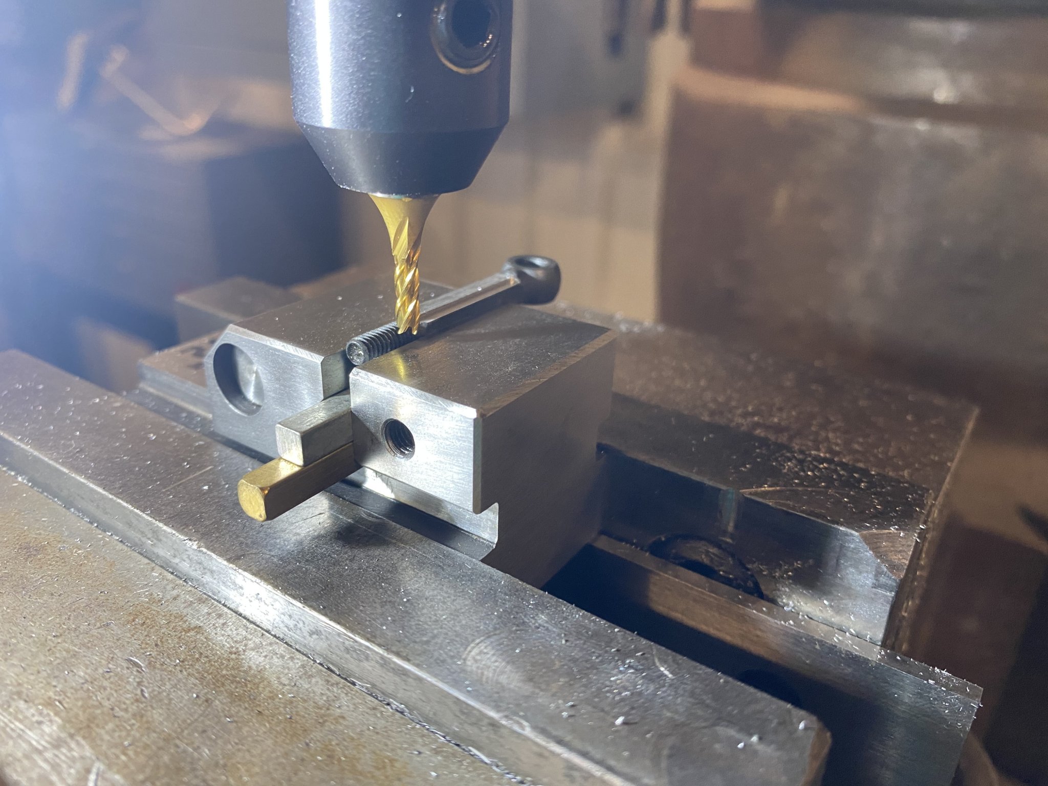

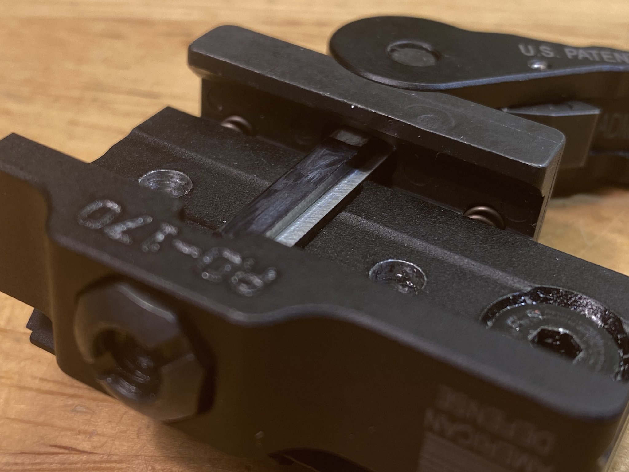

    I had to fabricate a special QD mount for the Springfield Hellcat as it has only a single slot on the rail and is not a standard configuration.

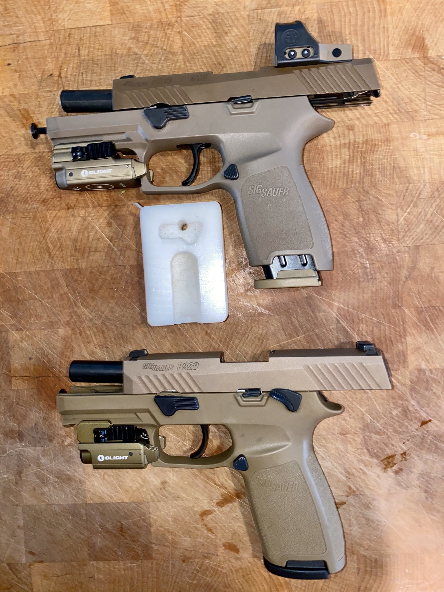

    I like the 357SIG but want a manual safety for carry.
    An RDO is not a priority.
    Swapped uppers between a 357 Compact and a M18. Had to purchase 14rnd 357 magazines for the M18.
    M18 9mm mags will lock in the Compact.
    Easy peasy.
    Off to the range,
    Am happy!!!

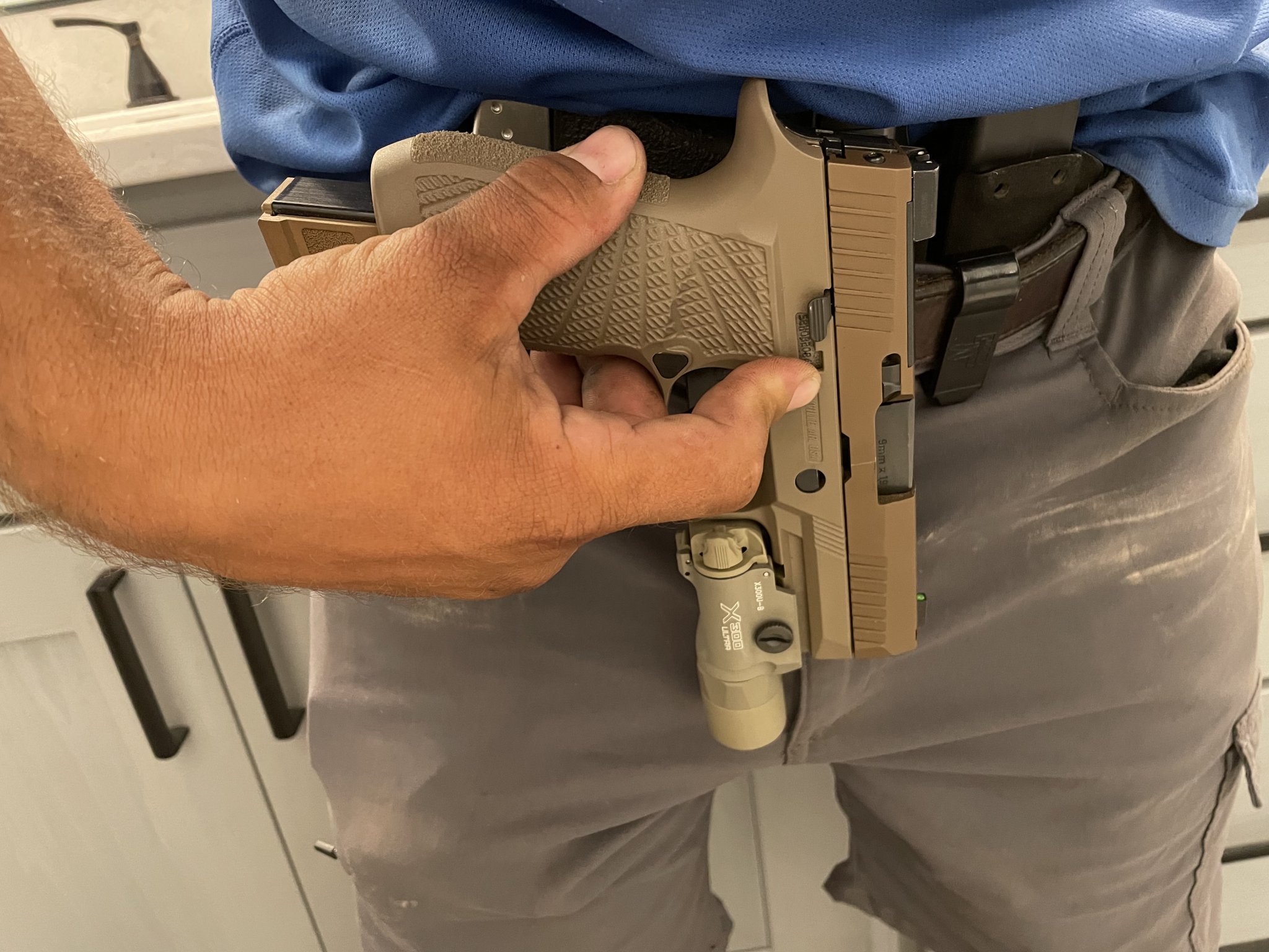

    I think this might be considered conspicuous. Think they’ll buy it?🤣
    Still waiting on RMR plate.

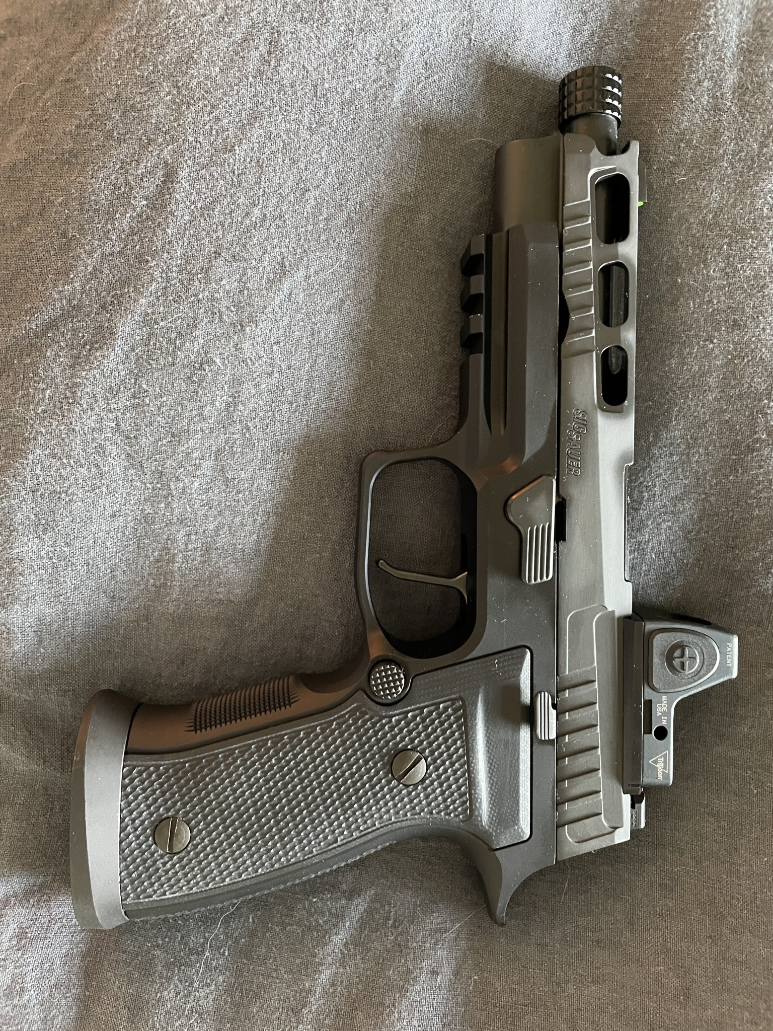

    My wanna-be Legion build (but better, LOL):

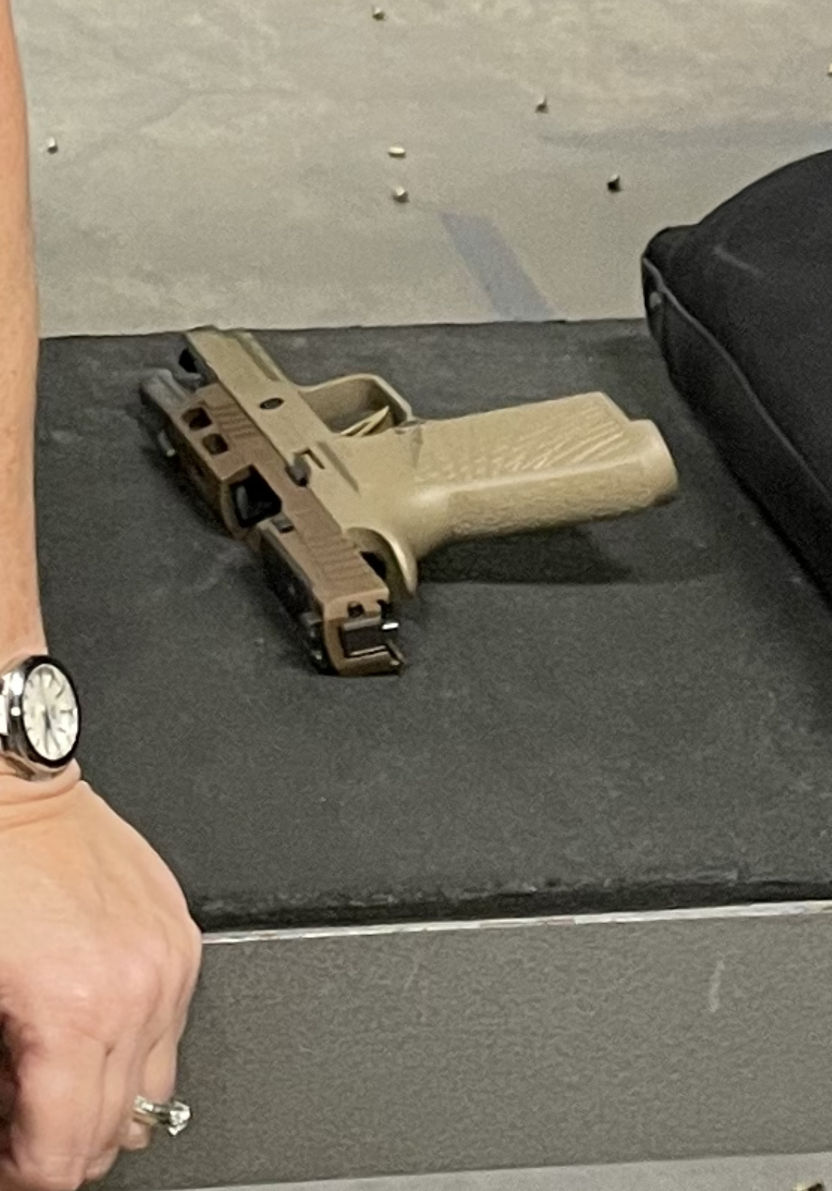

    And realized I don’t have a pic of it’s little brother 3.9” in FDE, but here’s a screen grab of a pic from my wife at the range with it last weekend:
