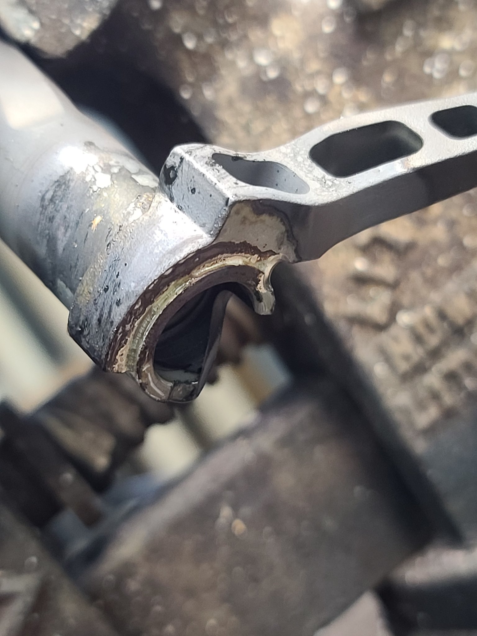

Handle came right off...entire stem and ball unit. Snapped off bolt body clean as can be. Only a "dot" of well was ever done to attach this to the bolt body.

There are a couple of things to be wary of. In many instances, when a handle fails, it "peels" off of the bolt body. If you can imagine your hand running the bolt as this happens, you lift up and pull rearward in a fluid motion. When the joint fails, the handle's narrower "strap" feature on the handle is typically the last part to get torn away from the bolt body. This almost always (99.9%) results in the strap portion becoming twisted as it separates from the brazed joint. Attempting to realign the twisted part is an absolute nightmare. I have had almost zero luck with restoring that.

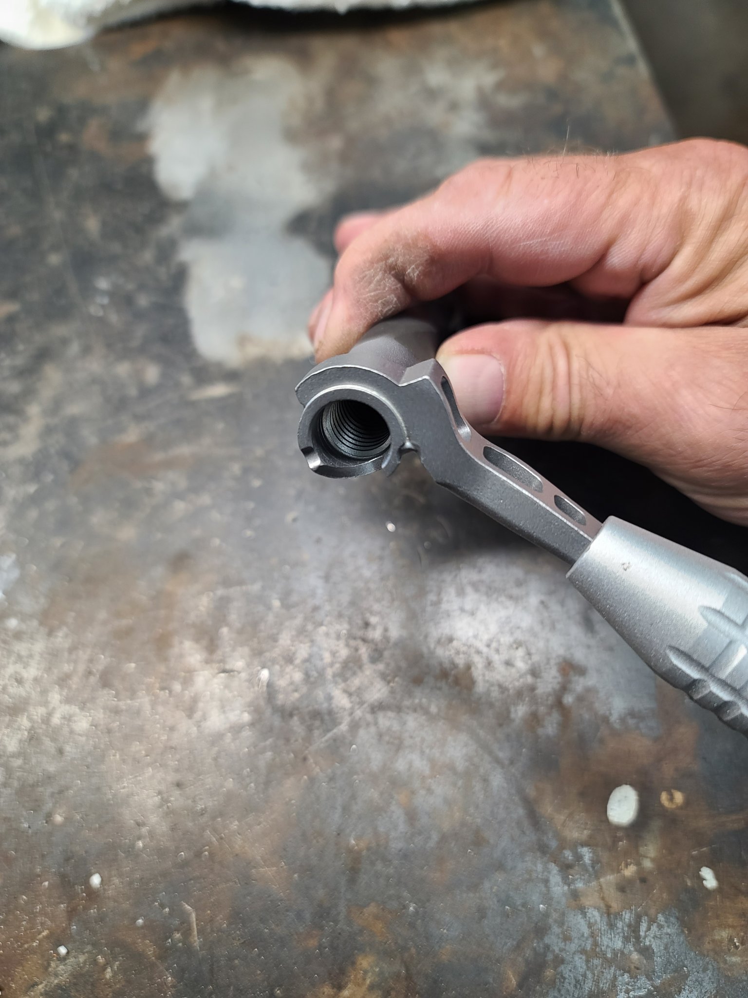

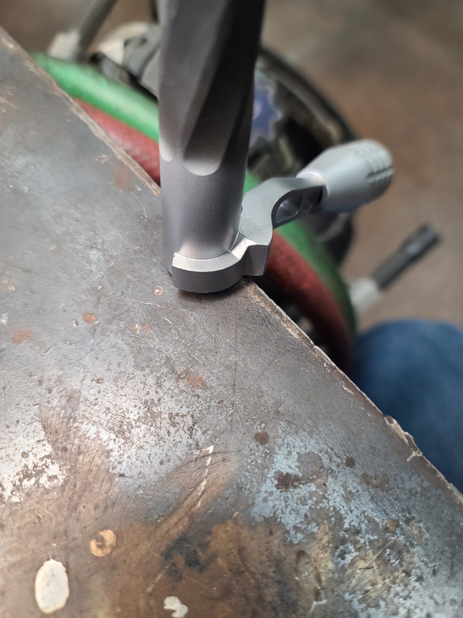

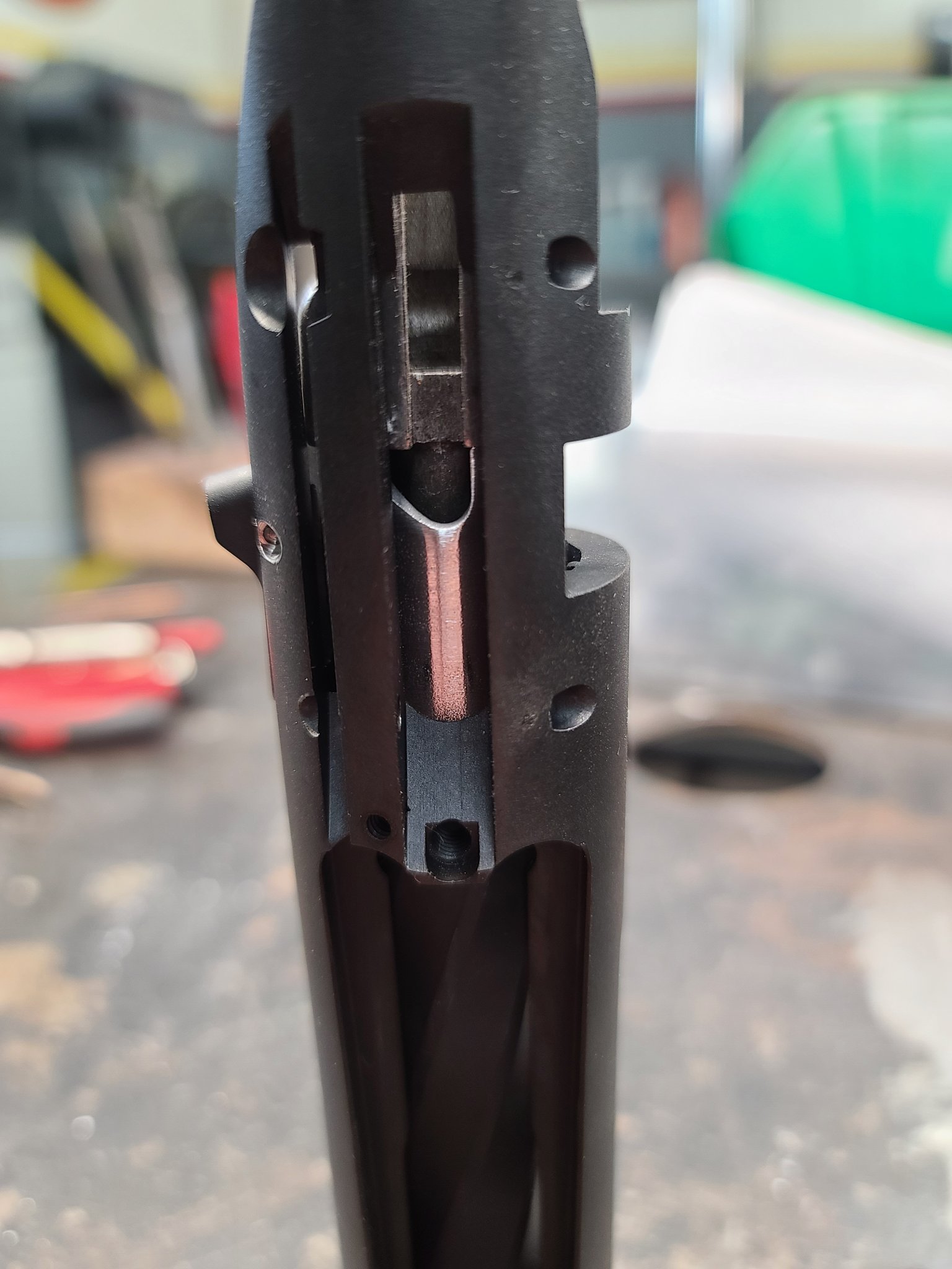

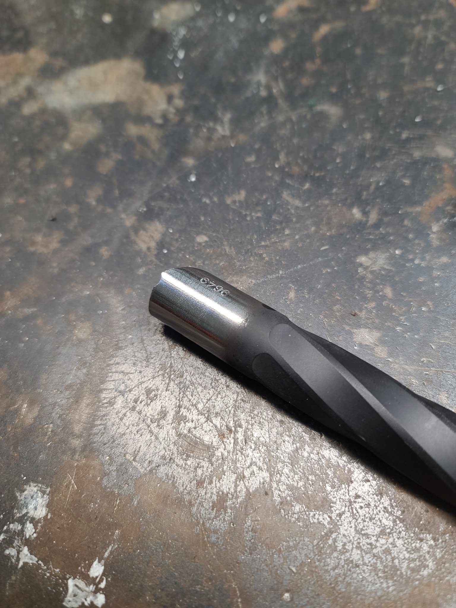

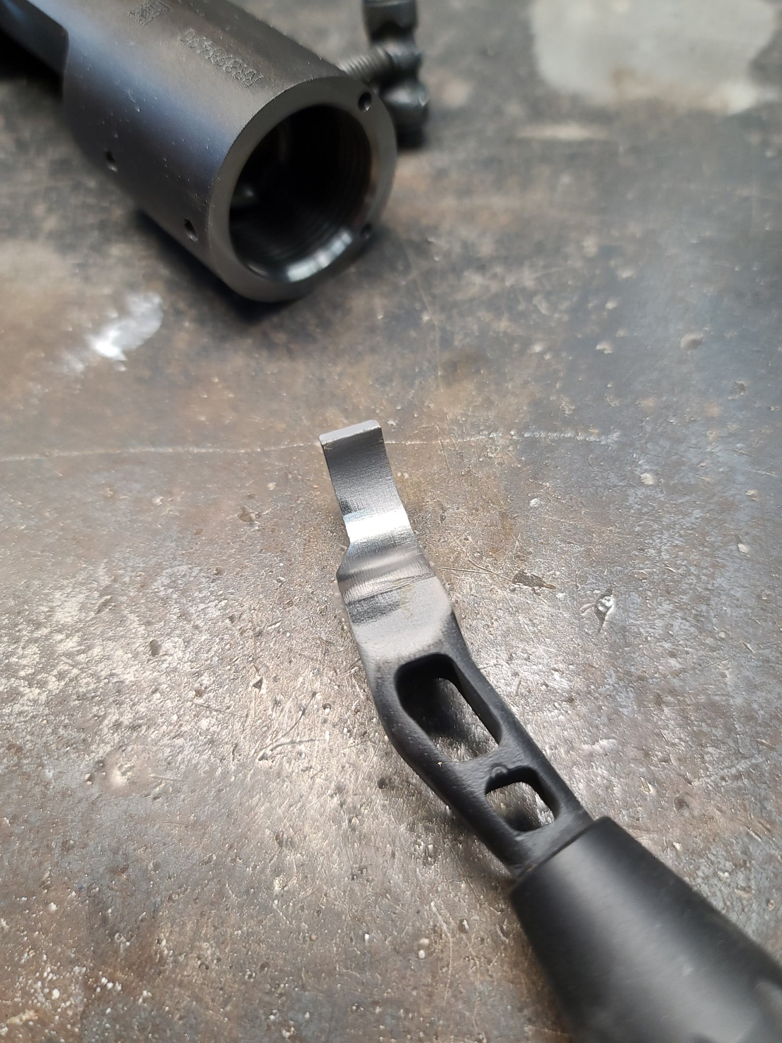

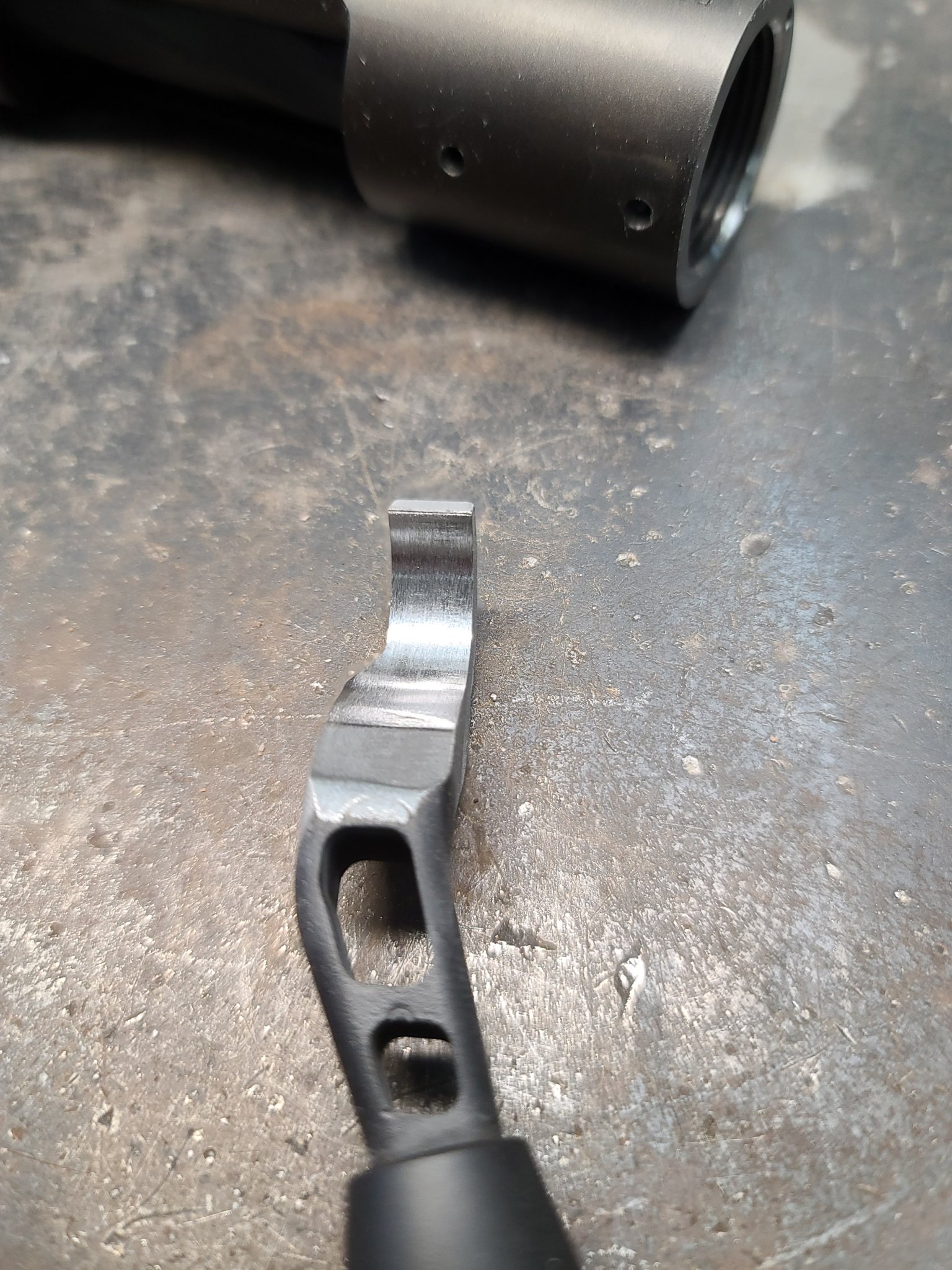

I have a few T&T jobs to catch up on this am so I snapped some photos to show what's involved with this service.
Parts being sterile is a big deal with this. No traces of oils, solvents, residual blast media, solder, paint, or any other funk can be present. Otherwise the weld quality goes down the tubes and solder will just refuse to adhere.

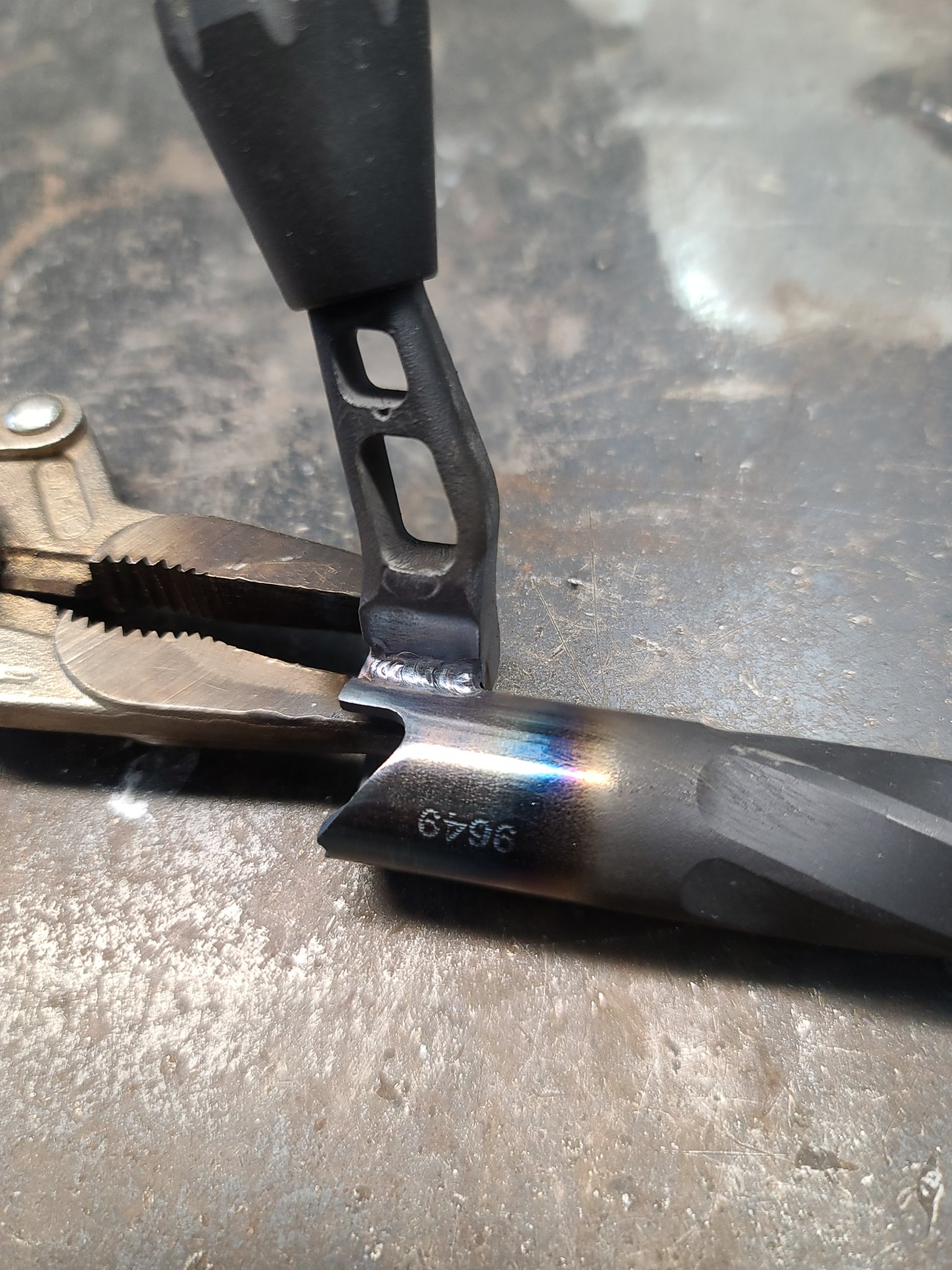

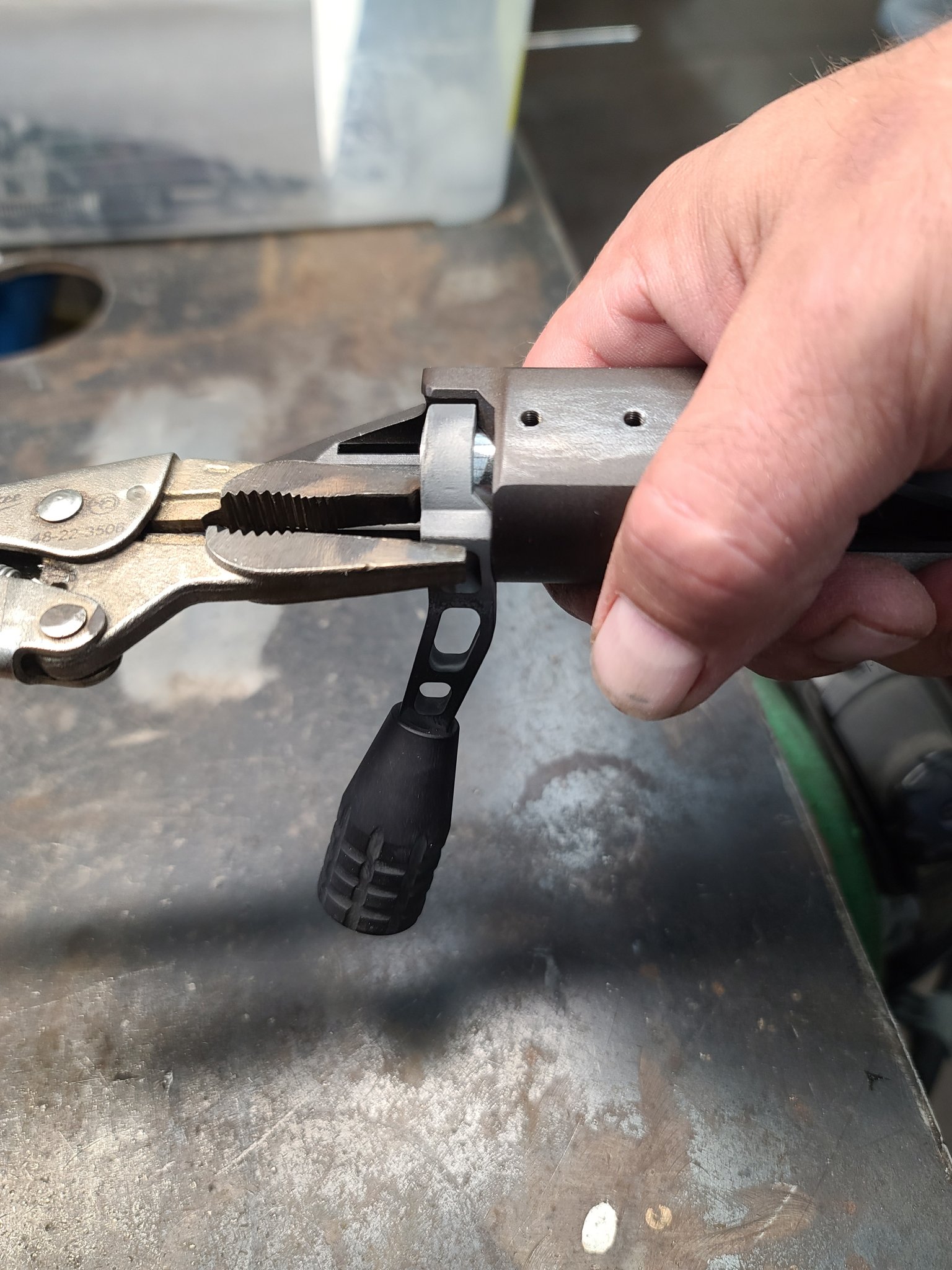

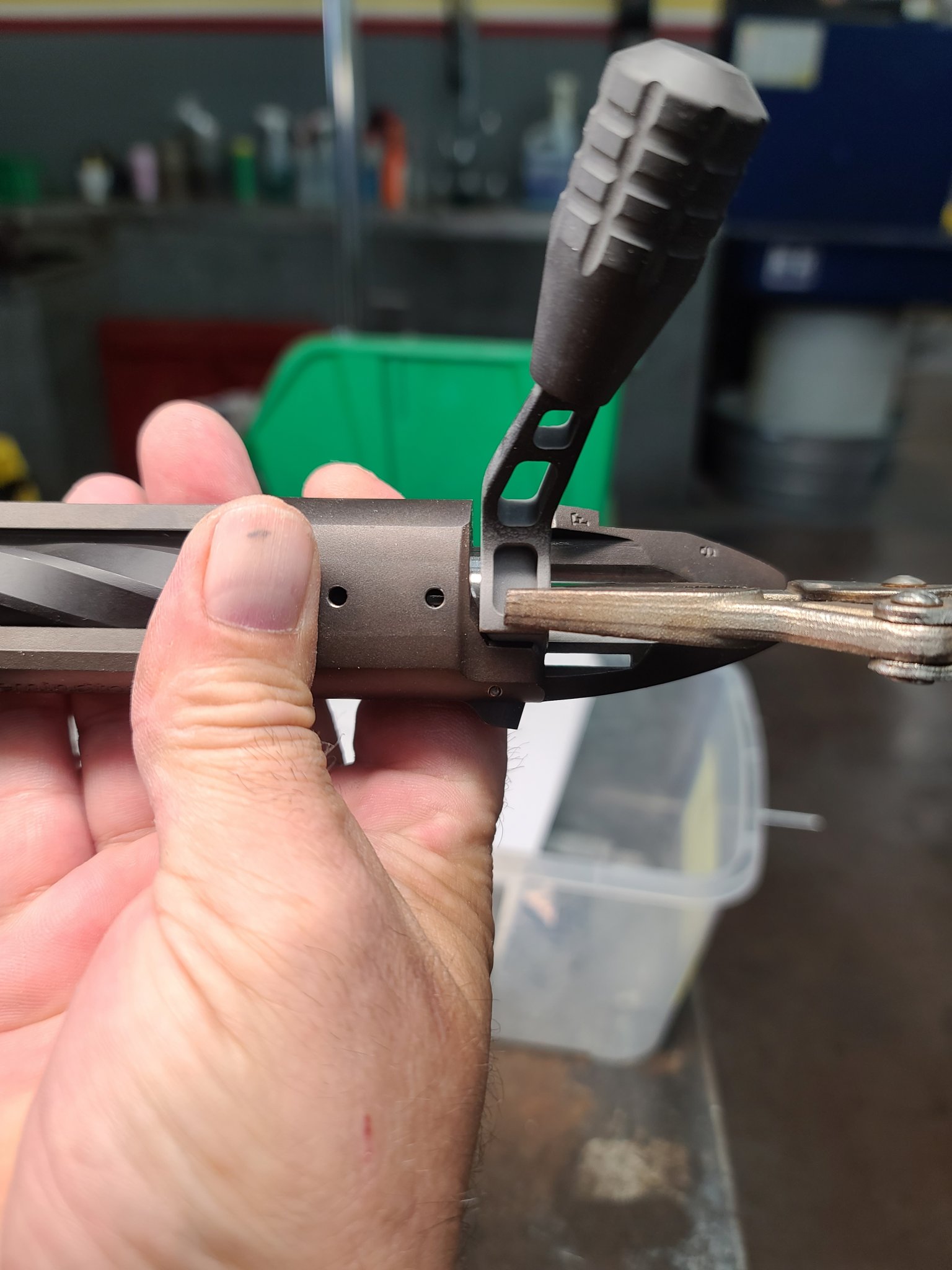

Setting the timing is pretty easy with the gauges and aids I made a decade ago. A modified pair of needle nose Vice Grips is still the best way to position the handle for me. I wear out a pair every 5 or so years.

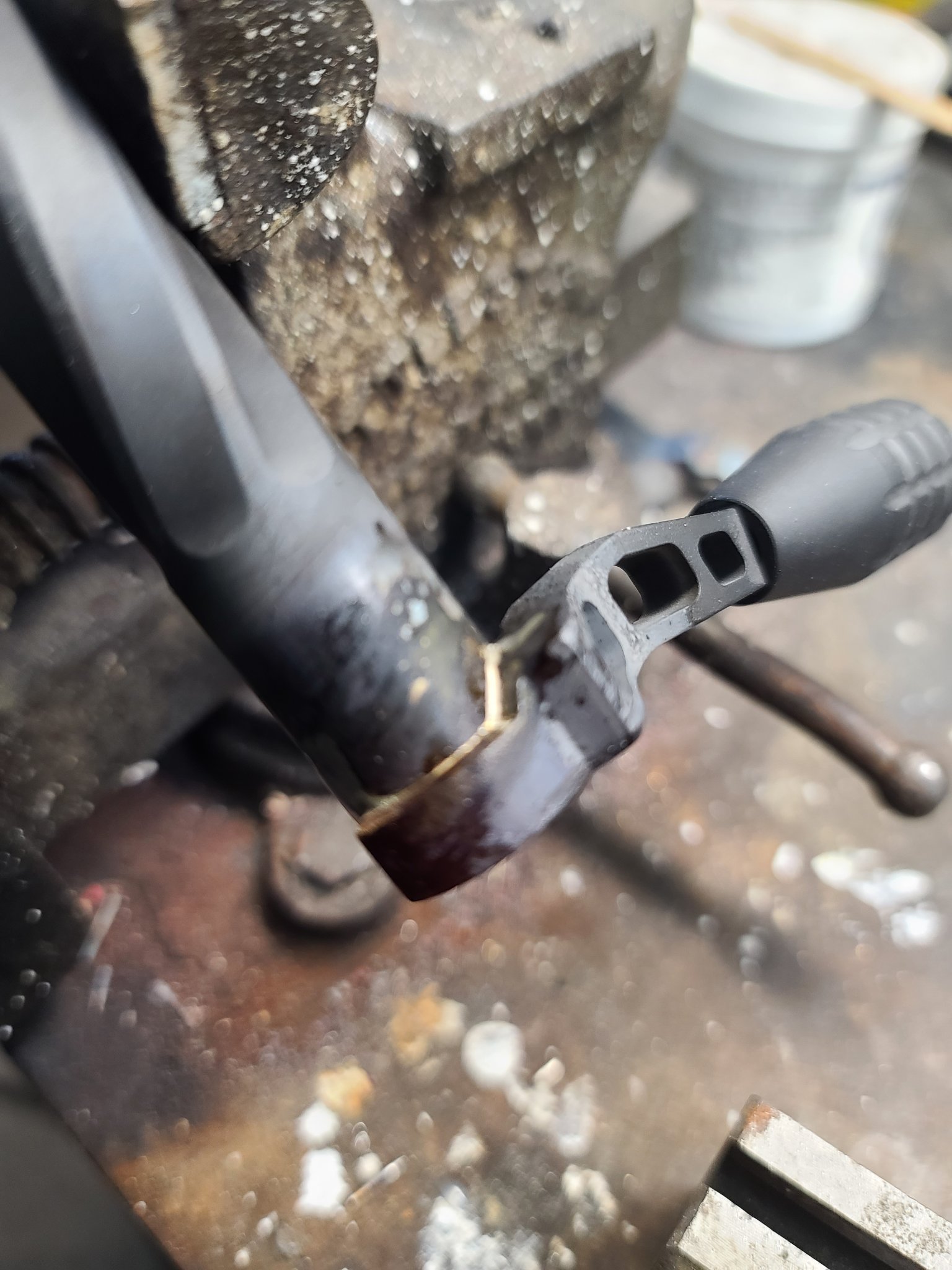

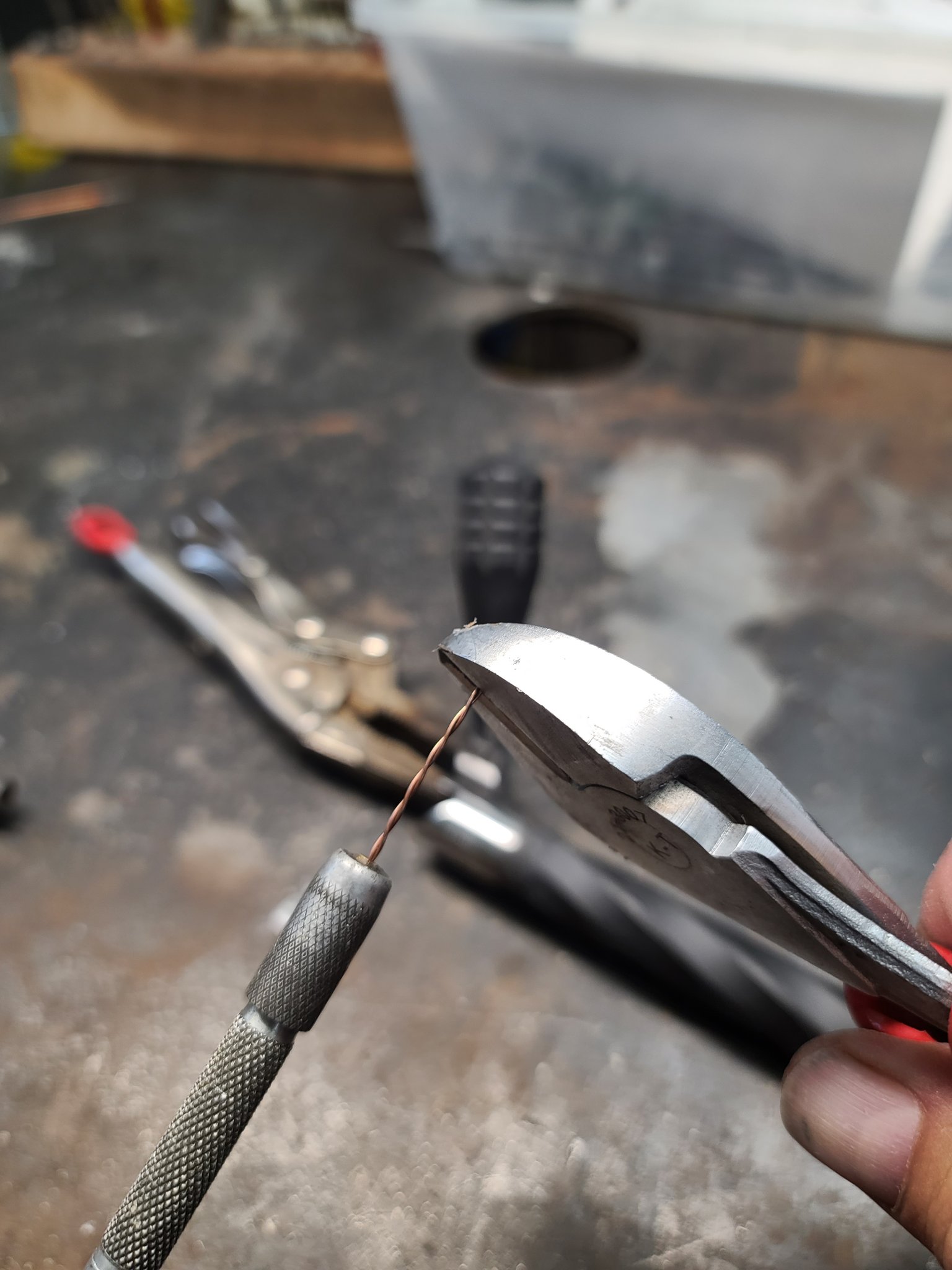

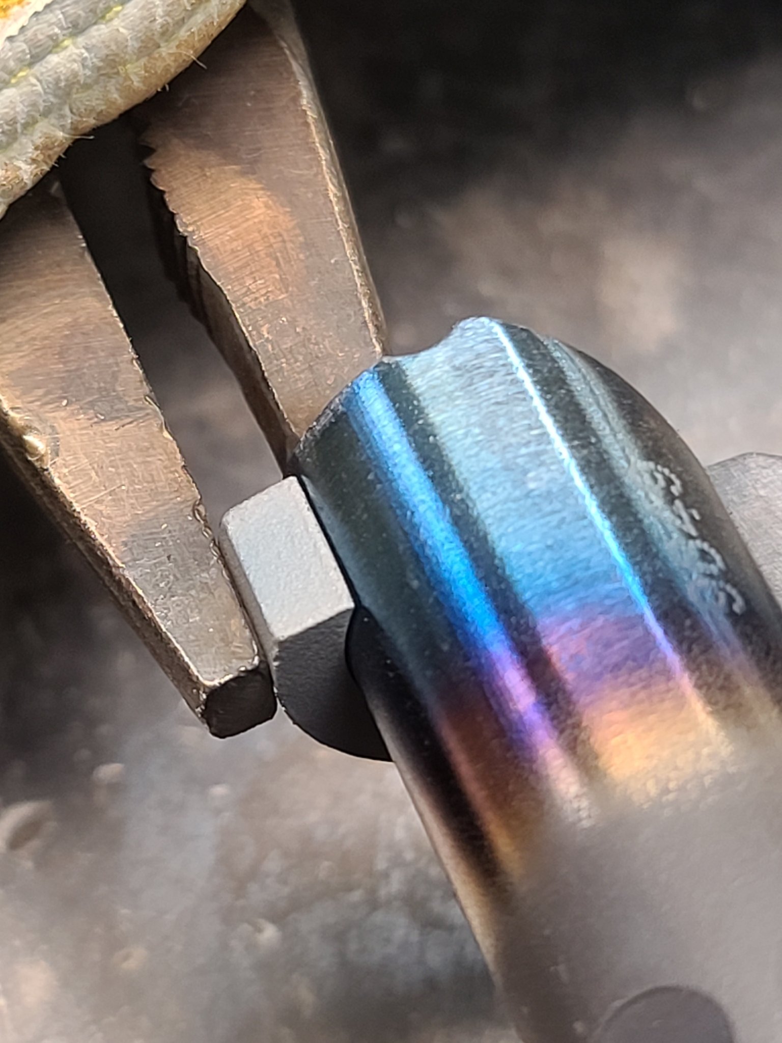

I always forget to keep my filler wire under the gas plume so that it cools in an atmosphere. So, I snip the end off back to clean wire. Not sure if it really matters, but that's what I was told to do when TIG welding race car chassis stuff in chromoly. (I play with a drag car)
I zip the strap with no filler as any buildup will make a mess of the bolt function as it drags on the raceway. I stitch that part of the handle under clamp pressure so the solder only has to fill a small gap between the bolt body and handle.

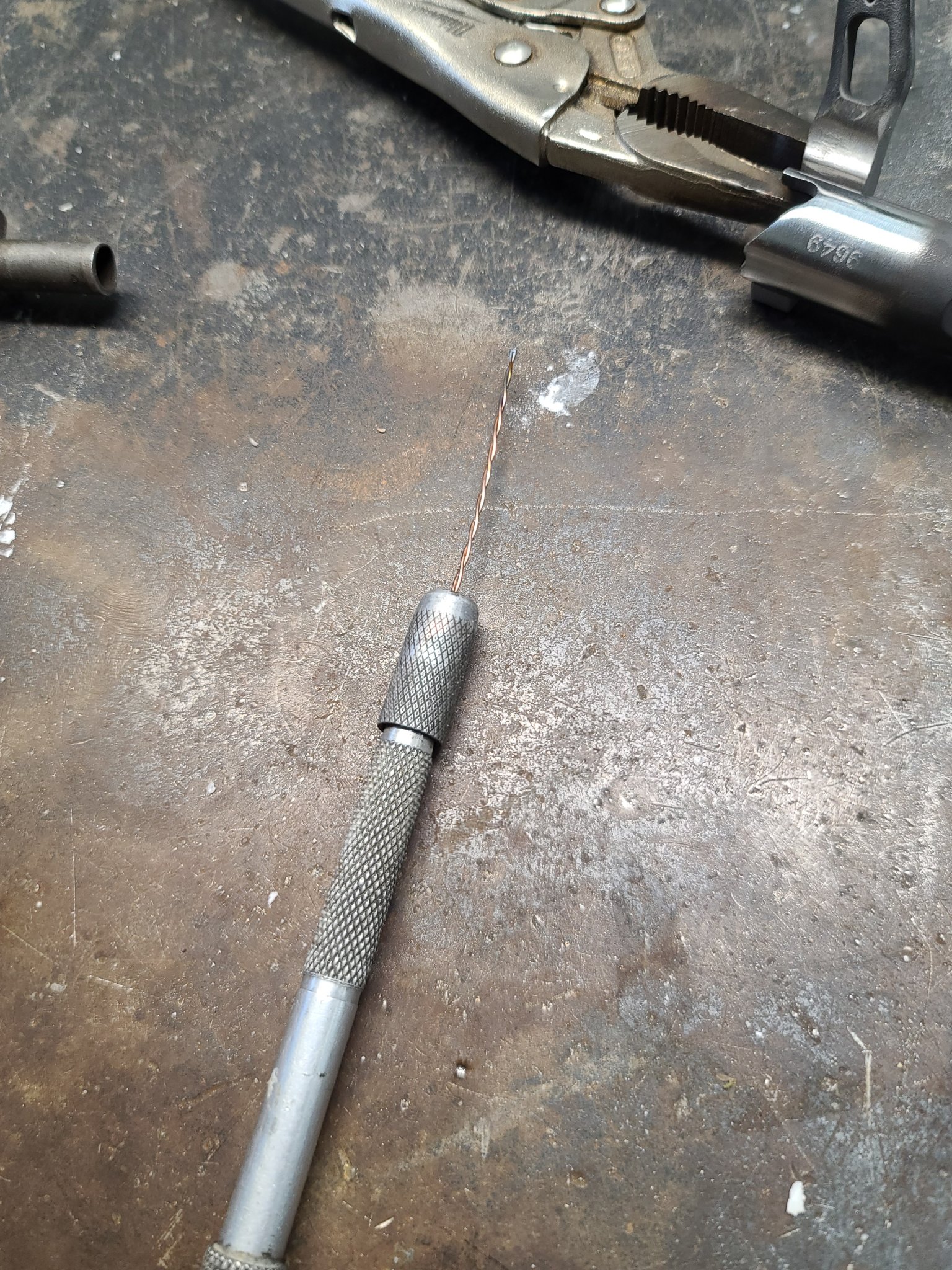

A 2x diopter helps my 52 year old eyeballs with the finer welding stuff. I use a pin vise to hang onto the wire. The stitch weld on the strap is only around .025 to .03 wide.

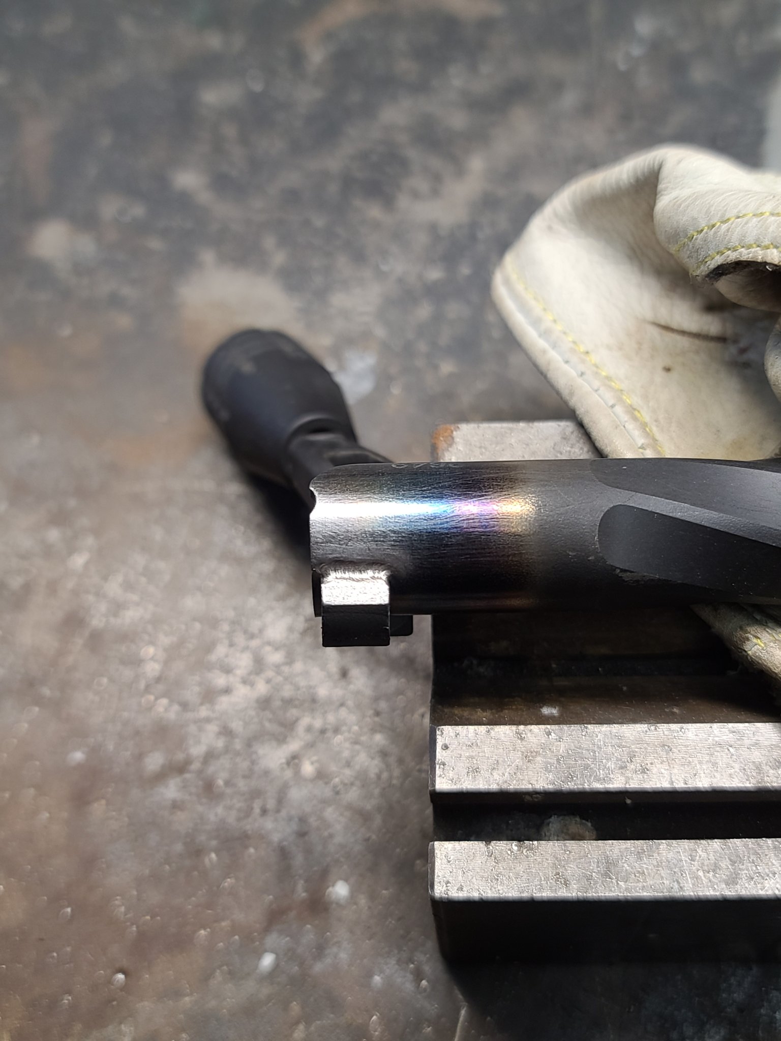

Last, flux and solder. Just enough heat to let it flow nice. I feed from the front and let it build up. Then concentrate the flame to the back side. When I see it flow rearward and form the silver ring along the back of the bolt handle I know I have 100% adhesion.
Onto the next one...
