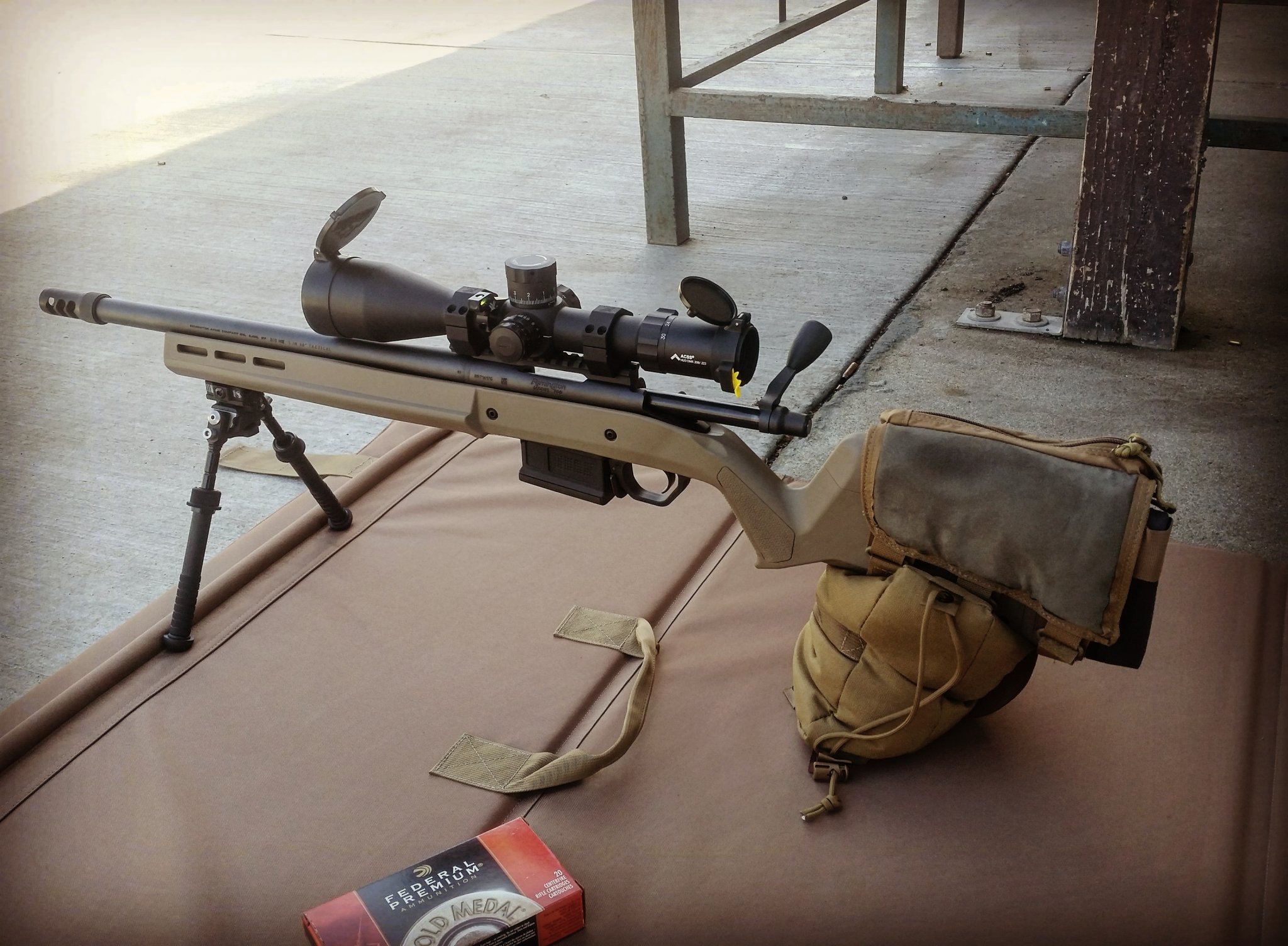

I can’t seem to get comfortable behind my rifle in the prone and need some help. The problem I think might be with my position but I am not actually sure.
The problem presents itself fairly quickly in that I get a pain in my neck on my right side from the base of my skull running down my trapezius when dry firing.
I index behind the rifle with my inside of my right foot to the right side of the stock and place the butt into my shoulder pocket or what I think is my shoulder pocket ;)
BTW full disclosure this is a new rifle... just zeroed it and have 40 rounds down range.
Rifle: Rem 700 Magpul short action hunter stock with the 0.50 cheek riser (the 0.75 is too high) with a Triad Tactical stock pack.
Thanks!

Thanks guys - I have my scope as low as possible. I did not think to adjust the bipod which is an Atlas BT46-LW17 at the lowest setting. I also have a small (red tac) and med rear (str8 lace) bag to try out as well. As for body size I can see the top of my belt buckle when I look down so no issue there.
How about elbow position since that relates to how high or low the shoulder is which in turn I guess could cause neck strain. BTW Would butt pad placement or LOP come into play here?
I forgot to mention that in the current position that is a problem my sight picture is good i.e. no scope shadow... <sounds like I know what the heck I am talking about lol. This is actually my first scope.
Cheers!

Hi all - raising the bipod and extending the LOP seems to have done the trick! Thanks for all the replies!
