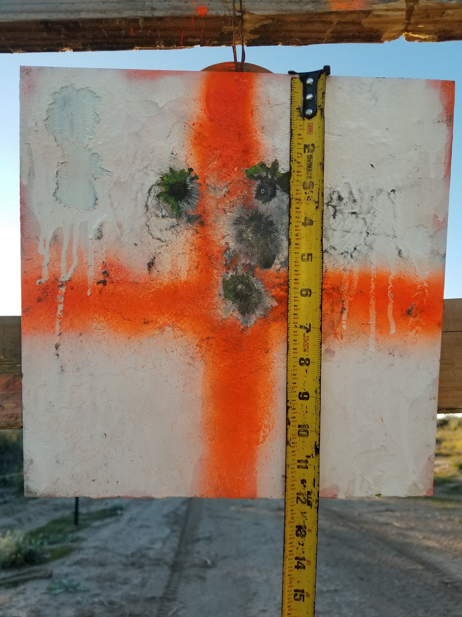

    So that's my Hi-Vis yellow and as you can see, it sucks. Great theory though, a bright yellow, should be great for shooting at. Not so great in actual practice. The Orange though, different story. It's too bad I ran out of it.
    And then that's my white & orange... I'll look at Amazon and look for that primer paint as well as the acrylic enamel. It's probably better I look online than any store local to me.

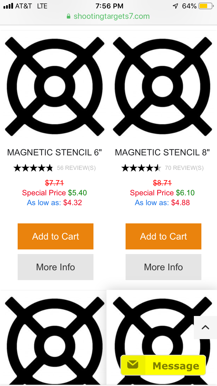

    Looks like a nice solution for giving a “center” to aim for.
    Yup, those look fucking useful haha. Before, I would just paint my target a solid color. Then, I added a waterline and noticed it helped a lot and shrunk my groups. Now, I'm doing a vertical and horizontal line just like a cross. It works real good so you can lineup your reticle to that and be more consistent with your POA. I noticed it worked really good for me.
    Those magnetic stencils should work in the same way...
