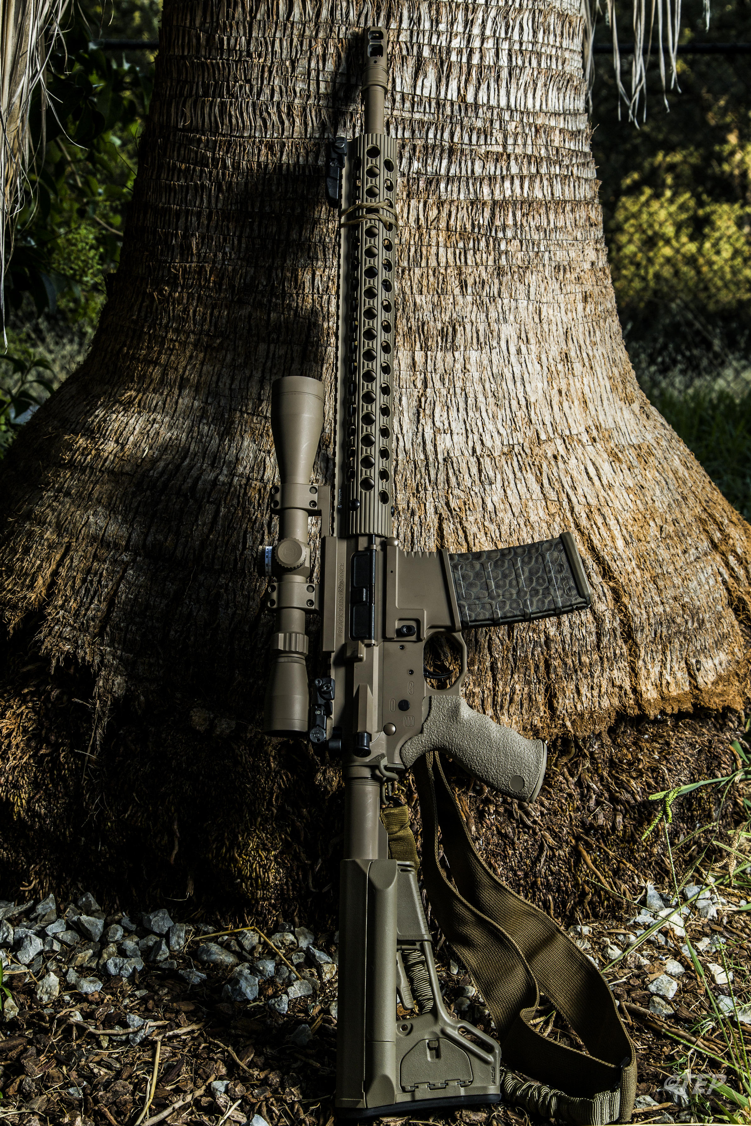

I had my WOA SS Match barrel cerakoted FDE along with my upper and lower a month ago. Turned out great. I had HDC, LLC do the work for $62.50 + shipping. I found the deal in the below thread. They did a great job and now I have them coating my SIG P239. Pictures of my AR after being coated below.

Wow.. I see a striking resemblance
