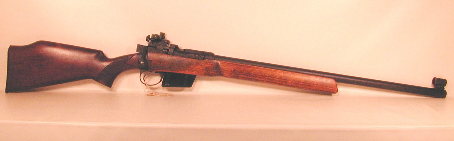

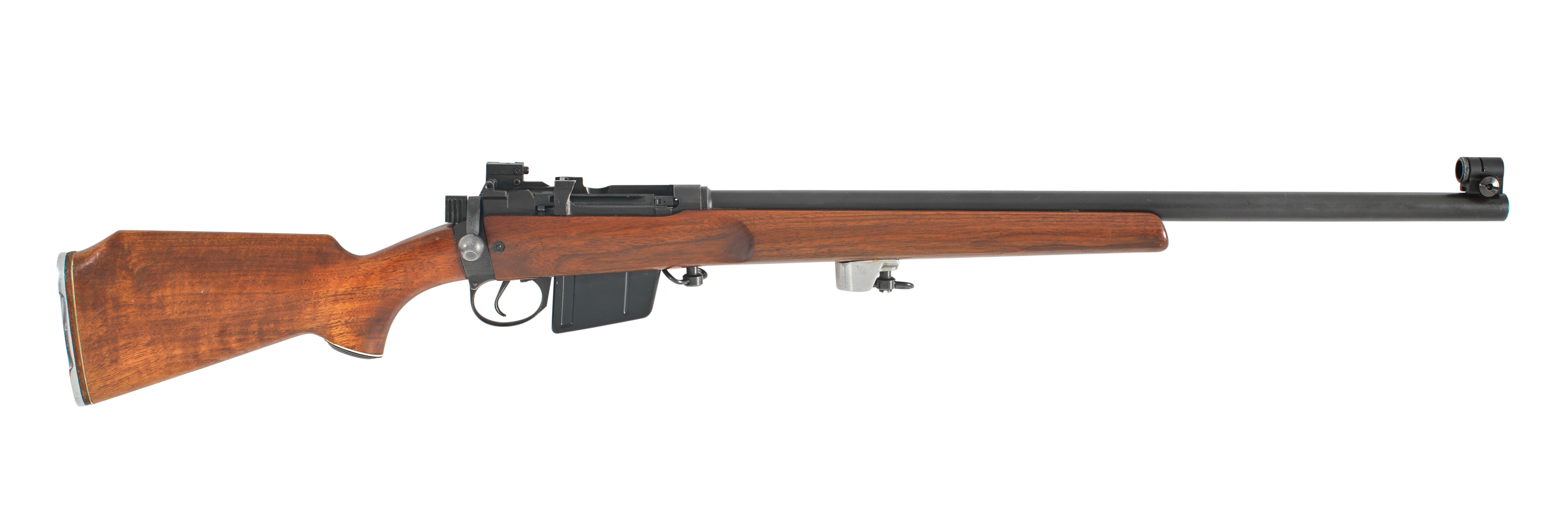

So does anyone know anything about these rifles? They were Lee Enfield No4 Mk1 rifles that were rechambered to 7.62 Nato and had the same barrels as the 1200TX line.
I will admit that I have never heard of one before.
Really your typical heavy barrel No.4 in 7.62. Generally similar to the Enforcers. Better stocks etc than the L42A1 rifles. Pretty good shooters when set up well.
So you’d say they shoot as well as the L39/L42’s?
Would the Parker Hale barrels be considered better, worse, or basically same-same quality wise/accuracy potential as the L39/L42 barrels ??
If I remember correctly Enfield made the hammer forged barrels for 39/42 7.62 conversions. Excellent shooters. Parker Hale barrels are also fabulous. I have used dozens either on actual PH rifles 81/82/84/85/87 or used to build Mauser based rifles. It's sort of an Red Delicious apple to Cosmic Crisp apple comparison, personal preference and availability. Really finding any factory heavy barrel No.4 in 7.62 in the US is a happy day and an enjoyable rifle. Most of the target versions are reasonably affordable, while the L39/42 rifles have gotten stupid. Example, I once bought an L42A1 in its transit chest with matching optics and all accessories for $1500. I think there is one on GB now for $15000 or more.

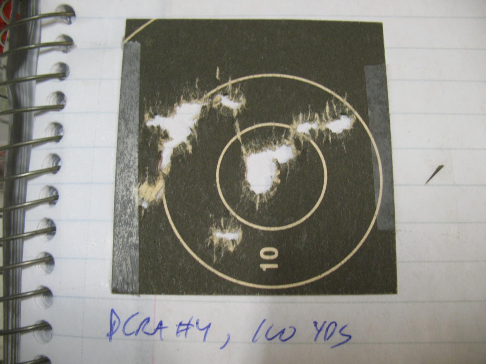

Mainly the bulletweight-range coming from the Service-resp. Surplus-Ammo, I see, yes.. . What about the target-loads with match-bullets from 155 grains and higher - the range of out to 800 yards is not necessarily the most suitable one for these lighter bullets ?.. . Hoping and supposing that NZ has not to follow all the english NRA-Rules, too ;):D ? To fully exploit the rifle’s precision. Some T4-Barrels may be less tight than "typical old" Enfield No.4-matchbarrels.. . Hopefully.

  • Lee-Enfield DCRA No. 4 .7,62 mm NATO 20-Shot Group 100 yds 155 gr Hornady A-Max Match.jpg
The 155 grain bullets should do well, subject to barrel dimensions and condition. Experimentation will determine how quickly you need to drive them to ensure full obturation and reliable down range performance, due to their relatively short shanks.

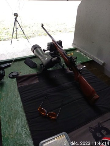

There has somebody the Lapua 155 gr Scenar and his 167 grain-sibling used: https://tirsportif.forumactif.com/t33759-parker-hale-t4

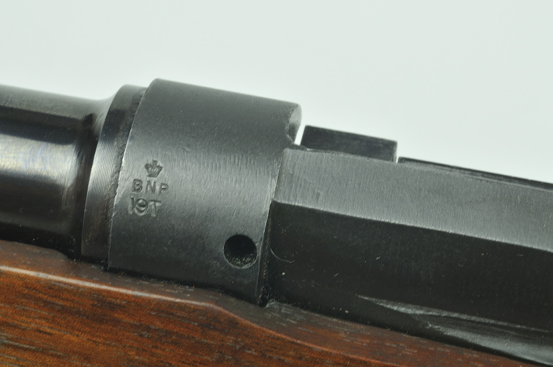

Hmm.. what about the exact level of this 7,62 mm Nato-proof ? From which years ? To compare with the No.4-Enfield-Conversions in England.. .

According to p. 526 (pertaining to the L42A1) of The Lee Enfield: A Century of Lee-Metford & Lee-Enfield Rifles & Carbines, by Ian Skennerton, pub. 2007;
‘the bolthead is marked ‘19 T’ which indicates a pressure of 19 tons per sq. in. for the 7.62mm re-proofing.’
N.B. Nineteen (19) Imperial tons per sq. in. equals 42,560 pounds per square inch. It is worth remembering that, according to Julian Hatcher, the short ton is never used in ballistics. The same is apparently true of aeronautics.
P.S. The reproving of British N.R.A. rifles to 20 tons was actually recommended in 1973 for the purpose of shooting ‘Heavy Raufoss ammunition (185 grain) …’ although it obviously came in handy later on, when some shooters started using deliberately undersized barrels with 144gr service ammunition. The reproving was done using the oiled case method, which … when you think about it, is an excellent method for proving a small arm. Oily chambers, oily fingers and cartridges with water on them are known causes of real world rifle problems. If you P.M. me your email address, I can scan the relevant page of Guns Review, June 1973 and forward it to you. I also have a copy of the May 1990 edition of Guns Review which contains a four page article on the Parker Hale M85 Target Rifle.
