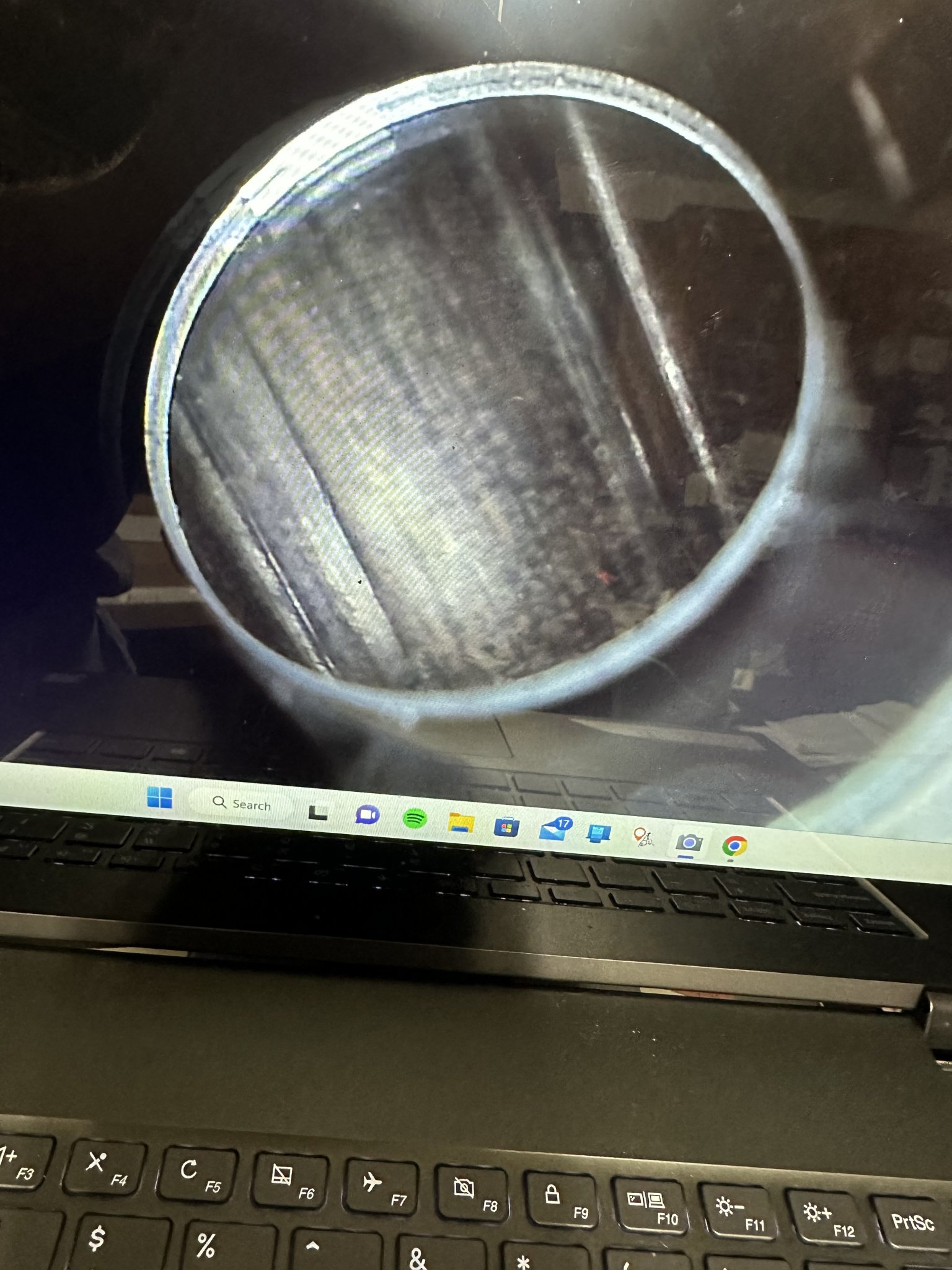

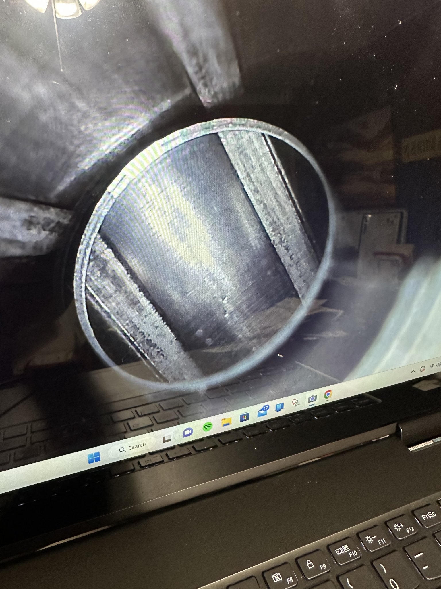

Hello I have a couple of bolt actions that are seeming to be clean but when I look with the bore cam I am seeing a smooth black coat. I actually am seeing this in 2 right now, both are Remingtons, one is a model 710 .270 and the other a .300 rum in model CDL. I have done a multi stage cleaning process using all bore tech cleaners, jags, patches, nylon brushes etc.. I thought maybe at first I had let something dry but they advertise all of the products able to sit and I haven’t been mixing or anything like that, just one at a time. Non of the multiple others have this black coating that will not budge like these 2. Wondering if it is a heat/season type deal or if something had been done previously that made this coating? Not sure it doesn’t seem to be carbon and can’t imagine it could be from any products or anything I did.

It’s just leftover hard carbon, completely normal. If you really want it gone, you’ll need to probably soak the bores in something that helps break it down and then scrub, or scrub with some abrasive cleaners.
Okay I had let it sit for the night with several cleaners, one being bore tech carbon remover C4 and did a bit of nylon brushing.. still nothin.. so if it is carbon I guess it’s incredibly stubborn?
not all nylon brushes are equal, and they’re always going to be more difficult to clean with than a quality bronze brush. But, some people like to avoid bronze brushes.
Iosso nylon brushes are great quality, and when used with a good cleaning regimen, should get all the carbon out. But at the end of the day this boils down to time or agitation. You either let a good cleaner like Bore tech c4 really soak in for a while, or you use an abrasive.

Use a bronze brush and Free All penetrating oil, it will remove a good portion of the hard carbon. It will NOT make the
barrel look BRAND NEW but will remove enough to keep the the carbon from becoming excessive.
There is no need to go to abrasives because you will never win the battle, carbon always wins. The
thing to do is simply dont let the carbon buildup become excessive and if the rifle shows no accuracy issues
you are good.
And your barrel dont look that carbon fouled.

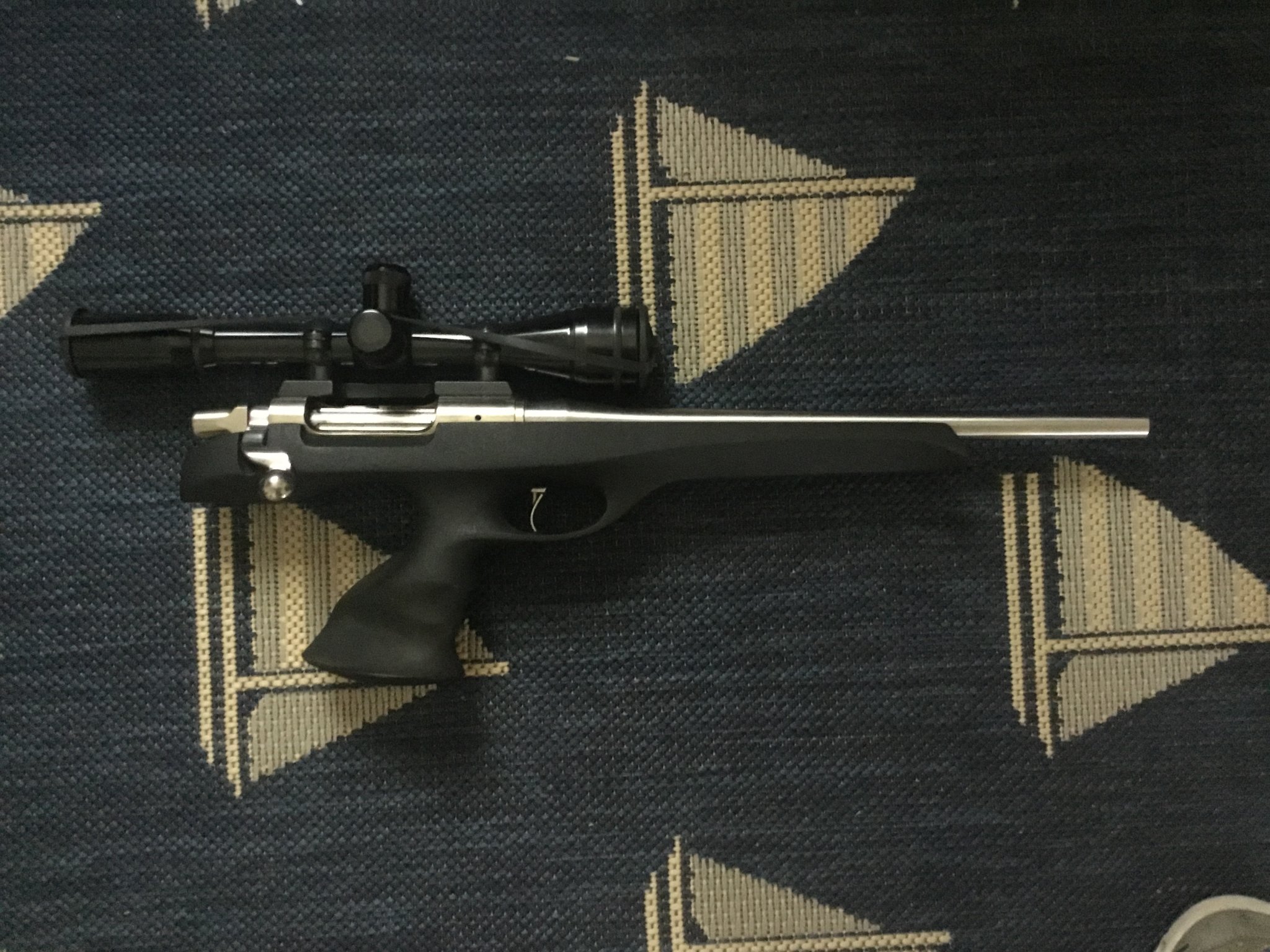

As said, I purchased this XP-100 from a good friend who built it for open sight shooting, found it a bit muzzle light, added 5 oz of lead in the fore end, mounted a 7X Burris target handgun scope and it has shot more perfect scores 40x40’s and 60x60’s than all of our other handguns combined. And it still wears the same barrel it was built with 20 years ago. And it still puts three shots into an inch at 200 meters, shooting creedmoor.
Personally, I don't see a problem in those pics.
Does it still shoot as well as ever? If so, then march out and enjoy it.
It’s carbon and you will need to used an abrasive like Iosso or JBs bore past (not the bore bright) to get it all out. But the 710 and CDL are factory rifles with generous factory chambers and you don’t need to scrub all the carbon out to avoid pressure issues. you can go a long time with just normal cleaning before the carbon causes any issues.

Pressure issues? I don’t see mention of a carbon ring (did I miss it?)
And personally I would not go full retard with abrasives to get what looks like just a thin wash of carbon.
To me, that barrel looks pretty good but the open question to the OP stands unanswered….does it still shoot good as it did before?

There's no solvent that will remove that carbon. Jb bore cleaner will remove it or a bronze brush but the bronze brush will take a lot of work. A nylon brush is pretty much useless, run a bronze one behind it and you will turn up lots of black

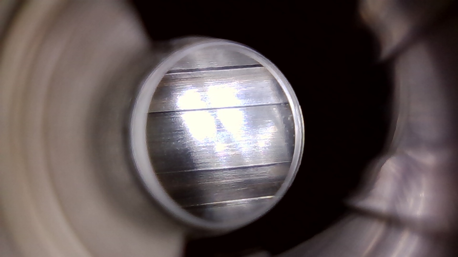

Those barrels are nice and clean. A clean barrel will look like it has a black coating. It's shadow/trick of light thing. I have a few premium blanks that look dark as night in the borescope, but are pristine. I had a barrel I thought had "hard carbon" in it. I posted pics to accurateshooter.com. All those know it alls were telling me hard carbon. I'm pretty sure I roached that barrel trying to clean shadows out of it.

I would just add that if you hadn't had the bore cam you never would've know there was an issue, because there's isn't one. My point is this: bore cams have a way of birthing issues, not necessarily identifying issues. Guys (myself included) get themselves a shiny new bore cam and all of a sudden the rifle they've been shooting for many years with no issues at all has a growth in the bore that is going to suck the life out of the gun and humanity alike. Do yourself a favor, use the bore cam to identify legitimate problems that arise, use it for periodic checks, use it when you need it but don't get down in the weeds on what your seeing because I can just about guarantee it's not a big deal. I'm not giving you a hard time, just the benefit of my own lessons learned.
Here’s a JB Bore paste clean bore. Shot like complete shit for 40 rounds afterwards. Waste of time except for the sweet pic.
Waste of time ? That's the way it is supposed to look . Do you have shit stains in your underwear because getting your anal dot clean is a waste of time ?
