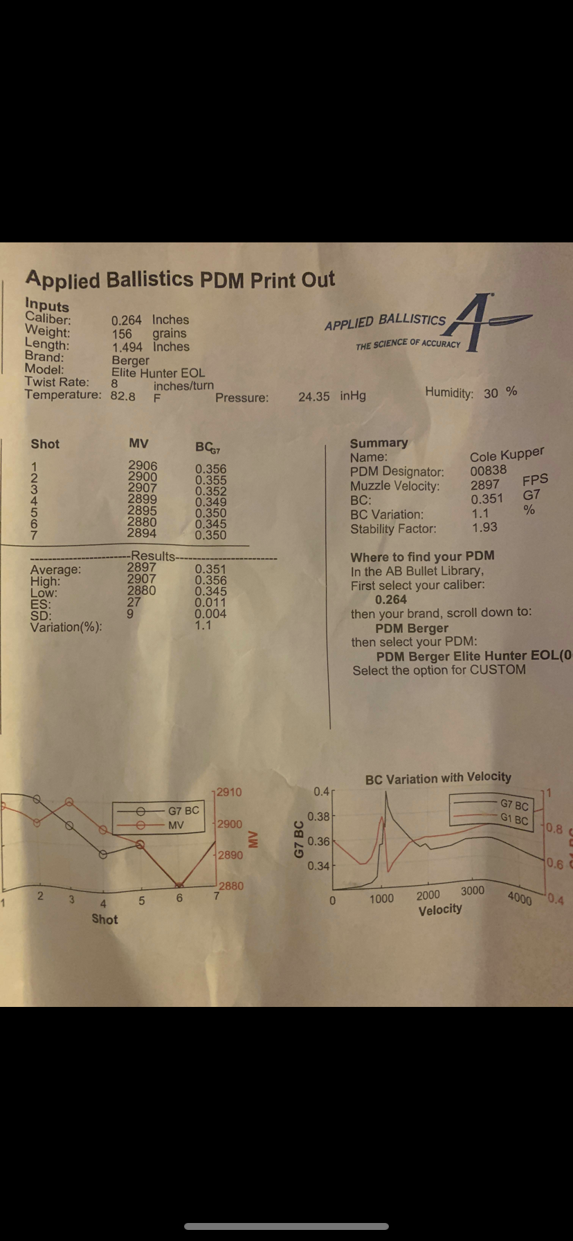

It will be interesting to see others PDMs with different bullets, my PDM seemed pretty accurate, I just rounded down or up depending on what I saw downrange
I didn't have a chance to shoot through the AB radar, I trued it up myself and had to drop the BC when it was nearing trans.
I trued my bc at 1820 yards during practice, then when I shot the 2100 I was low, this was the amount of correction I needed to be on target. I was also shooting these out of a 300 RUM 1:9 barrel 32" so possibly under spinning them a bit, I did manage to blow one up.
250 A-tips @ 3040 fps
.440 G7
.404 G7 at 1350 fps
300PRC, 31" Brux 9 twist. For what it's worth

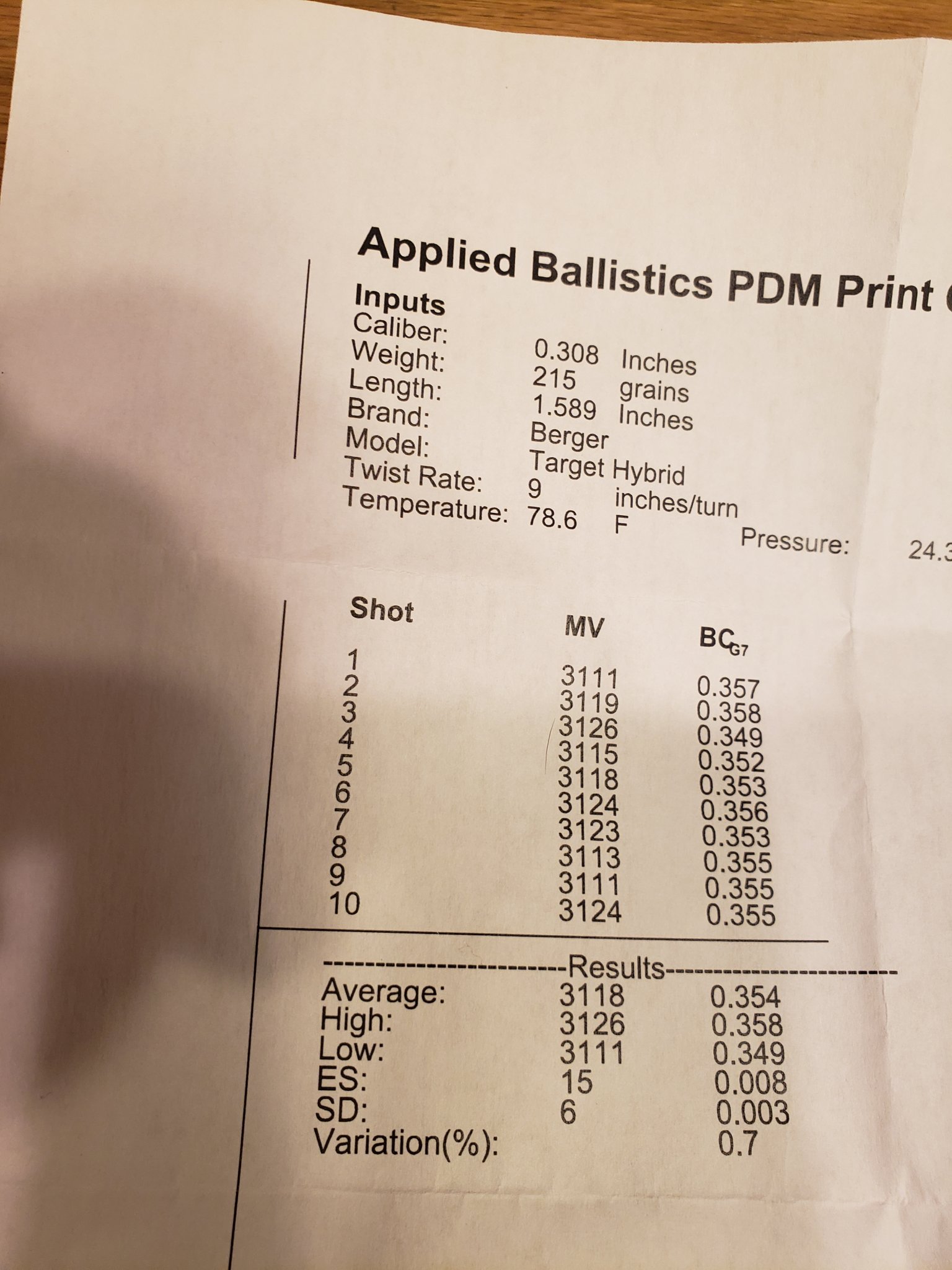

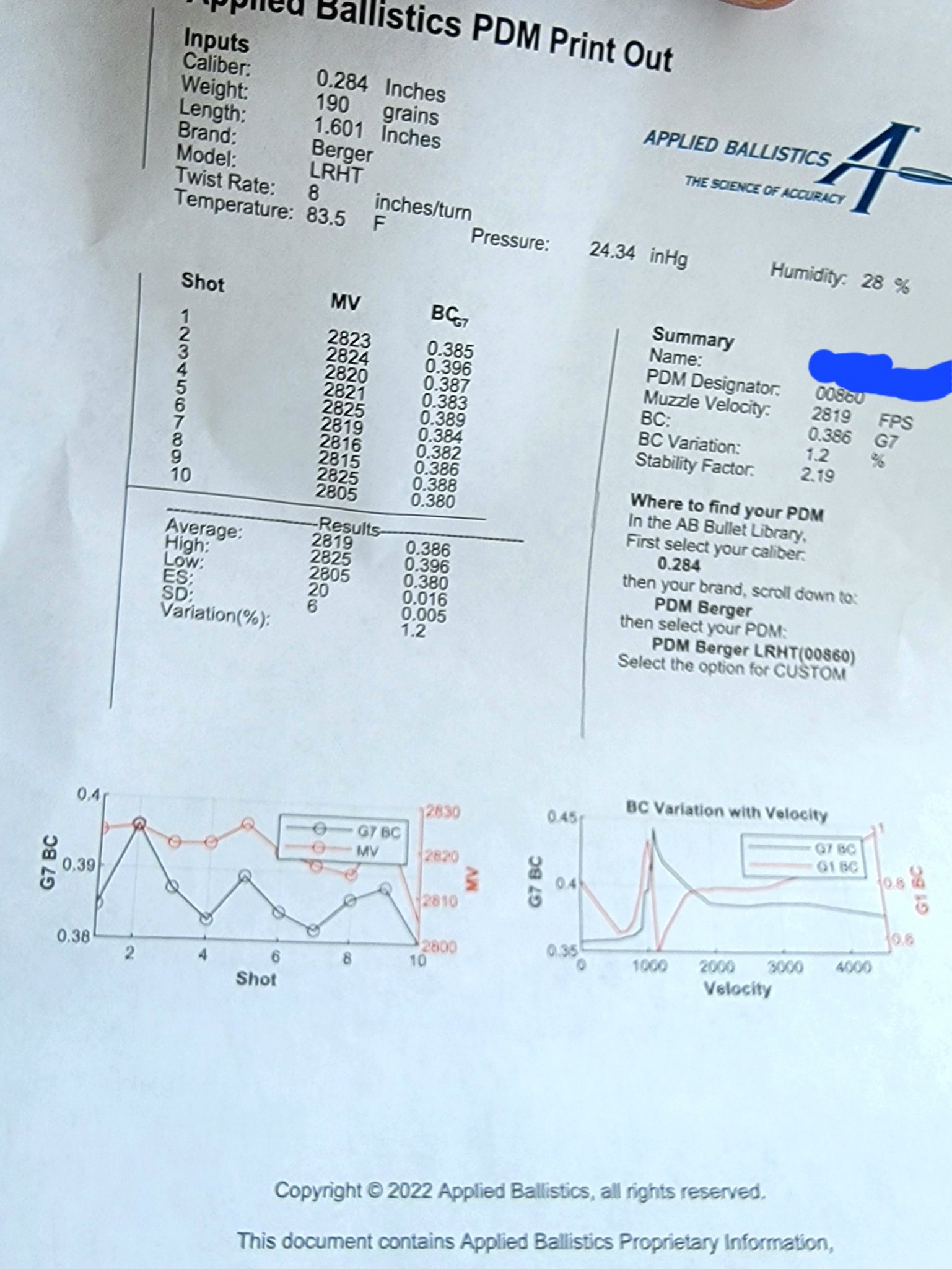

Wasn’t real happy with my ES but the gun shot fine. Only had one target where I missed low right under so I held just over top and that’s where I hit. That was the only notable miss due to ES/BC sd. My PDM only had 7 because I was sticking rounds in my chamber and having to remove them with a cleaning rod during the PDM
Can someone explain to me why the BC seems to spike at transonic?
It'd be nice if you could read the graph better so you could model it yourself in other calculators. I use Strelok Pro.
