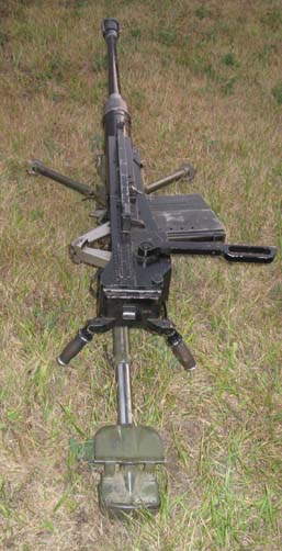

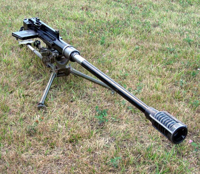

The Heinemann is a neat piece. The NRA museum has a couple but its tough to get those guys to allow any examination of these jewels. They were made in a few different cals so a chamber cast is about the only way to know for sure.
Pictured is the TB41 sitting on the mount for the Swiss watercooled Maxim MG11 machinegun. The Anti-tank gun would fit a mount made for it, the MG mount or could be fired while it sits on the ground. The picture from the rear shows the cocking handle retracting the bolt and the toggle links sticking out the left side of the receiver. The gun is recoil operated and weighs about 170lb without the mount. The mount pictured weighs about 55lb so we're over 200lb. Mag holds 6 rds and is self ejecting after loading round 6. Its semi auto.
Frank
Frank
