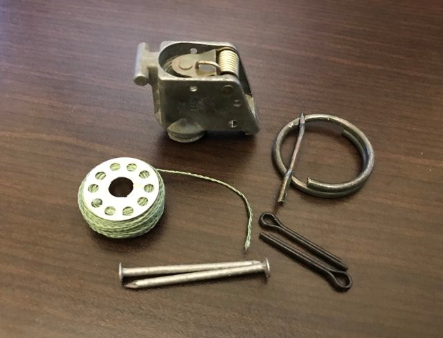

    I recently bought some tripwire perimeter alarms made from modified M228 grenade fuse assemblies. These are armed with common 209 shotgun primers. When the pin or cotter pin is pulled, a spring loaded striker strikes the primer. The sound is comparable to a pistol shot.
    Every summer I have bears climb up on my deck (8-11 feet above ground) even though we bring in bird feeders every night. And they usually cause some damage to Mrs. Slo cat's plants.
    Here are two pics of how I trip-wired my deck for bear. I placed the grenade fuse assembly where it could be easily reloaded. I strung the trip-wire about six inches away from the outside of the deck rail where it is not likely to be disturbed except for bear. I used wheels to string the trip wire at each corner of the deck as in the second pic. The trip wire extends all the way around the deck, about 45 feet, where I placed a second grenade fuse assembly. One other thing. I tested the force needed to pull the cotter pin out of the fuse assembly with my trigger test gauge. It takes 4 lbs. of pull. Since there are many birds and squirrels on my deck, I wanted a heavy enough resistance on the string to keep false alarms to a minimum. I also drilled a hole in the center of the assembly to make it easier to nail it to something solid.

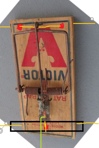

    This is what I use for Early Warning in the field for work. Its a Victor rat trap with three 3/8 inch holes drilled out (marked in red). The whole at the bottom will have a loop of 550 cord pulled through (yellow), to hold a chem-light(black). The chem-light can be IR or colored depending on the situation and your NV capabilities. You then attach the trap around a tree at eye height from your position and run a trip wire (lime green) from the trigger across the Anticipated Avenue of Approach. When the trap is set it will sound similar to a breaking stick but give the observer a heads up as to which direction the enemy is moving in from.
    I didn't feel like unpacking my field gear to make the mock up so please excuse my crude paint hand-jam

    seems like a good idea but my concern would be the trip wire being towards the top of the rail as bears usually climb when spooked and they’re already going to be close to the top when that goes off.
    Wouldn’t want a pissed off bear stuck on my deck! Maybe having the wire below the deck level would work better as a deterrent? Just food for thought , but neat system.
    Yes, a trip wire at the top of the rail would be too high, and then squirrels might trip it. If you look carefully at the photos, you can see that the trip wire is only about 8" above the floor of the deck, where a bear would trip it on it's way up.
