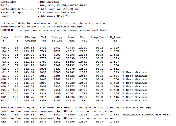

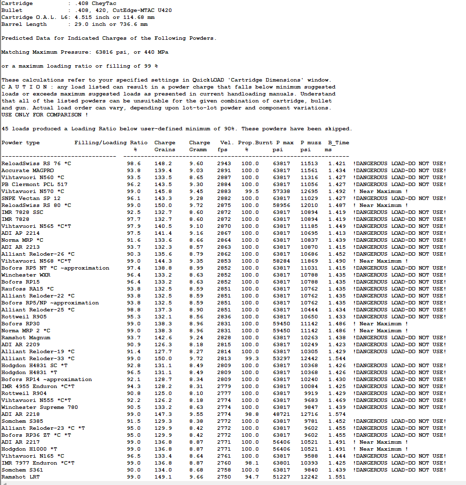

    @232593 here are some suggestions with Quickload using Cutting Edge 420gr MTAC as an example

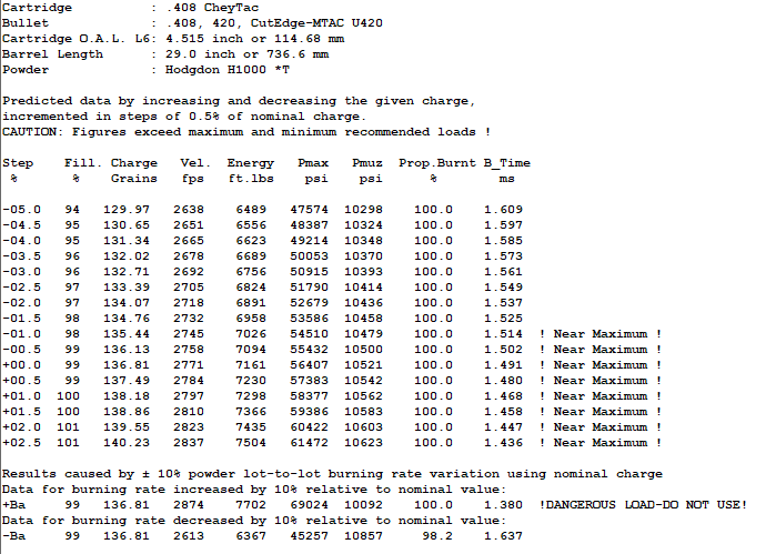

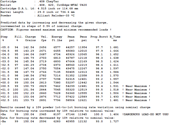

    From that list it looks like RL33 would be ideal, with N570 & H1000 not far behind. Unfortunately those are hard to get powders, but drilling down a bit on those to see a ballpark of charge weights to think about....
    RL33
    N570
    H1000
    Again, this is NOT a replacement for actual load data, but this should at least give you an idea of where to start.
    Reactions: 232593
