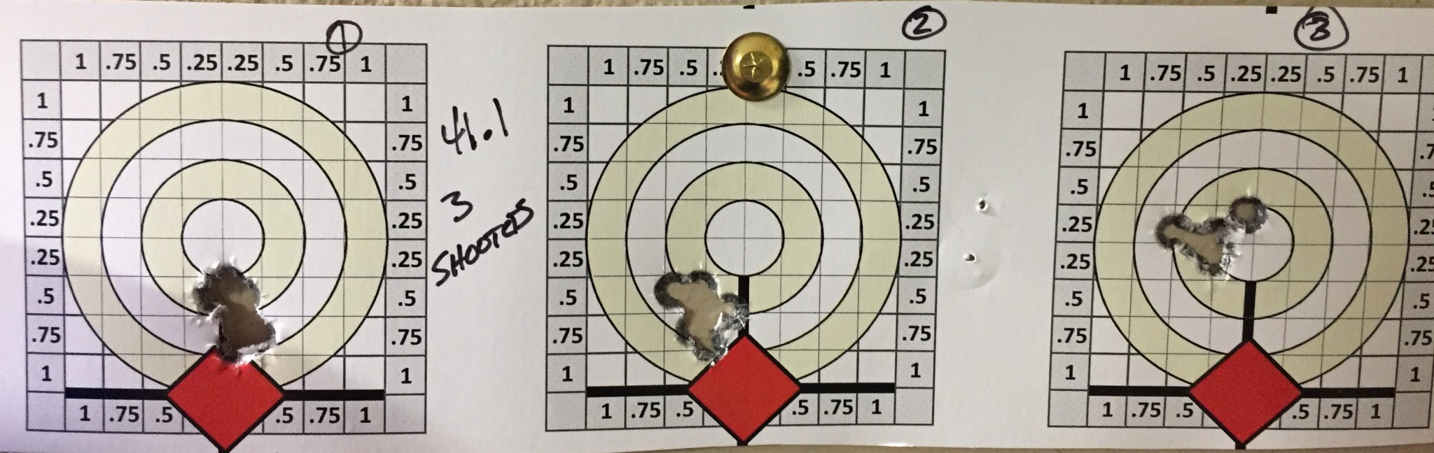

Experimenting now with no expander in the Redding die and my SDs are 6-7.
41.2 H4350, .025 off lands, 24” Bartlein, 2750 fps
3 different shooters shooting 5 shot groups, all under 0.25 - it’s an accurate node with this rifle.
