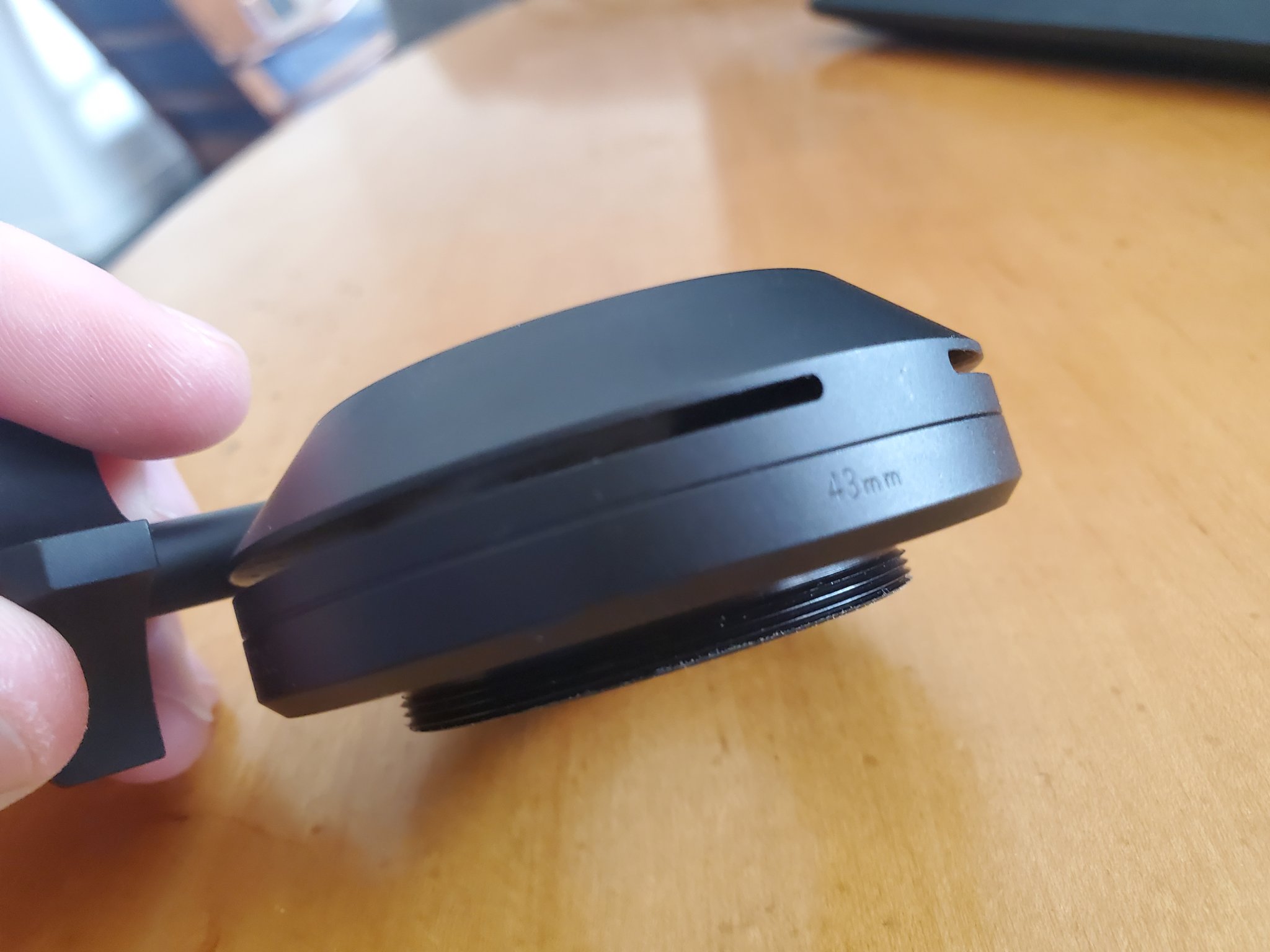

I'm going to try epoxy and this ring with a spare phone case and thread it onto the Leupold adapter.

You look like you've got a winner.

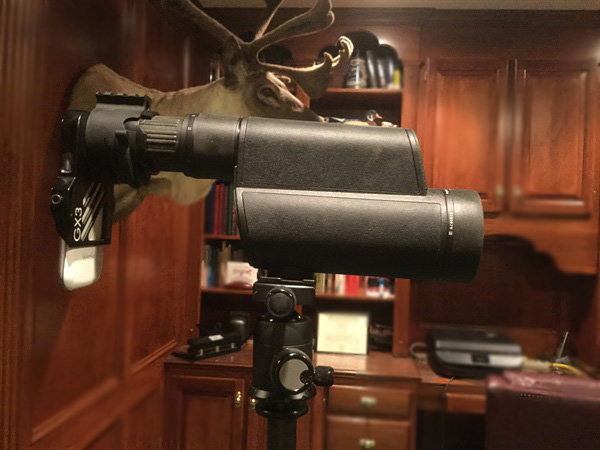

This is the setup I use with my spotter.
