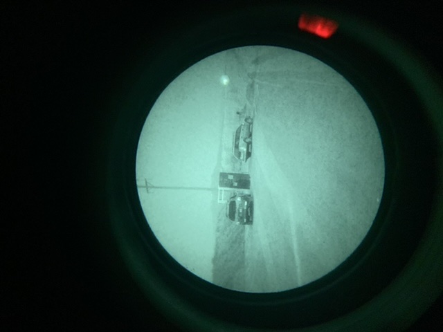

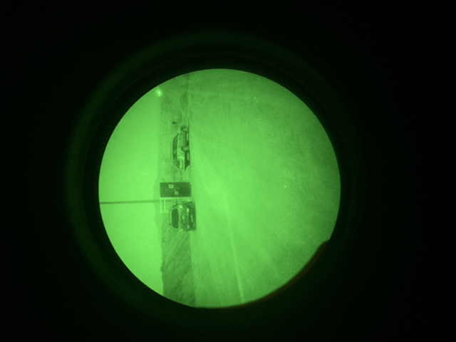

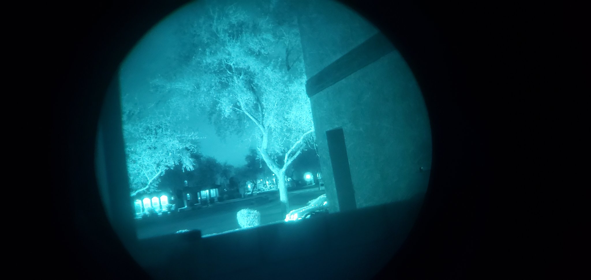

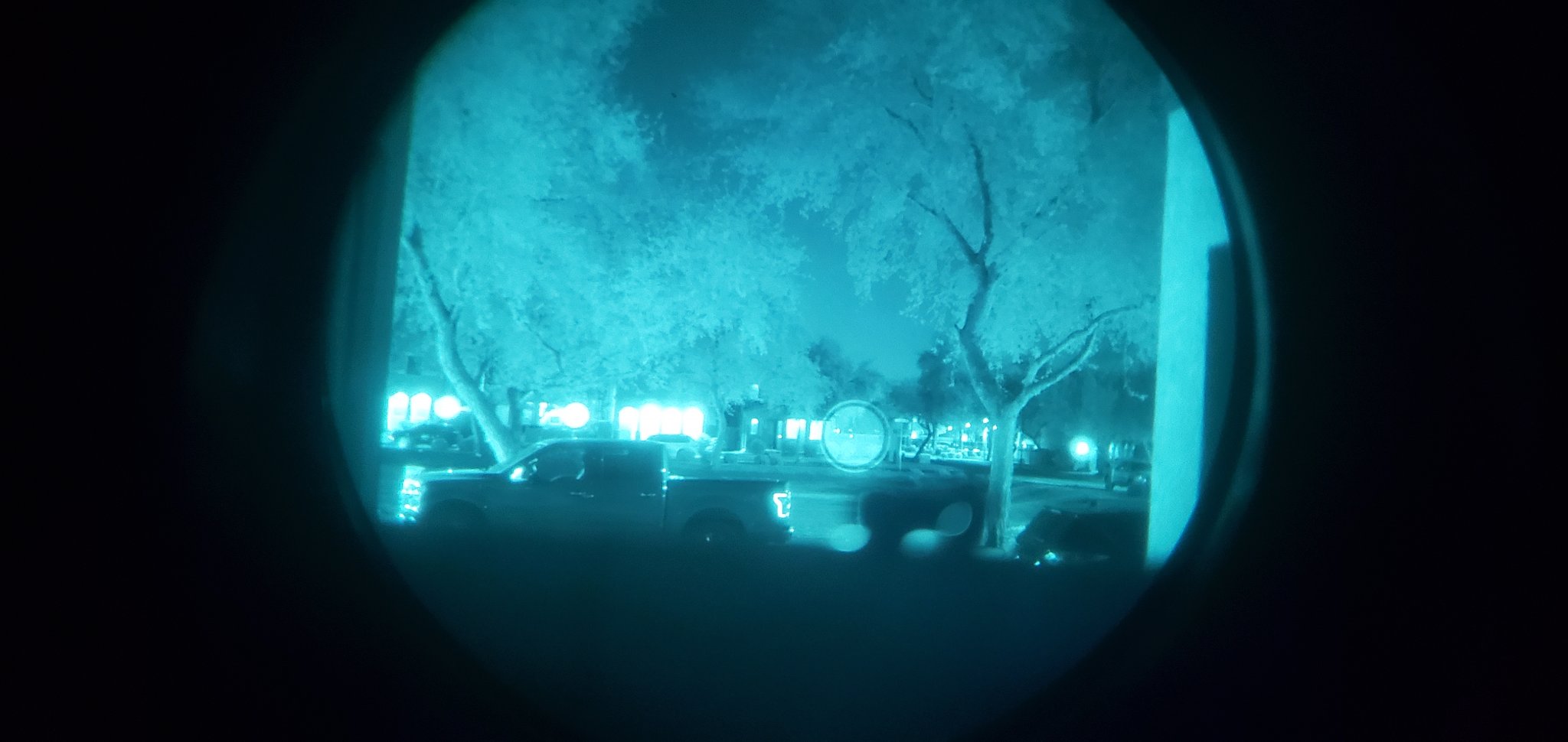

So...i use all this shit more than a lot.
I find that when I’m driving with NODS it takes me between a lot of high light and low light zones. And that I need an Echo to avoid having to use extra illum with some of the driving conditions I find myself in.
It’s better about that than my L3 stuff.
I was able to use them in bino mode ( l3 on the right and photonis left). The l3 did better low light and the photonis better in most other conditions.
Photos are: L3 moderate light, Omni VII moderate light/same scene, Echo extremely low light. Didn’t get the best focus on the echo for that pic.
I am satisfied/have been satisfied with any unit with more than 1800 or so FOM.
For my experiences, I want high SNR, rrs, good halo and EBI.
I find poor SNR and low res bother me the most.
I just got my photonis from Felipe several weeks ago... My omni 8 gp intensifier suffered a horrid death while i was showing off to my brother the glories of being a moon goon... Any ways the tube I had was f***** phenomenal... The photonis I have now is f****** phenominal as well It does well for anything I need to do under NV.. Thermal is the best way for any real detection and use NV for PID and traversing. My buddy will have a L3 Filmless and I will see if I can take pics to compare them but at the end of the day, unless your taking photos for astronomical or are in aviation any quality tube will suit you well. Photos attached are the tubes I had/have.

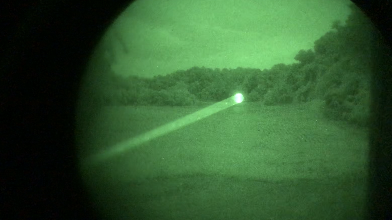

Here a photo of my DBAL 2 Illuminator and laser on high setting with an echo tube... This is in a urban neighborhood with alot of artifical light. When its pitch black out its almost like the 2nd coming of jesus.. ELIR Illumiator would be the first coming. (Shitty joke)
