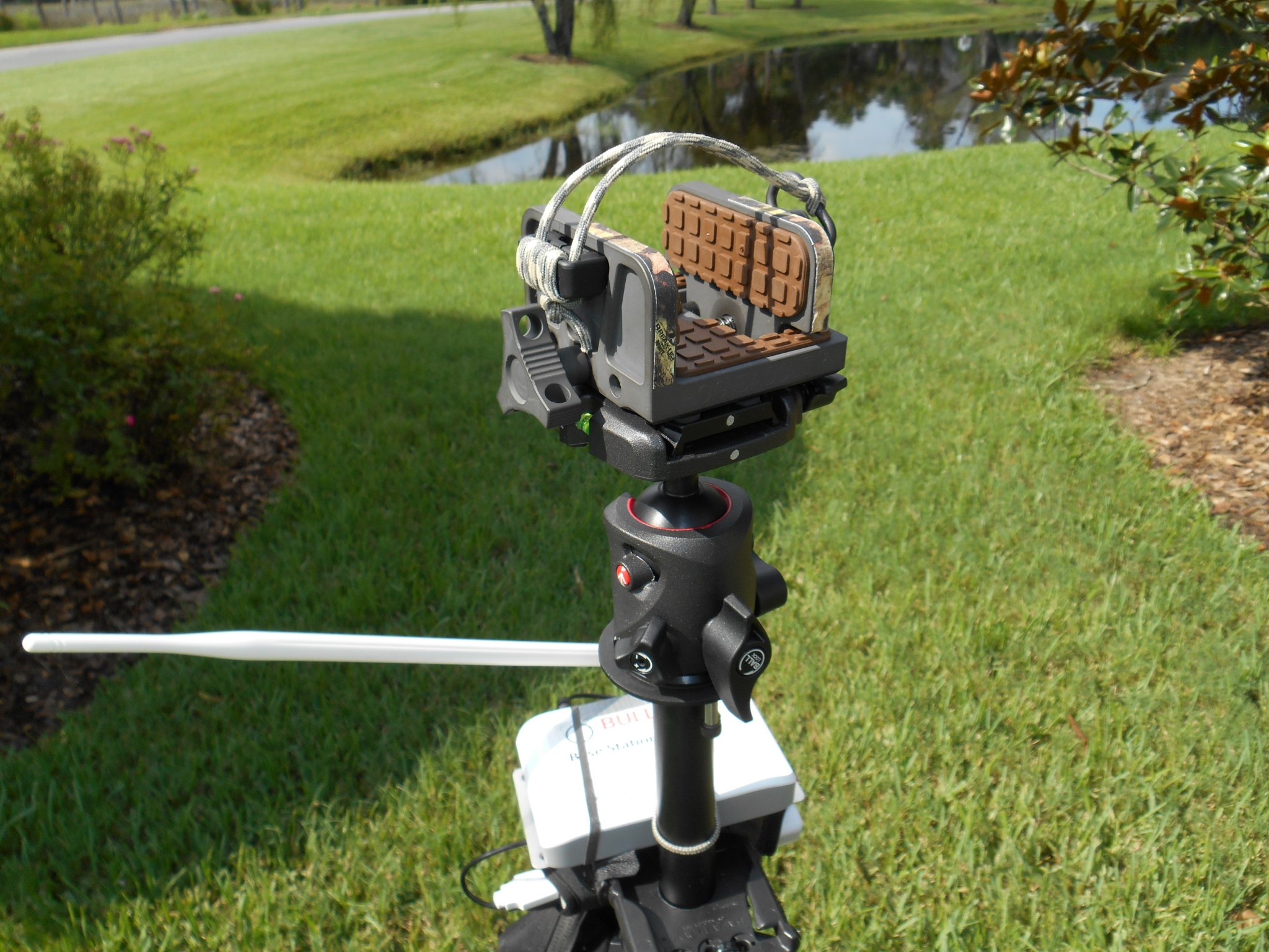

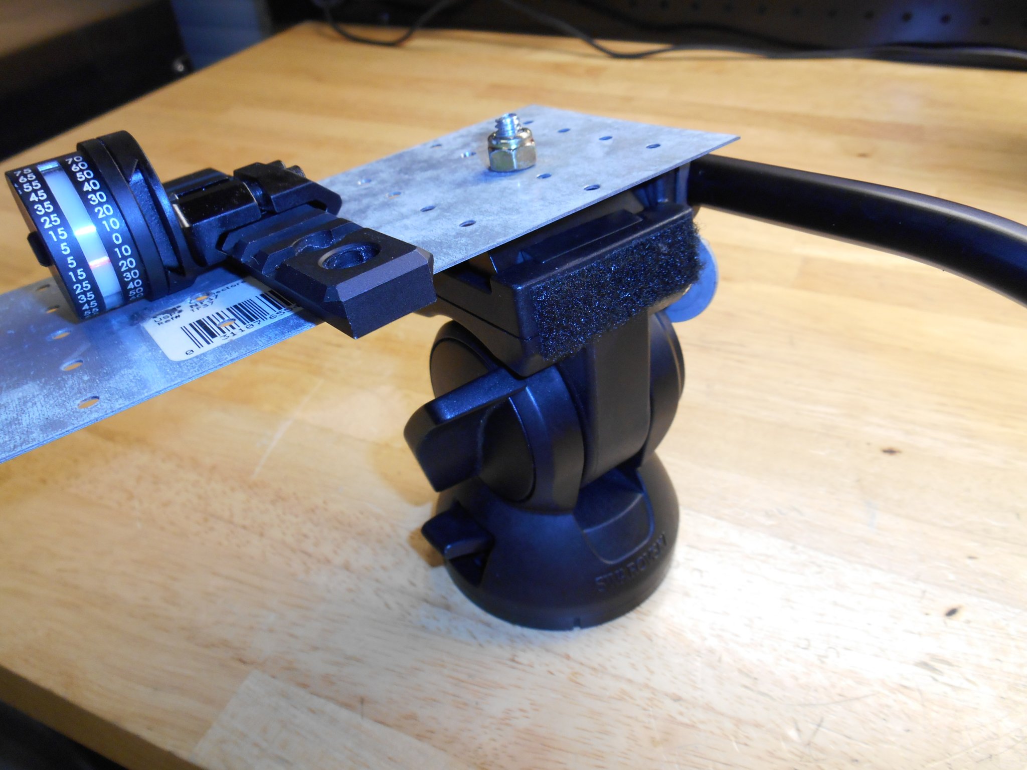

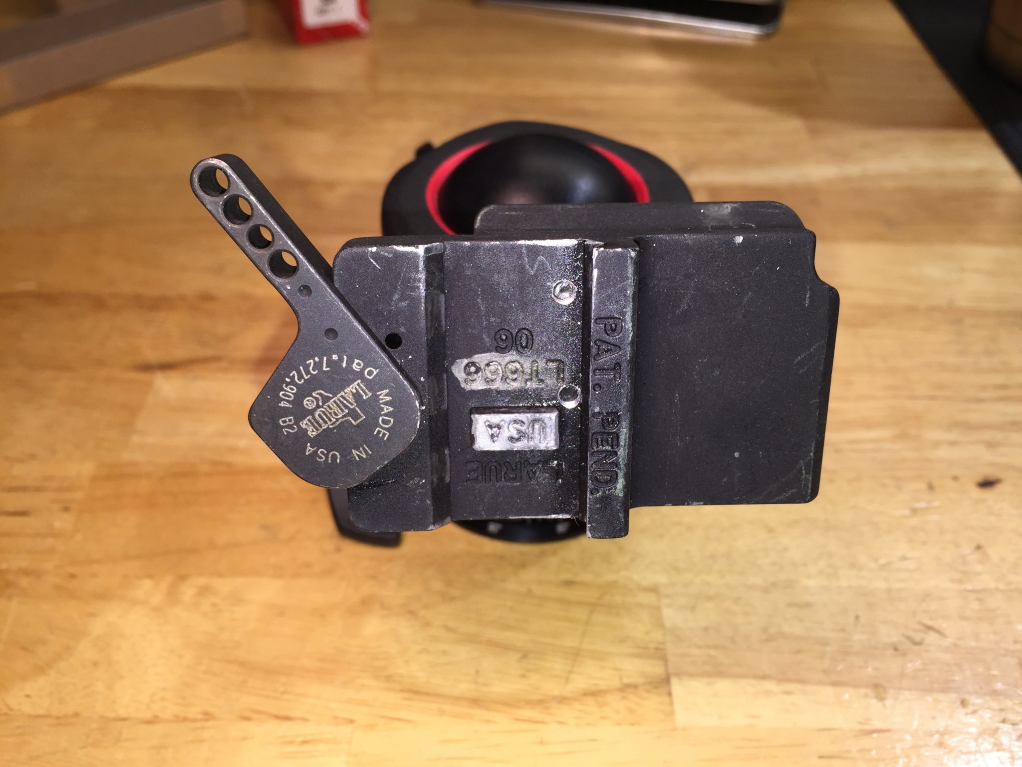

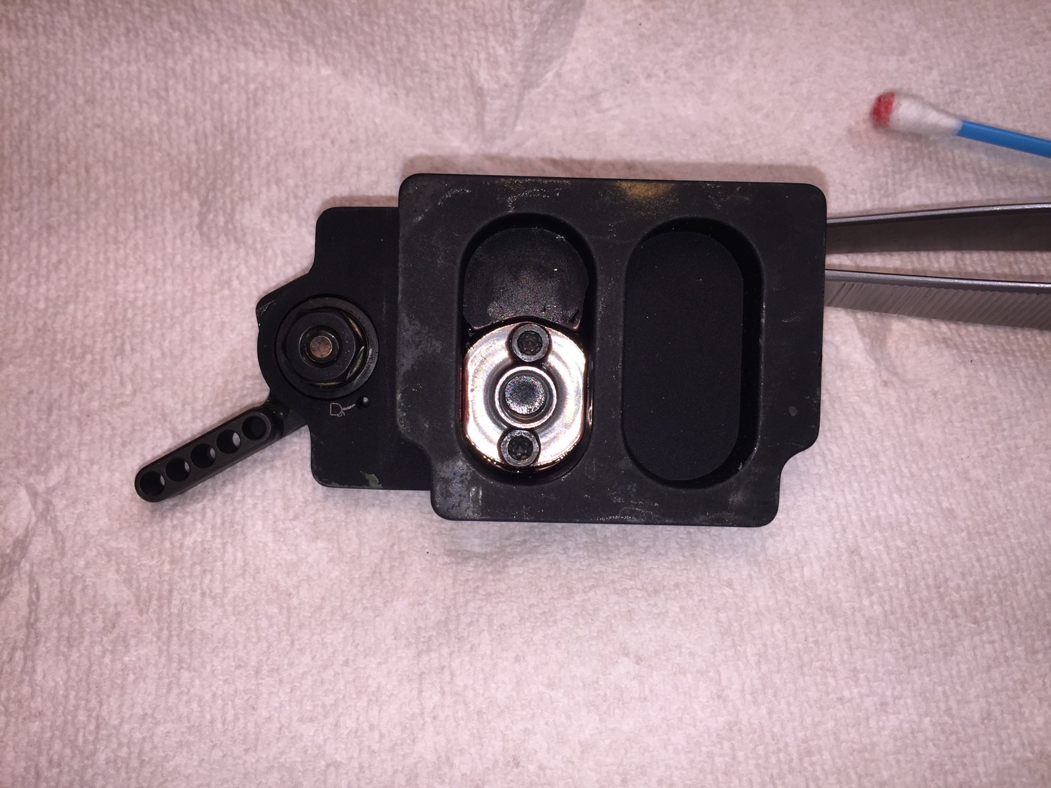

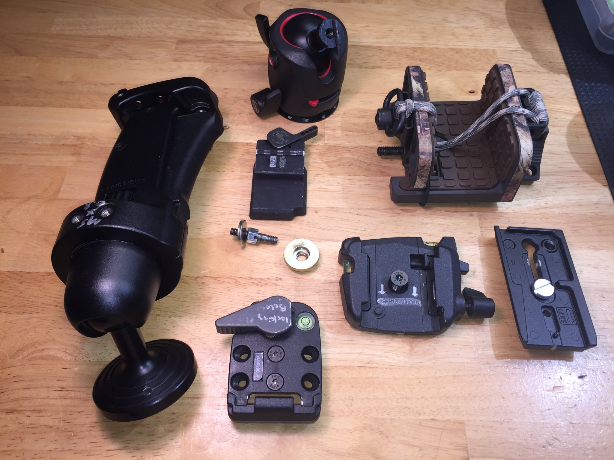

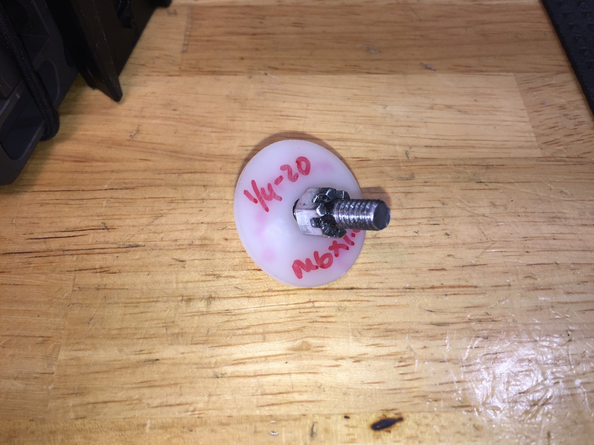

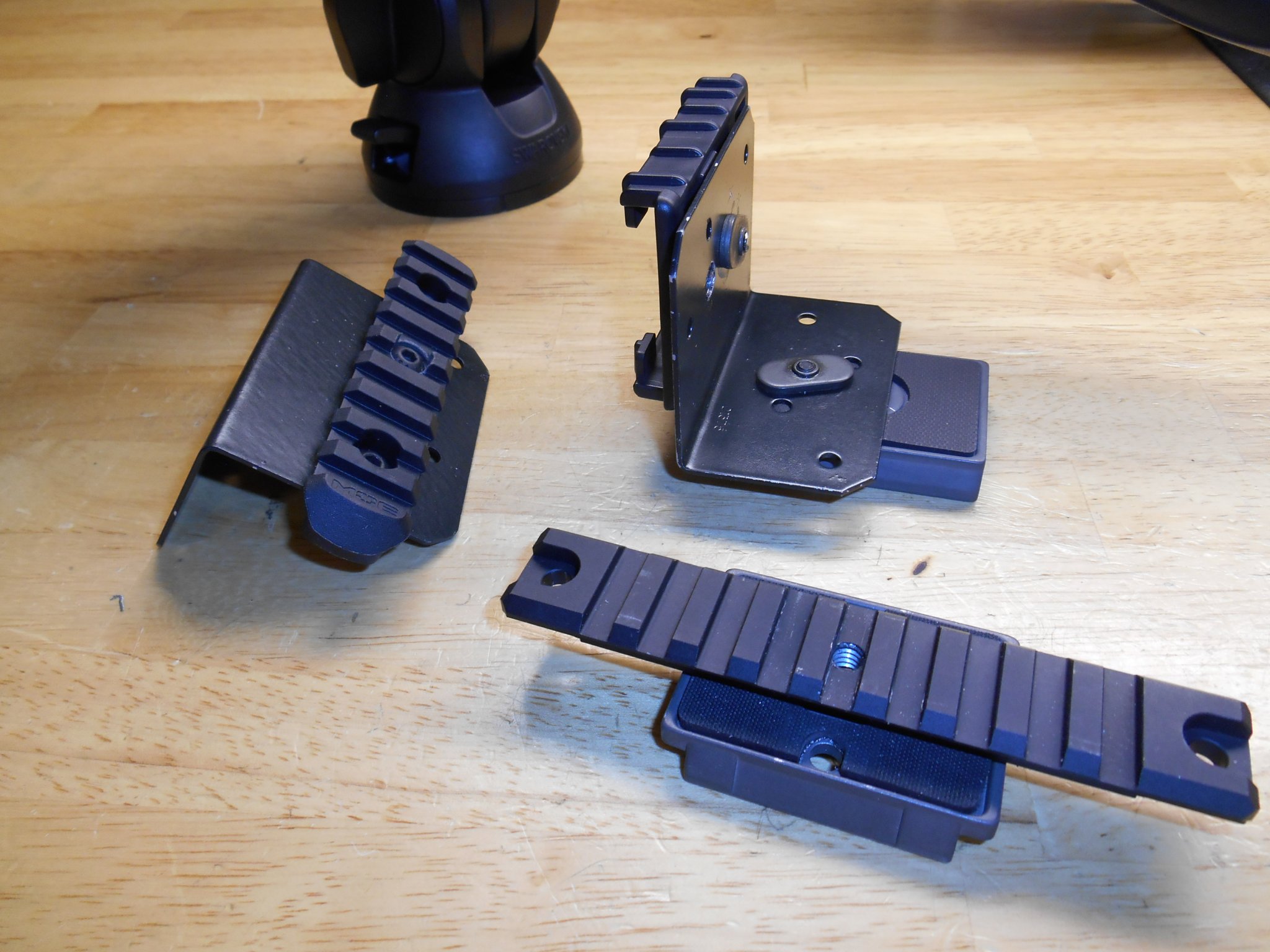

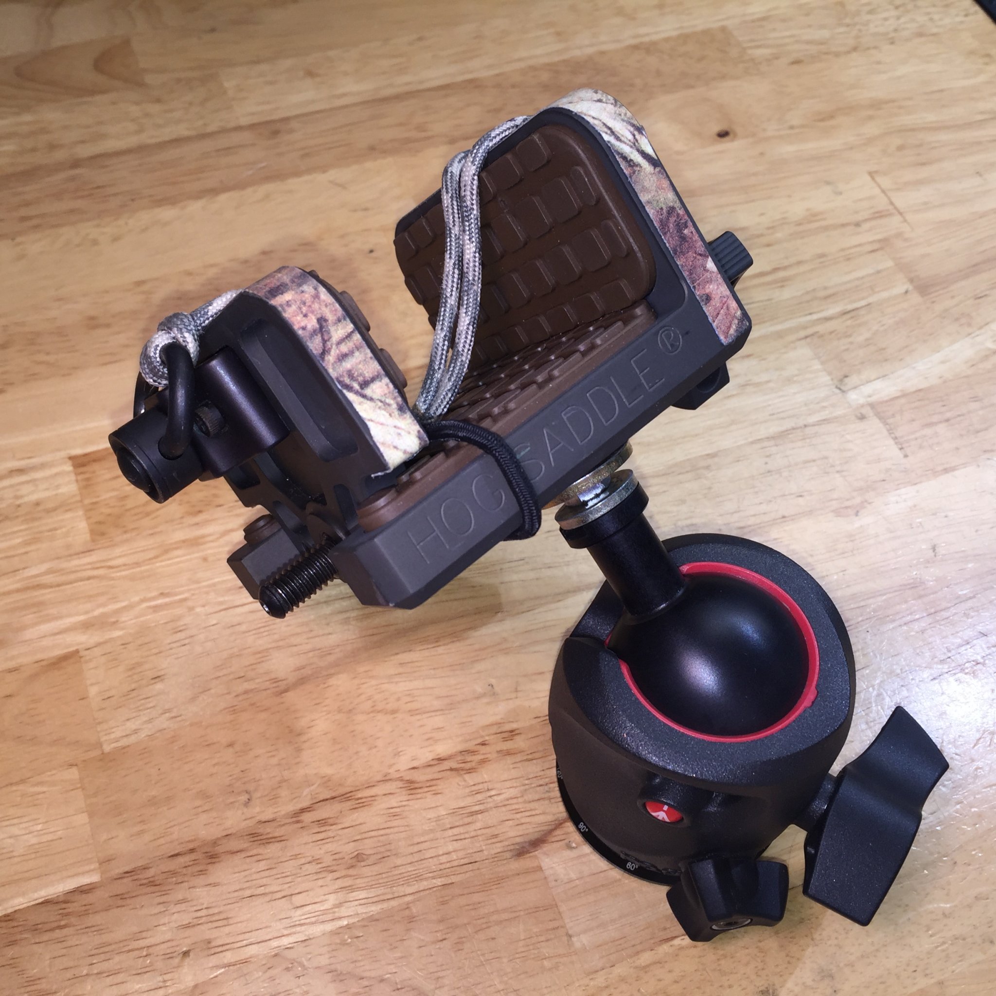

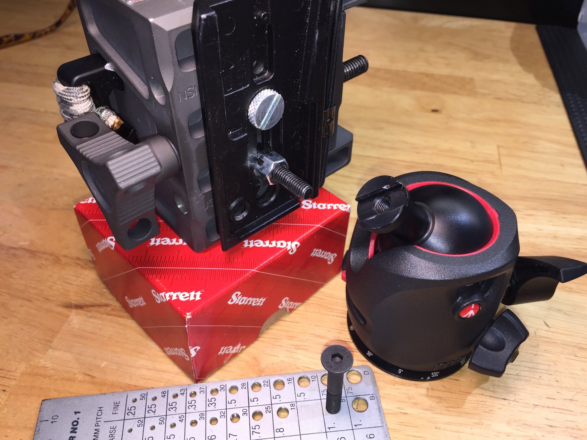

I mostly use RRS system now, but when Manfrotto's and HOG style were fashionable, I modified the connectors and mounts with
threaded inserts for QD assemblies. Maybe some of these might work with your project.

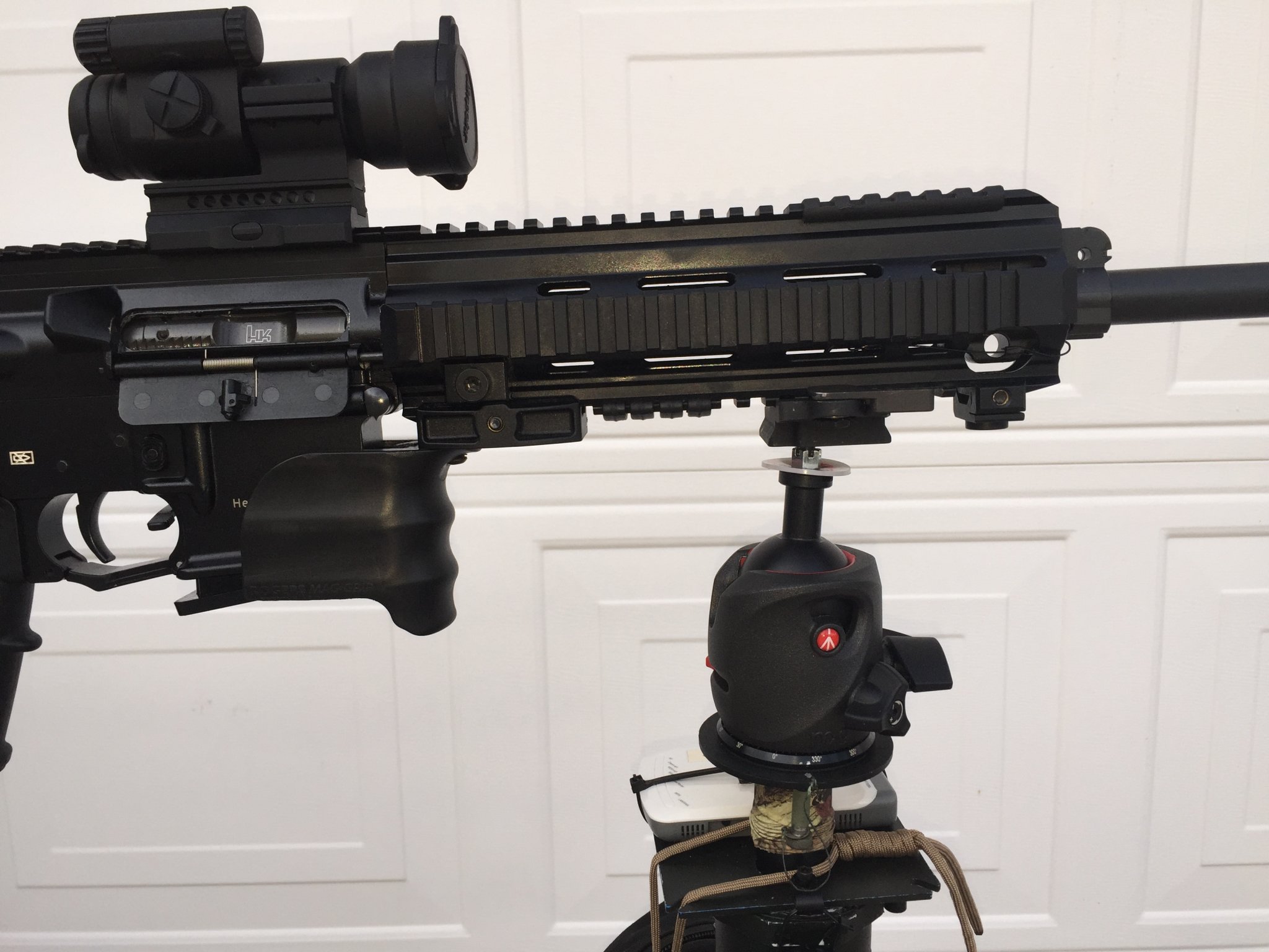

.....and some more. These galvanized plates are really strong and capable of being used for table top tripod mounting
for any picatinny QD mounting device to the rifle. The PDF describes how I modified the LaRue. A 2016 Hide thread on this topic. Will download to your desktop when the PDF icon is clicked.
