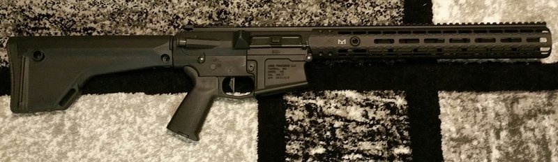

I have an M5E1 with SD-E trigger and dwilson bcg just waiting for a good 6.5 creedmoor barrel. I am not looking to go too heavy and would prefer to stay at 18-20" I was initially looking at BA 18" and 20" but I don't really care for the bull profile of them. Any suggestions for a 18-20" would be appreciated. I am currently leaning toward the Criterion barrels sold at Brownells due to their profile and reputation. Any help and suggestions would be appreciated.

I went with a Criterion 18" (2.7 lbs) and ordered a jp adjustable gas block to go with it. I have a feeling it will do what I want It to do. I had considered the BA barrels but the weight was more than I wanted on the front as this will not be a BR gun. If it does not shoot to my liking I will most likely get a Bartlein turned up in the profile I want. Can't wait to get it to assemble and test.

Got the barrel and gas block installed. Headspace checked out just fine. I will go to the range this week to adjust the gas setting and get a few rounds down range. Didn't realize how short the 18" would feel on the rifle but the balance and weight are pretty nice. I will throw a scope on it in a few weeks to break it in and shoot some groups.
