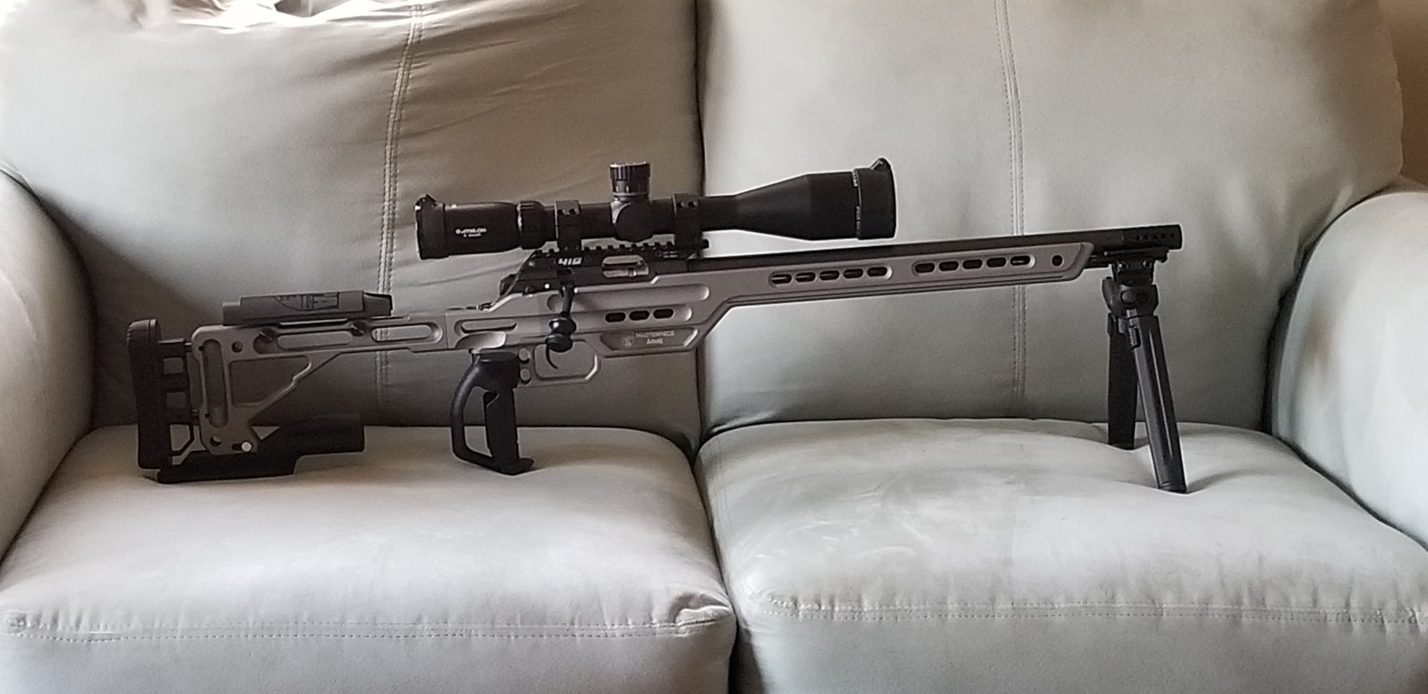

So did some work.
Polished up some areas on the bolt and got that nice and smooth.
3d printed a bolt disassembly tool and a single shot magazine for breach loading.
Lighted the trigger. Should I'm guessing we'll under 1lb. I need to get my gage back but my finger says it's under a lb. I'll confirm this when I get my gage back from my friend. This will be a dedicated target rifle so not worried about it being too light.
Lighted the striker spring. Action is nice and smooth and very light compared to stock. First try ran about 50 federals that I pulled the bulls out of. All primers went off. CCI nothing. So changed the spring and retested and all the federal went off as well as the cci. Strikes looks a little on the light side but should be fine. Looks similar to some other .22's I shot. but if I run into issues I have another spring that will fix that. Safety still works and is now much easier to work.
So I'm going to build this into a 100 yard rifle. Not going to go crazy into it ill keep it a modest build but it's just for some fun 50 yard competitions and poping Clay's at 100 yards.
Bipod I don't know. I have a Harris but considering a Sinclair F-Class. Probably just slap on the Harris and call it a day.
Scope. I got a spare Leupold Mark 4 LR/T I'll probably just toss on. I know it's a bit much for this but I got it and I'm not using. Still deciding on a mount.
Pillar and bedding soon. I'll be machineing up the pilars and doing all that this winter.
Hydo dip multicam? I wanna try dipping so figured why not. Maybe A-tacs or something like that. If I cant dip it I'll probably just paint it. I got a cutter to make my stencils. Probably won't use ceracoat some last time I did that it was extremely expensive and time consuming for multicam. Probably just clear coat it with ceracoat after I dip or paint. Not worried about durability since this is going to be a "precision" rifle. It's going to be treated like an egg with a crack like I do ally precision rifles.
Pretty happy with it. Excellent little rifle out of the box and with a few hours and some stuff most people probably already have you can really enhance it.
Reactions: 1911Operator

I think this was worth the wait. Feels like I got a really nice one. I'm going to make a 10 rounder and 3d print the mag body and falower. I got a sla printer so it's pretty good for stuff like that.
Did more polishing. Down to a 1um diamond lapping compound. At work we got compounds all the way down to 0.025um so this action will be pure butter. I gotta make this project last to atleast March lol.
Reactions: carbonbased
Trying to decide on what kind of camo I should go with. Probably going to dip this one. Figured it should not be to hard to do. Next week I'm going to work on the pilars. And get that all squared away.

Got bored at work today so I drew up a scope mount. Going to see how 3d printing it goes lol. This is a high-end SLA printer so not a hobby one.
Print it at 20um layer height. Dimensional accuracy is +/- .01mm so it should be ok. Resin is pretty strong and stuff. Definitely won't be permanent for the rifle but I'm bored and figured out I would try it out and if it works good for plinking toss it online. We got a lapping machine at work so I'll be lapping pretty much everything.

That's what I was hoping it was. What is the barrel length?
I said I wouldn't do this but I bought a NIB 457 Scout model last night for $314 shipped. My intentions are to turn it into something similar to yours and right now Anarchy Outdoors has that exact chassis for $768 shipped. Area 419 has Bartlein barrels for $495 shipped. I am surprised they use the Benz chamber though, which IMO is not optimal for a bolt gun. That's the expensive route, the cheaper route is the MDT LSS-RF chassis from Anarchy for $362 shipped + $40 for a grip and roughly $175 for an adjustable buttstock and tube. The MPA would be roughly $200 more, which may be worth it in the end. Barrel on the cheap would be a Lothar-Walther for $300+shipping. So high side is $1,263 and low side is roughly $892.
