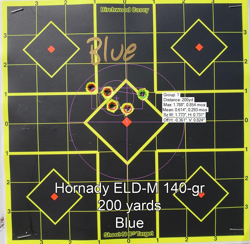

    OK… the actual question: When evaluating the LDP #1, should I be looking for the smallest VERTICAL spread instead of the overall group? For the LDP #1, I chose the GREEN load over the BLUE load (and the other three). Perhaps the BLUE is better? (target photos below)

    I like to look at group size. I also do that step at a distance of 100 yds. I believe there is less chance of the wind moving the bullet.
    If you were looking for vertical dispersion I think you have to do that at longer distances.
    Yes... Copper Creek recommends doing it at 200 - 400 yards. Local range availability is scarce.... once a month 100 and 200 yards... one per quarter at 300 yards. In this case, I did the test at 200 yards. Thanks for your comments!

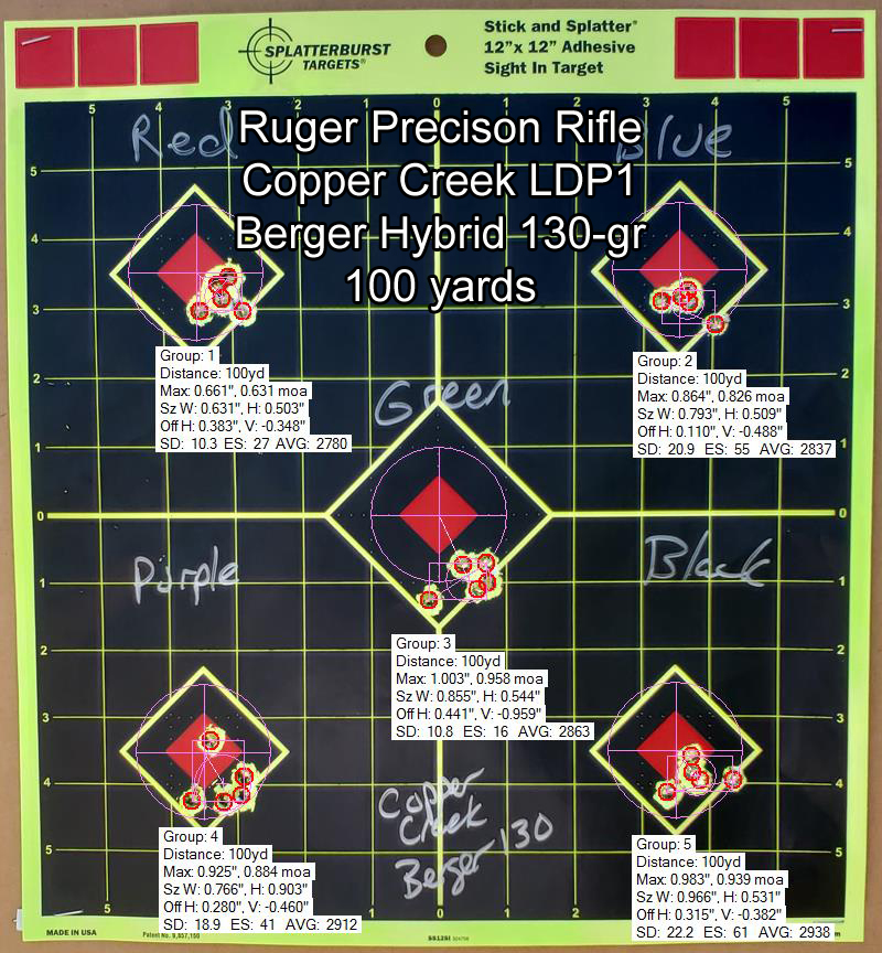

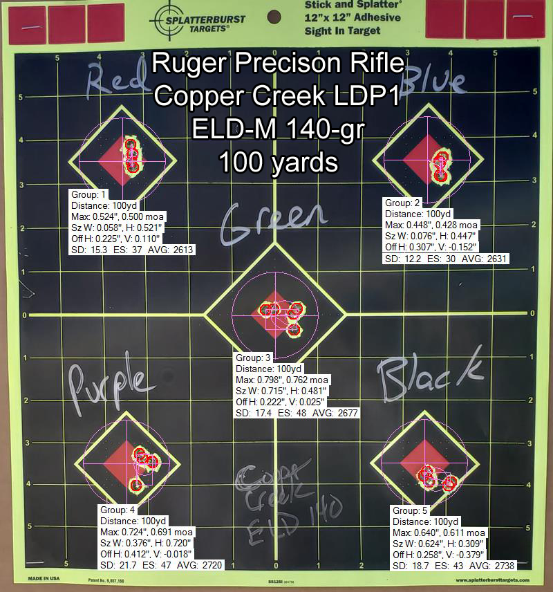

    OK... Made it to the range with two new LDP #1s from Copper Creek. Since I was having some good groups with factory Federal Gold Medal Berger Hybrid 130-gr ammo, I got one LDP with that bullet. The other was Hornady's ELD-M 140-gr. I was half-expecting the Berger to win. But, overall, I'd say the ELD-M won again. Now... which ELD-M load? Hmmmm....
    The chrono data (MagnetoSpeed) for each group is on the last line of each group analysis annotation.

    Hornady ELD-M 140-gr
    The next step of the load packs where they adjust the seating depth can help with the s.d.'s.
    Reactions: Racer88
    Is it the loads causing the high SD and ES or is it a shot out barrel? The next barrel i shoot out I will chrono my known load on it before I pull it. See what the SD and ES look like.

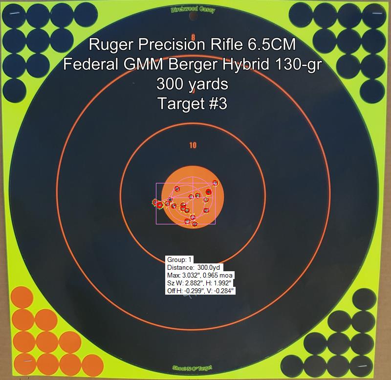

    As of today, the barrel has 2,440 rounds through it. But, it's still shooting sub-MOA. Even sub-1/2-MOA at shorter distances (100 / 200 yards). Here's my best group at 300 yards today. Factory ammo! I was quite pleased to shoot sub-MOA at 300 yards.
    At what point do I know if the barrel is "shot out?" I think the barrel is still capable of better groups than I am. :)
    glad it is still shooting. at some point the accuracy and velocity will drop off. then you know. sometimes its a rapid drop, sometimes slow, but you will know,
