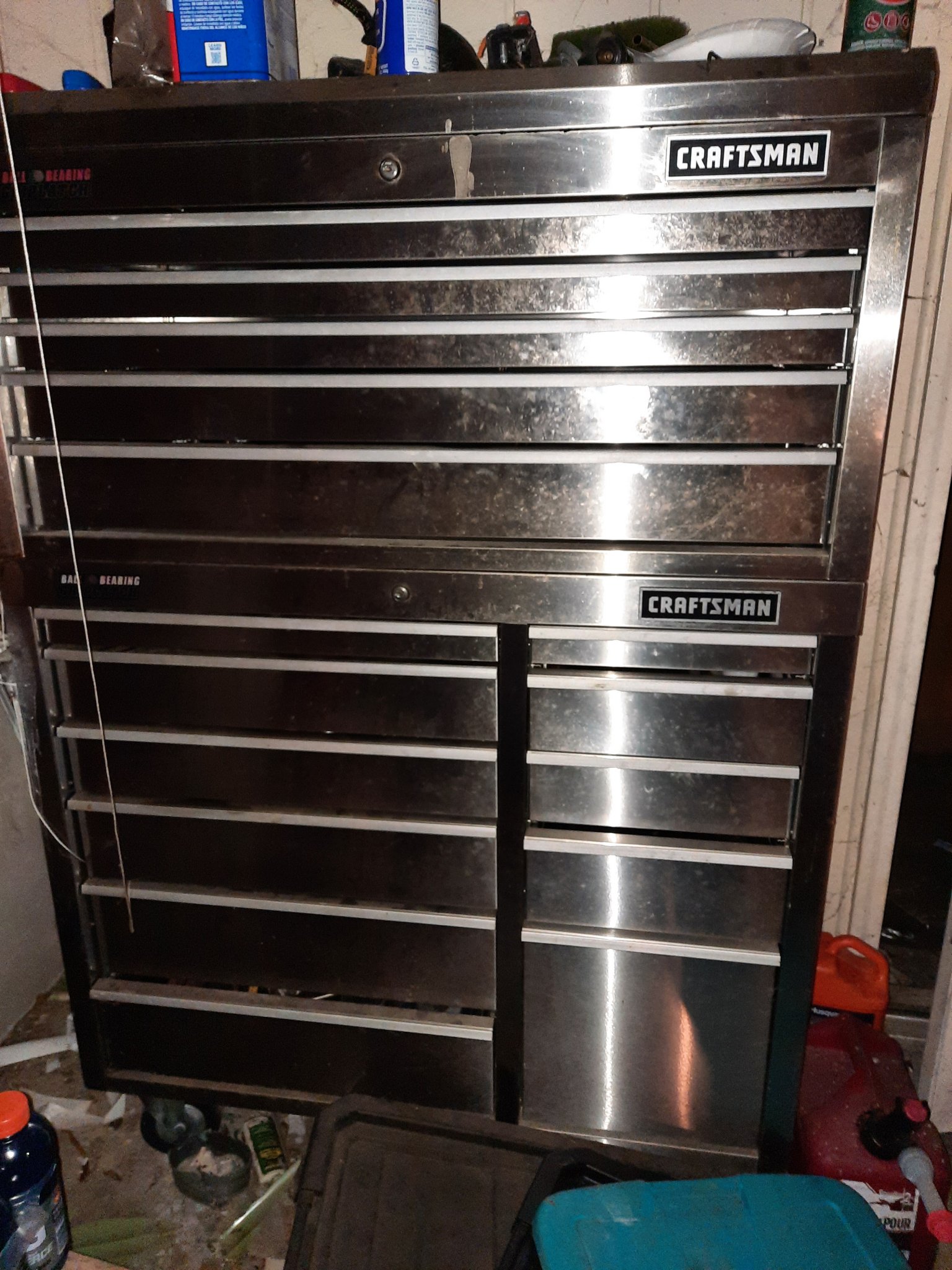

Hollow ground screw driver bits, brass and soft faced hammer. You can't have have too many tools. Brass punches,
steel punches. The list is too extensive to list. Always buy quality tools, they will last your entire life.
