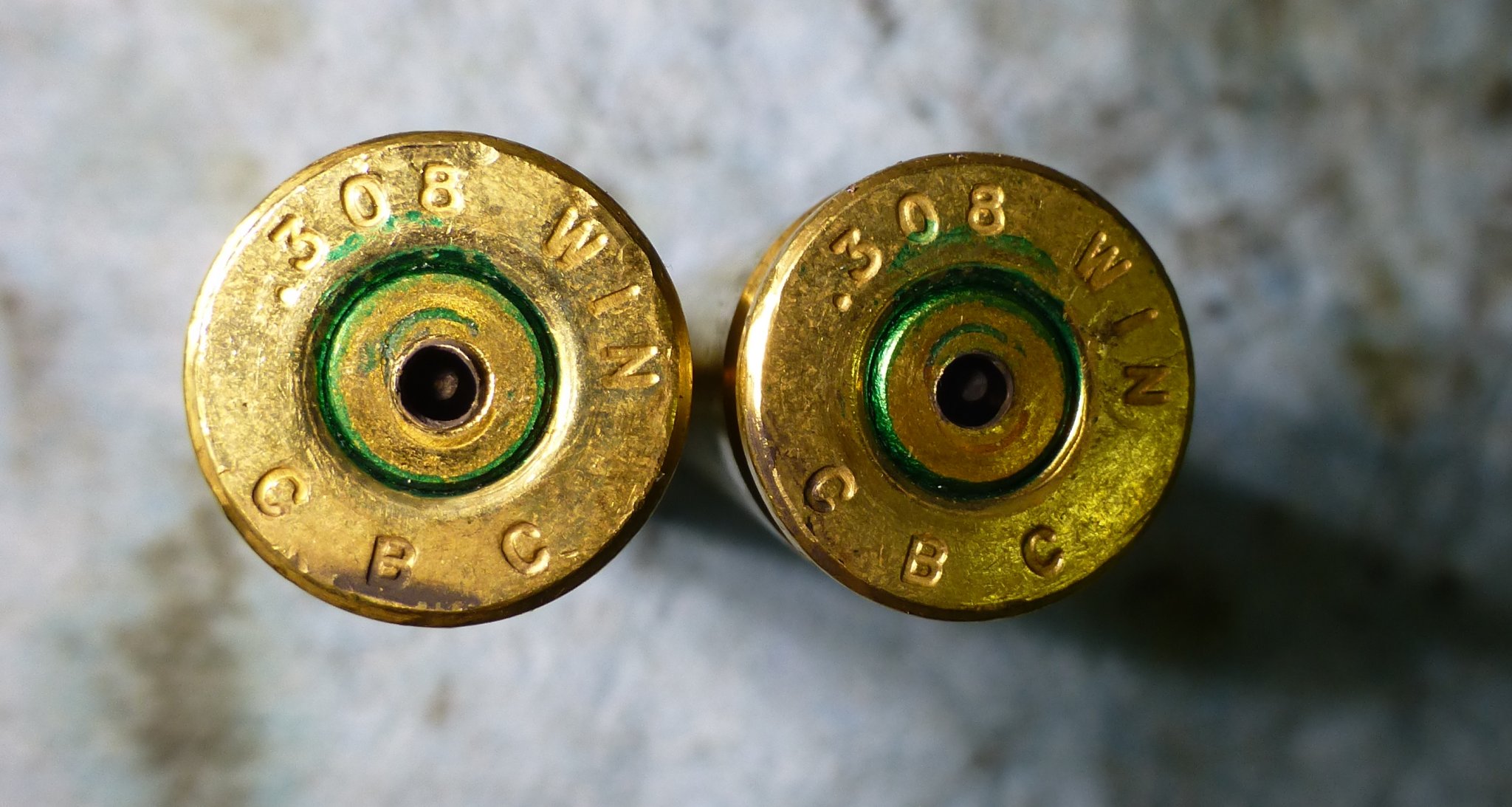

My Aero AR-10 in 308 is experiencing some pierced primers, with factory ammo, not handloads. MAGTECH 308 168gr HPBT.
I did check the headspace with GO, NO-GO gauges at assembly and it checked out good. It's got an Aero NIB bolt, and using wire-size drills as gauges, the firing pin hole checks out at 0.081", and the tip of the firing pin is about .0780". It's killed 1 firing pin already. Is it the ammo? "thin primer cup"?
I examined the tip of the replacement firing pin, and it's got a nice radius to it, still smooth, but I already had another pierced primer with the replacement FP. The primer is still in the brass, it's just got a hole in it.
Also have a Geissele HS-NM trigger in it. 24" Brownells/Satern barrel. I didn't have this occur at all when I was shooting M80 ball ammo.
I noticed that in comparison, my Aero nitride 308 BCG has the high-pressure version firing pin & bolt, I think that's what it's called, nominal .070" aperture, .067" firing pin tip. Wondering if I should switch out the bolt to this HP version. I would like my firing pin to last more than 1 box of ammo.

Since you have changed firing pins the bolt would be suspect as to having too much pin protruding. The primers look penatrated very deeply to me.
Imho that is very deep.
Edit] since no problems with other ammo like @rcmigpilot said bad primers may be a better case.

Interesting the case head pics don't show typical over pressure signs... ejector smear, and harsh extractor claw abused case rims.
Maybe your batch of CBC ammo has thin primer cups.
Or like speculated, your FP protrusion is excessive.
Firing pin protrusion on the original Aero 308 bolt is .040". not sure what the spec is...
Firing pin protrusion on the replacement HP bolt with the skinny FP is surprisingly .045". Replacement bolt is from Rubber City Armory.
I didn't have any more pierced primers with the replacement HP bolt, using ammo from the same case, same ID numbers on the boxes. I'll probably leave the HP bolt in the bolt carrier for this upper, although at this point, I'm guessing some defective primers were in that batch.
