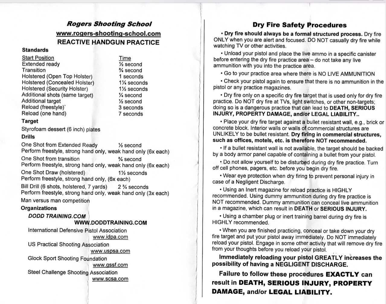

That said, I don't put a ton of stock in stand and shoot skills.
This.
