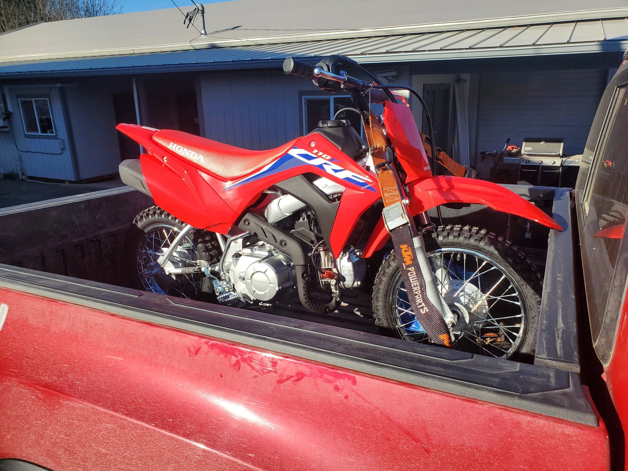

I cannot tell you how much I dislike his ttr50. I bought one back in the day for my oldest boy and swore never again but covid hit and I couldn't find a Honda. So the dealer is going give me my money back on it as a trade for something else. He sells Honda and KTM so I put my name on a crf110. But still would like to built the 50 as the project.

Pick up the new 110 and be done with it...electric start, low maintenance, aftermarket accessories, and the highest resale value of any bike on the market.

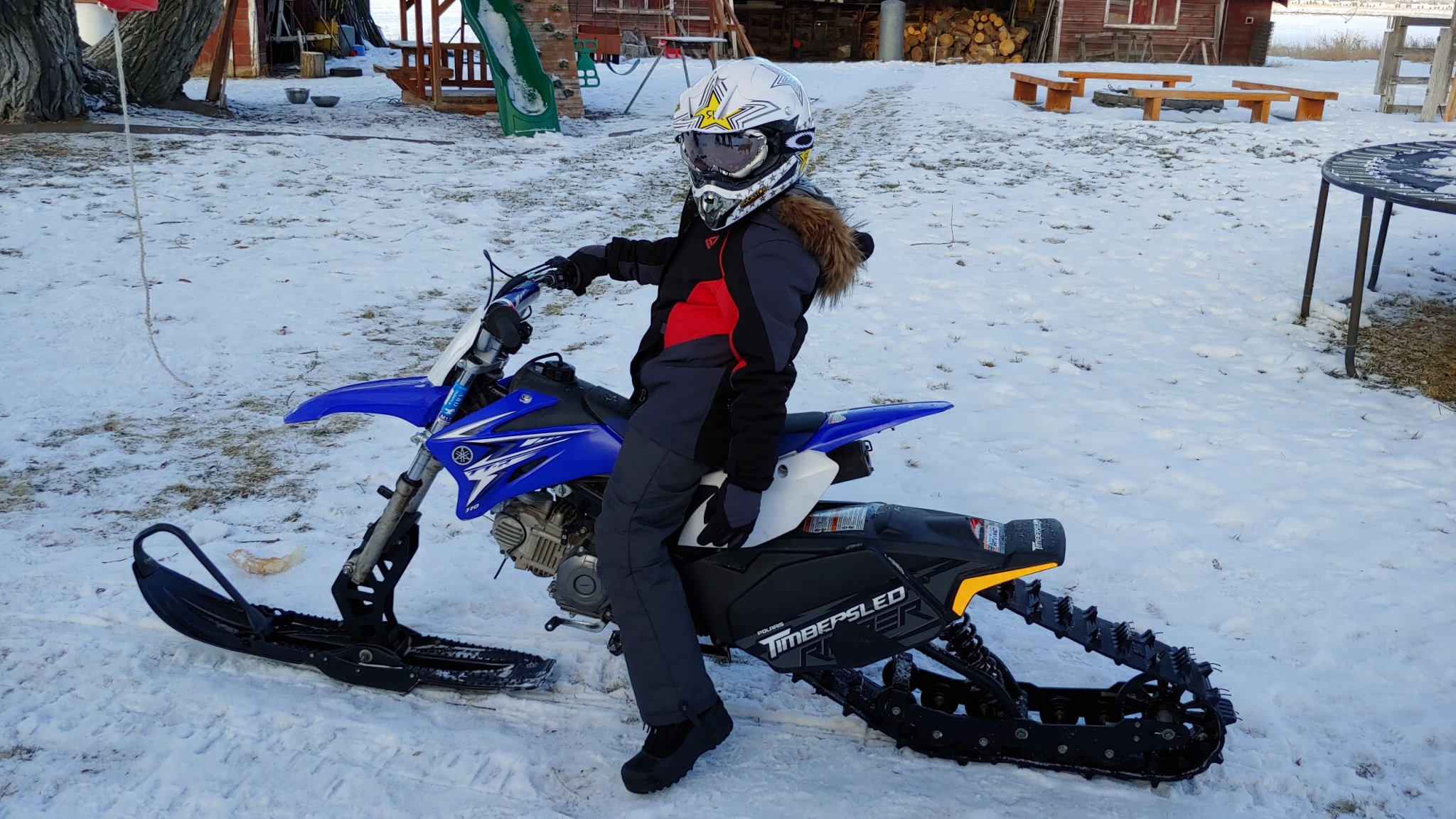

My son has been on a 110 for the past three years and is small for his age(11). It's been an excellent bike for the trails and passable for motorcross(two blown fork seals). Last winter I even threw on a timbersled kit...couldn't keep him off it!
That’s bad ass! I didn’t know they made a Timbersled for the 110s.
Does the stock bike have the power to move it pretty well?
With over a foot of fresh powder on a packed base, he had no issues holding 3rd gear on level ground. I could dig up some video but I don't want to derail the OP's thread... there should be some footage on YouTube. I just wanted to point out some of the perks of owning a modern 110.
