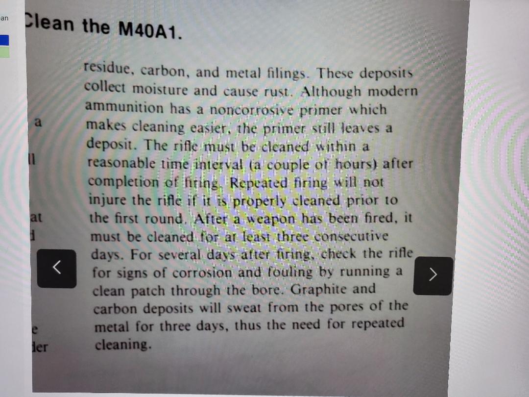

Attached is a page out of the M40a1 manual. Someone else posted this a few months back on a cleaning topic and I saved a copy.
Read the first sentence at the top of the page. The priming compounds etc... will cause rust/corrosion. So stainless steel barrels will not get that reddish type rust but they will/still can corrode/pit!

One of the things I've always said is that a barrel will sweat and boom....here it is in black and white. Sorry for the squiggly yellow lines. Not sure where that came from.
Every time you fire the gun....when the bullet leaves the barrel it creates a vacuum and sucks in the outside air. Moisture etc... then put it away dirty and the bore is still sitting there in the humidity etc... and after x amount of time presto. Corrosion. All those chemicals, copper fouling, powder fouling the moisture are going to work on one another.
