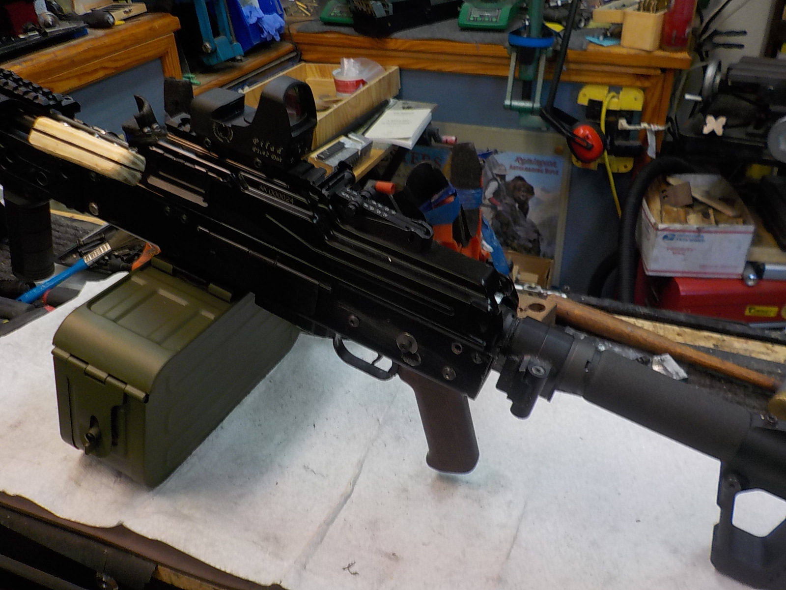

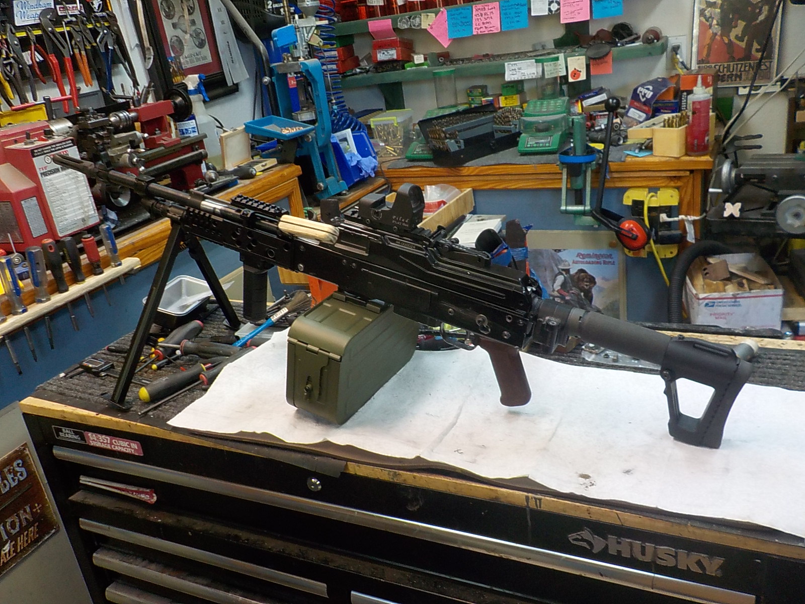

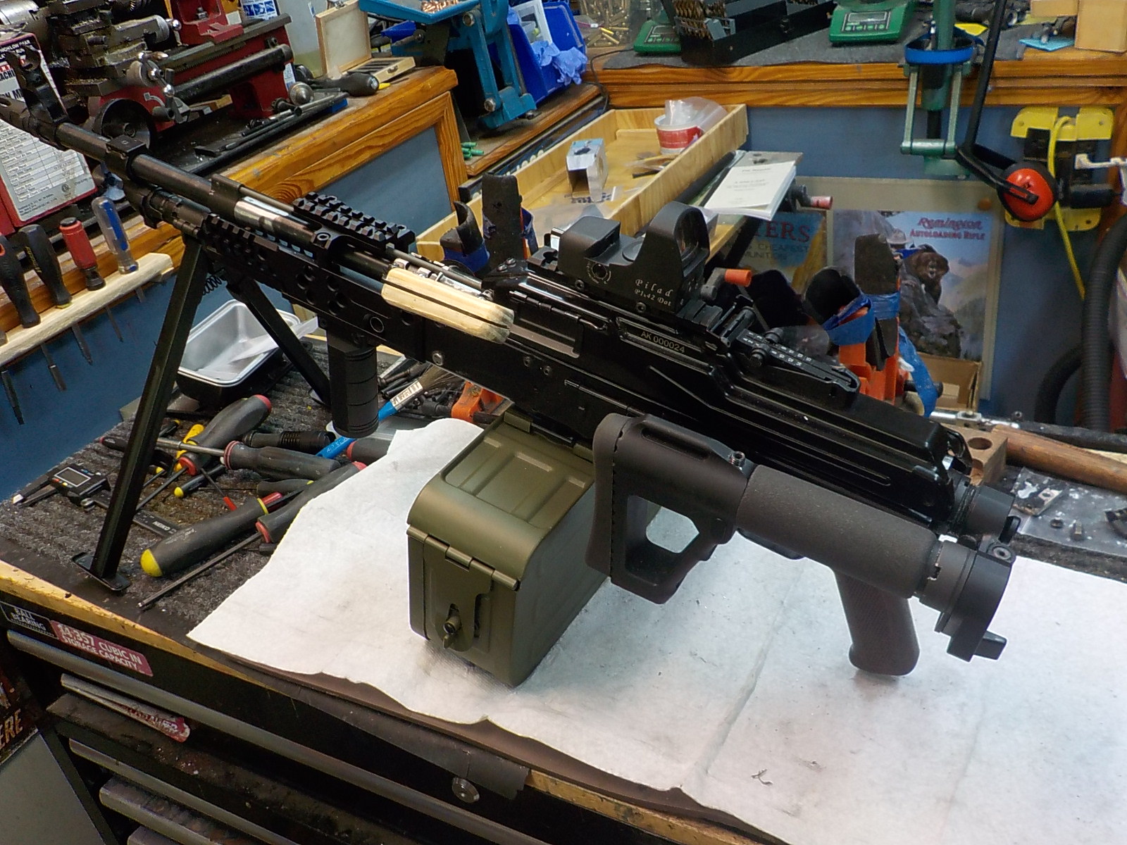

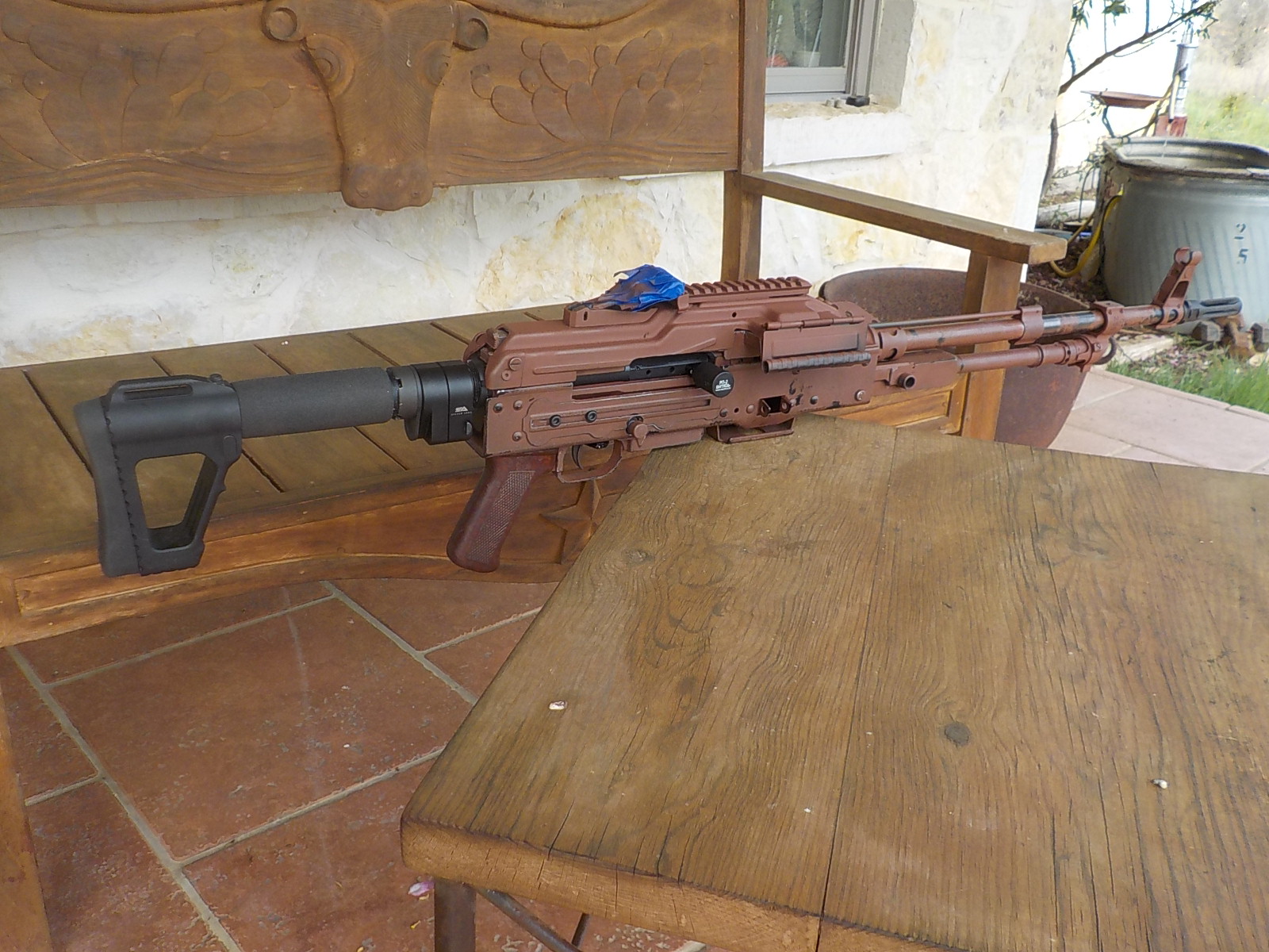

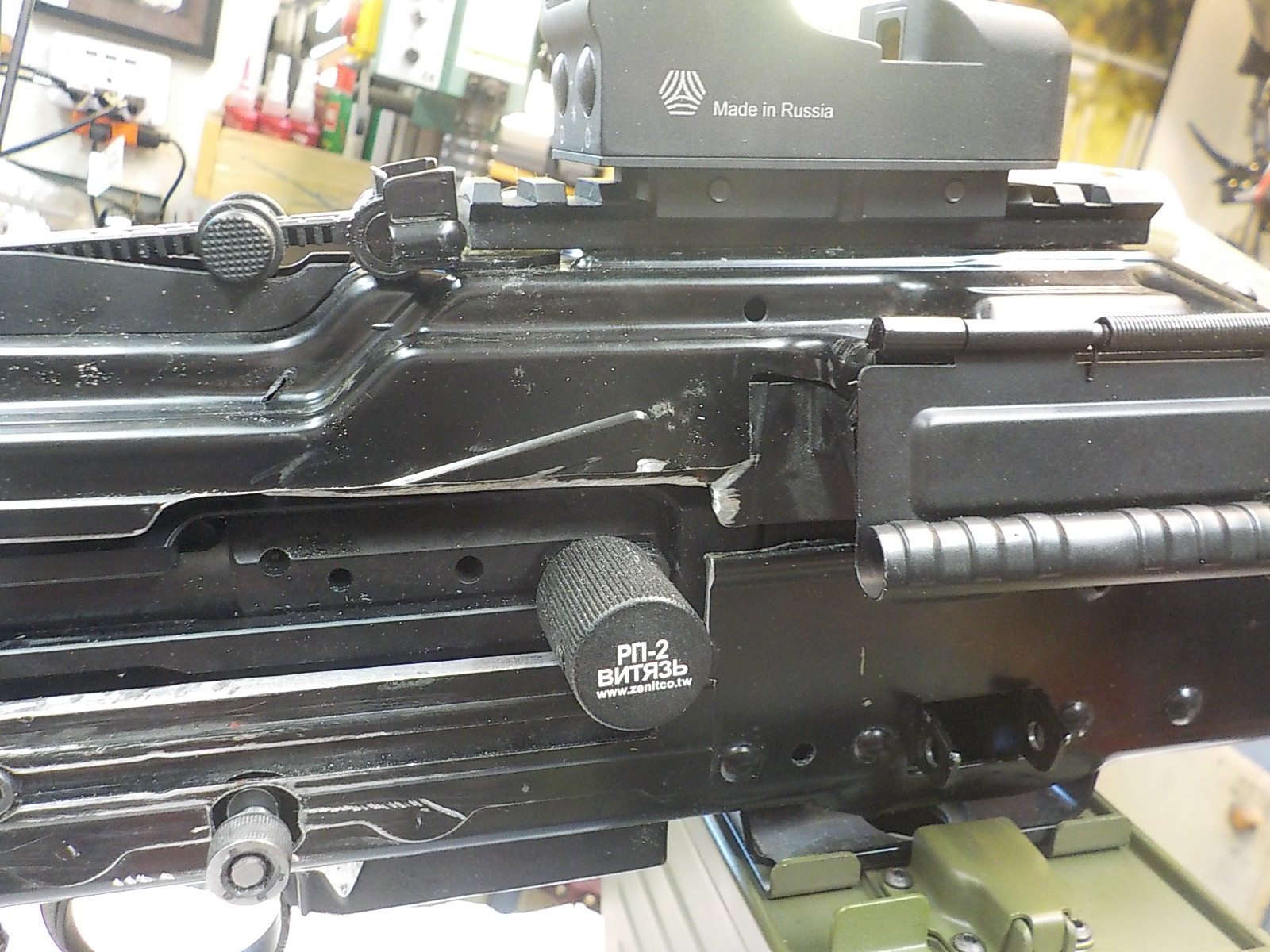

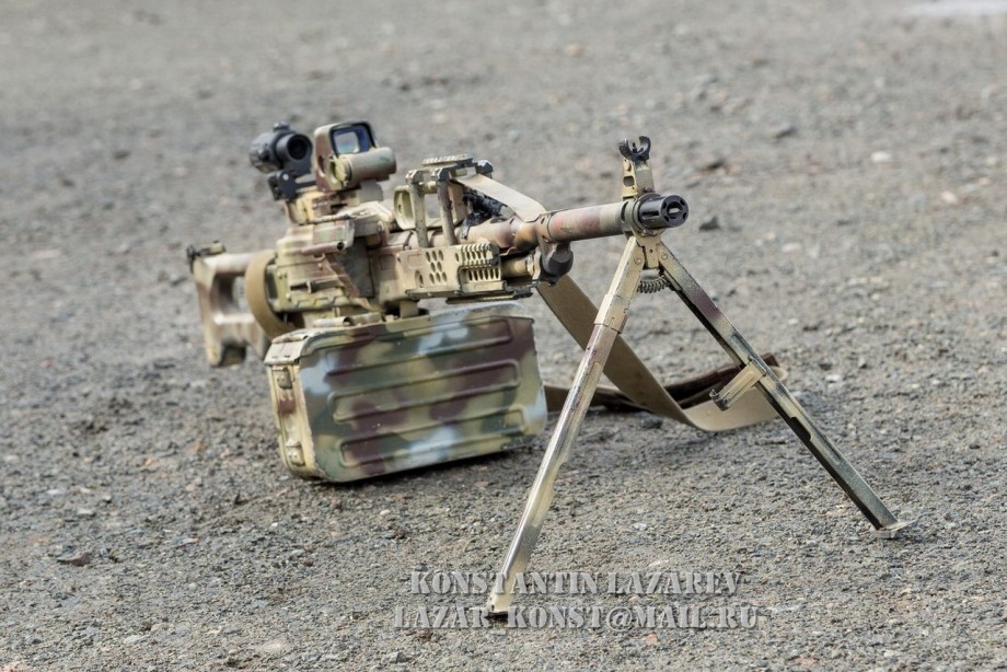

    I'm in the process of getting all the parts together to build a semi-auto PKM. As part of the process I am building a "PKM" based on an AR-15. It will be magazine fed and in 5.56 and just look like a PKM. The gun utilizes a side charging upper and a lower with a Frankling Binary trigger. 20" 1-7 barrel, rifle length gas system, ACE SOPMOD doorbuster folding stock and Russian PK-01 red dot.

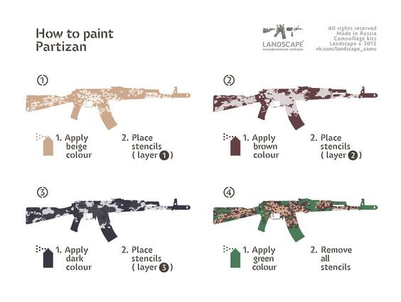

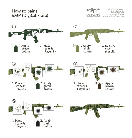

    Coming along rather nicely. I'm going to experiment with different Russian Camo schemes on this one and am leaning toward Russian "Partizan" camo and maybe do it in dark grey and dark blue.

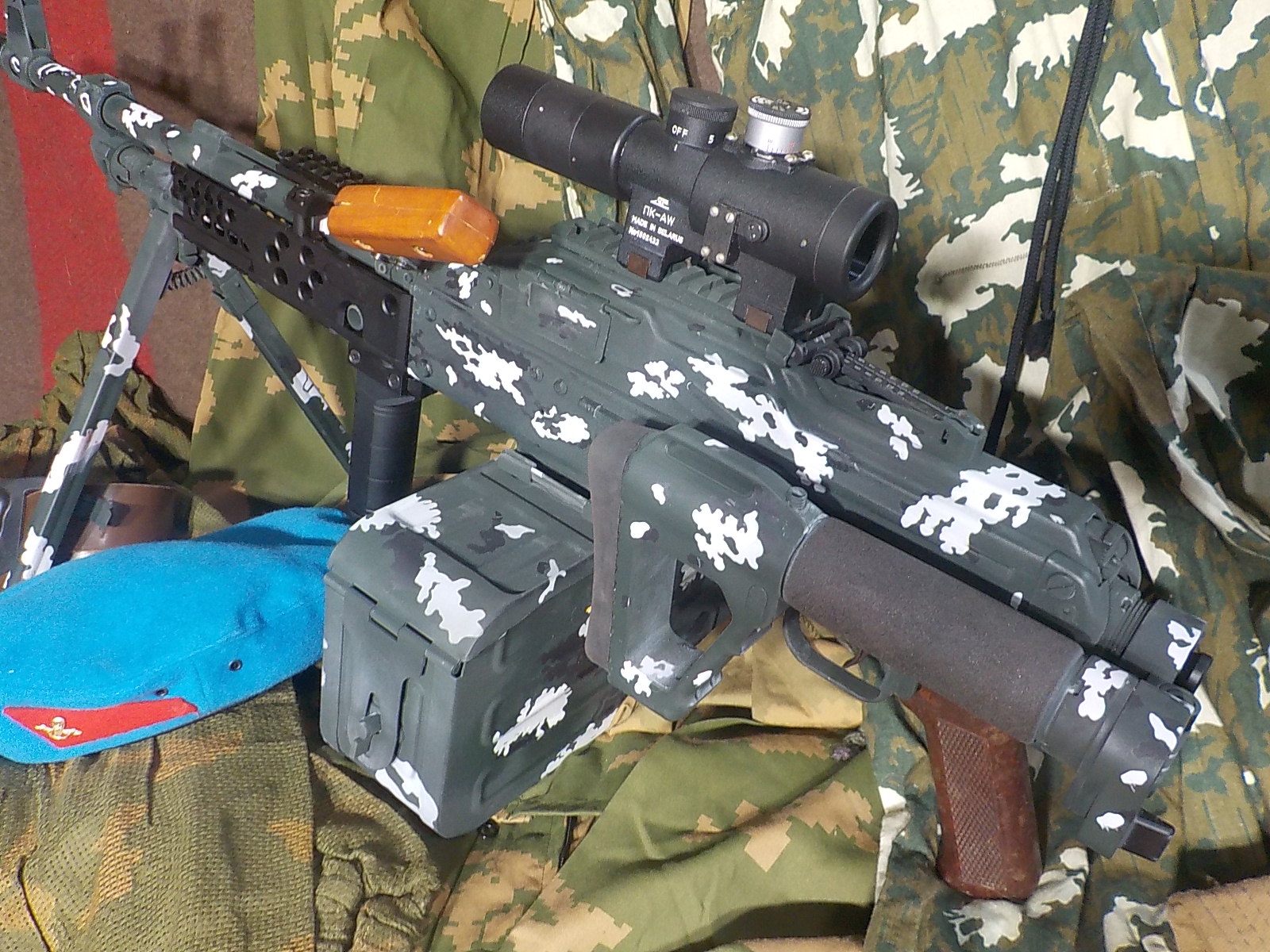

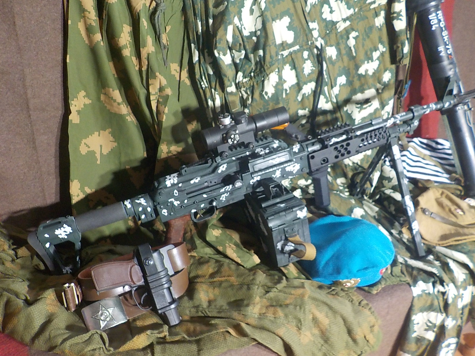

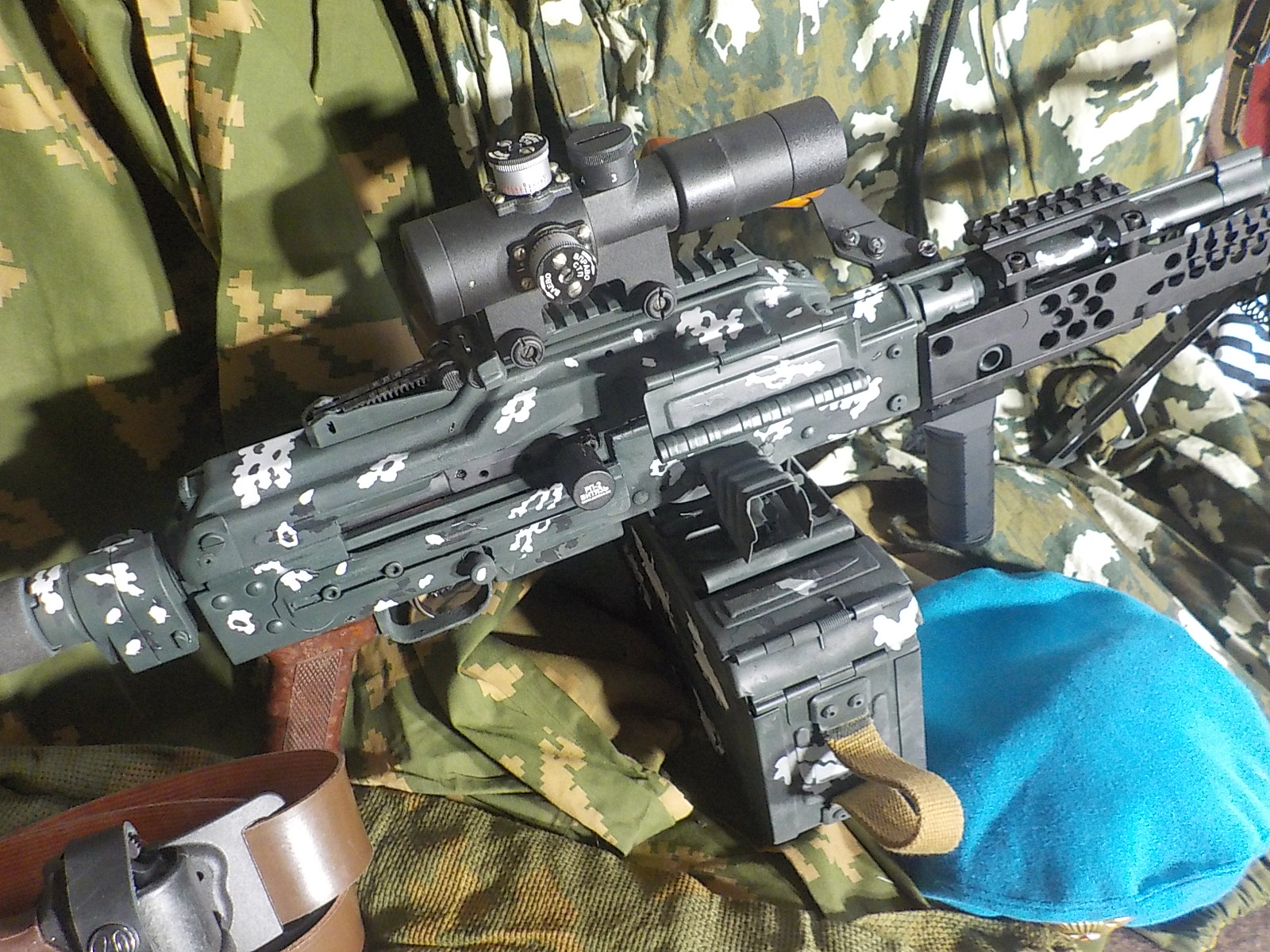

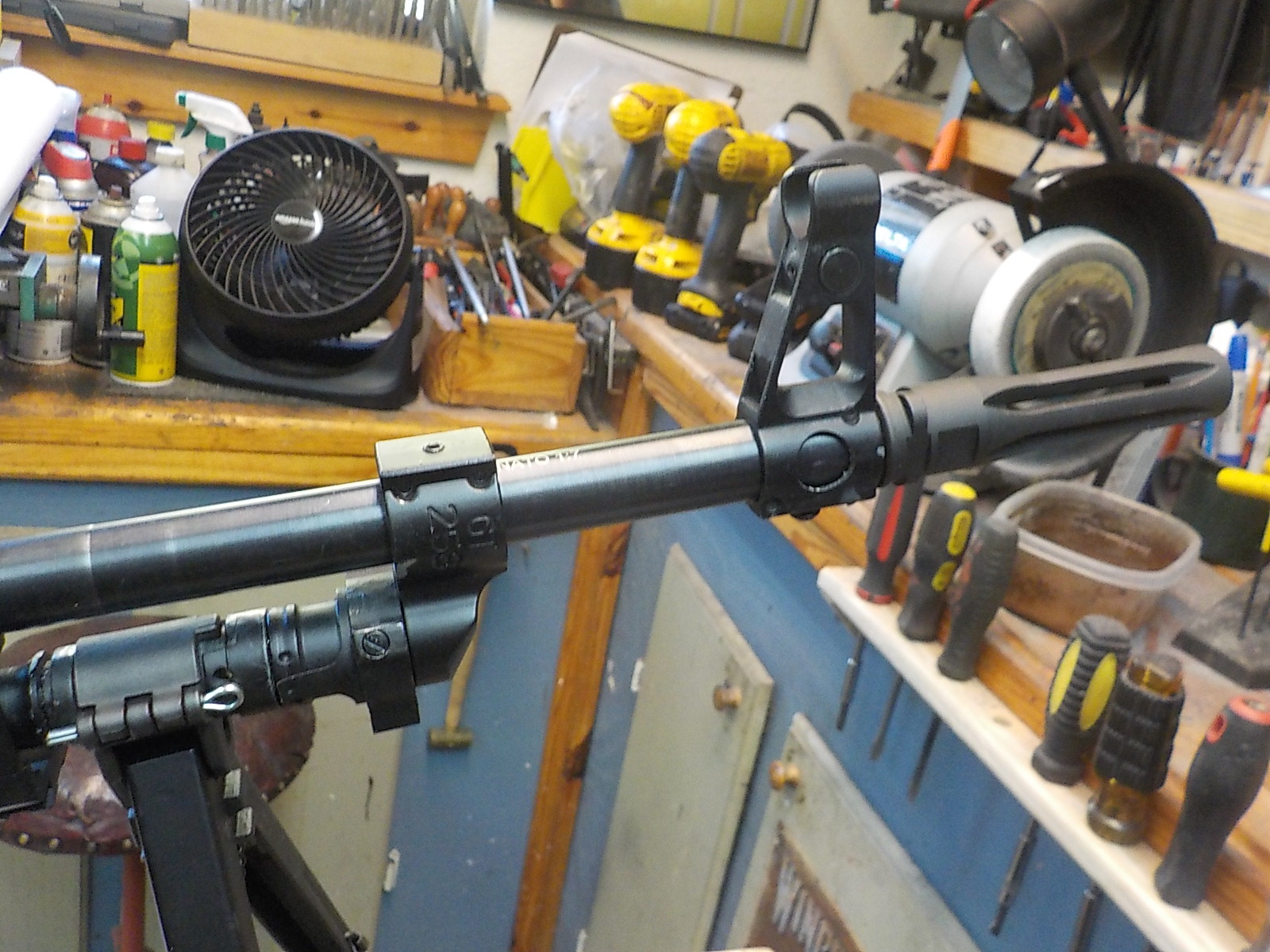

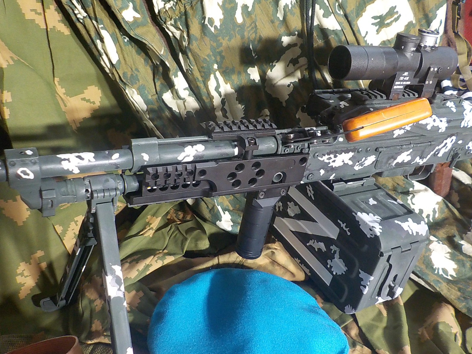

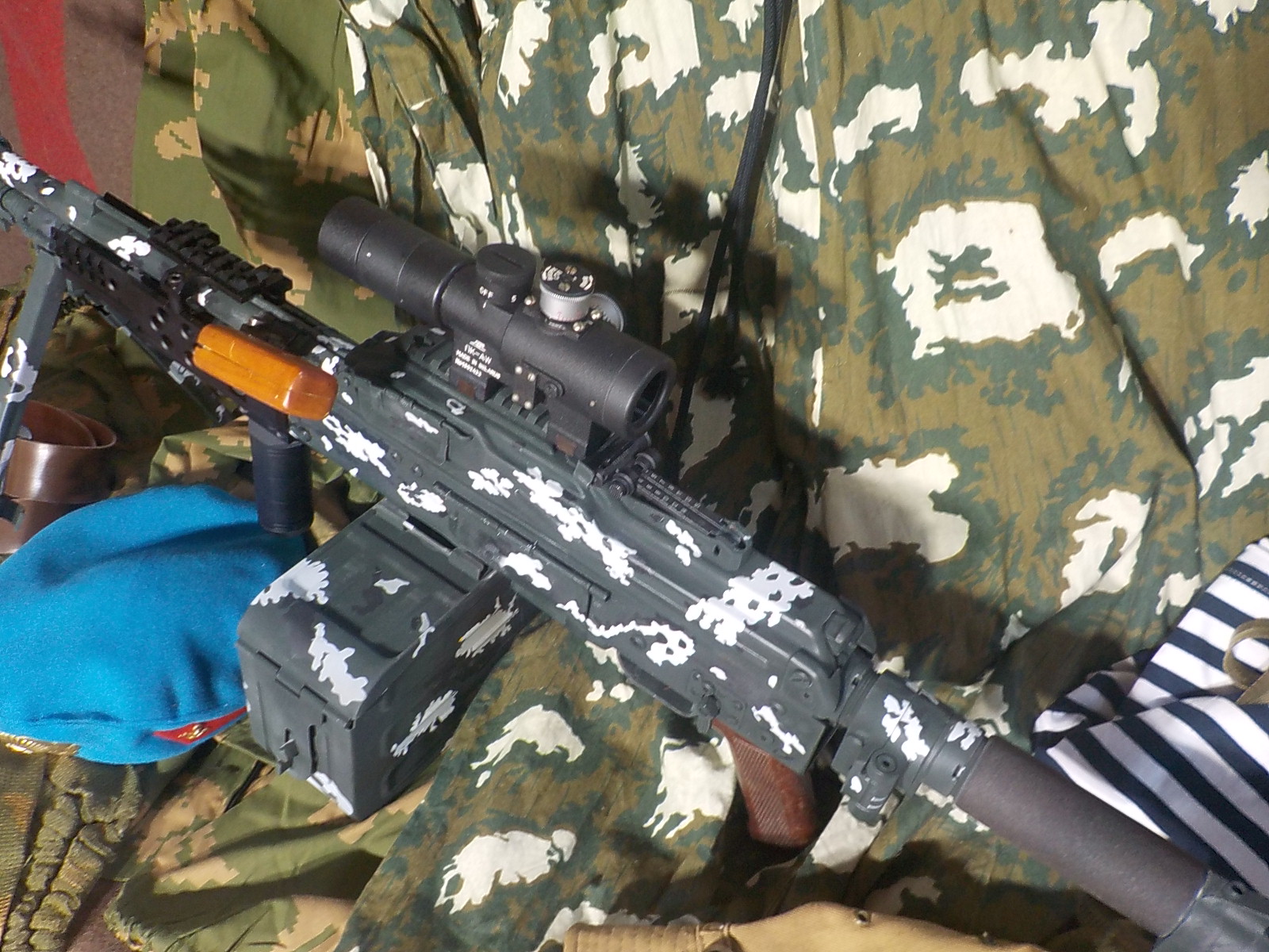

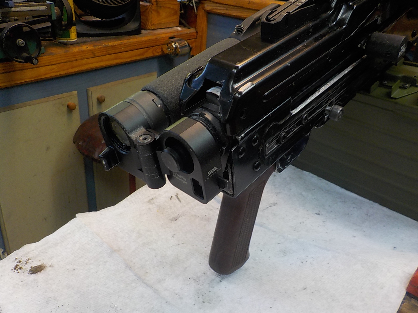

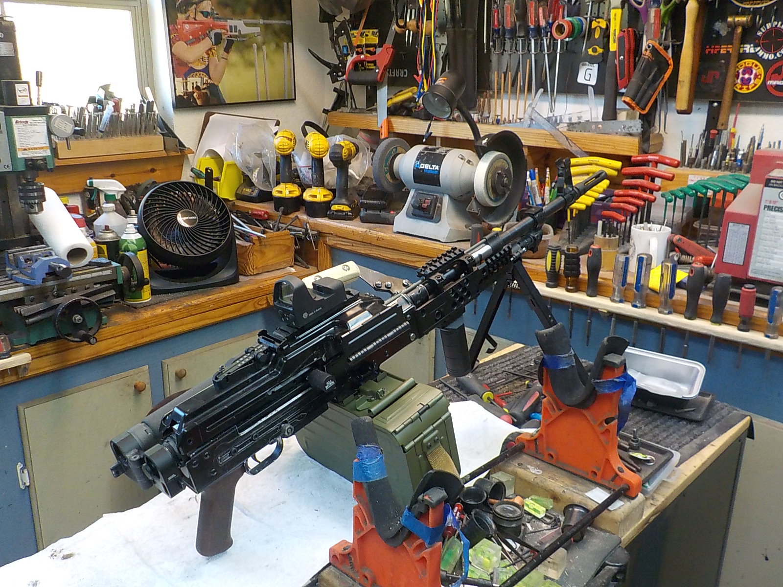

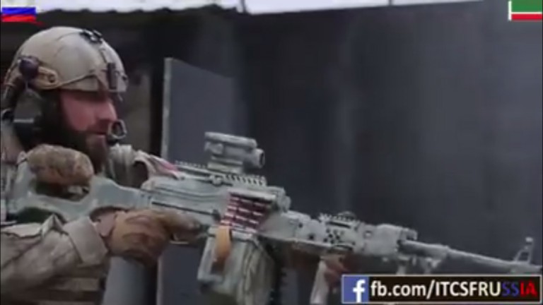

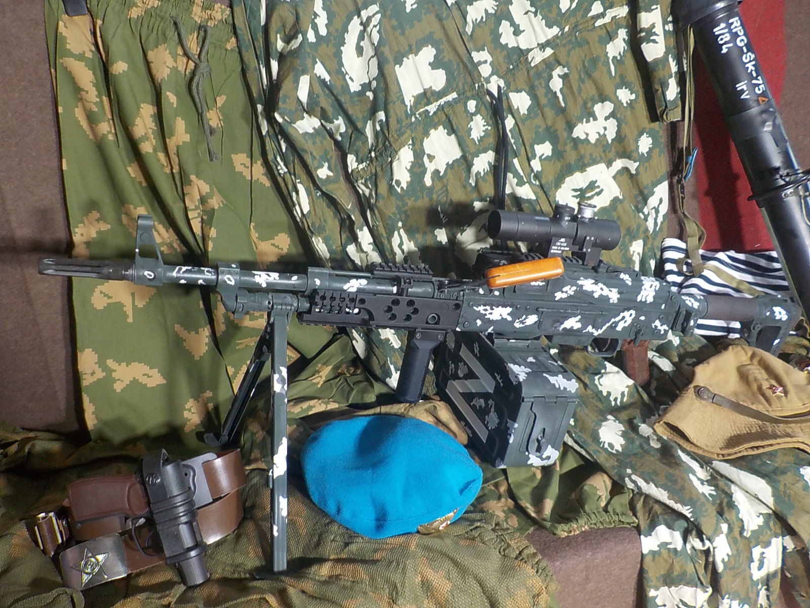

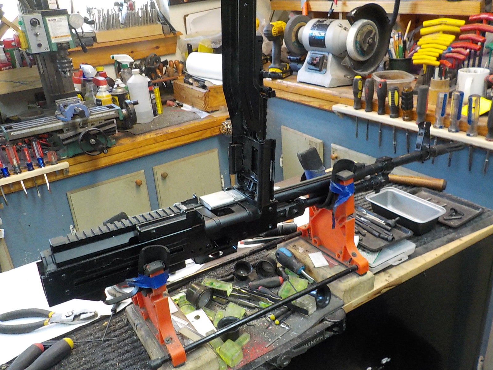

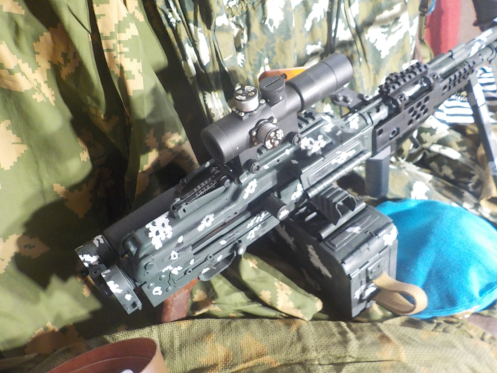

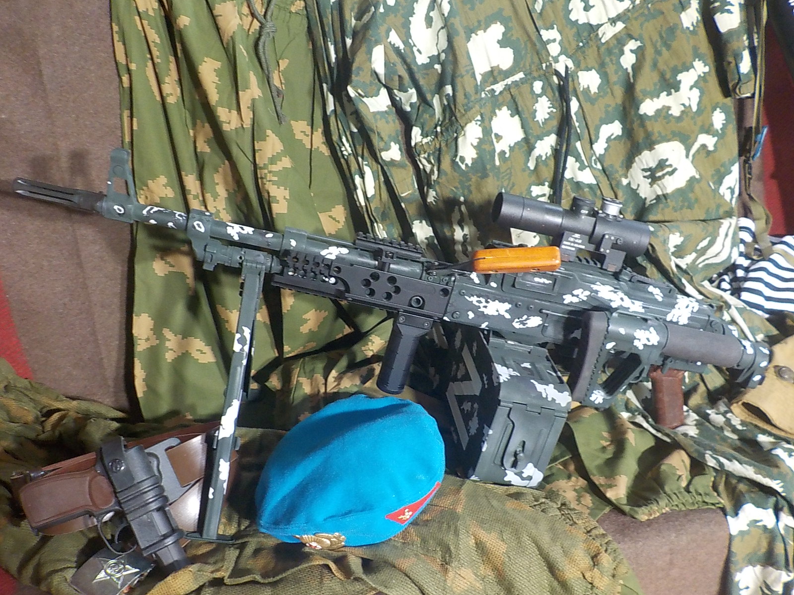

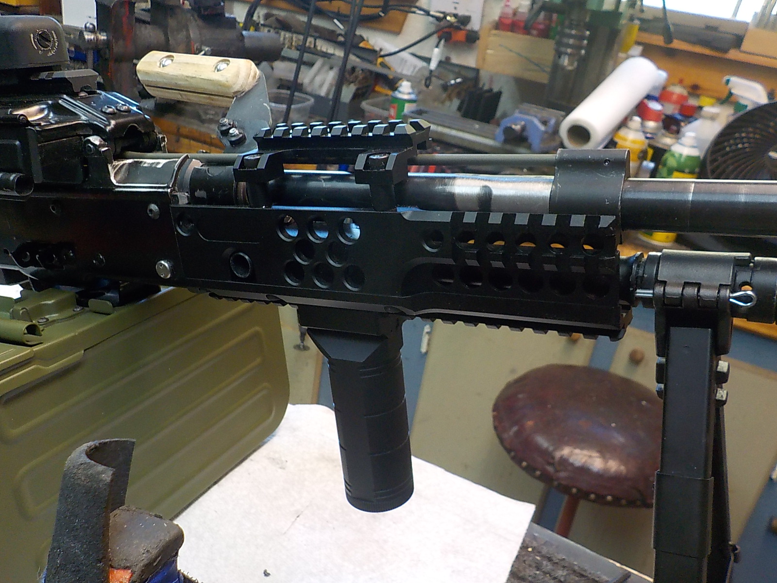

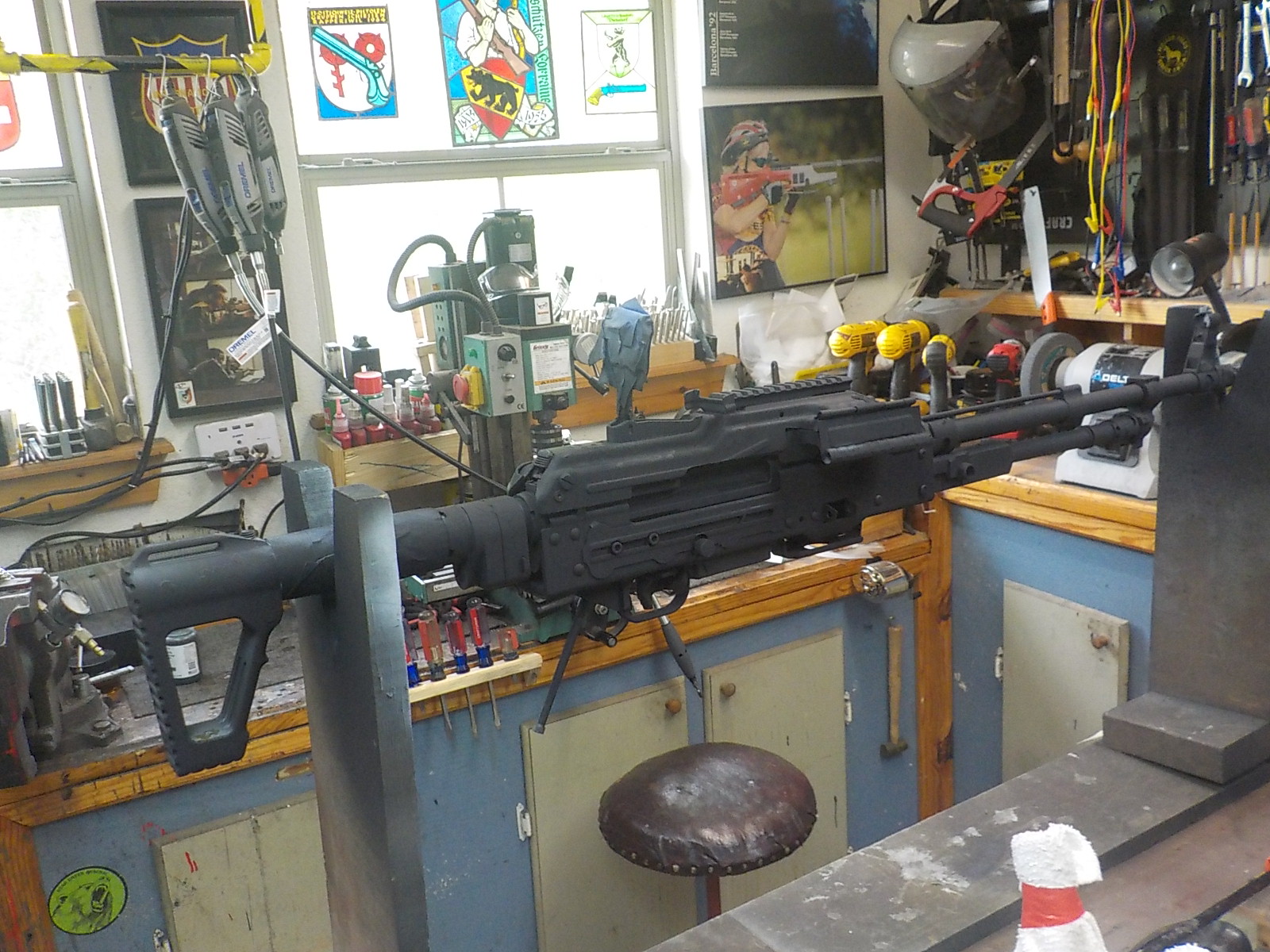

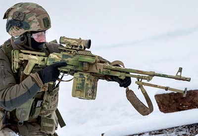

    Finished all the major components and test fired...works fine. I must say that the folding stock on an AR with that bolt extension gives the wierdest springiest recoil. Working on some final cosmetic stuff like the hinge for the feed cover, and a safety extension for the Fostech binary trigger. This is a somewhat Spetsnazy variant with the SOCOM doorbuster stock, and Picatinny handguard. The handguard, charging handle, and fore grip are Russian Zenitco. The handguard is made especially for the PKM and I have included some pics of its use in Ukraine. Coming up is the final disassembly, cleaning, reassembly, and final test fire, then on to Cerakote. Yes, I know the PKO is on backwards.
    This updated PKM has the new designation of PKN

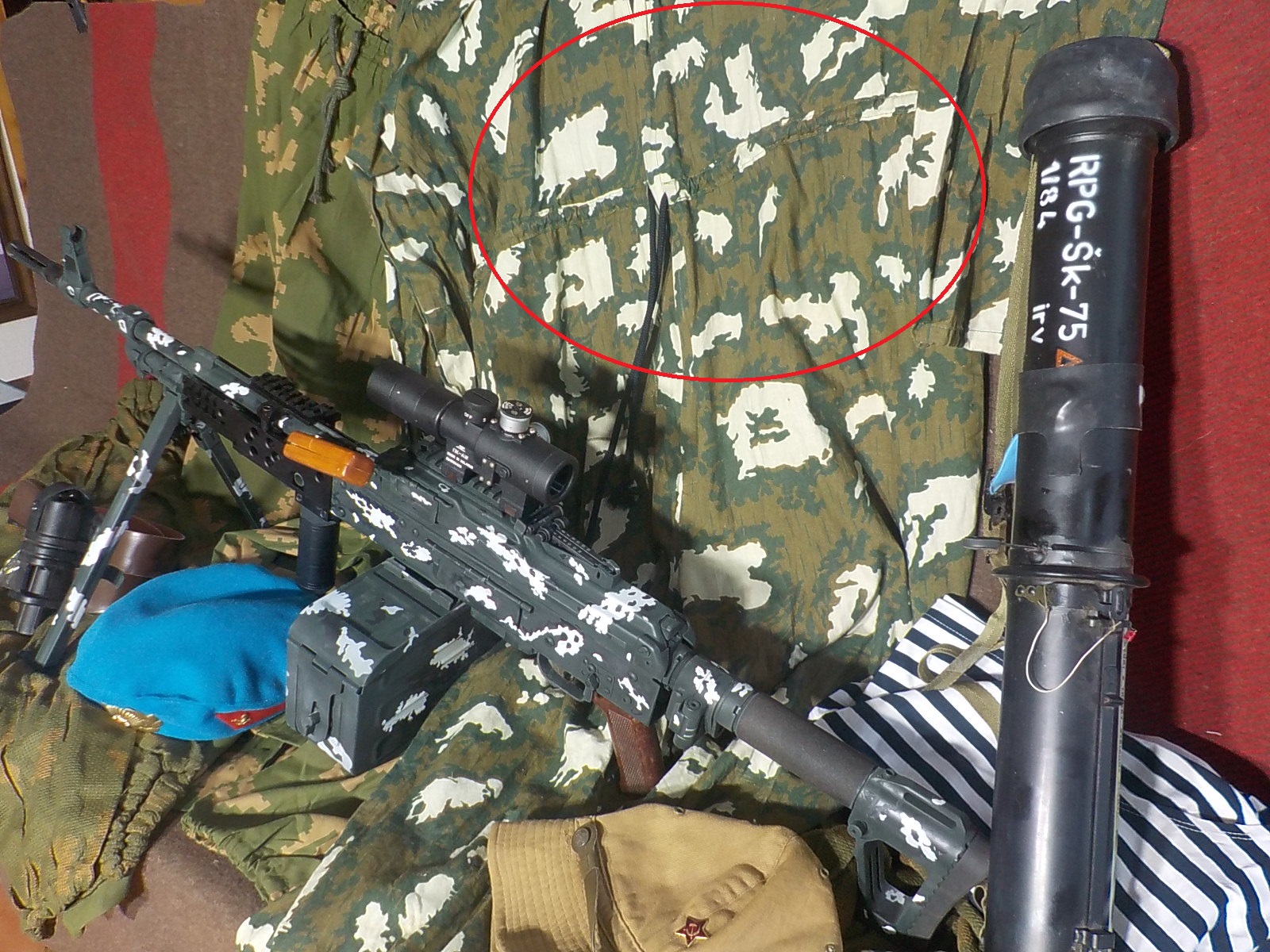

    I've decided upon Soviet KLMK Berezka pattern camo Cerakote. Probably best known from Red Dawn. I actually have one of the suits used in the movie.

    The real suit.

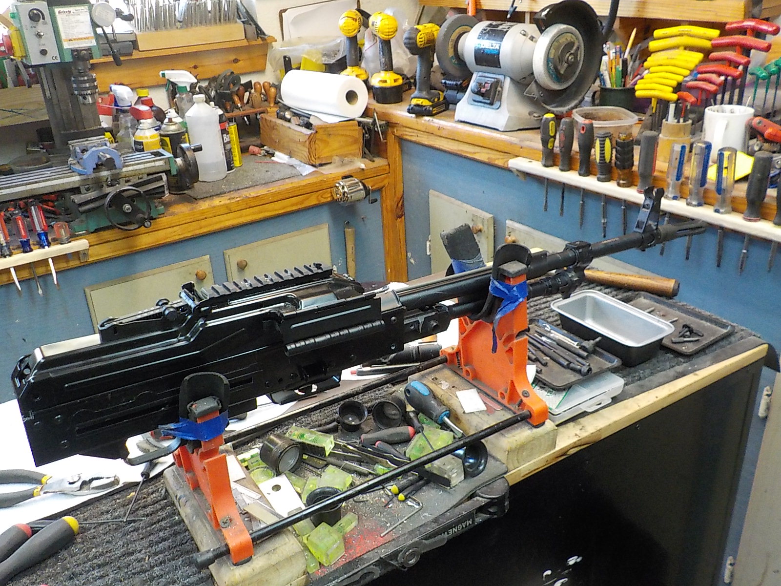

    You'll note that the one is missing its extension. It broke when it got caught in my shirt. 4th time in 3 months, I keep 3 extra extensions on hand at all times. And, speaking of welding...I find this sign apropos.

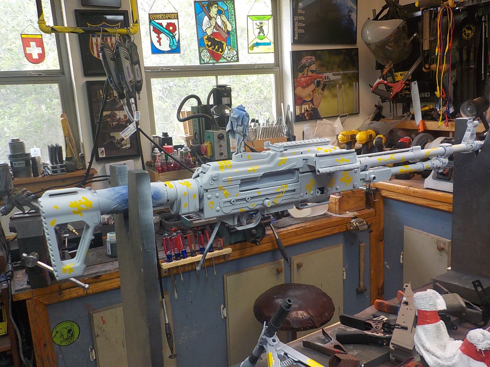

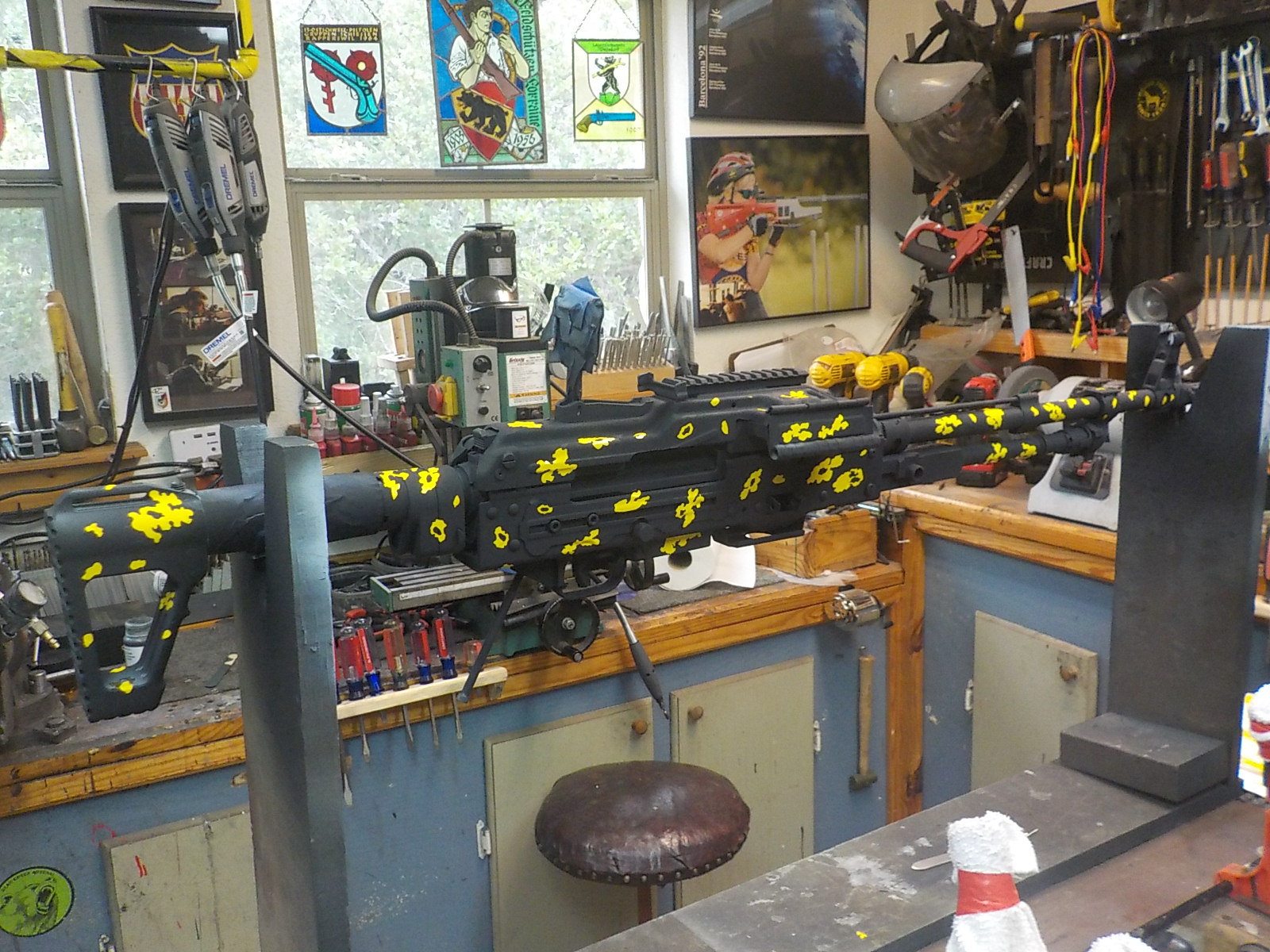

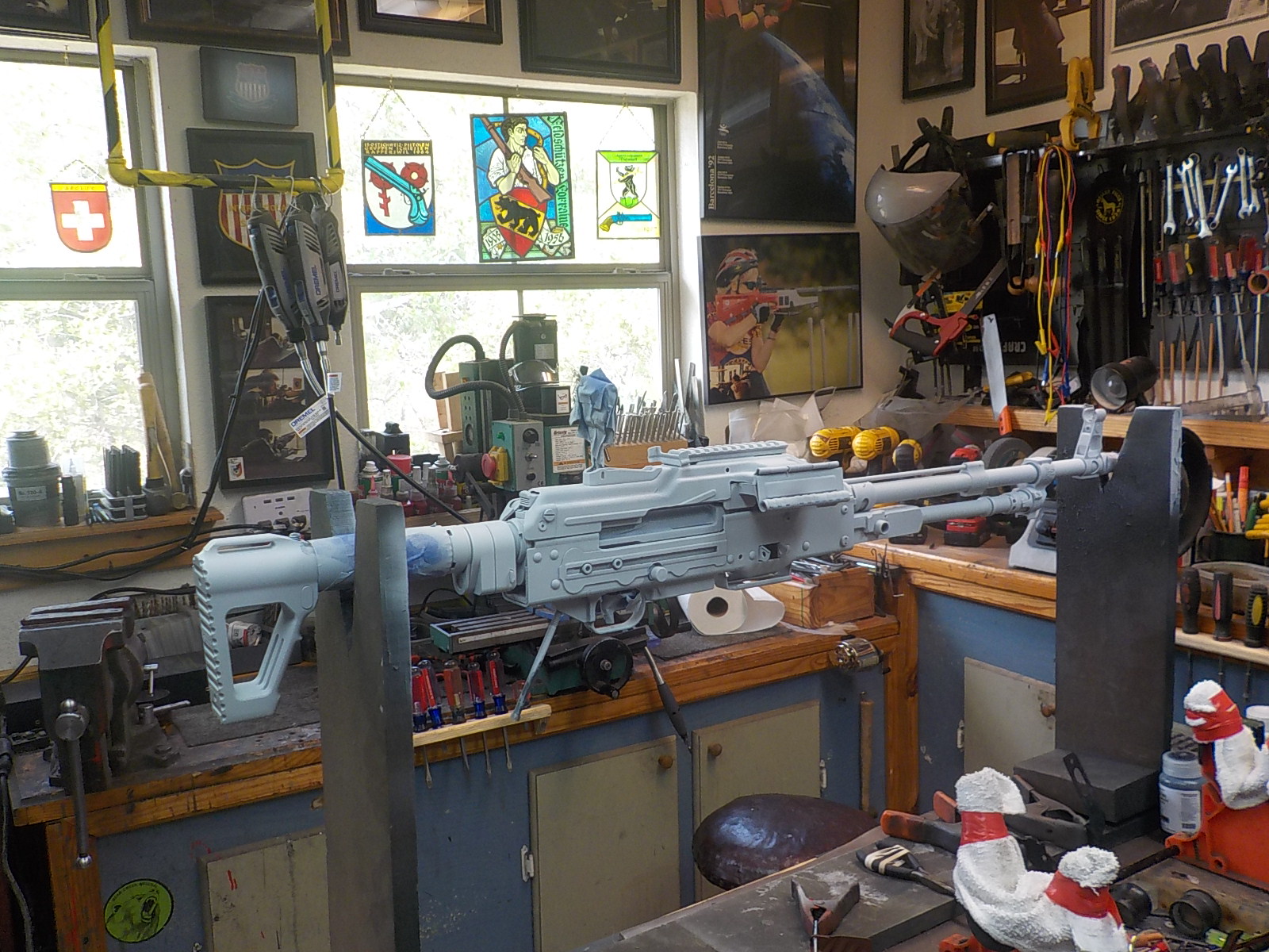

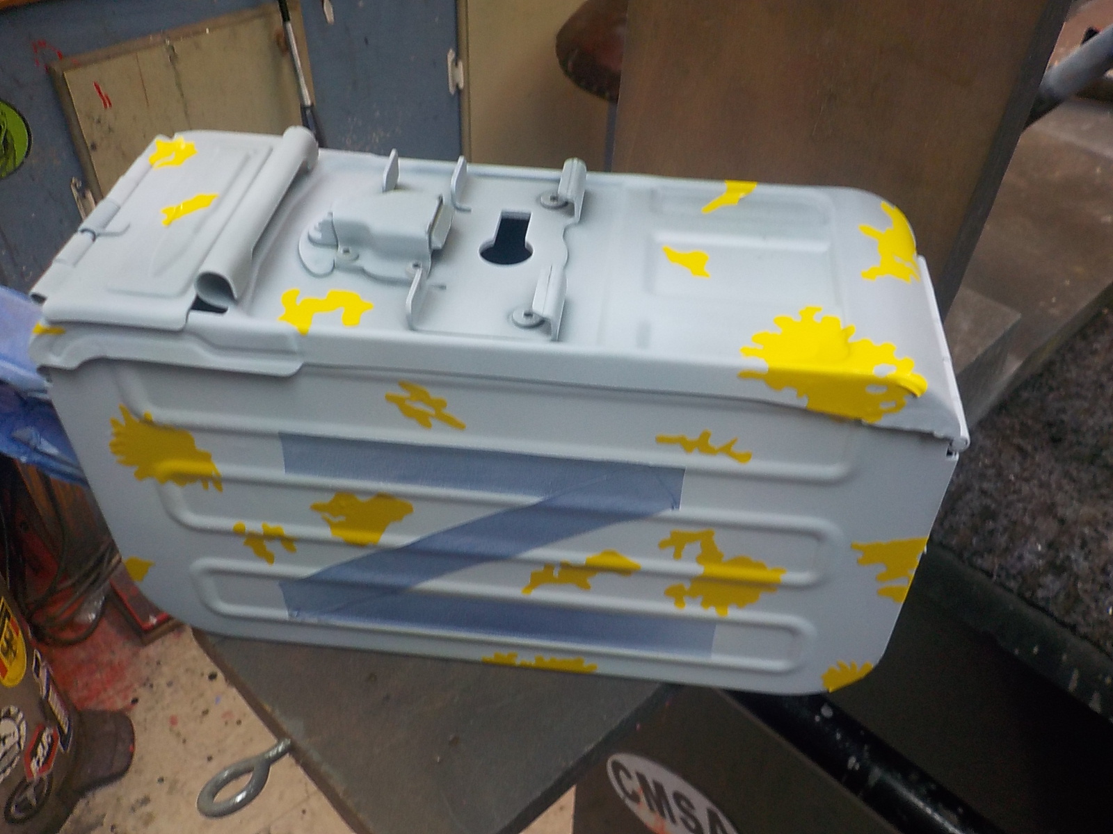

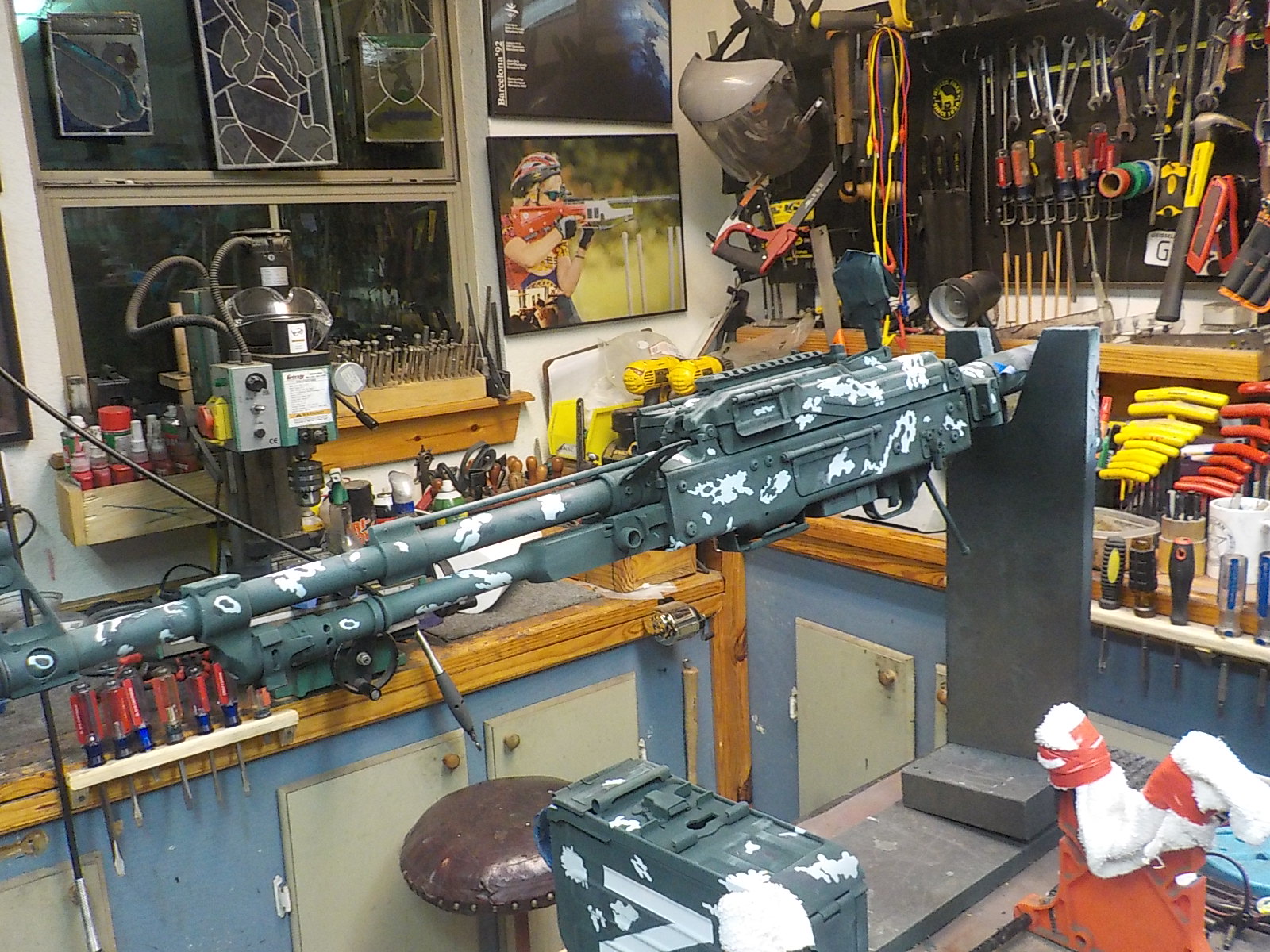

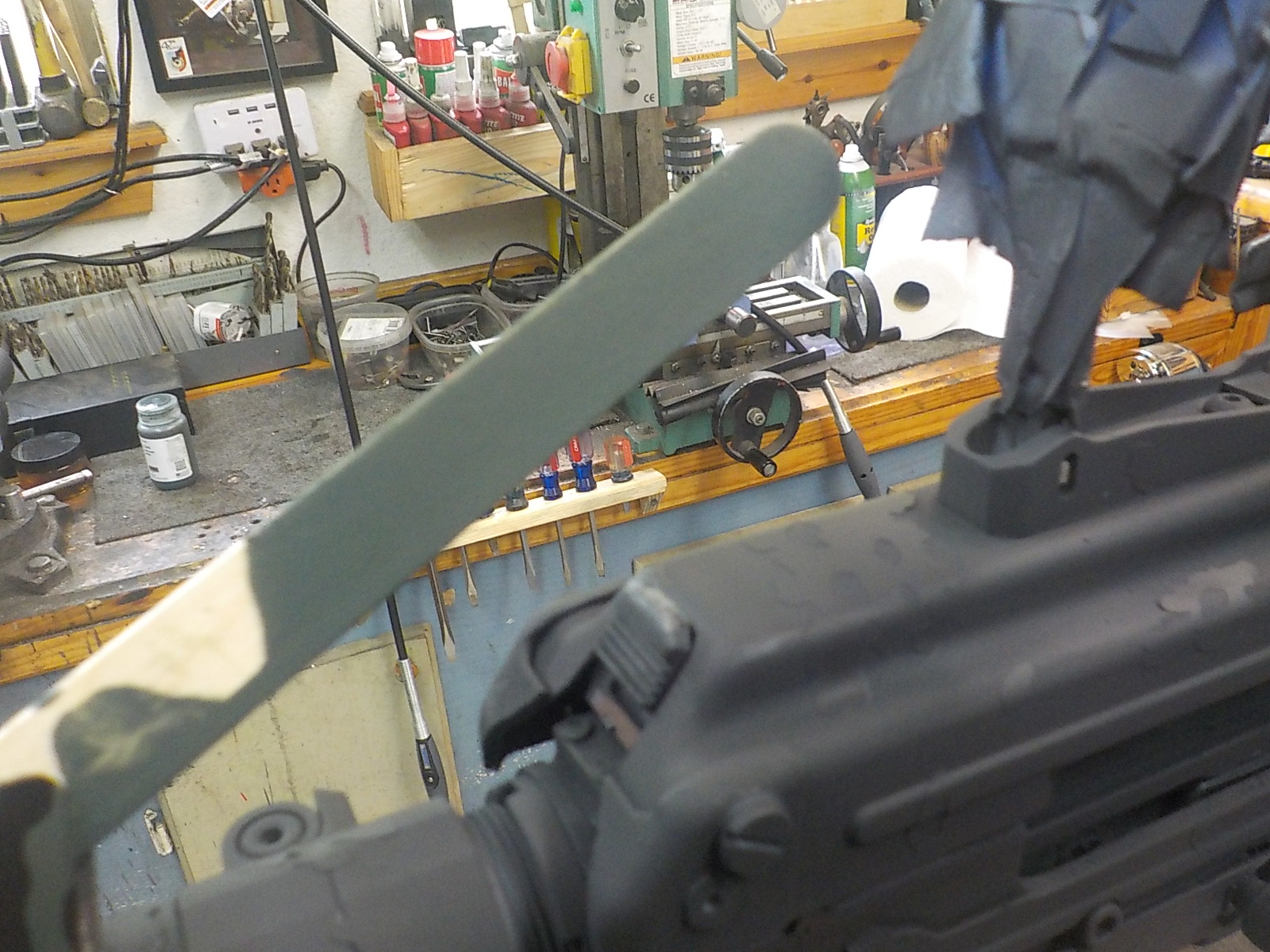

    Graphite Black. Next, more stencils which will give a black border to the first stencils in white. Then, a topcoat of Highland Green mixed with Graphite Black to give a matte flat green. Finally, Matte Clear Cerakote.
    Graphite Black mixed with Highland Green
