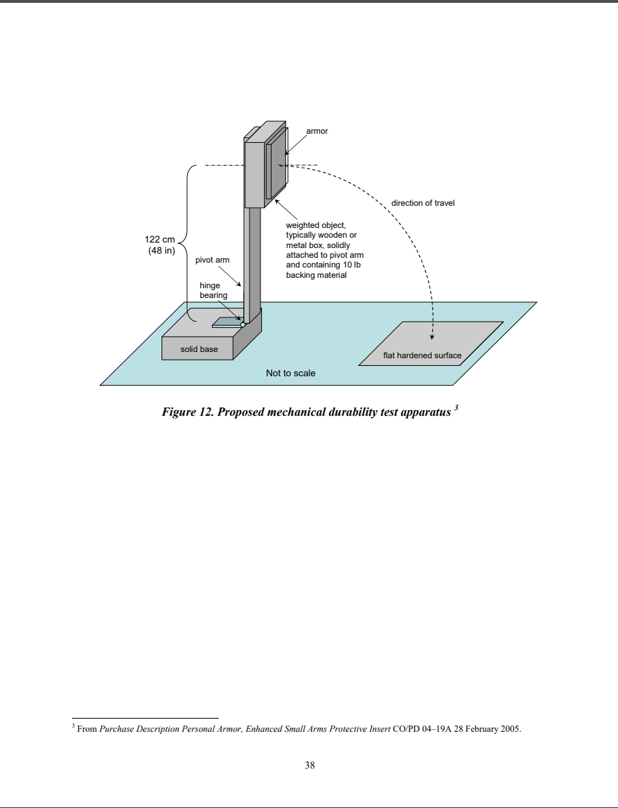

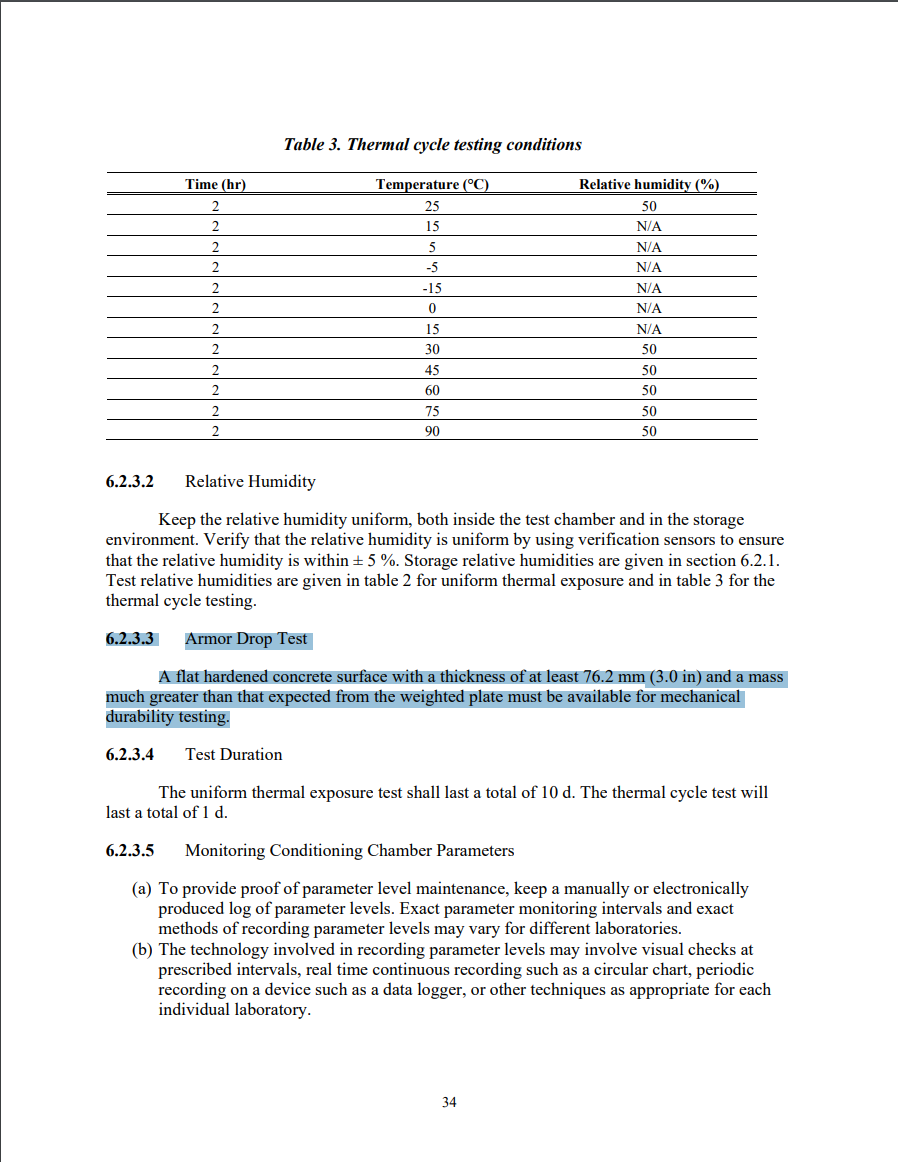

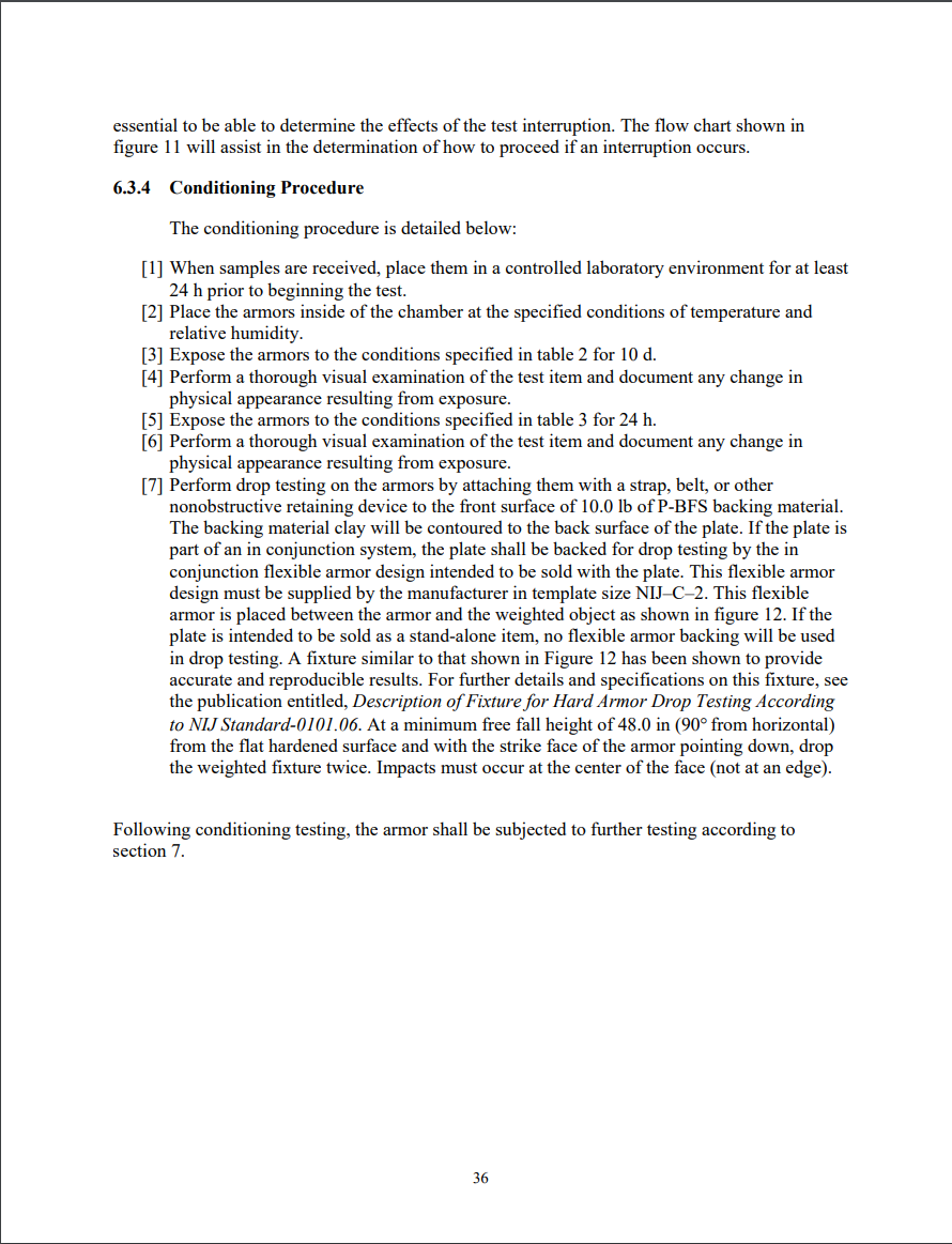

I seem to remember hearing somewhere that SOP for service members was to turn in their plates after every deployment and be issued new ones, so the used plates could undergo X-ray inspection to look for cracks. So the military clearly thinks its an issue that at least needs management, which civilians don't have access to.
