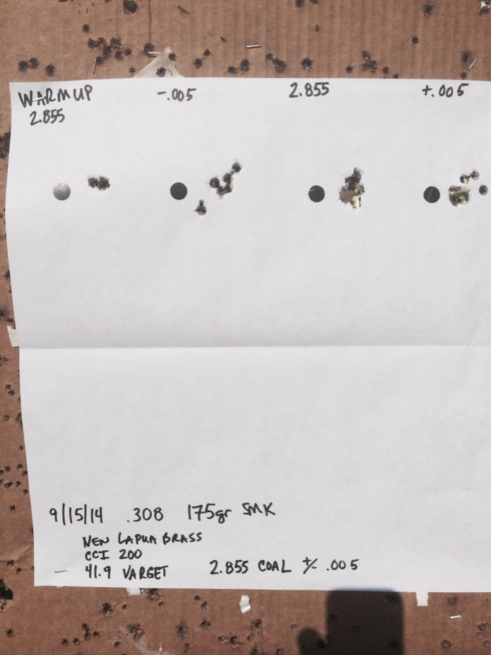

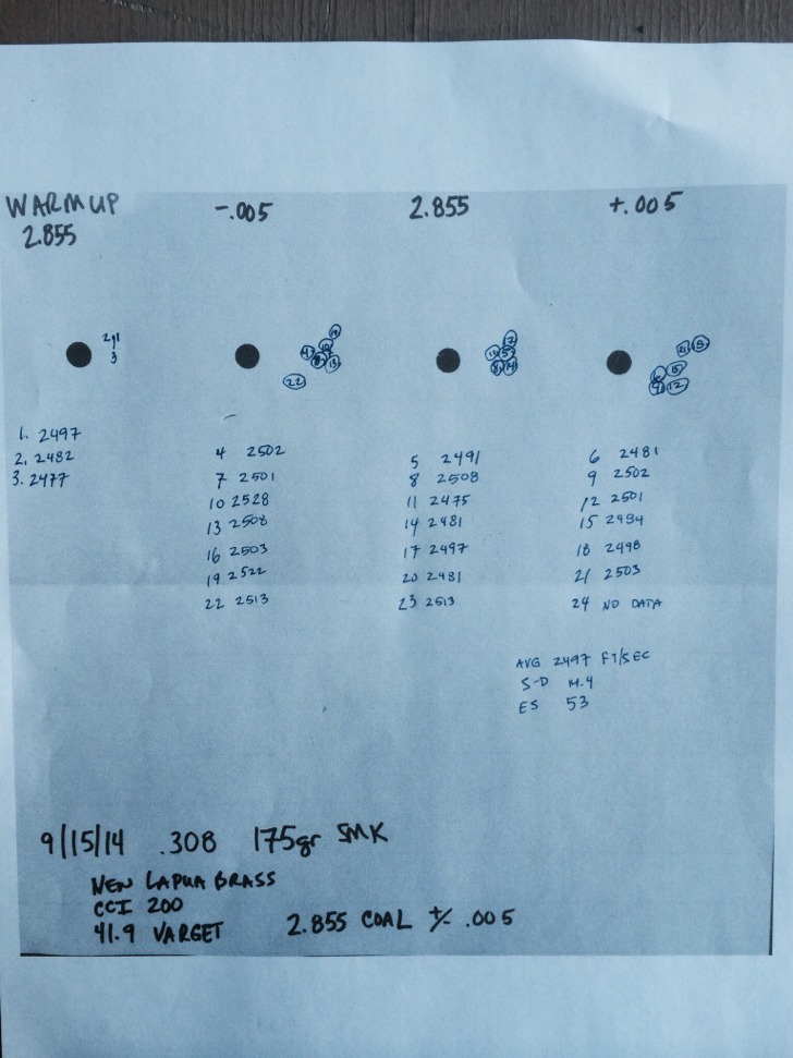

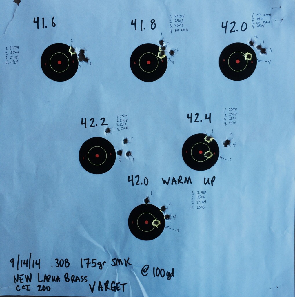

Please advise: another very first hand load workup
Working with Dan Newberry to sort out a good recipe for my FN. Charge weights are all +/- .02gr. Minimal wind. Had issue with my chronograph so I missed a few readings.
These are all seated to 2.855 COAL.
Loaded up three sets of seven rounds and 41.9gr charge. 2.855" COAL and a plus and minus .005" set. The first three of each seating depth printed horizontal lines.
Target:
Data sheet:
