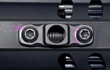

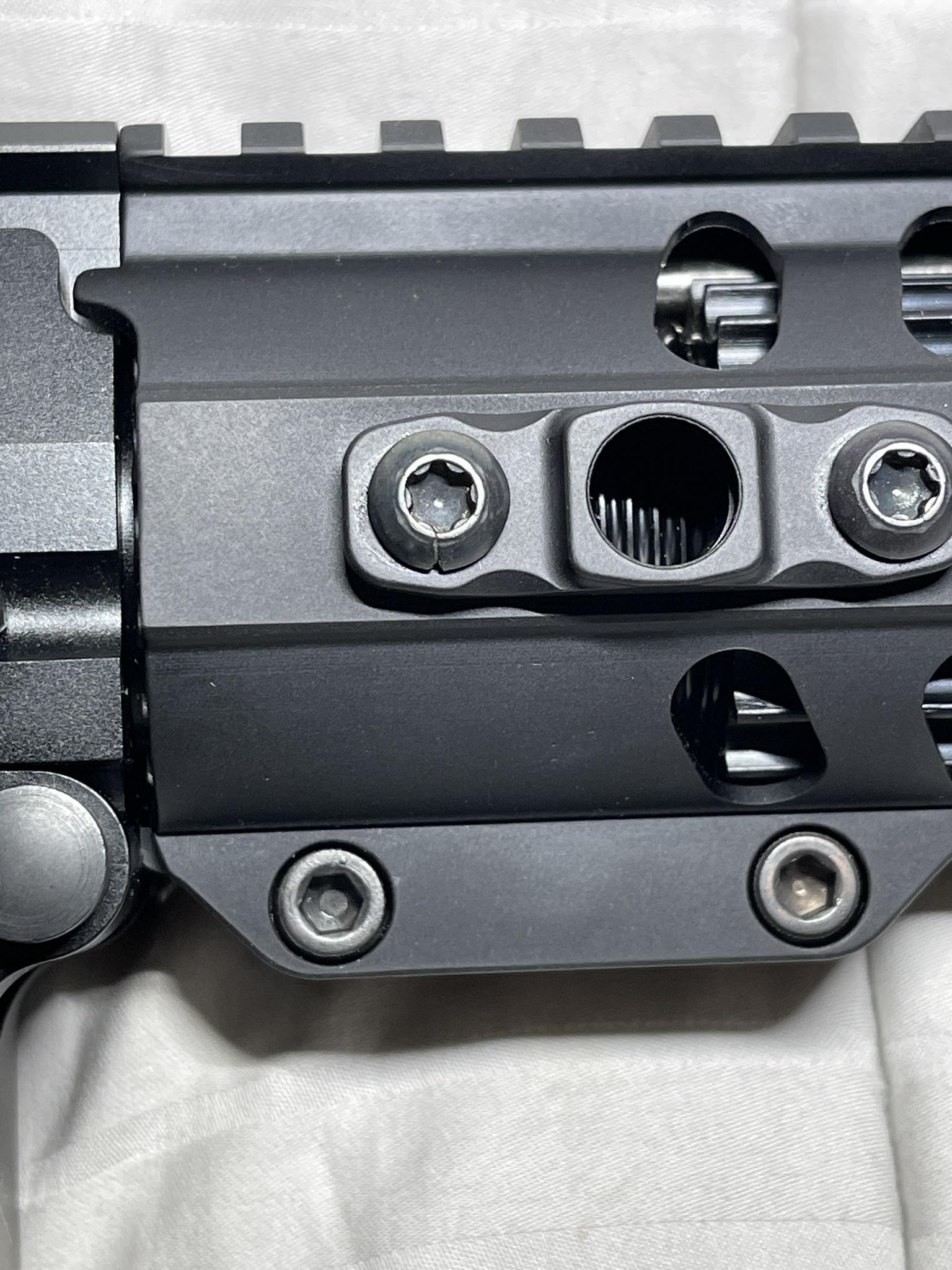

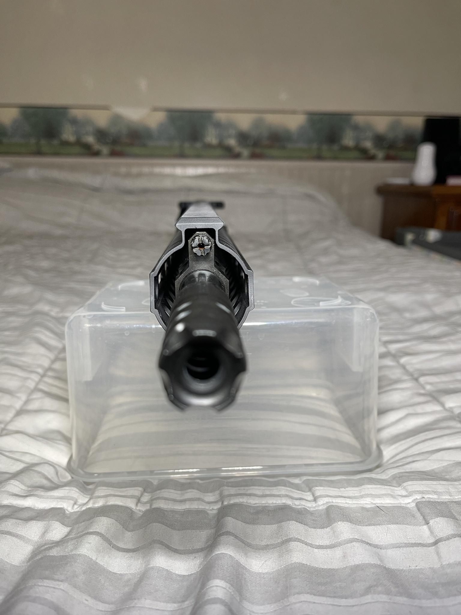

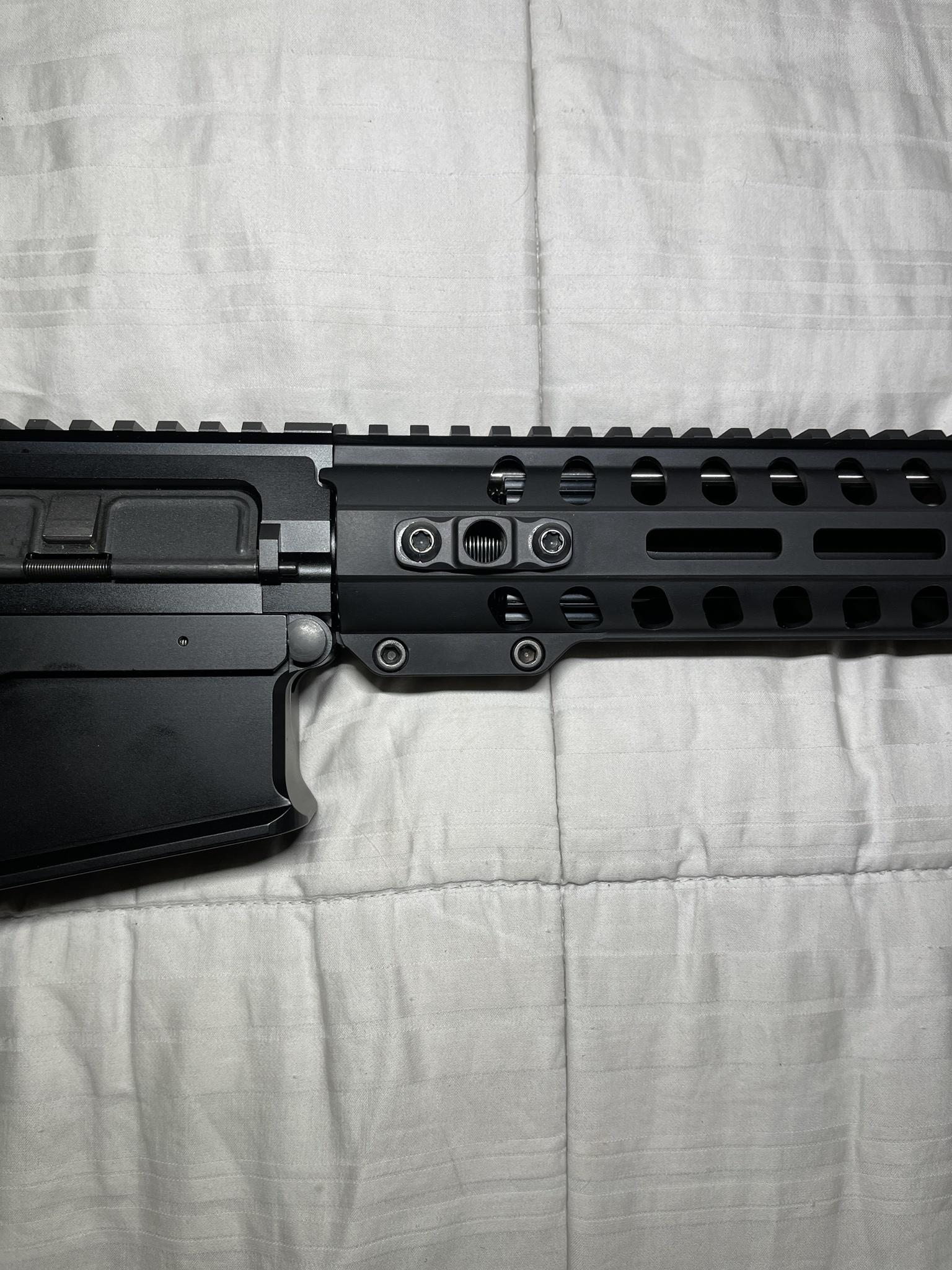

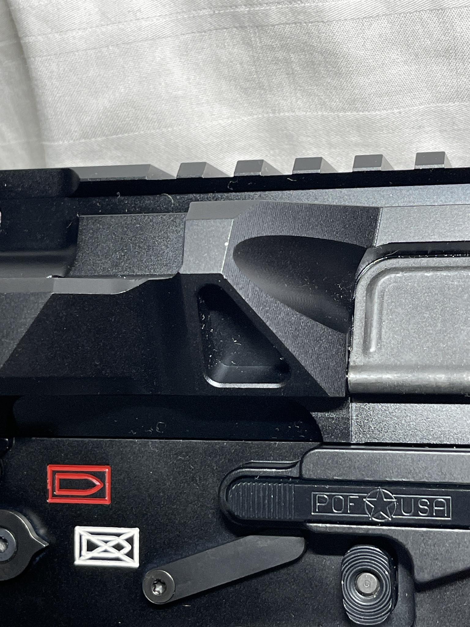

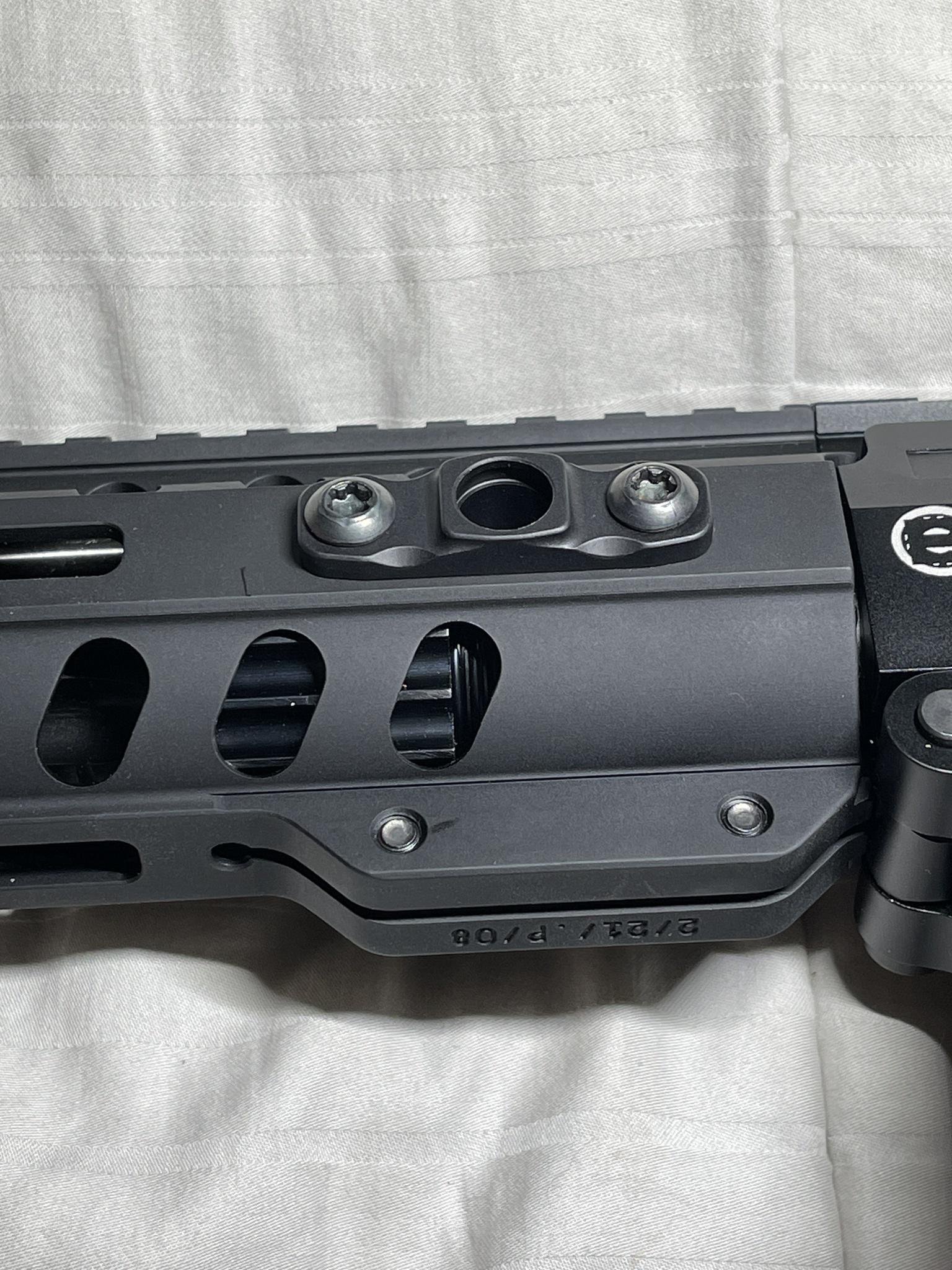

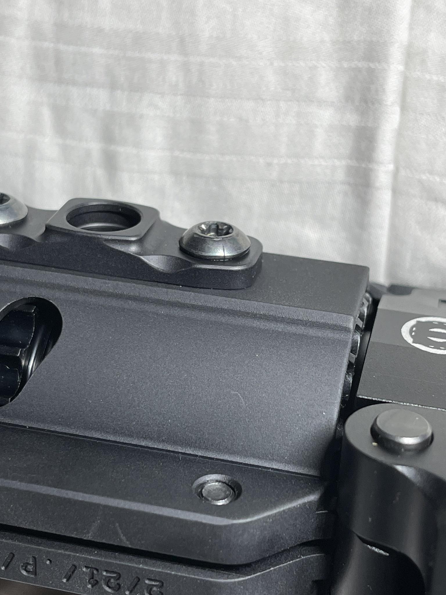

I want to start this with saying I have owned a few POF over the years all have run flawless and fitment was good. However on 8/6/2021 i picked up a POF Revolution DI 308 gun, got it home to spend some time with it and this def seems to be a Friday right before quitting time rifle. Rifle right out of the box has 1ea screw that has a visible fracture/crack in it and another one that has a facture/crack line but doesn't look to be completely cracked like other side. Second big issue is the gas block is quite not centered in the handguard. Also out of the box one of the handguard screws that clamps the handguard to the barrel nut was completely loose . After speaking with the gunshop I purchased from they advised I at least shoot the firearm to verify function before I contact if there is other issues. I shot 5 rounds of Federal M80 and already have anodization chipping on the shell deflector. I mean 5 rounds damaged the finish already on a firearm of this things cost.
I spent several days trying to call someone and Tech and Customer support lines go to voicemail and you don't ever get a call back. I finally called sales after a few days, they got me to someone who gave very little to no help and said go on the website and setup an RMA. Fine go and do that to find out they want the owner to pay shipping to them for there lack of QC. The rifle wasn't a few days old and right out of the box had several QC issues that are concerning. I am in shock honestly I had heard stories of POF and QC lacking but experiencing it now first hand I am regretting this purchase quite a bit. Wanted to pass the word to save anyone else the headache or do a better than I did inspection before signing paperwork.

if you don't want that sharp gucci billet edge of the brass deflector to get dinged, then you need to get one of those gucci amazon rubber or velcro pads that sticks onto the brass deflector.
that sharp edge is just begging to get dinged by brass, that's normal. the rounded forged version is probably more forgiving, but will still show brass impact. I think the aluminum on a forging is denser than billet and this is definitely billet. but that sharp edge of your deflector, that won't survive without showing wear from dings, unless you don't shoot it, just look at it how beautiful it is.
looks like it got nicked by the sharp edge of the case mouth.
You can't escape the deflector getting hit with brass like that it will happen on all guns if properly gassed...
As far as the screws...that really sucks...however if you call up POF they will send you replacement screws...
With any rifle platform regardless who makes it...I go around and re-torque/loctite every single screw...
I would hang my head in shame if my brass deflector was not dinged and streaked with brass 😞 I doubt POF makes their own screws, they just buy them in bulk. So the bolts probably came that way, and whoever makes those, makes them by the 1000's per shift. Easy defect to be overlooked at a sweat shop. That would be something I would chuckle about on the way to the hardware store when I replace those torx with hex key "button head cap screws".
The hand guard/gas block issue is kind of interesting. I don't think the gas block is what's out of alignment here. I would look at the alignment of the hand guard. Take it off, make sure it is not bent or twisted, clean of burrs both inside the hand guard where it mounts to the barrel nut and make sure the barrel nut is clean of burrs. Make sure those clamping bolts are equally torqued when putting it back on. If it is still out of alignment, then either the hand guard or barrel nut was not machined square. Can be corrected by shim or replacing the suspect component; or just leave it as is if you're not mounting a sighting device to the hand guard.

Brass deflector, buy a roll if duct tape and cover it or sell it because people pay for that battle worn look.
I use a small piece of Velcro on my brass deflector's if they start to show brass dings.

Looks like someone pulled the QD mounts, you can see the witness marks from the screw having been tightened down once before.
You have to do that to pull the hand guard as they set in to that heat sink and it will not come off with out them removed. That could also be binding the hand guard off to one side, the QD mount binding against the heat sink barrel nut. Maybe that's why the other hand guard nut was loose?
Possibly? someone between the factory and you pulled the hand guard, and didn't properly reassemble it??
Unless the Factory missed that.
