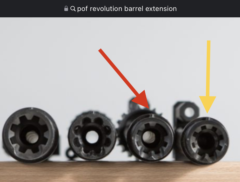

What do you mean out of headspace? Its installed and was out of headspace?
Aren’t the barrel extensions on POF small frames the same dimensionaly as a standard Ar-15 extension. With a section of the extension removed in the area the extractor interfaces with it.
Red .308
Yellow .556
Reactions: bigjake83

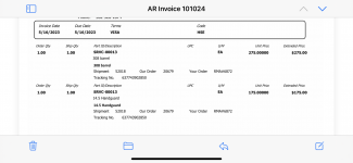

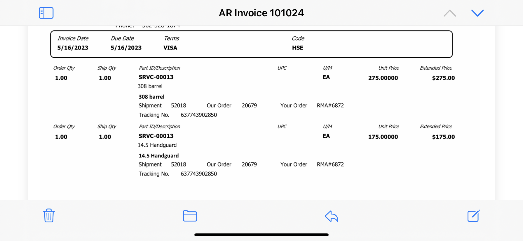

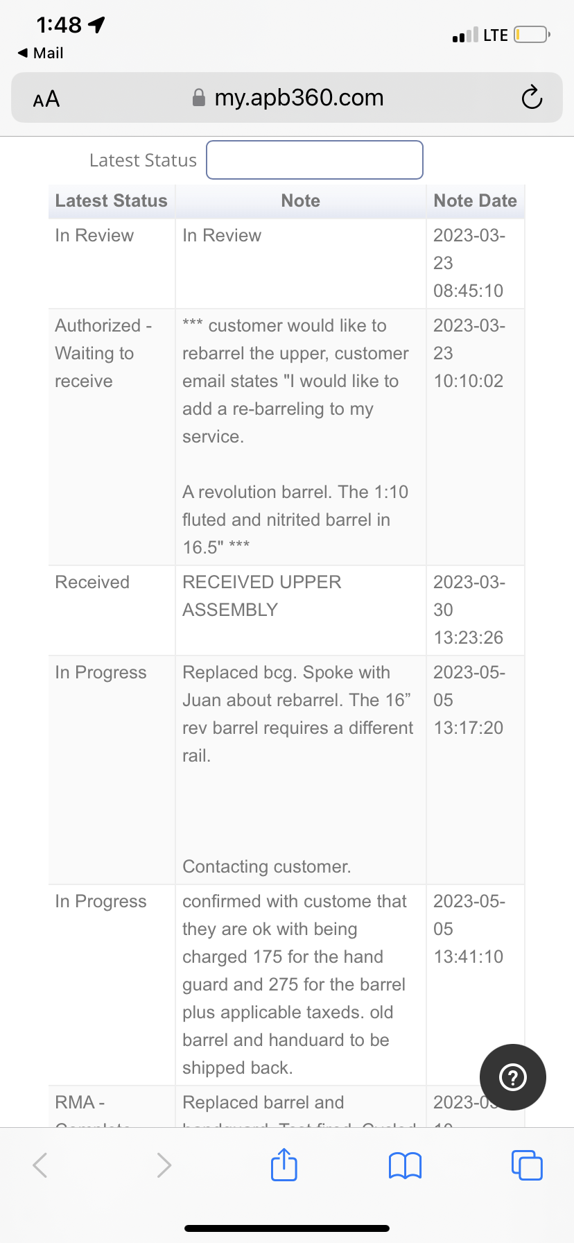

You know what’s funny, Juan, the customer service guy also said they could ship my rifle direct back to me, “since I already own it”
Which I thought was wrong as well.
I told him I’m grandfathered in and my state won’t let me ship out and then bring it back through an ffl. It’s a dumb rule but that’s what every ffl I have talked to has said.
I asked to buy an extension originally they told me no but I ended up just getting it rebarreled while it was getting the bcg replaced. Cost me 275 for the barrel and I asked for the fluted nitride barrel which only came in revolution and so I had to get the handguard too.
Ended up being 450 bucks, totally wasn’t worth it.

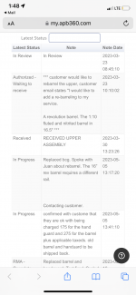

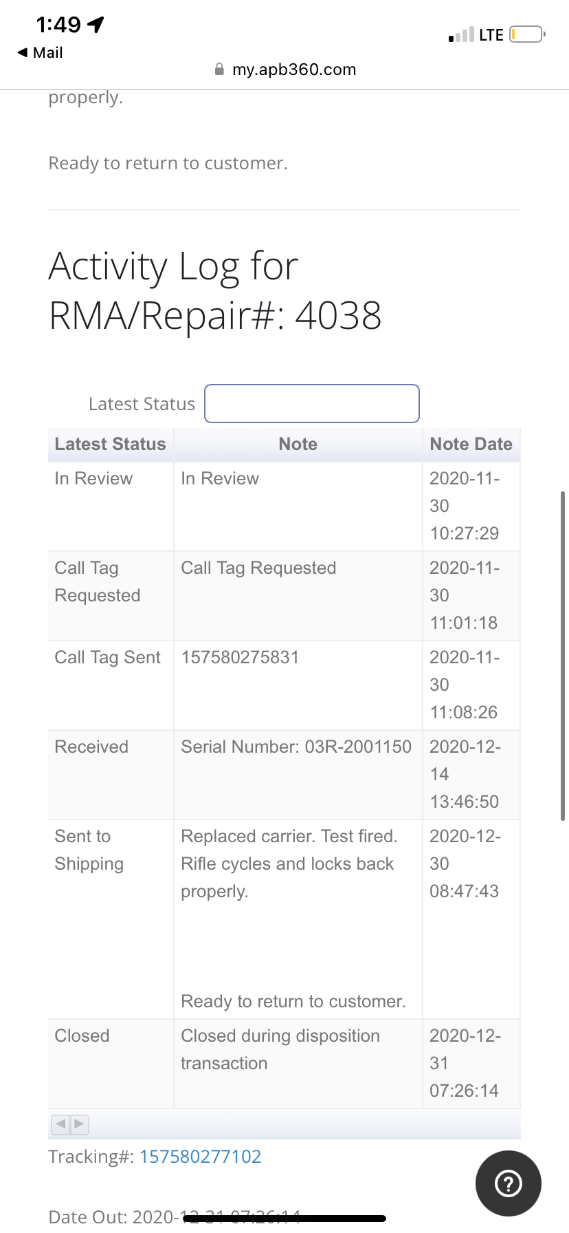

This same gun is on its 3rd bgc because carrier keys came loose. It uses a dovetail and a single screw. But from what I’ve seen, it relies entirely on that screw being tight.
The stakes were light on both carriers and I couldn’t get the screw tight again on one after it failed. Maybe 60rds the first one and 400 rds the second one.
My newest one the stakes were light too but I took out the screw to make sure it wasn’t stripped and then torqued it back and staked it myself so hopefully no more issues there. The dovetail still seemed loose on my current one but we’ll see. I may end up buying a spare bolt carrier because that thing seems like a liability.
I also got their adjustable gas block thinking it was over gassed and beating the pants off it. But that was on the first carrier and still had the second one become loose.

They are using my first barrel and taking the extension from that and threading it onto a new barrel.
Not quite a remove handguard and drop in like you would with a typical AR barrel.
it’s not a standard extension.

I bought a used Rogue that shot absolutely horrific. 6"+ at 100M on a good day. Tried everything I could to get it to shoot.
I wound up sending it in to POF and they replaced the barrel and hg with Revolution parts for a reasonable price.
Finally got to shoot the rebarreled Rogue-alution today. Accuracy is right where I was expecting it to be, sub 1.5moa with the cheapest 175smk on the market, so I'm happy with that. However, with the gas block fully open it will not cycle this ammo I have 800 rounds of. I guess the 16" RLGS is just too close to the edge.
Anyway... Ive got the crappy barrel sitting at home and would like to reuse the extension to upgrade it at some point in the future.
Reactions: TheWatchMker
Be sure to give us updates @TheWatchMker
