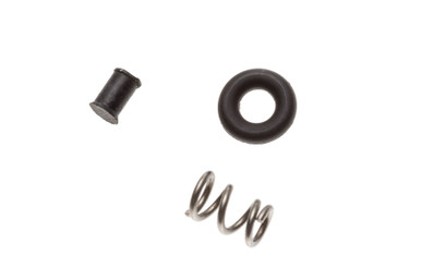

This was the ticket for my rifle that had extraction issues, though an ar15 frame. Perhaps you can find a large frame equivalent...
