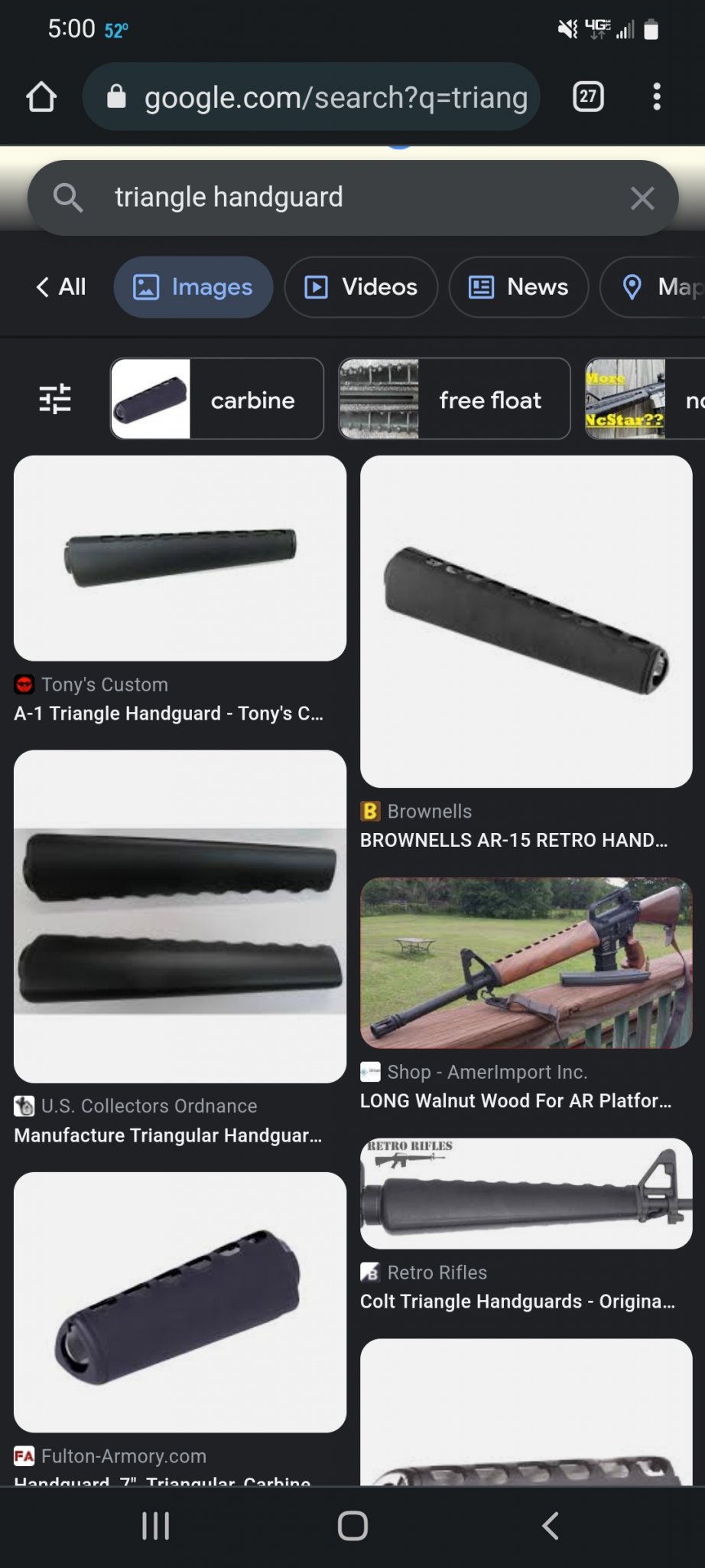

Who has a triangle handguard? Is this 1974 again and nobody told me?
Reactions: BurtG
The dnr it’s pretty nice
Reactions: 357Max

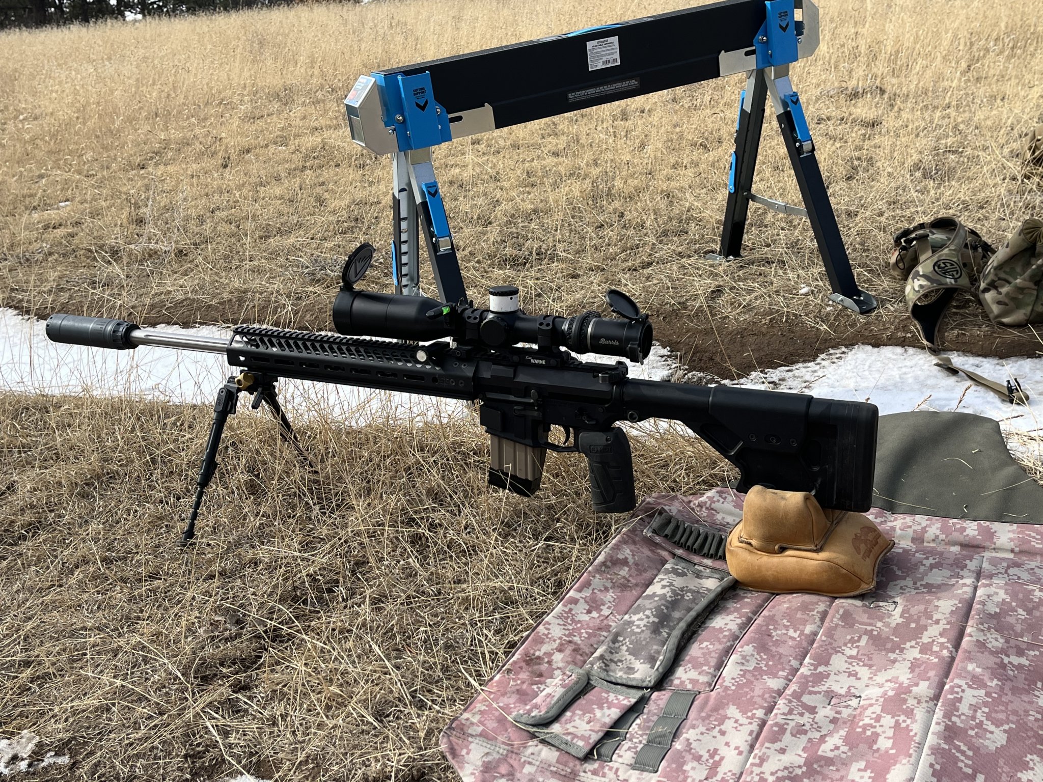

And I did not try the bipod off the barricade. I was using a sawhorse for kneeling and my tripod setup for standing position. Both with a sand filled shmedium game changer. POI for both kneeling and standing were the same

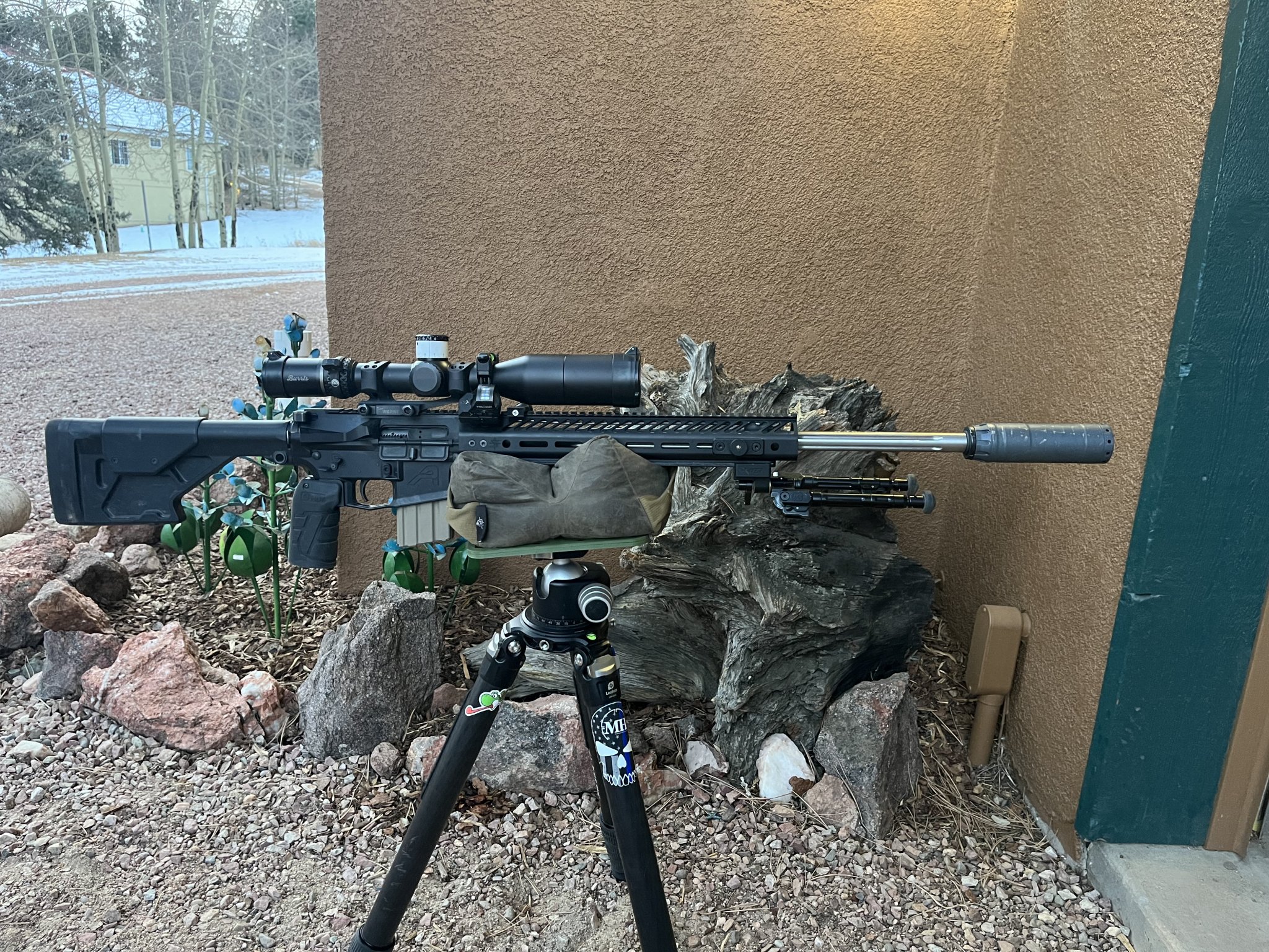

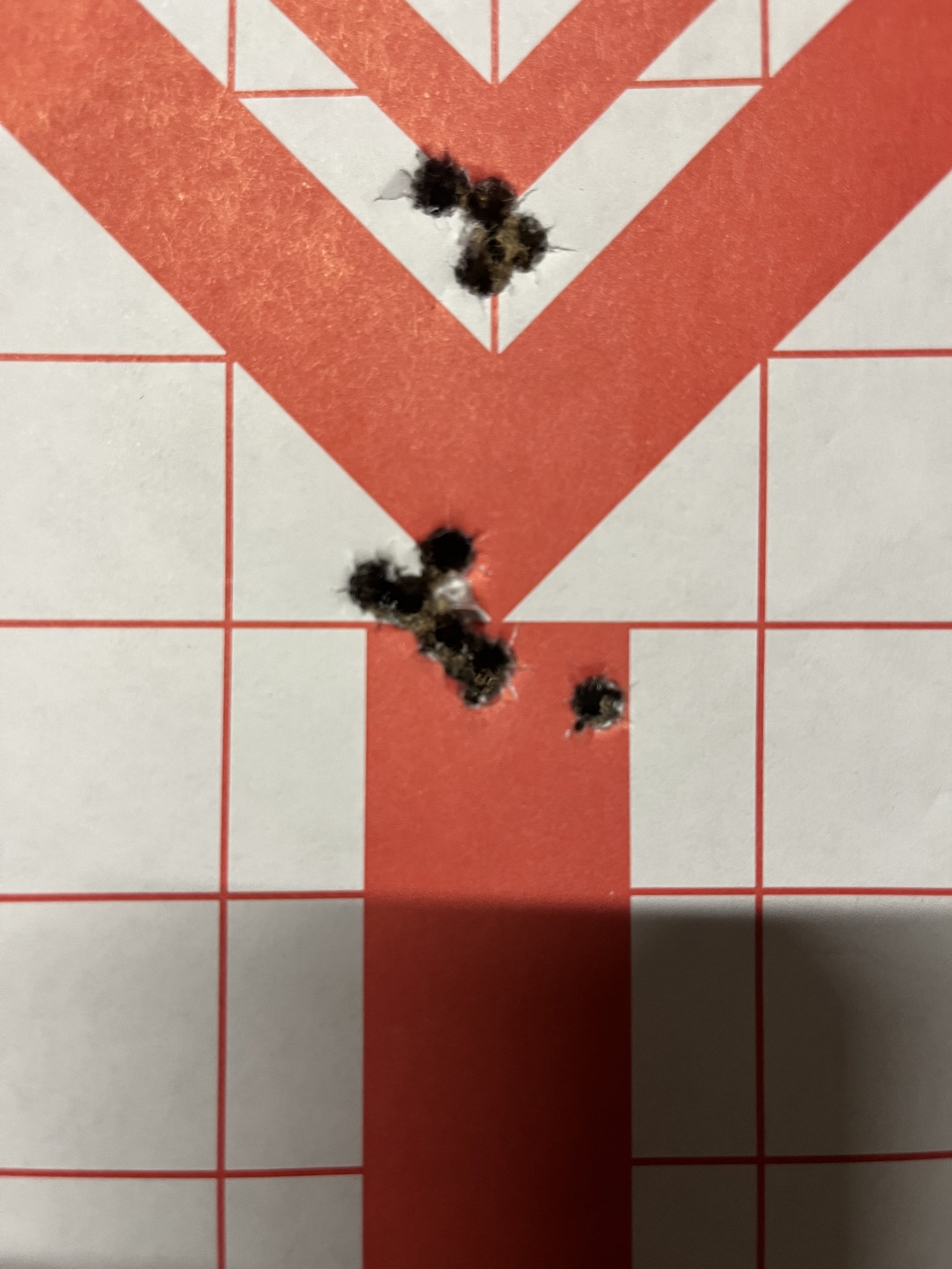

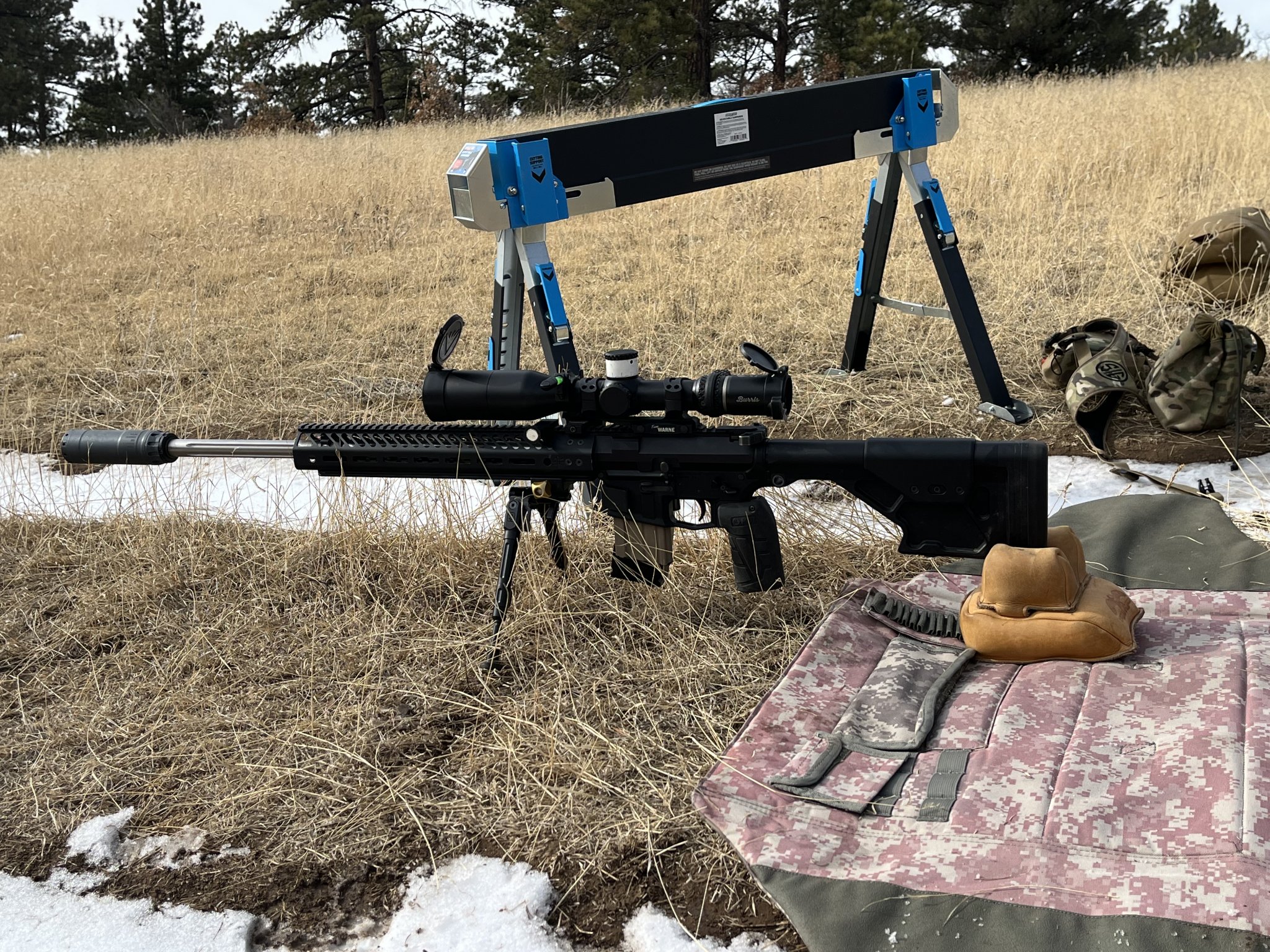

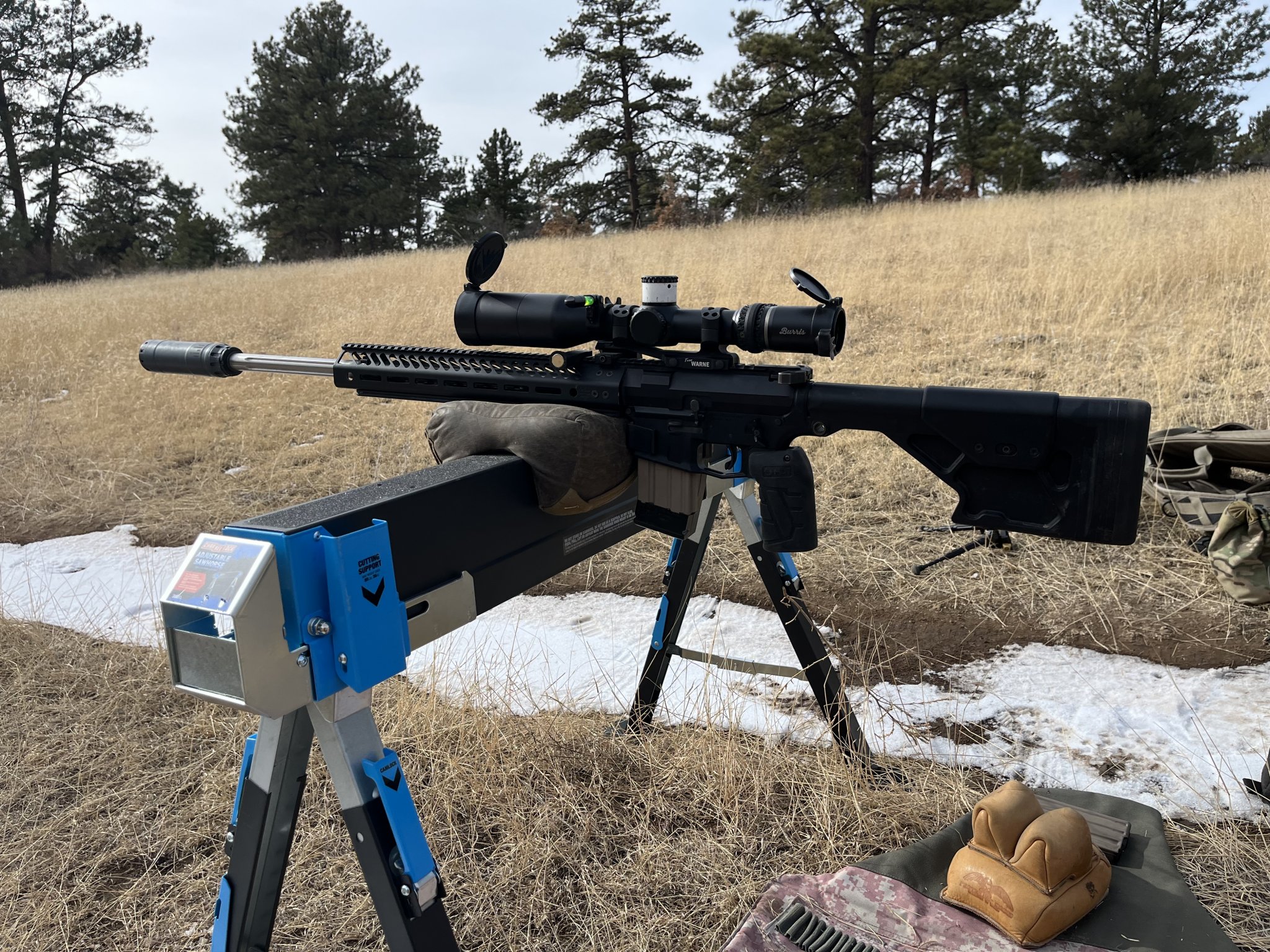

Pictures as requested. The 2 groups on the bottom points of the diamonds are prone. I shot one group then shot off the barricades that went low then went back to prone and shot the other bottom point group. Don’t remember which was first or second but went back to the same point.
The other 2 pictures were off the saw horse with the game changer. I was aiming at the side points of the triangle and both were about the same elevation low. Like said above, after shooting these I went back prone and ended up zeroed again.
I just checked the rifle again and have good clearance all around the barrel and gas block. Nothing touching. And no real flex in the handguard. It is really solid.

There's another potential cause that should be ruled out. If your rifle is dipping in the rear bag when shooting prone, it will shoot high.
You've zeroed for it, but that would also explain what your seeing. On the props the rifle is sitting on the balance point so no dipping in the rear.
Make sure the rear bag is firm & not angled when prone.

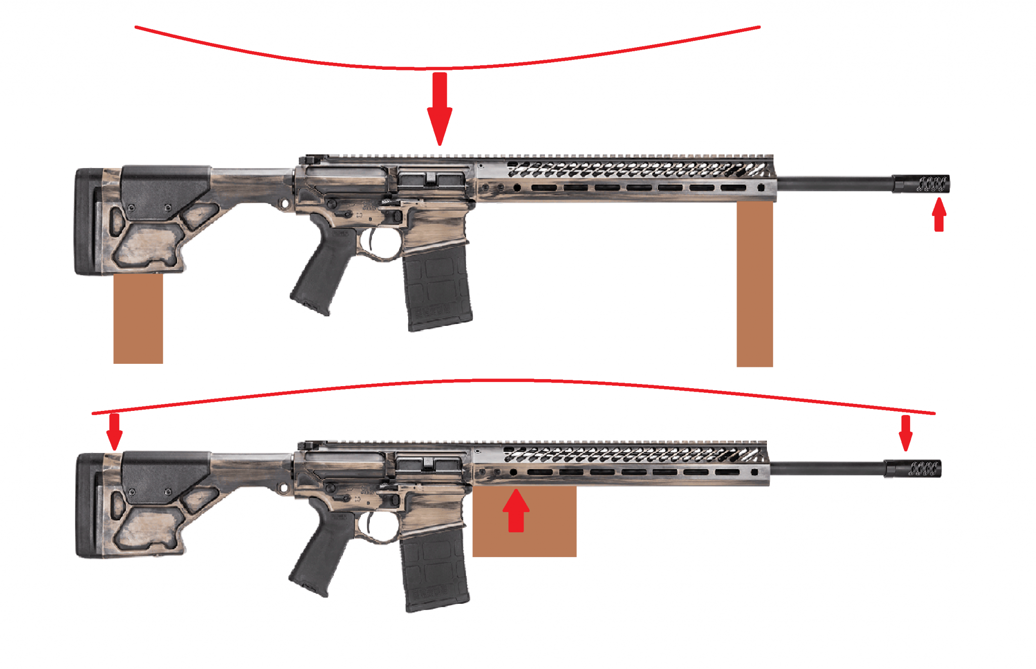

If it's not you, the below pic explains better than words.
The whole point of the Seekins, Mega Monolithic, VLTOR fusion, LMT Mars etc is to minimize this.
Unlike std mil spec, these receivers take the rail off the barrel nut in an attempt to stiffen the upper receiver-rail assembly.
On std mil spec the pivot point occurs right at the barrel extension to receiver face. Likely unnecessary for a floated 16" barrel & 12" rail.
Make everything longer and heavier it becomes more pronounced.

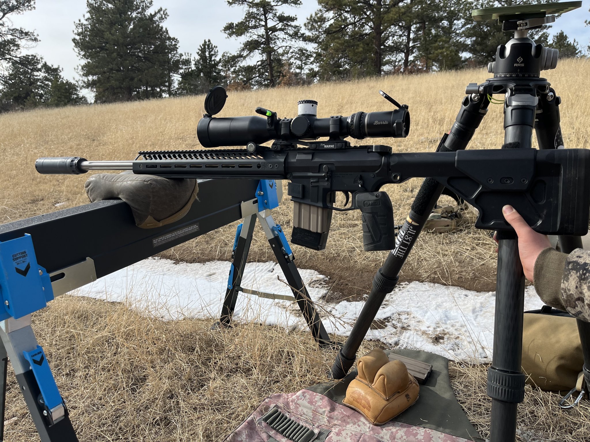

I played around a bunch on another target and seems when I gripped over the top of the handguard and pinched the bag on the barricade it was throwing them low as well as I was putting quite a bit of pressure into the bipod yesterday.
I lowered the pressure on the bipod and stopped gripping over the handguard and the results look pretty consistent, much better than yesterday. The only weird one is the bipod slid back close to the magwell was still low and was really unstable.
Top row was with the can on bottom was can off minus the group circled, that one I just wanted to double check the results from the top row.
Looks like it was shooter error and just need to learn how to shoot this rifle different than my bolt guns, or the bolt guns just do a better job masking my poor form.
Looks like poi was better with the can off. Your zero would need to adjust down, but 3 of 4 were close on elevation without can.
Still the trend is when gun is supported front and rear = high. Center support = low
I rarely shoot the positions #2 & #4.
For #2 about the only time I pull the bi pod back is for movers to reduce how far I have to arc the back end around to chase them. The closer the mover the farther back it comes.
#4 I typically have it on a bag in front of magwell + rear tri pod support.
For the most common positions #'s 1 & 3, Your target shows advantage going to can removed.
I have never shot with the bipod that far back. I used to slide the bipod about 1/2 way back to shoot off barrel tops but now use a bag. And position 4 was simply to test the theory of flexing. I don’t see any use shooting like that in reality.
Without the can certainly seemed more consistent but the rifle typically shoots better with the can on and I know I perform better suppressed, I hate muzzle blast. This has certainly opened my eyes and will be doing more testing in the future to confirm these findings.
