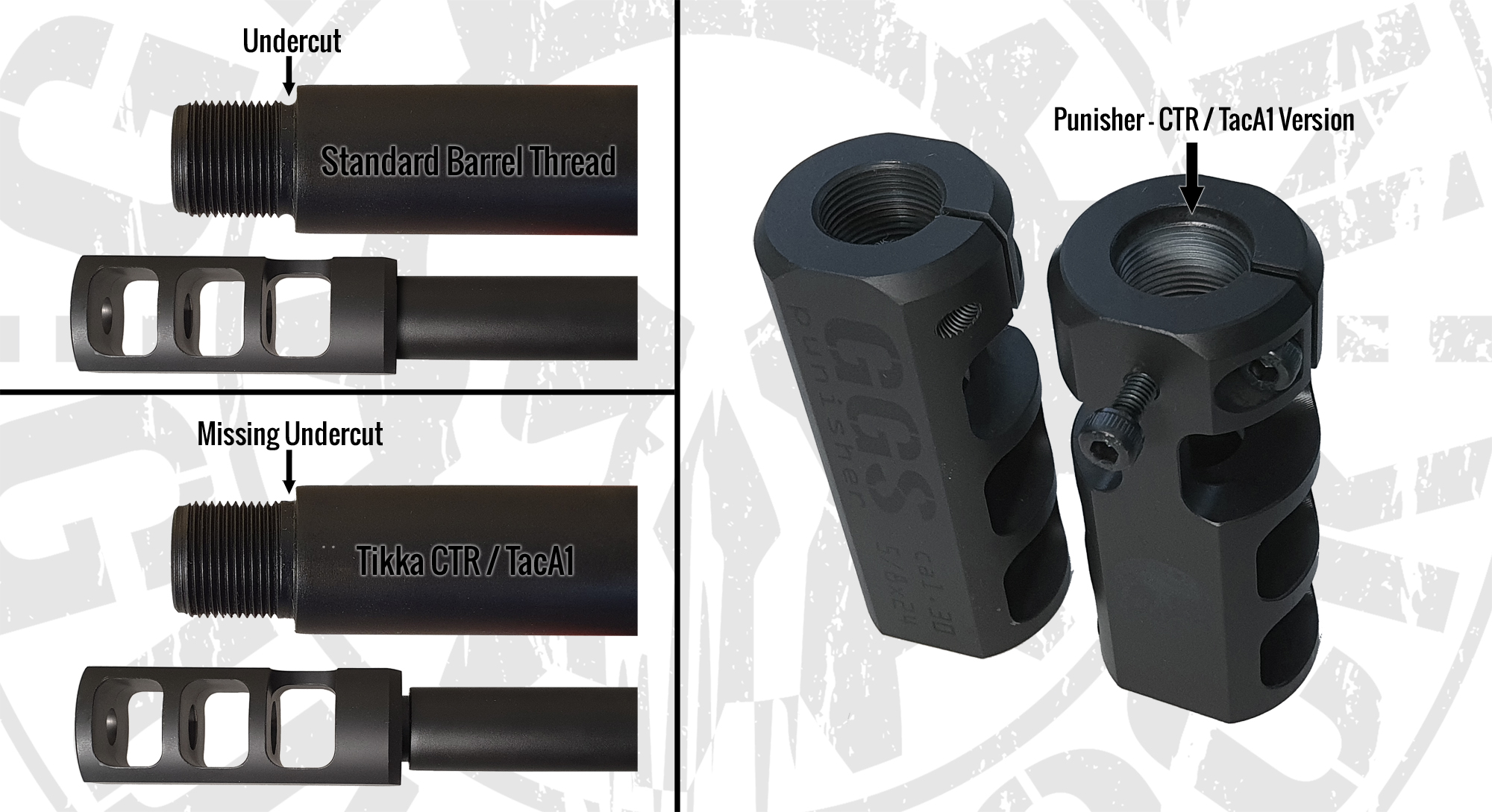

I am suspecting, that the F***** up threads on the CTR ( they have corrected it since they made mine ) have something to do with it. The muzzle threads have no "undercuts". I am suspecting it interfear with the mounting of the supressor when warm. I have attaced a picture so you can see what i mean with no undercut.

The relief cut is meaningless, it’s called a shoulder, the back of the can married it.
Im not sure i understand what you mean. With the missing "undercut" on the CTR ( The first models had this missing undercut, if yours dont, you have a example with a barrel made after Tikka/Sako fixed it ) and with this missing undercut, the supressor cant be screwed all the way down, the threads on the supressor will screw down over the little piece where there are not threads, and in some cases you will ruin the threads on the supresoor. Its like they forgot to thread the barrel all the way, and did not make undercut either. it was a pretty big deal in the shooting community in europe, and many sent ther rifles to a gusmith to get it fixed. Some supressors have a built in cut with no threads in the beginning of the thread, so they can screw over the missing undercut of the rifle, and have no issues. But many supressors dont ( at least in the eu, maybe its diffrent in the us? ) Hope it makes sense. The picture you posted, is how a thread should be made. The CTR models with missing undercuts, are not made like that. Still, im not saying its not mirage, i just suspect it isent the problem.
Im not sure i understand what you mean. With the missing "undercut" on the CTR ( The first models had this missing undercut, if yours dont, you have a example with a barrel made after Tikka/Sako fixed it ) and with this missing undercut, the supressor cant be screwed all the way down, the threads on the supressor will screw down over the little piece where there are not threads, and in some cases you will ruin the threads on the supresoor. Its like they forgot to thread the barrel all the way, and did not make undercut either. it was a pretty big deal in the shooting community in europe, and many sent ther rifles to a gusmith to get it fixed. Some supressors have a built in cut with no threads in the beginning of the thread, so they can screw over the missing undercut of the rifle, and have no issues. But many supressors dont ( at least in the eu, maybe it’s diffrent in the us? ) Hope it makes sense.
When you screw the can on does the back of the can meet the shoulder on the barrel? Im guessing it doesn’t if your threads look like the image you posted.

Thing is, when i first got the rifle, i did not know this about the threads.
The can DO meet the shoulder on the barrel. However, i suspect that the threads on the supressor is squeesed, since i just screwed it on when i first got it. I cant remember if there was resistance when i screwed it on the first time. I cant visually expect the relevant part of the supressor threads, since it is a telescope type supressor ( dunno if it called that in the US, but it means that the first half of the supressor actually goes over the barrel, meaning the threads are hidden deep inside the supressor ) i will try and find a little camera that i can inspect the threads with. however, i do suspect that the supressor seating somehow gets affected when it gets hot.

We call that a reflex suppressor over here. Is it direct thread? How can you tell if it is touching the shoulder if its an over-barrel/reflex mount?
I dunno what direct thread means, but if it means that the thread starts without a "blank" start, i dont know since i cant see the threads good enoug.
I cheked if it was up against the shoulder, by making 6 very little dots of paint from a Posca pen around the surface of the shoulder. I then screwed on the supressor, and all the smal dots where smeared out when i took the supressor off again. Hope it makes sense.
If direct thread means, that its screwed directly on the barrel without adaptors and stuff like that, then yes it is a direct thread.

Im sorry if my english caused you to misunderstand, but my CTR barrel do not have a relief cut. My TAC a1 have relief cut. My Tac A1 do not have the same problem as my CTR. I have tried the exact same experiment with my TAC A1, same day, same range, same ammo etc, and the TAC A1 with a reflex supressor do not start to print higher with a warm supressor. Sry for my bad english again. Im not sure what "MV" means?

I know many ppl have had problems with the CTR muzzle threads. It is a legitimate thing to suspect, that it could have a influence in the problem.

What exactly about the threads would cause a shift with heat?

I am suspecting, that the F***** up threads on the CTR ( they have corrected it since they made mine ) have something to do with it. The muzzle threads have no "undercuts". I am suspecting it interfear with the mounting of the supressor when warm. I have attaced a picture so you can see what i mean with no undercut.View attachment 8151958
Well, you're right with the missing 'undercut', I have that in my TACT A1 as well.
