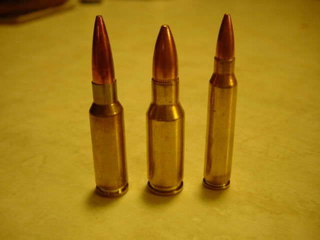

You MAY want to look at an upper chambered in 30RemAR,fits on the AR15 lower and gives VERY impressive ballistics
30RemAR in center,6.5 Grendel on left,5.56 on right
