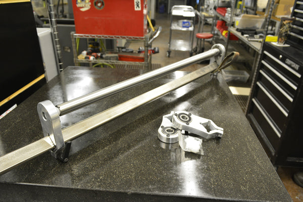

The tube below was attached to my drill and I hung it vertically with my left hand. I held the scotch-brite in my right hand and
went down the tube at a constant rate to create a uniform circular pattern. It could easily pass for machine produced. A higher
polish would just be more time and finer grits.

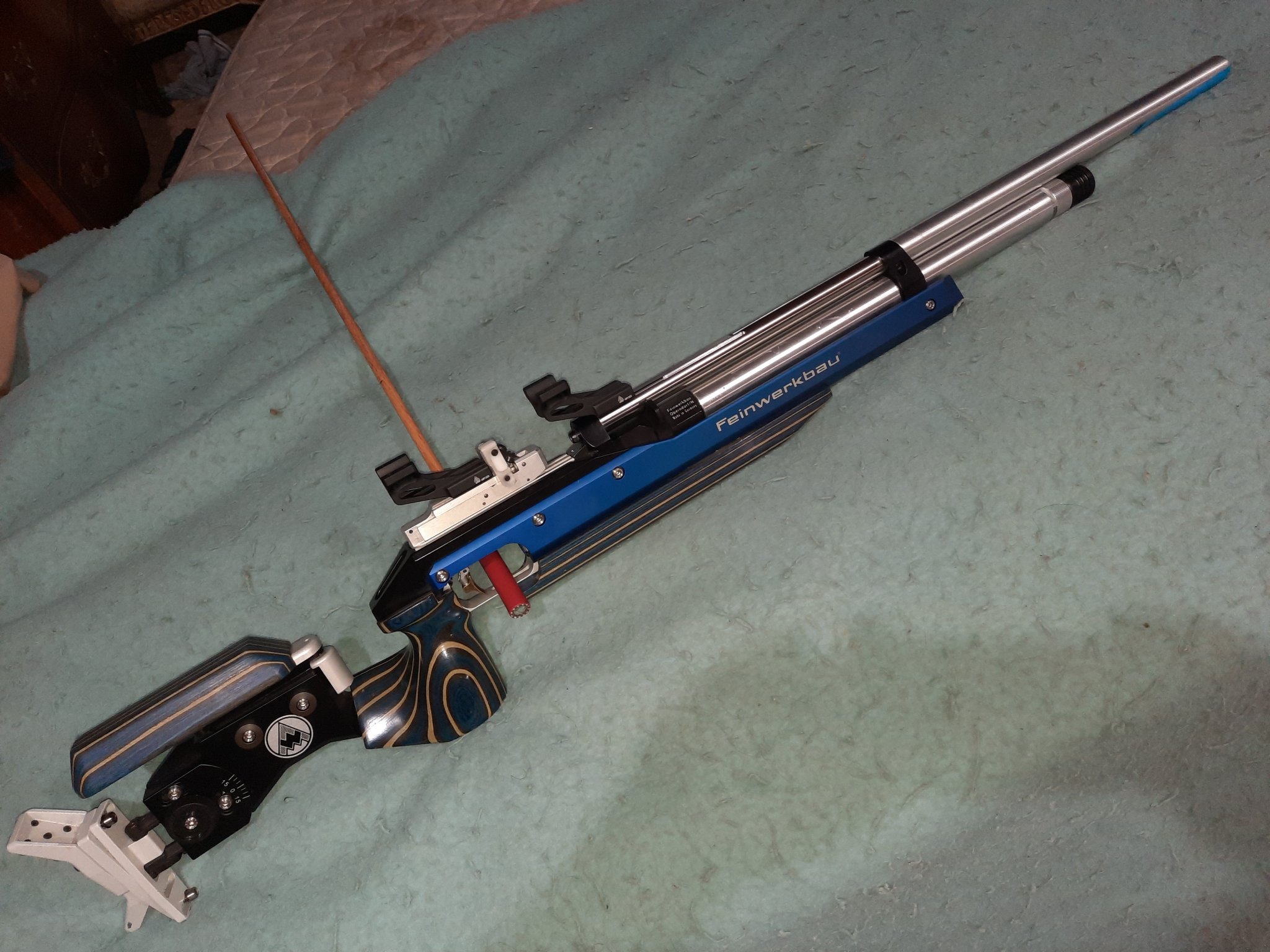

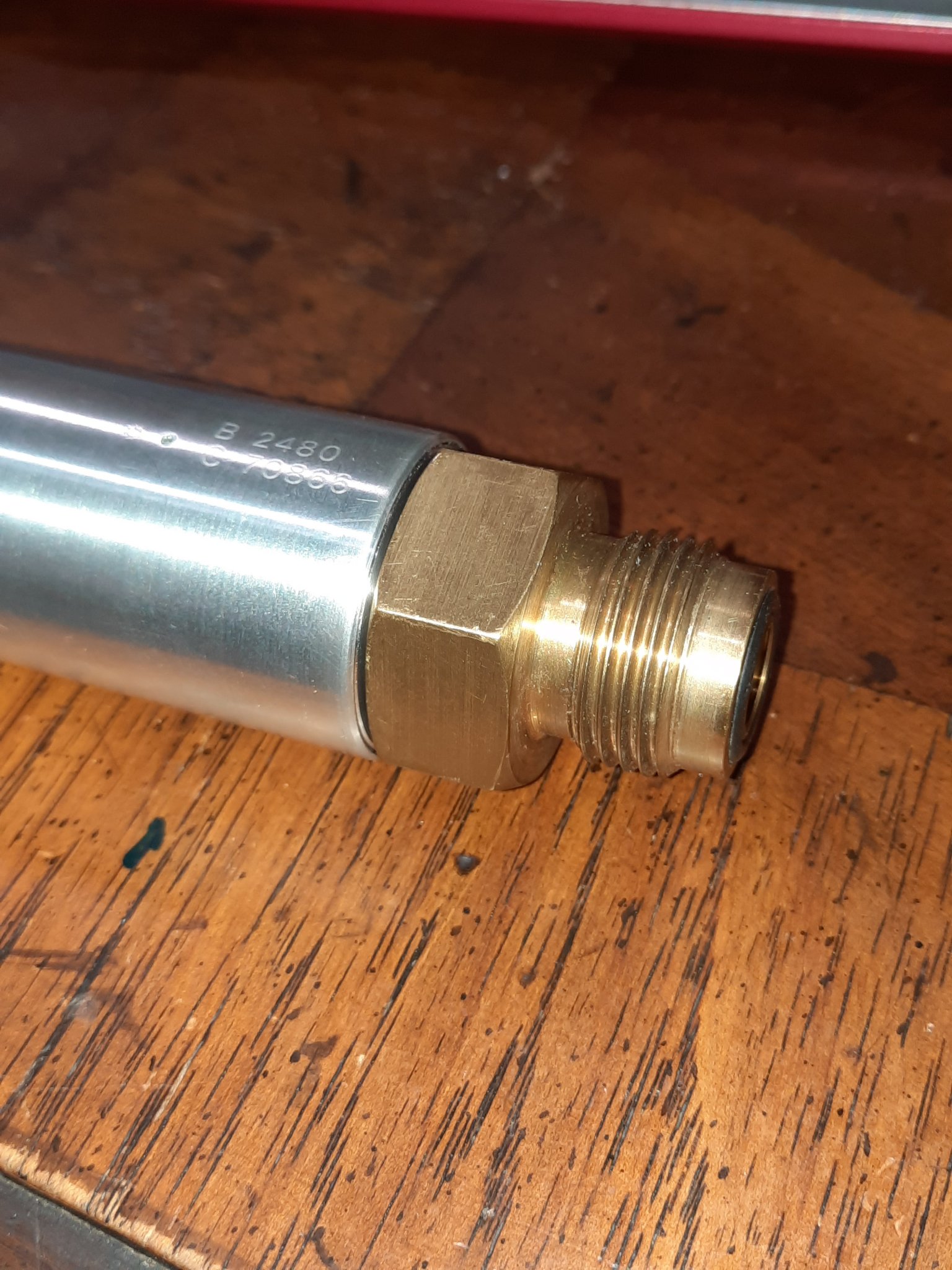

I have polished a few long items like the lower air tube on my FWB air rifle. I find a way spin it in my drill and spin it. In
it's case i used Scotch bright because I wanted something other than a mirror finish. On one end I was able to grab onto the Parker
quick disconnect. On other objects that don't have ready made piece to hold onto, I have used a socket about the same size as the threads and used Duct tape to connect them.

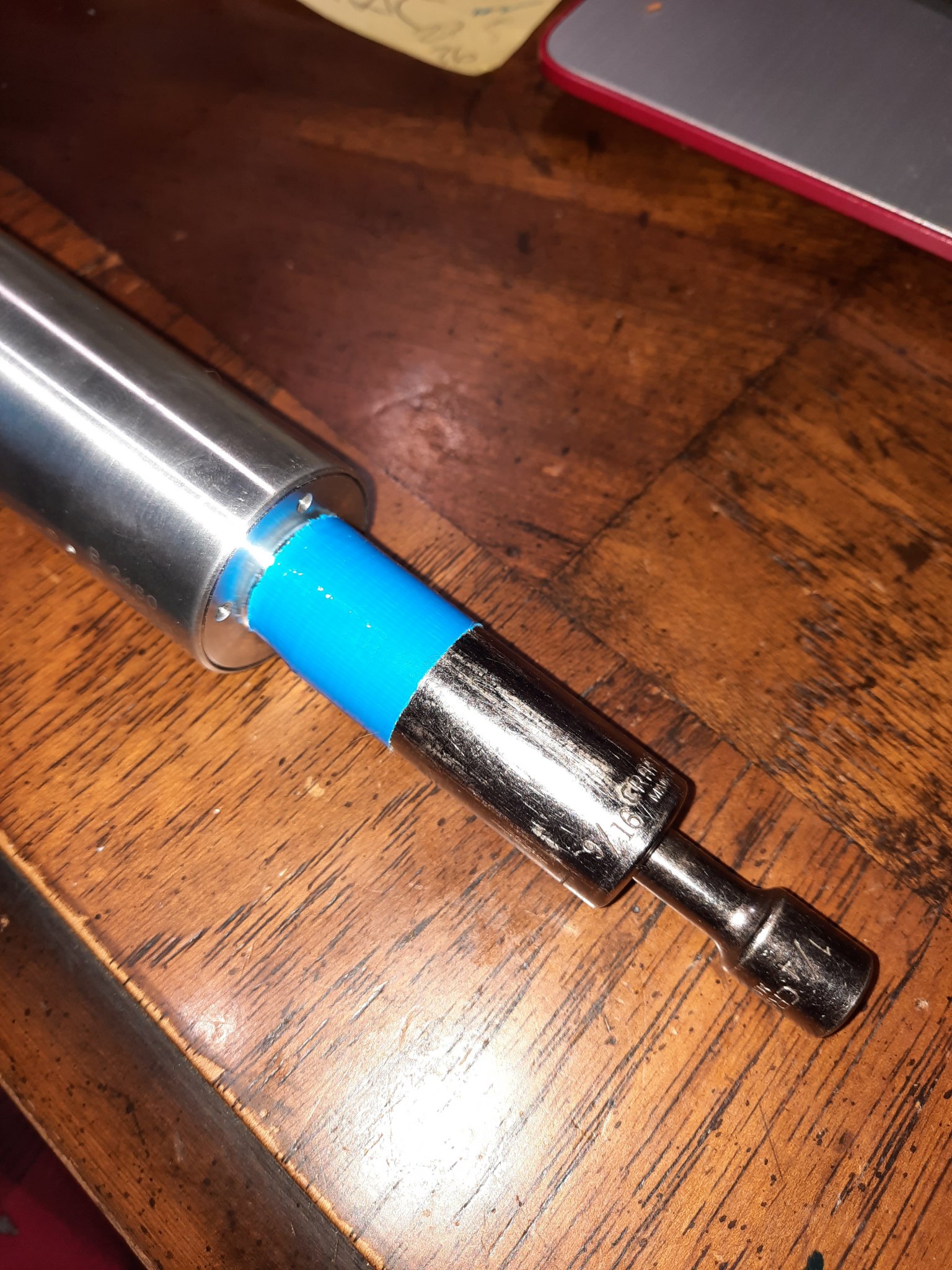

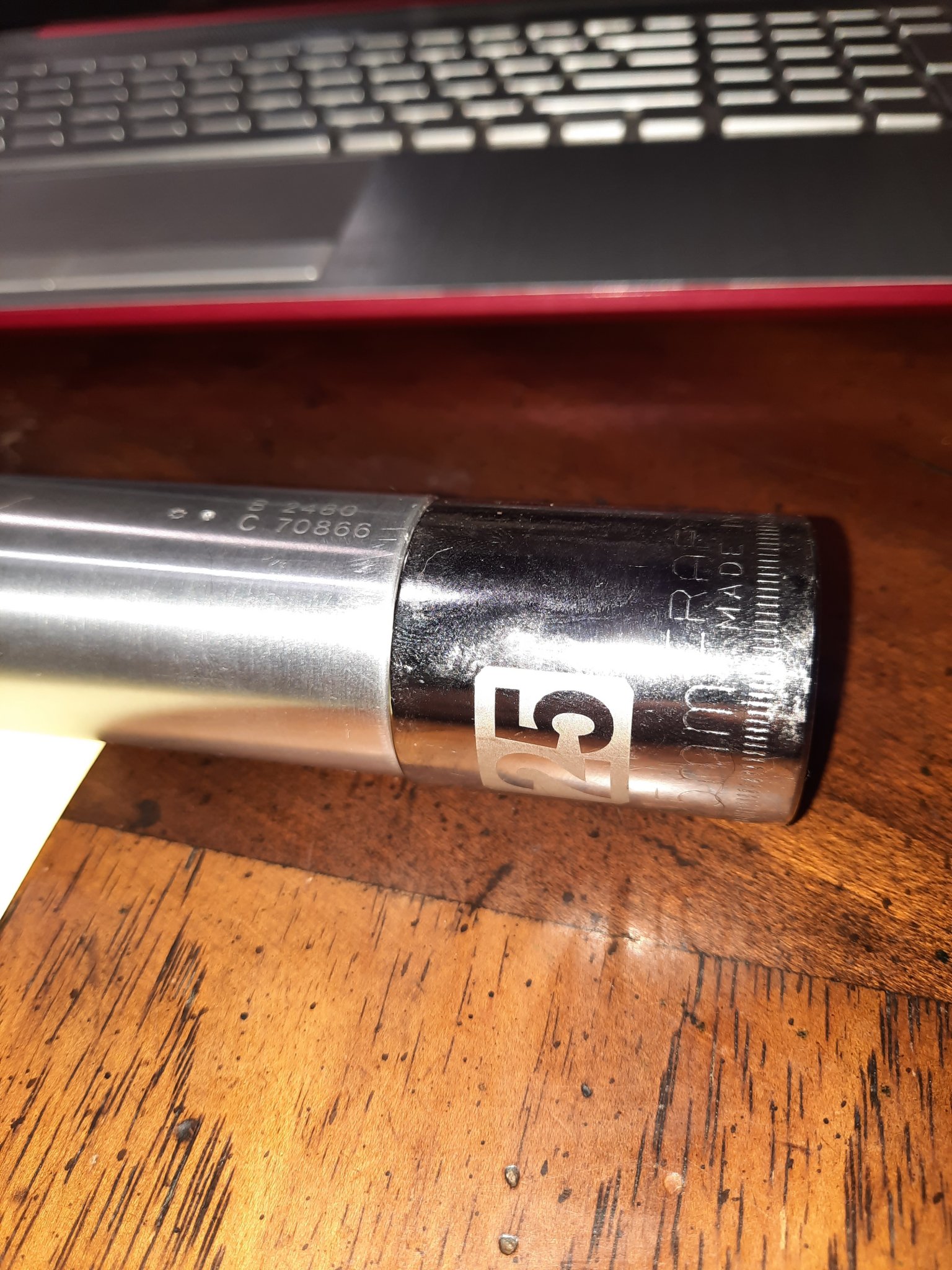

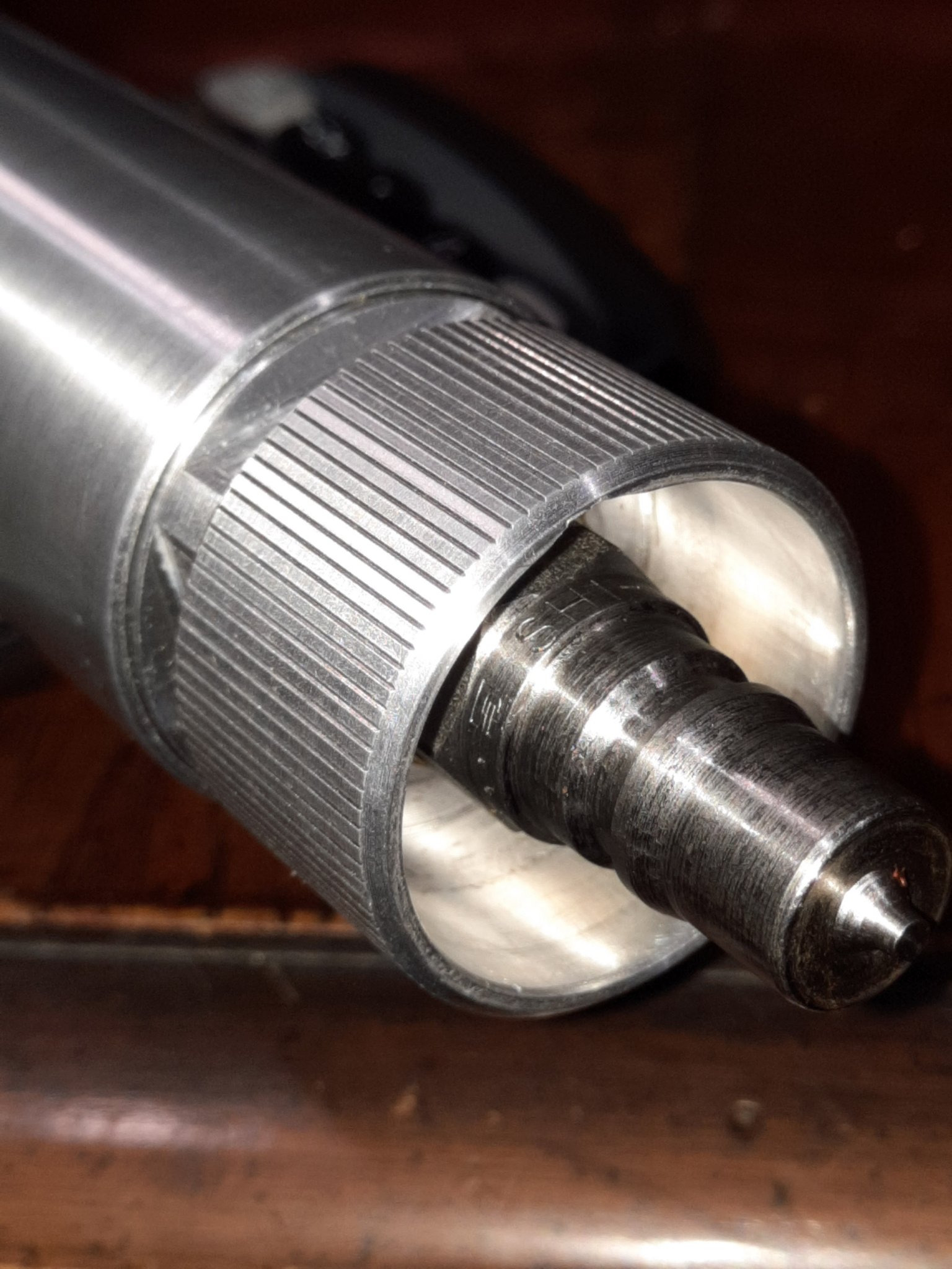

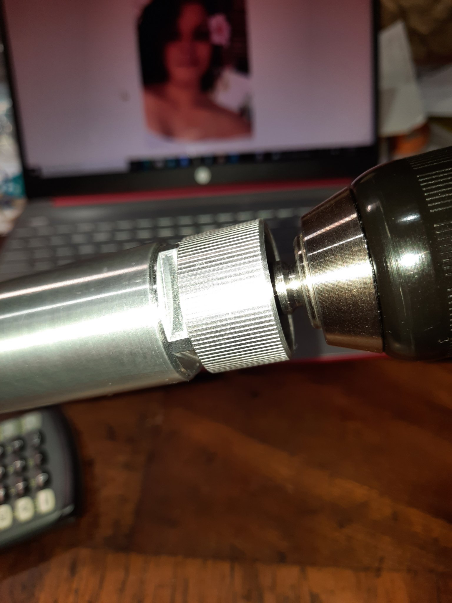

In the case of a barrel, I would likely protect one end with duct tape and get a socket that has about the same diameter and then
use a couple of reducers to get to 1/4" drive. A 1/4" drive will fit in a half inch drill. ( Photo #2 ) I would hold it vertically and spin it
at a uniform speed until I got to the duct tape. Then I would hold the other end the same way to finish the end that was covered by
the Duct tape. By the time you got that far you would have learned how to start / stop and blend the finish. To blend, you start
higher than you need to with your hand slowly closing on the barrel.
If you can hold the chamber end and run it's entire length, that would be best.

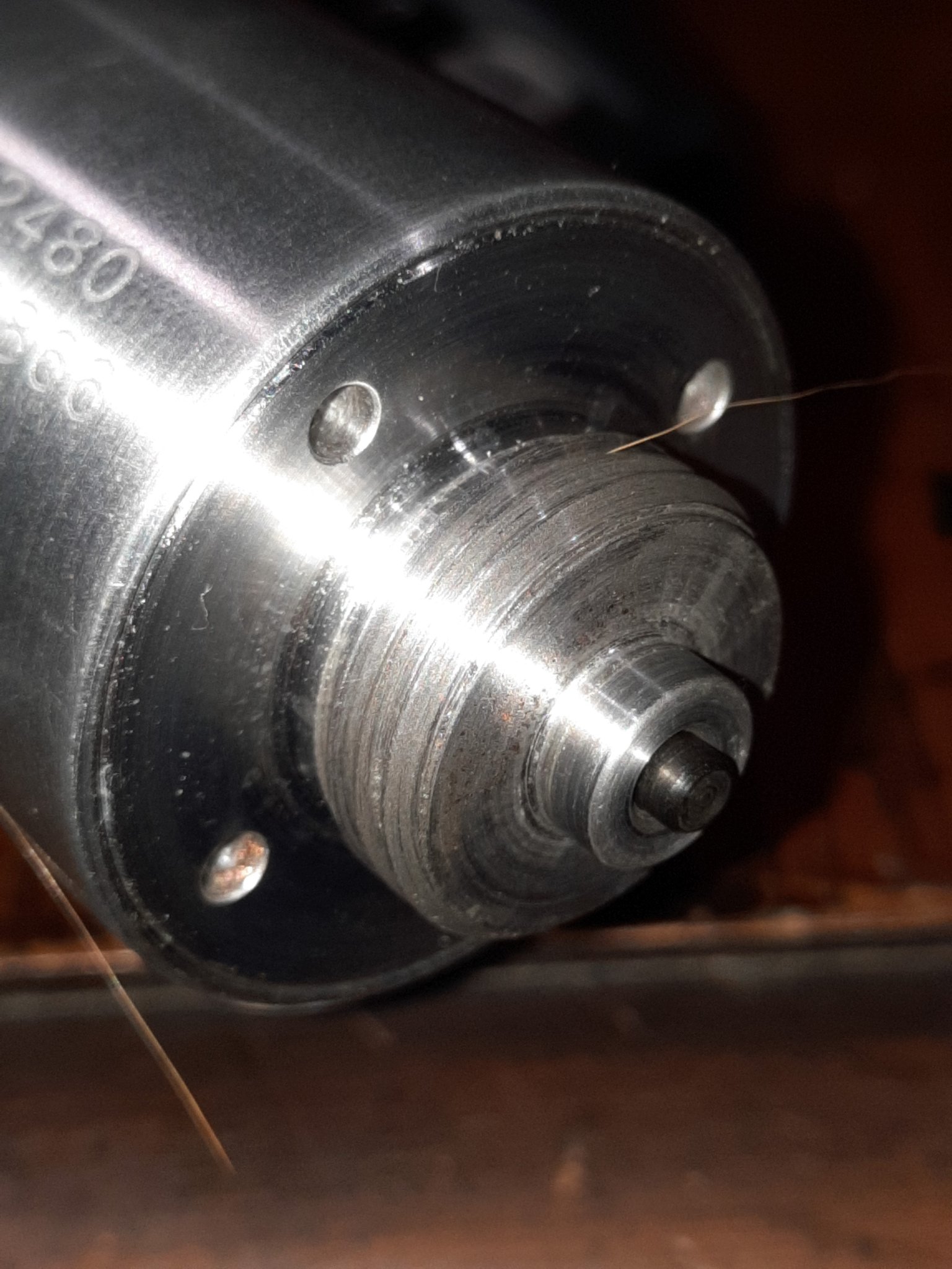

Is it the right way to do it.... Hell no !! I no longer have a shop at my disposal. :-( You just need to use the tools you have on hand.
I may have even used the brass filling adapter to grab the tube, protect the threads and then used a socket on it in my drill.

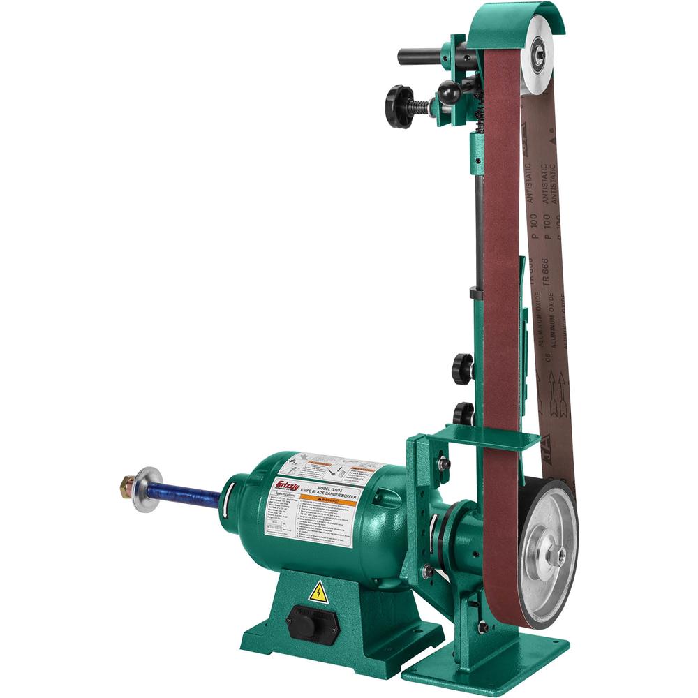

The easy way:
Now, on the sander from Grizzly... When/if you buy one, step one is chopping some of the vertical mast off. Set it up to use a 48" belt instead. This will save you hundreds of dollars per year on belt costs. If all your doing is fluffing/buffing a barrel contour, this will set you up for life. It would be "better" if this grinder had a 3rd idler wheel on the back to help with belt tracking when using. It's not the end of the world, though. With a little practice, it's pretty easy to keep the belt tracking on center of the lower driver wheel. You'll be "freehanding" this and keeping the barrel away from the steel backer plate down towards the bottom. I just removed the work surface/backer completely because the added room is nice and not having it there eliminates the backside of the belt trying to catch itself on fire when you are leaning on it.
Buy your belts in bulk. 120/180/220/320/400 grits. If your going to mirror polish, that is a whole other rabbit hole. You'll want a Baldor buffer and a healthy assortment of grinding compounds, various wheels, and polishing rouge.
I bought my Grizzly almost 15 years ago. Runs like a raped ape and we hang north of 100 barrels per month.
