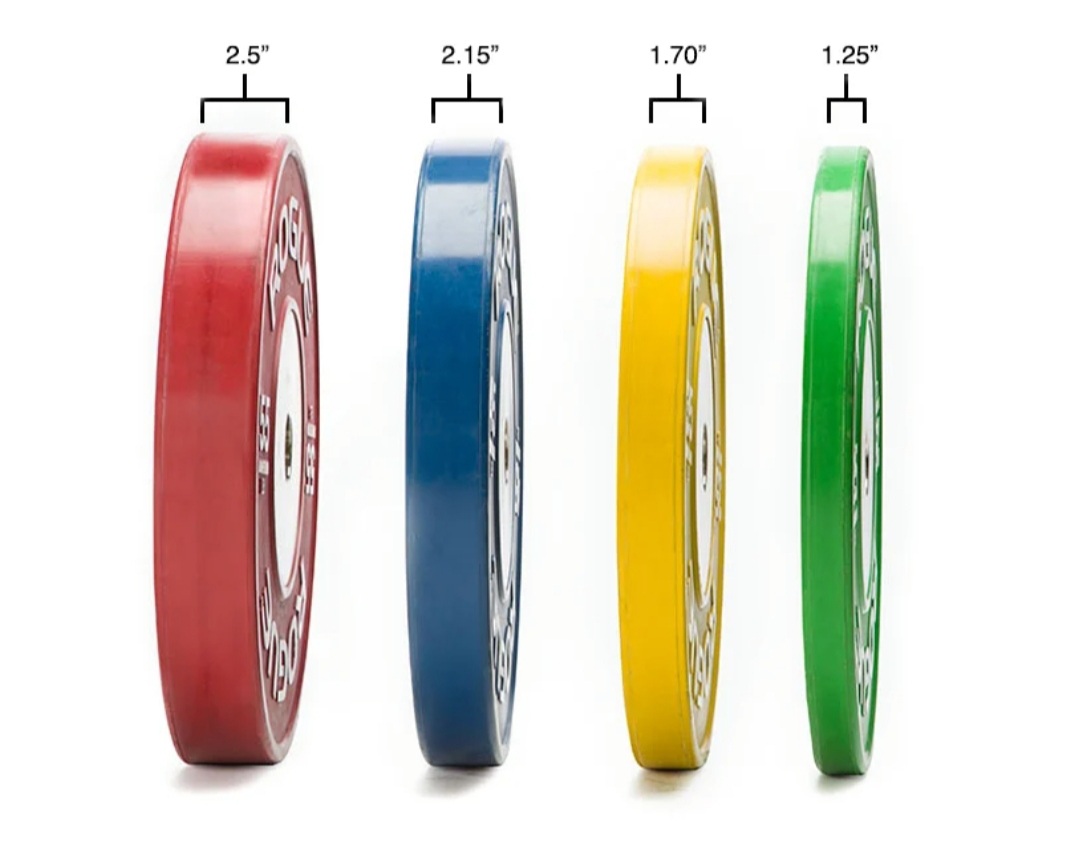

    If you get comp bumpers, you wont run out of room on the bar unless you are an absolute monster, we're talkin world class type strength. The rogue urethane ones though you may, those are thick.
    I'll play devils advocate...if price is no object, why not just get all comp bumper plates? Plenty of folks squat and DL with those, you dont need iron plates specifically for squat/bench/DL.
    16.4" sleeve on most rogue bars...pic below for ref.
    With red 4x55s, and 2x45s per side, you get to 665 and still have room for a clamp...6 55s per side for 705 total if you can find a clamp to grab the last 1.5"
    I don't pull anywhere near that either, just saying it can be done.

    @Vandy321 - I appreciate the reply. Right now im looking at plates that Rogue offers only, not saying theyre the best but they seem to be stocked most frequently. Really down to the Comp Bumpers, Urethane Bumpers, Calibrated Steel plates or Olympic steel plates. Looking at the order i was building I can get 1100 lbs of olympic "standard" plates for $1358 pre tax and $120 ish shipping. Bumpers are much more costly with the Urethane coming in at 2240 pre tax and pre shipping for only 760 lbs. Bumpers like you said are much thicker although the Urethane are 55mm for the 45lb which isnt bad really. My bar is the Ohio Bar at the moment with plans to get a hex bar and Ohio Power Bar soon, pending inventory.
