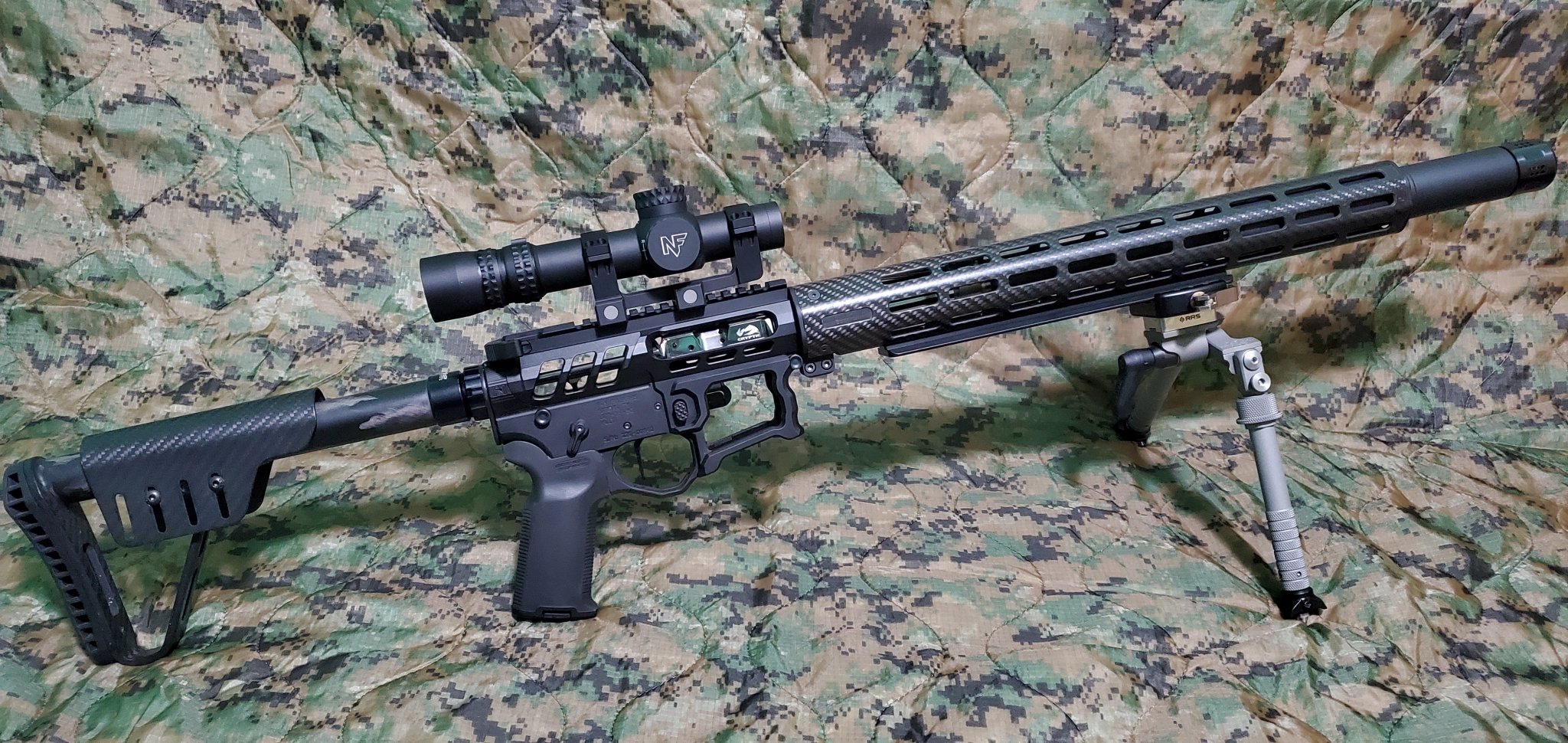

I have the 17" Faxon Firearms carbon fiber hand guard with a V7 titanium barrel nut. I wish I had gone with the Smoke hand guard at a custom length. The two nut clamp on the Faxon just gets in the way of a mag well grip, but it's just nitpicking.
I have the Smoke stock with the closed shoulder, cheek rest, buttpad upgrade, in rifle length. They sell a carbon fiber spacer that goes in for carbine buffer use. Also use their castle nut and carbon fiber buffer plate.
The other two buffers lack things, like a place to mount a QD cup for a sling, or need a buffer tube which adds weight. I looked at both of those when I built mine.
With all that said, with the F1 Firearms skeletenized receiver set, skeletonized Cryptic coatings BCG, Master of Arms adjustable titanium gas block, 12.5" Proof carbon barrel and the afformentioned stock and hand guard. It's just a stupid expensive range toy or hunting rifle IMO. Nothing I would feel comfortable grabbing if my life depended on it.
Take the bipod and RRS rail it's 7 lbs 10.3 oz. Remove the Sandman Ti can it's 6 lbs 6.9 oz, but then I would need a shorter hand guard. Can I make this lighter, yea sure, but not at the expense of comfort.
