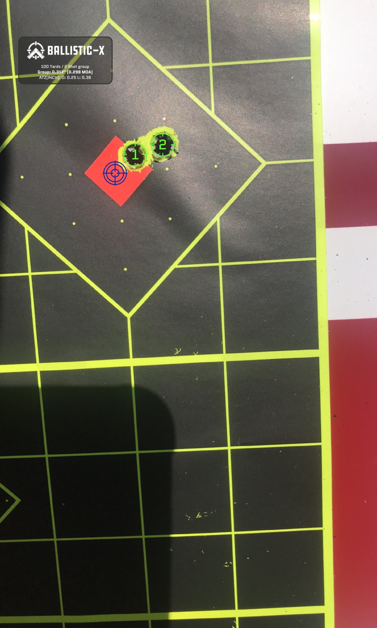

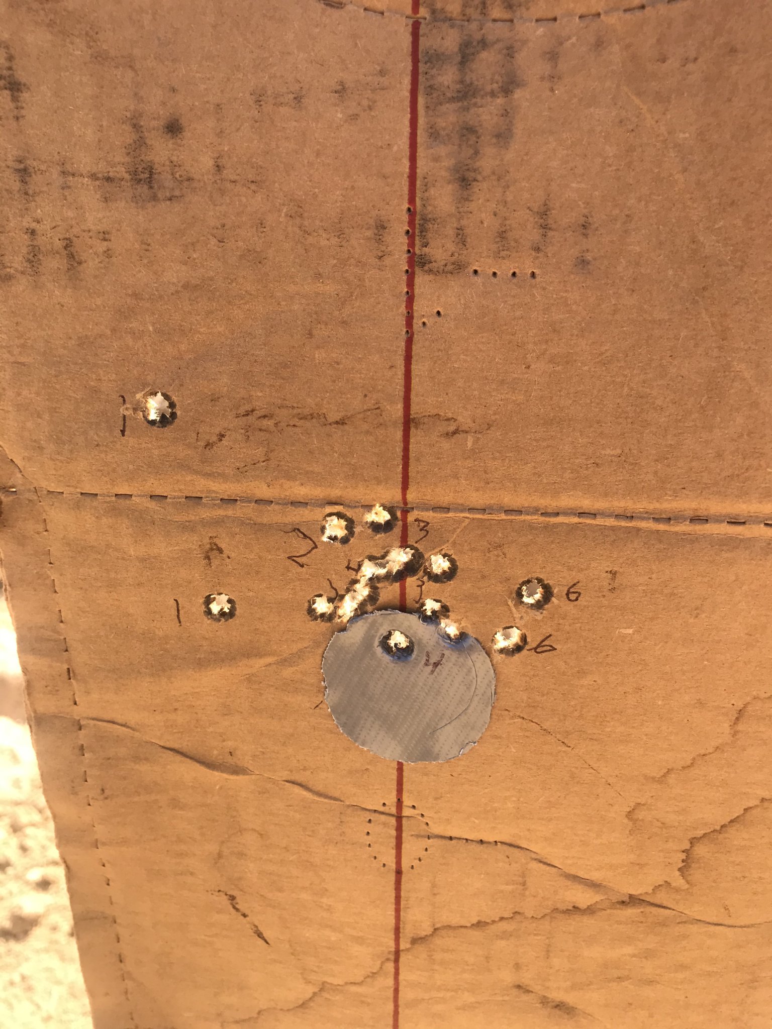

Here’s the shot grouping, at 100 yards:
I expected em to string up vertically a bit more
should I have used coarser increments , like 0.3 grains? Larger?
should I have done this at 200 or 300 yards?

That’s not a group, it’s a pattern! 6.5 Creed shotgun, well I never!
First, may I suggest setting up a new dot for each charge. That way the results will be easier for you to see.
Second, two shots is not enough to tell much from. I would load 5-10 with each charge.
Third, what is your baseline? What does the gun shoot with factory ammo or known handloads on a consistent basis? Hard to tell what your getting for results when we don’t know what the gun shoots ‘before’ laddered handloads.
4th, what is the gun? And scope. If that is a bolt gun from bags with a good scope at 100... something is wrong with the gun, hour hold/technique, or the ammo. If it’s a semi with a red dot... makes more sense. That looks like a 1-2” ‘dot’ of duct tape. I would expect any 6.5 at that range to group better or, as you state, vertical string.
Last... twist rate?

Was looking for a pattern, more than a group,
As that target represented 10 different charge weights
I thought each hotter load would be slightly higher that the prior one

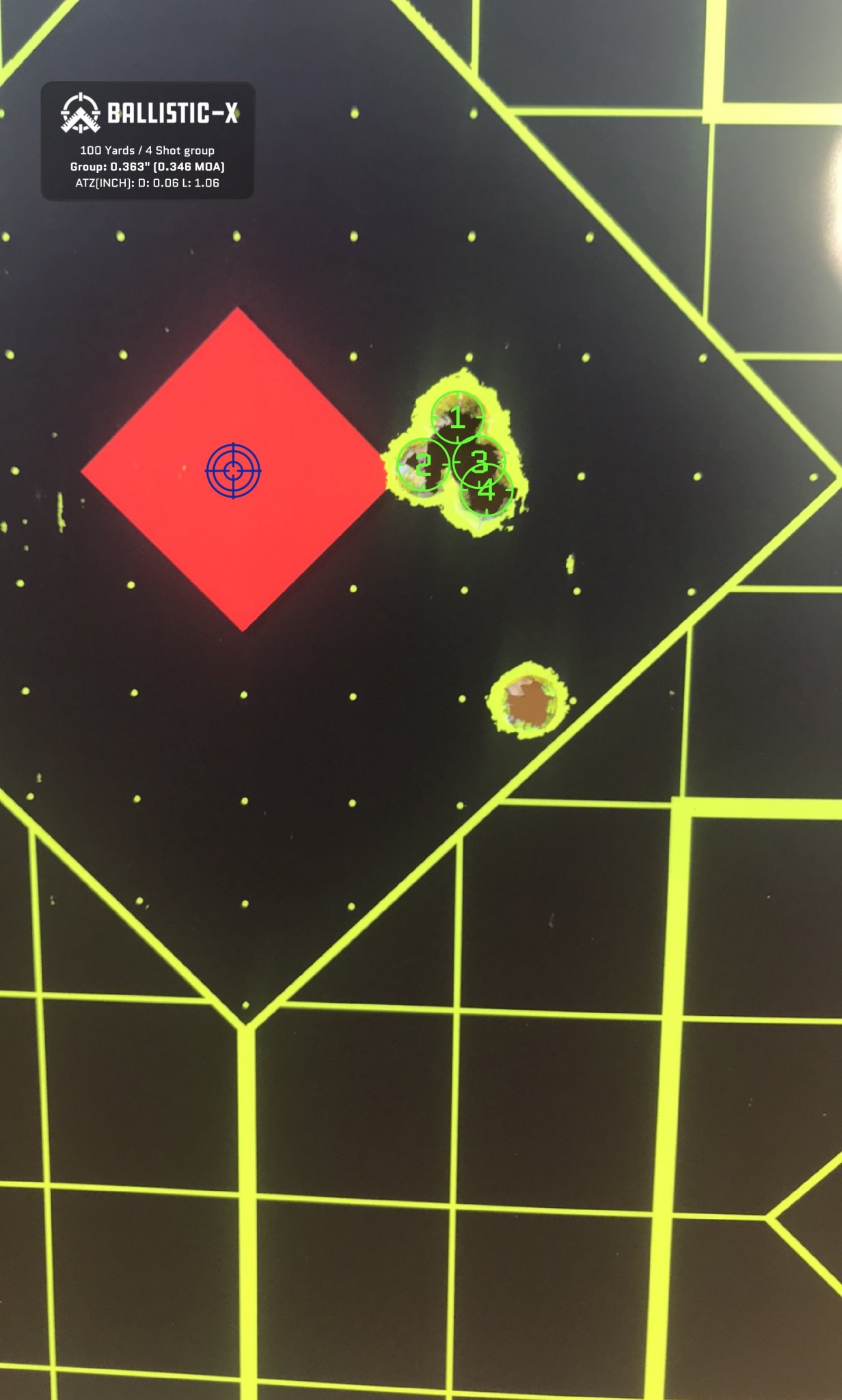

Is this cold bore? or cold shooter:
1st target is at 100 yards
Hornady’s Match 120gr ammo
New Sako s-20, 1:8” twist, 24” barrel
Bench with front bag, and squeeze rear bag
Vortex razor amg
four shots grouped to .36 moa
However, the flyer to low right was my FIRST shot / coldEST bore shot
Would one ordinarily expect THAT MUCH deviation from a cold bore?
(considering the gun and I can group)
or did I just pull the first shot, and that much error was ME, rather than a cold bore

First group is 1.21 moa, counting the flyer

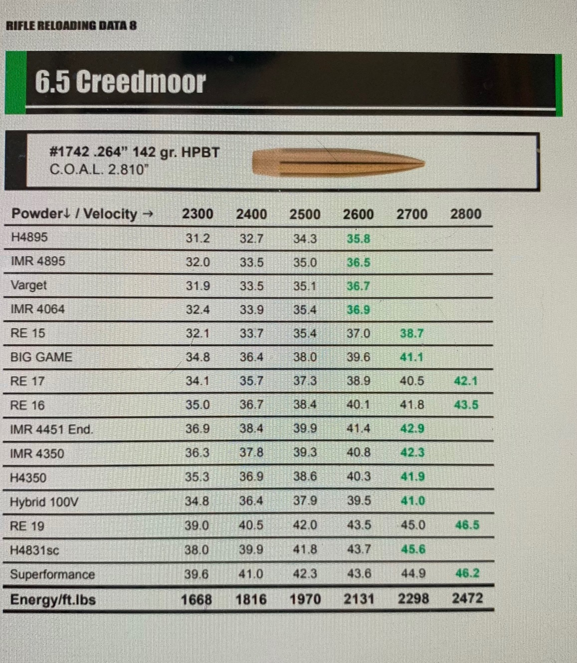

From Sierra Web site.
Some baseline data for 142 Gr.
Sako S20 with a good scope should be shooting much better than that, even with ladder charges. You could be a grain or more off of powder at 100 and not be 'patterning' like that. Also those cold bore flyers are 'way' off where a Sako should print cold.
By way of comparison, my TRG will send a cold bore first shot 1/4" - 1/3" up and to the left consistently. No Sako worth its salt should be putting out a group like that at 100 even if you are mixing up all kinds of stuff.
Before going to a ladder charge, may I suggest loading a box of 50 at, say, 34 grains. Fire the whole box of 50 in groups of 5 at small dots. See what you get. If they are patterning or all over the place... check equipment and technique (both loading and shooting).
Your long range groups with (what I assume are factory rounds) are good. And should be indicative of what you and your rifle can do. I would suggest getting a baseline on your reloading technique with a decent sized batch of rounds. Then start working up and down from that baseline to get the group tighter.
But I think that jumping into reloading 'first' with ladder charging and changing up your recipe right out of the gate is just going to confuse you or frustrate you.
