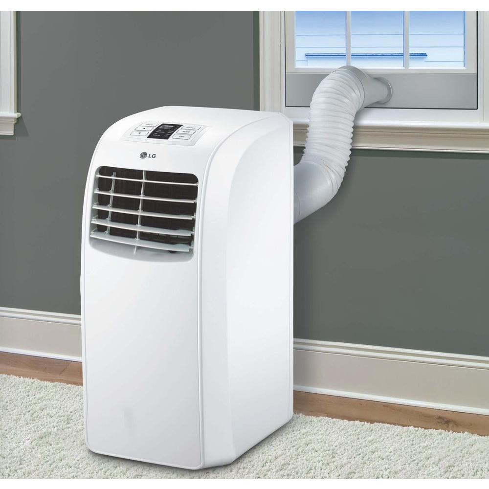

Anybody have any experience with these. Good brands? Will they work as supplemental cooling?
My home office is on the hot side of the house. Crappy contractor home (as most are where I live) and the office is at the end of the ductwork. Truth be told they should have had one extra vent in the room as the heat load is more due to more windows. Bedrooms are 73/74, office & kitchen 79-80. I've dicked around with the vents and lessened airflow into bedrooms but to no avail. Toying with buying a portable unit which, when I bite the bullet and buy a new HVAC central unit may do duty in the garage - not sure how that's going to rig up; but the mini-split for garage was ridiculous. Again, contractor home.....think there would be a spare breaker slot? So, it'd require an additional panel.
Thanks.

The biggest challenge you are going to have is venting the hot exhaust to the outside of the house. Take your hand and hold it over the condenser of your unit, outside. The problem I've got is I dont have any outside openings to vent to and the walls go all the way up with no openings out of the room. The space I've got is too small to dissipate the heat.
If you can get the exhaust out of the building it is equal to a window unit.
If you have a sliding window, you could cut a piece of plywood 12 by the height of the window with a hole for the pipe. Open window insert panel and close against panel when you need to use the unit. Remove panel so you can secure the house.

So a Window sill model is the best option. The toshiba at depot are good enough. I have had great longevity with Sanyo.
the window units can benefit from a leaf Blower and using the air to blow dust and debris out of them as needed.
The ones on the rollers are not efficient. The portable ones... The heat of the unit is in the case. The 12k btu units provide about 7500 btu of cooling as the entire heat device is in the case in the room. The window AC has the hot side outside.
so the portable ones consume 45% more power for the cooling vs he windowsill models.

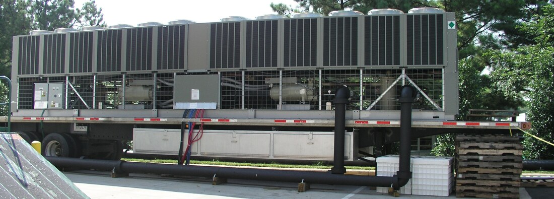

Pete; as a former GI Electrician USMC Utilities Engineer, and also as a computer site manager, I've always sided with excess capacity. If you don't need it now, you will eventually.
IT capacity engineer, "You gotta getta biggah Box, boy..."
We always had to balance the efficiency against the reliability; running at full (not peak ) capacity. With some excess capacity, we could take a breather, but computer capacity needs are always growing.
FWIW, I once had an Osborne Executive portable PC assigned to me; hardly a laptop.
But I'm also open to discussion on that.
Are there difficulties with excess capacity, and what would they be?

I use a Hisense 300sq ft portable floor AC unit from Lowe's in my boys' bedroom, which is on the second story of our house and positioned where it gets full evening sun. Need it basically mid-May thru mid-Sept; set it to 72 during the day and down to 68 an hour before bed. Works GREAT, plenty of white noise, only downside is the exhaust vent doesn't look asthetically pleasing from outside but its on the back of our house so who cares.
Already had the unit from when the central air failed at our hold house over Memorial Day weekend 2018 and it took 9 days to be replaced...a hell of a lot cheaper than having a second central air unit installed in our current home (which probably will happen in a year or two).
I bought this same unit yesterday for my reloading room. Looks like it is going to work great. For something as a supplement I think is is a good investment.

Greg,
Im not sure about the 10A as I just checked the box and it said 15A.
But I have a big TV and ceiling fans/lights another small window unit in the office on the same breaker and never tripped.
My power goes out quite often and the troy built 7k watt genny runs 3 ACs and 2 fridges along with TVs and wifi so these A/Cs cant be drawing that much power.
96 deg today and this De Longhi AC kicks ass and so quiet.
