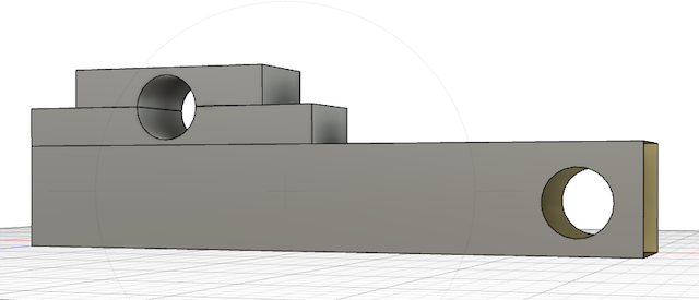

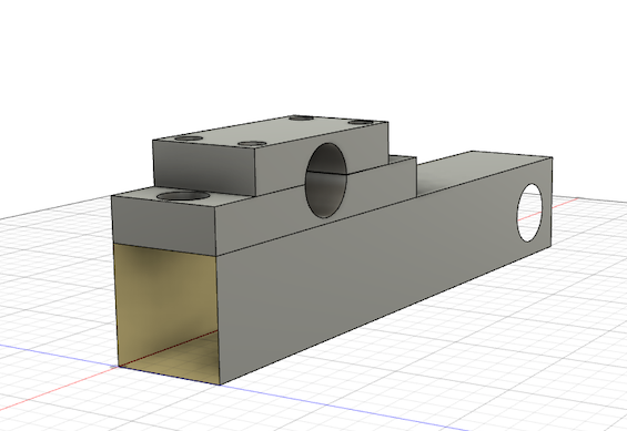

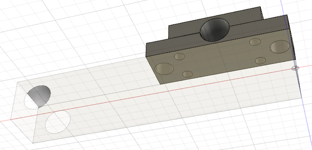

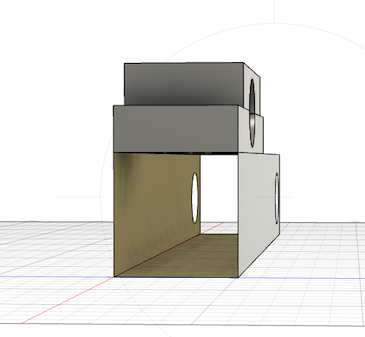

gonna try to draw up a model for you.

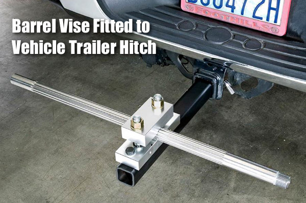

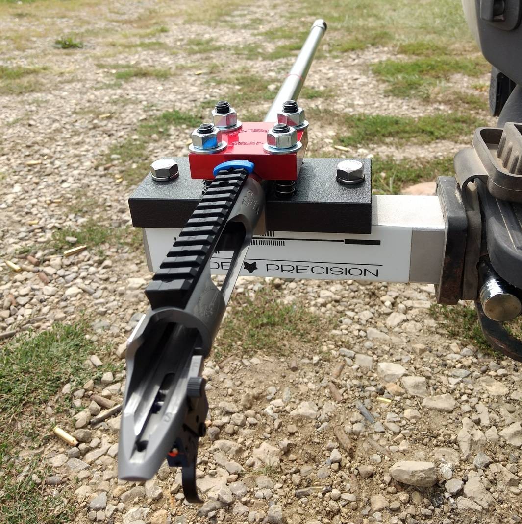

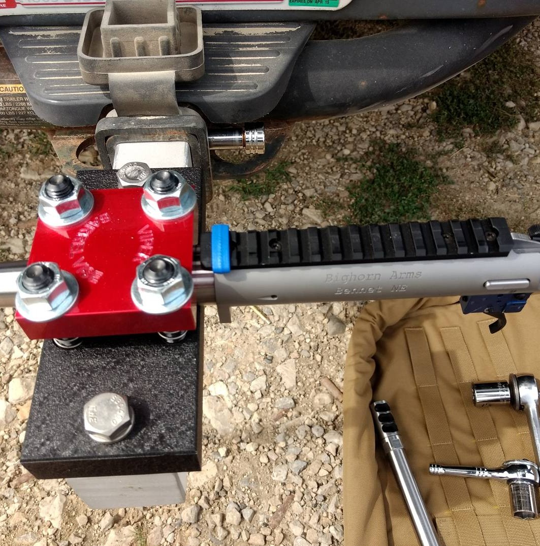

found this photo on accurateshooter:
@want2learn wish you would've found that before i designed it on CAM!! hahaha
@Greg0326 This is obviously with the 21st century on top. I have an 11in arca rail that you could just drill matching holes for on a piece of square pipe. same concept though. I'd probably find some way to shim the square pipe in the trucks receiver though, take up the slop of shitty tolerances. Just me being anal though.

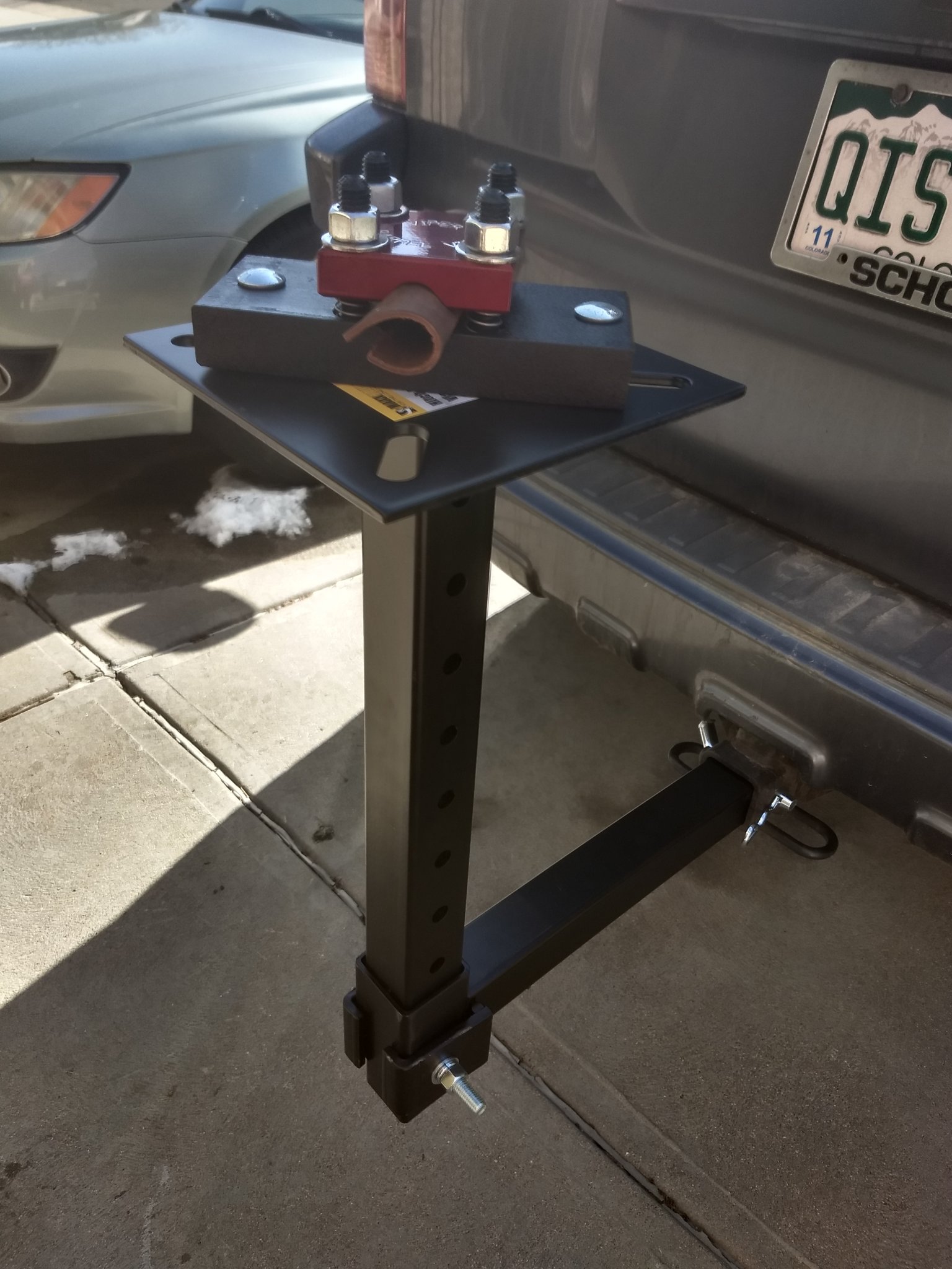

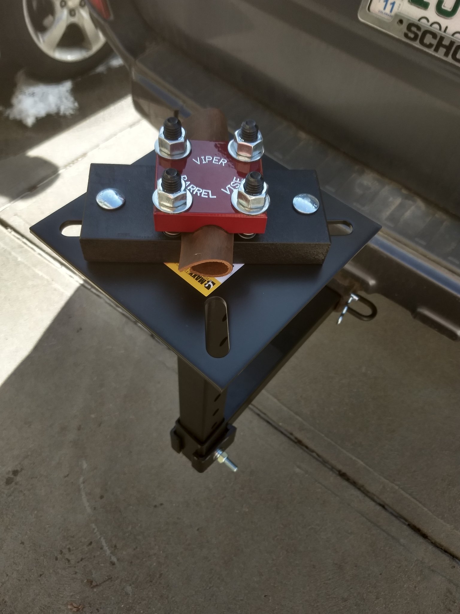

That’s exactly what I’m doing. I found some trailer hitch vise table on amazon. I’m going to pick one up so I can at least change barrels out while standing and use the truck bed as a table to set everything on.

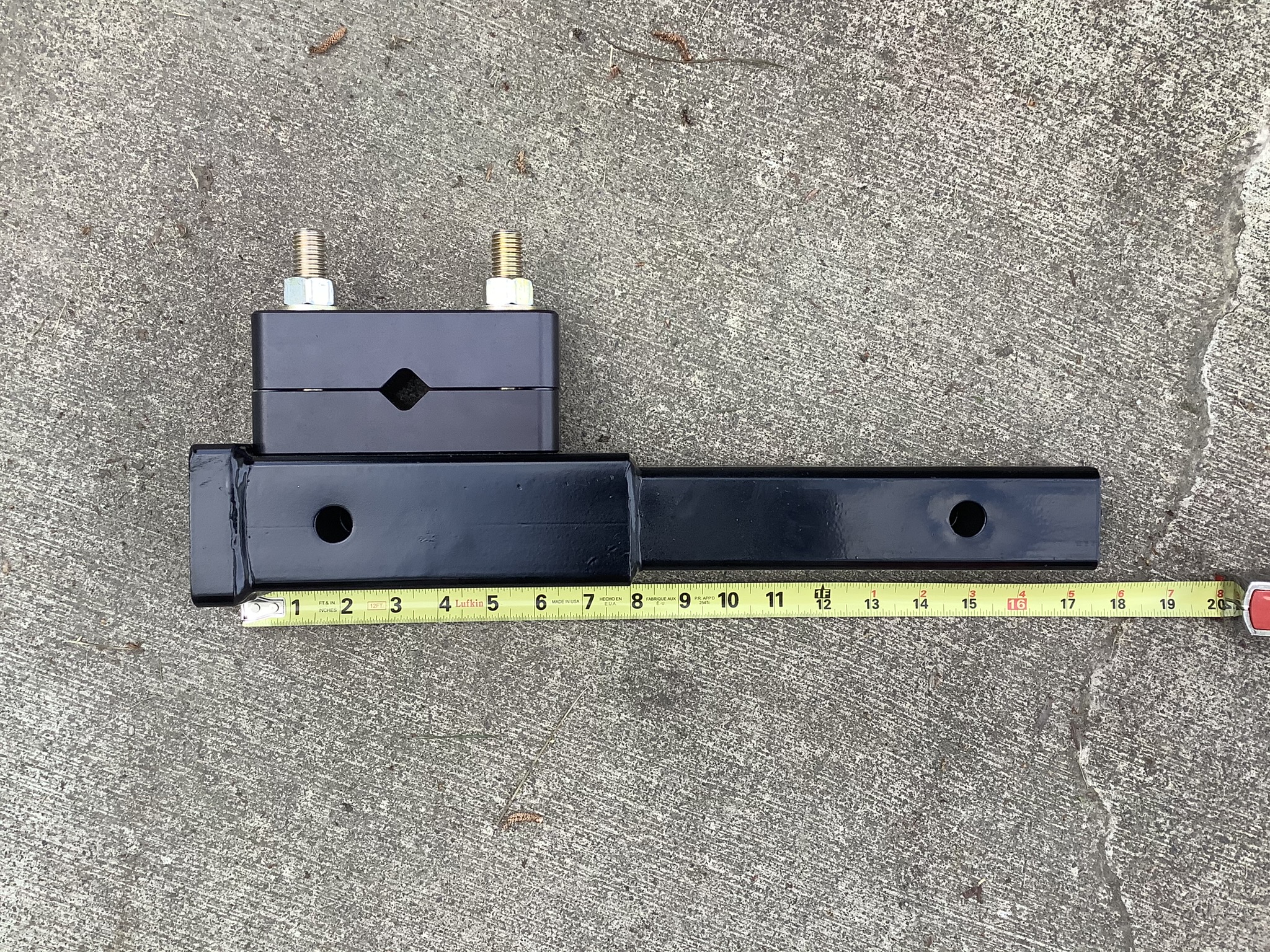

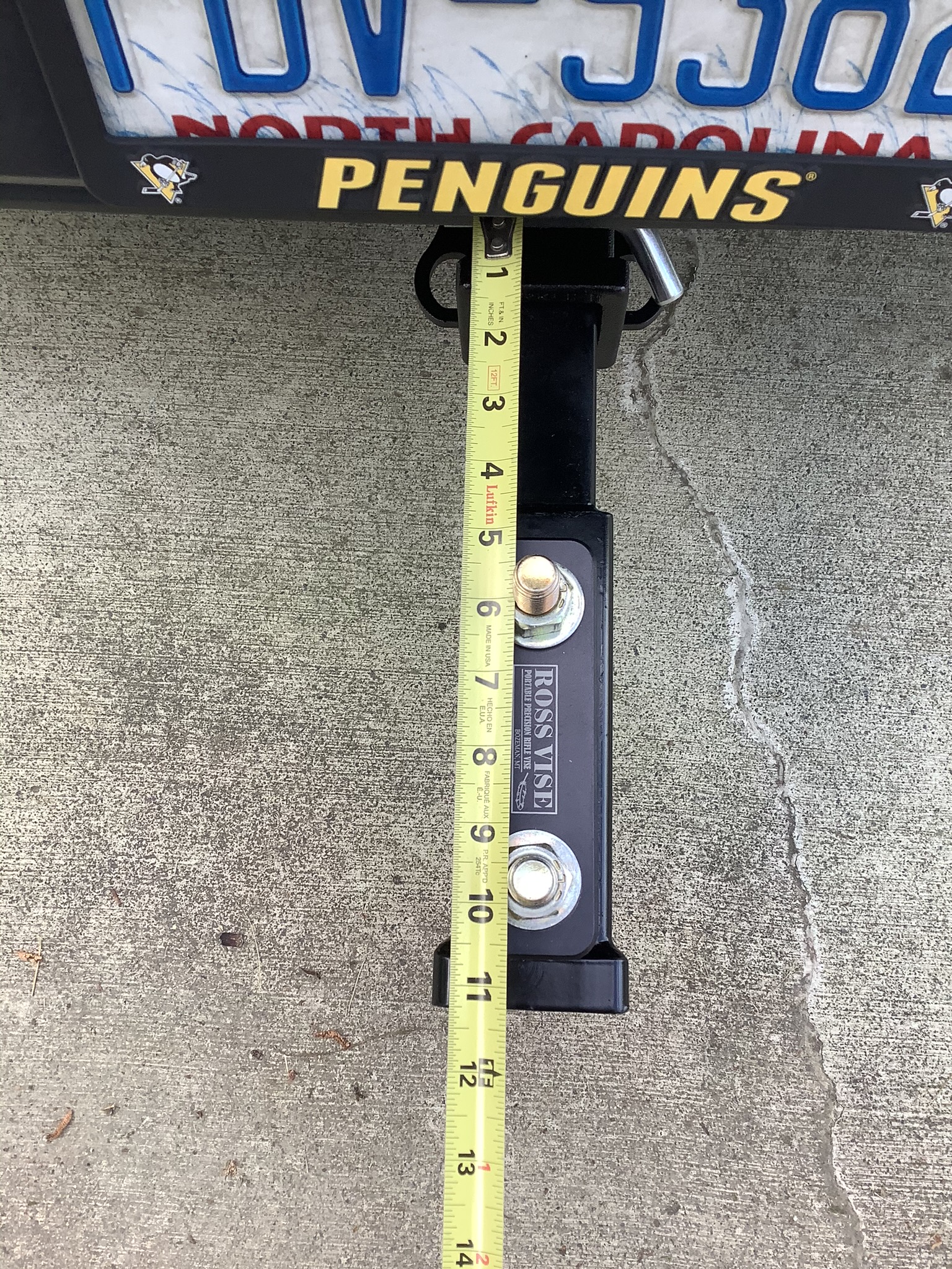

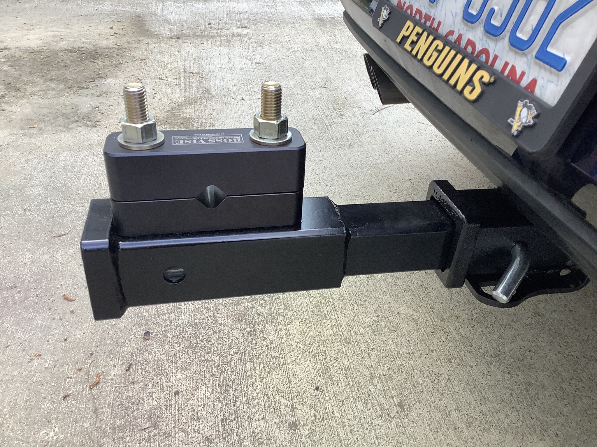

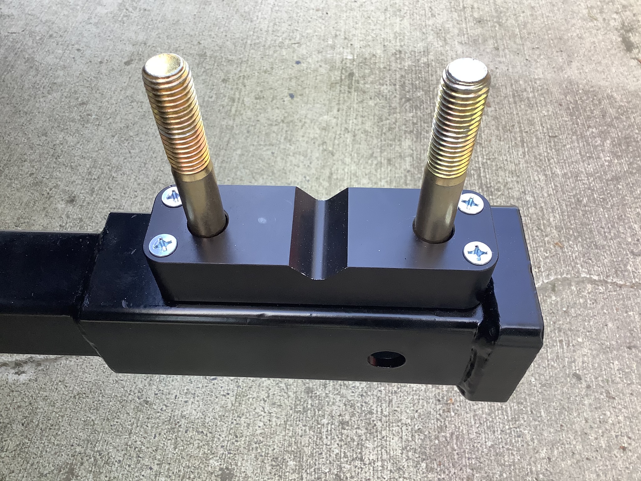

I did the same thing but mounted my Ross Vise to a "2" Hitch Extender" I purchased from Northern Tool for something like $42.00. I tried to follow the videos of using the Ross Vise but I never could get a good torquing experience, it's like I always needed a third hand... Now I have the third hand... LOL The Ross Vise just fits, and I mean just fits on this extension. The bolts that hold the vise to the tube just barely clear the end of the tube inside this tube where the vise is attached. It works dandy, love it.... Makes changing barrels in the field on my Bighorn TL3 action a snap! Should have done this sooner!
All the best,
Jeff
https://www.northerntool.com/shop/tools/product_200612675_200612675

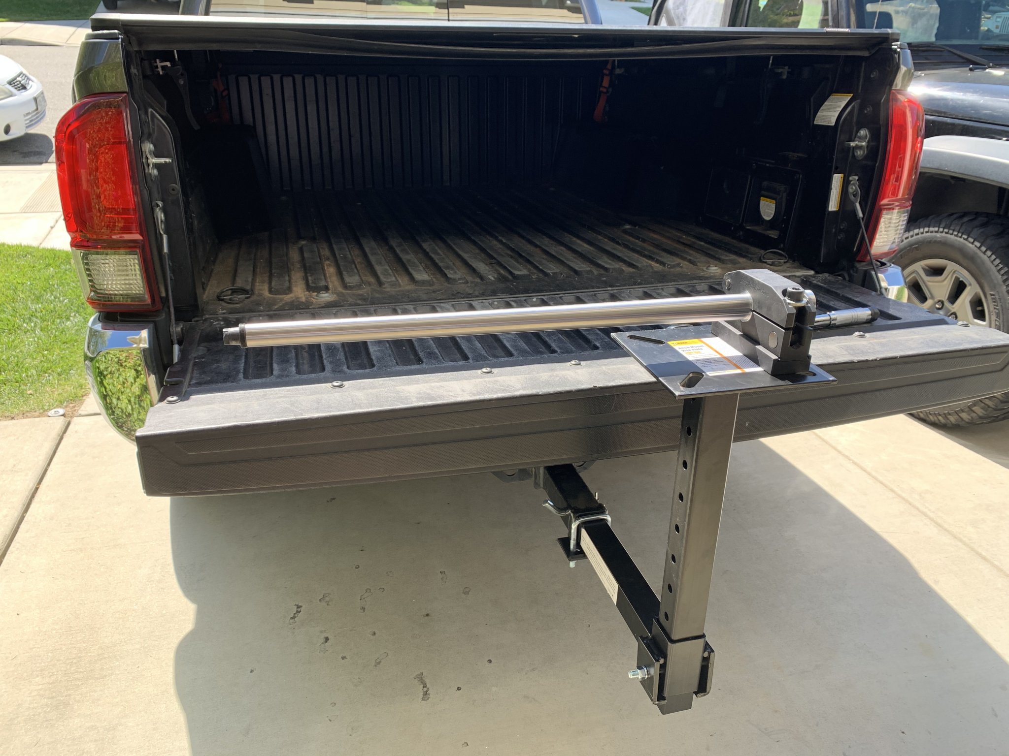

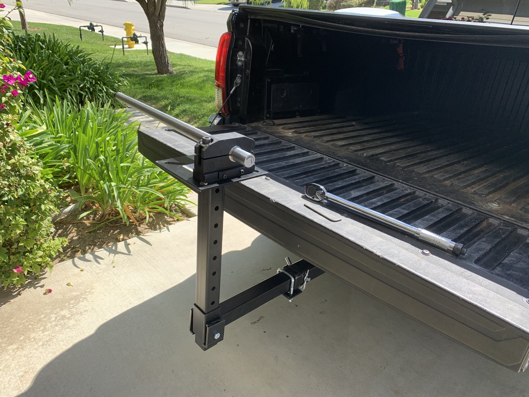

So here is what I ended up with. It’s far enough out with the 12” extension that I can open and close the truck bed to use as a table top. And it’s tall enough that it replicates my work bench. I already had the SAC Modular Barrel Vise and just bought another ARCA plate to mount to the vise table. Move my barrel vise from the bench to the truck and I’m ready to party. Overall pretty happy with it.

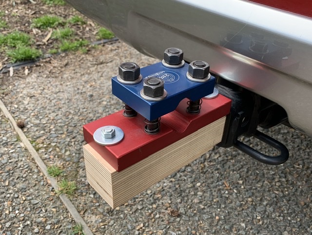

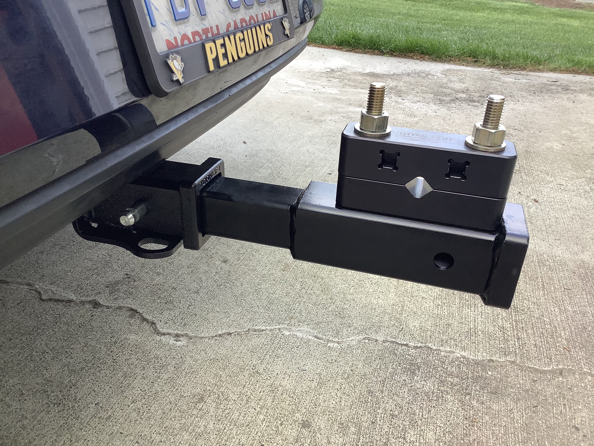

Pretty much inspired by @Greg0326 setup.
The mount from Amazon + SAC Modular Barrel Vise. Excellent platform with zero wiggle. This will make it so easy to switch calibers at the range.
The socket through the base is 1.5x1.5 in x 13 coarse thread, grade 8 washer and wingnut from the local hardware store.
