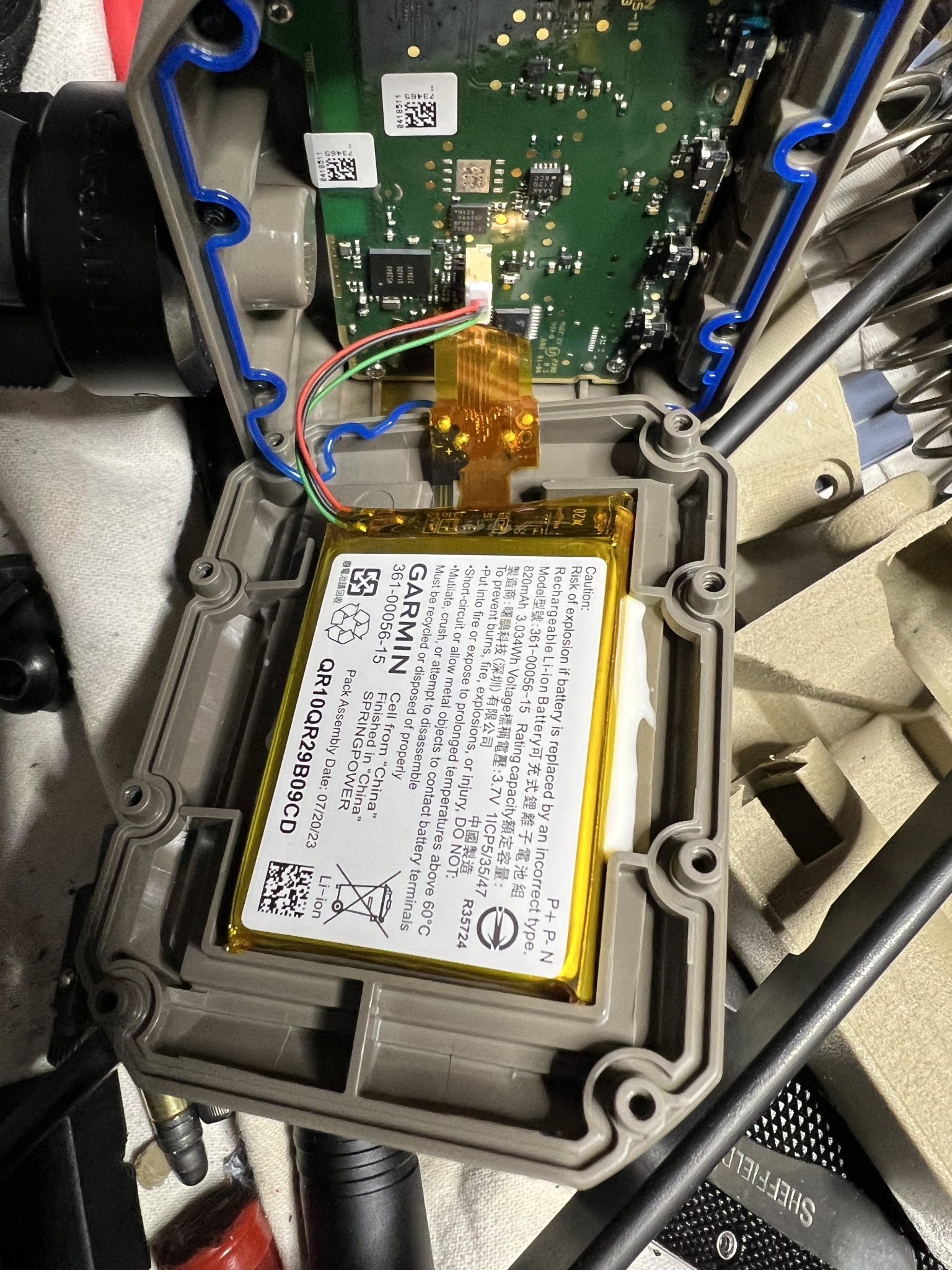

The battery is a very common one that comes complete with pig tail and connector. There has been a post here already where a member opened his unit and the battery is very easily replaceable by the end user.

The battery in the xero is a common Garmin part number used in multiple devices and is easily obtainable and replaceable by the end user (if Garmin won't swap it for a reasonable charge.)

If you look at the picture there's a BMS circuit board attached to the pack, the replacement battery will need that.
You can't just toss in a 1s 820-ish mah capacity pack of similar dimensions and have it work (unless you transfer the BMS from the old dead pack, and depending on how Garmin has it programmed sometimes the BMS will throw a permanently disabled flag if the pack voltage drops below a certain lower threshold, which then requires software to reset and re-enable the BMS...)
I'd either source a genuine Garmin pack or a third party pack that replaces the exact part number as it should have a properly configured BMS board inside the shrink wrap. The good thing is it seems Garmin uses that exact pack part number for multiple devices so it's easy to source one.

Cell from “china”
Finished in “china”
Is this some kind of passive aggressive way the Taiwanese are saying it’s actually made there?

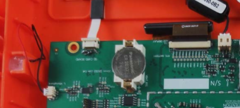

Has anyone needed to replace the Coin Battery in the LR?
I had to replace the 2032 battery in my lab radar last year when the clock and calendar stopped retaining the time and date after power off. Piece of cake, and put a dab of hot glue on it to help retain it just like it was from the factory. I bought my labradar right after they first went on sale (2016 IIRC) so it lasted quite a while.
