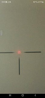

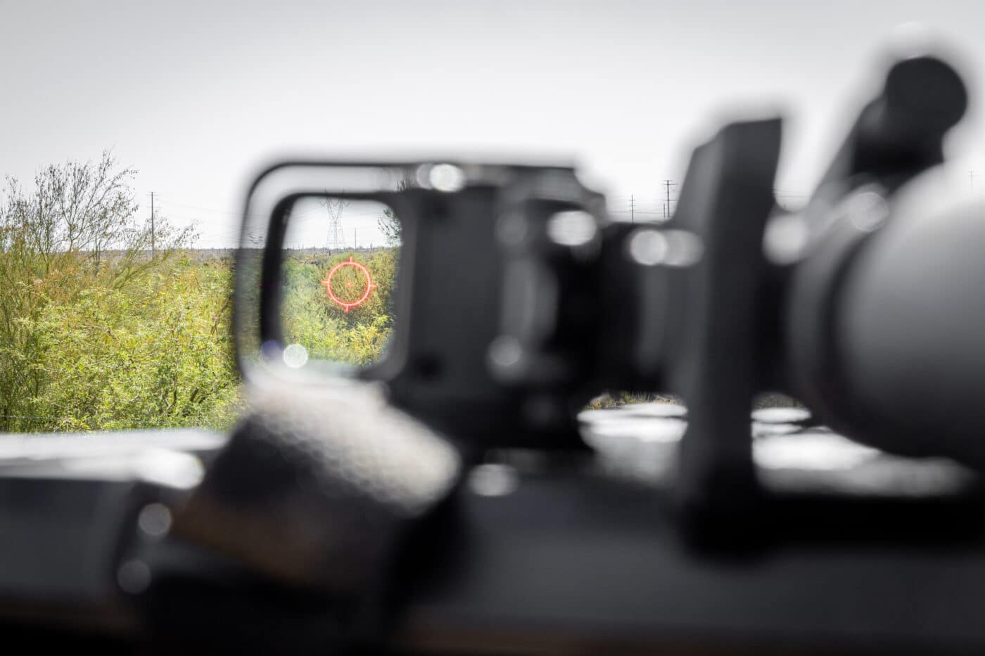

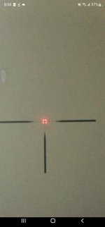

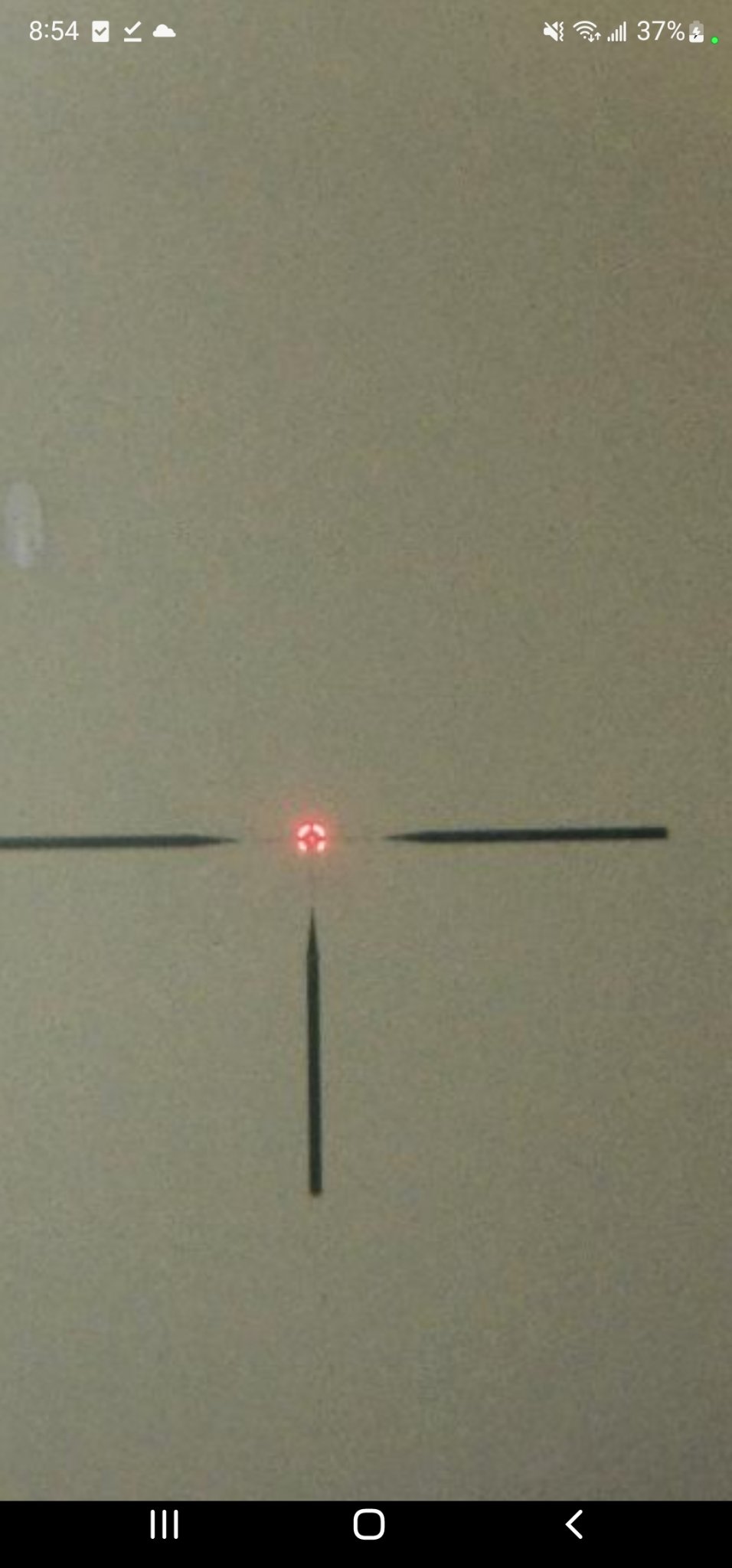

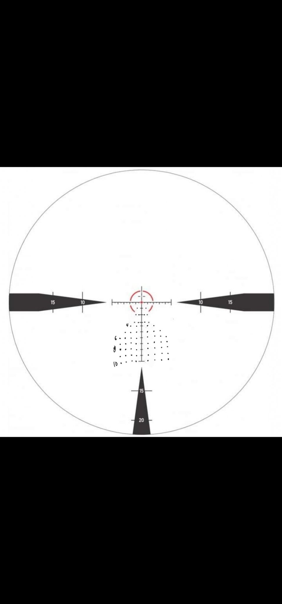

I've been back and forth with nightforce for some time now and have suggested they reduce the thickness of the segmented circle lines in half (.25mil to .1mil). No changes to the actual dimensions-still 4mil in diameter. Doing so would clean up the image with illum and create a cleaner circle dot and less of a blob like in the picture. The short version is if we can get enough support this is an easy change and would have a good chance of becoming reality. If you're interested leave a comment. This is going to be cross posted on the hide as well. Thank you for your time and support
Edit***the second illum pic is the suggested change. It was edited on my phone so it may not be the clearest thing

With this style illum the thickness of the line doesn't have any carryover to the actual brightness of the reticle. Remember the original reticle (fc-dm) had even thicker stadia and was the same exact brightness. Same with the nx8.
Edit***
You may have a larger reflective surface area throwing the sun into your eyeballs but the thinner lines will be just as "bright"-only thinner
Fwiw I'm not the only person who's discussed this with them

You mean when the fc-dm came out and everybody bugged them about the center reticle obscuring too much of the target under magnification so they changed it? Just to be clear, you're saying voicing your opinion isn't valid and will never have any impact? Is that really your stance? If you aren't being sarcastic then please disregard or dm me and I'll edit this.
My stance is that the improvement from FC-DM to FC-DMX was very substantial and tons of people asked for it. The difference between FC-DMX and this hypothetical reticle you desire is, at least IMO, slight and I go as far as saying of questionable value. For what it's worth, I hate that second illumination photo. I am able to shoot good groups with the FC-DMX and don't see the need for finer stadia.

I have the FC-DMx reticle and I like it just the way it is. I would like this reticle less if they made these changes.
Reactions: 1911hombre
@Hoody2shoes i never considered reducing the thickness of the ring as I have liked the reticle on all magnifications.
But, this evening I took it out and looked around with it with your suggestions in mind, and can see how a thinner ring at low power could possibly be an improvement, if I’m trying to hold more precise at further distances.
But from about 3x magnification and up the thickness doesn’t pose a problem to me.
Reducing the reticle brightness also helps, but then it is too dim for other settings.
My Verdict; I wouldn’t want it thicker, it’s ok as it is, but thinner might help in some scenarios.

That was the idea. It changes zero usability under magnification but helps the 1x use. A small positive with no negative

But its not harder to see. I give you a thinner reticle thats just as easy to see.
I think a 65 MOA cicle and a 1 MOA dot (going from memory, I'm not looking it up) is a bit of a false equivalency. The center dot on the FC-DMx is 0.2 MRAD. That's significantly smaller than 1 MOA, which is already pretty dang small. It needs that ring to make it visible, and on max brightness it is going to be visible even if it is half the thickness of the already tiny dot. But you're not always at max brightness. You may find yourself transitioning between dark and bright areas, or you may have a battery die, or all sorts of other considerations... in those cases, the reticle would be even harder to see than it already is, and I see that as a down-side.

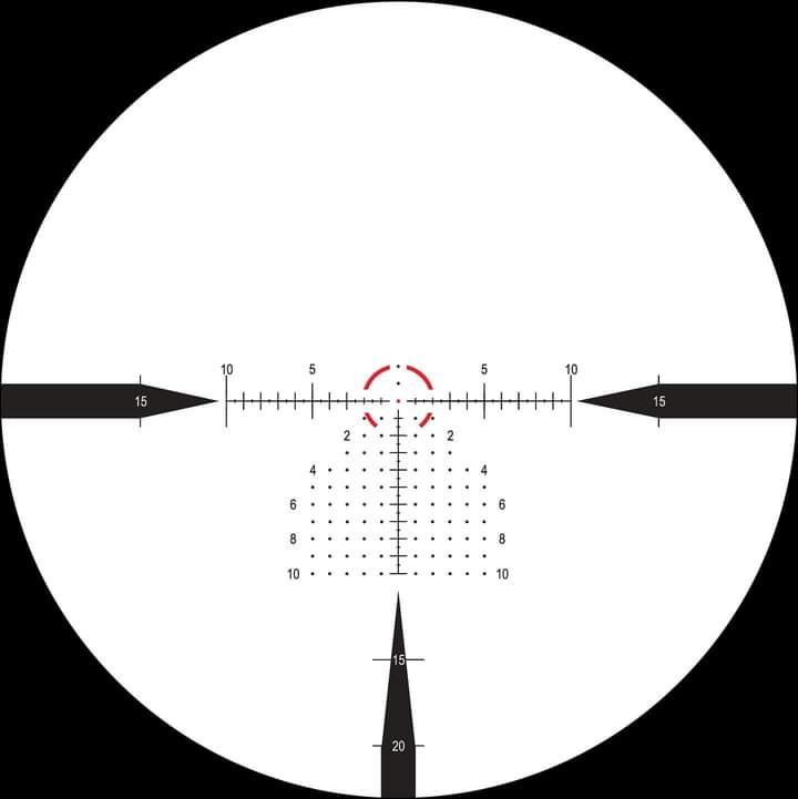

What are the subtensions on that reticle? Are you sure it's thinner than the FC-DMx? I think you might be wrong about that.

I understand the brightness thing-speaking strictly from experience I've never needed my atacr past about 7/10 and that's including desert shooting and working force on force in training environments. After speaking with nightforce thinning them out would not affect the actual light output. The argument could be made for perceived brightness but they noted they could actually ADD to the brightness if needed. I'm not sure I've ever heard of anybody using the center at 1x without illum anyway-its already too small and most people just bracket with the posts.

I'm not talking precision as in distance-I'm talking precision as in placing a shot into the t-box at close ranges or in between armor. Not having a massive blob covering it helps

I'm pretty sure that's not correct. Anyway, the amount of area being illuminated matters. The stars are brighter than the moon. If you cut down the amount of area being illuminated, it will be perceivably (and that's all that matters) dimmer.

So the segmented circle on the tremor 8 is thinner and equally as bright...
Not a reticle I'm very familiar with. What are the subtensions?
They aren't published just like the fc-dmx isn't. I have time behind it and own an fc-dmx. I'm not sure how much thinner but it IS thinner and cleaner while being just as blindly bright if you choose it to be. I'm not trying to be argumentative-I've been talking about this for a year now and have close to 100 people that have agreed it'd be an improvement with you being 1 of 2 in disagreement. I'm truly trying to understand what your eyes see vs mine.
From the few pictures I've seen, the center dot looks a lot bolder on the Tremor 8 too. I don't hate it. But I still prefer the FC-DMx
Reactions: Hoody2shoes
It is. And I don't want to change the center dot. The tremor 8 is .35mrads. I would reduce the thickness on the rings of the fc-dmx while keeping a .2mrad center dot
***something to note on the tremor8***
The .35mrad center ISN'T THE ZEROED PORTION OF THE RETICLE. I'm not going to tackle that here but there's a reason for the setup though I would have preferred a .2mrad center still
As Charlie Kirk says, we have clarity but not agreement. I wouldn't want to trim down one without thickening the other, and I like the fine center dot.
Edit***

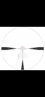

I have had to brush up on my knowledge of diffractive reticle technology and still trying to understand the relationship between the diffractive angle etchings and the spacing and the wavelength of light but from what I understand so far, you are correct, the brightness of the illumination should not diminish with a thinner horseshoe/quad, this is a great learning opportunity for me as I tend to geek out on some of this stuff.
I've used the tremor 8 before it was all over the webz... I've held onto this one for awhile
Eliminate the bdc from the tremor 8 and change to standard mrad spacing.
Keep the same 100y/m zero at the 1 mil hold under dot as the tremor 8
From mils 1-3 a simplified tree mean to put rounds on target at distances carbines excel at.
Mil 1 has 1 wind holds
2 & 3 have two. The wind holds are staggered a bit
Mils 4-10 have a full grid
Mils 1-3 have no half mil marks.
Basically donut of death and Mils 1-3 for fast shooting and for a universal bdc of sorts. 4-10 for slow shooting.
