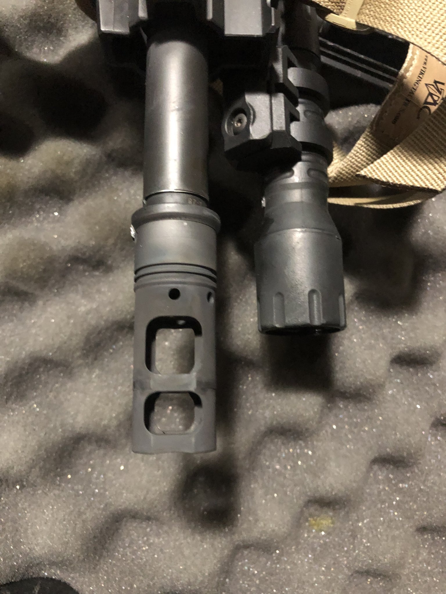

I just recently got a surefire 300 sps. I have noticed carbon build up on my barrels of behind the suppressor. I am just curious if this is normal?

What do you mean by "carbon build up..."? Suppressors do add some back pressure. As a result, you will typically get some carbon build up on the muzzle device. That is normal. Is that what you are experiencing?

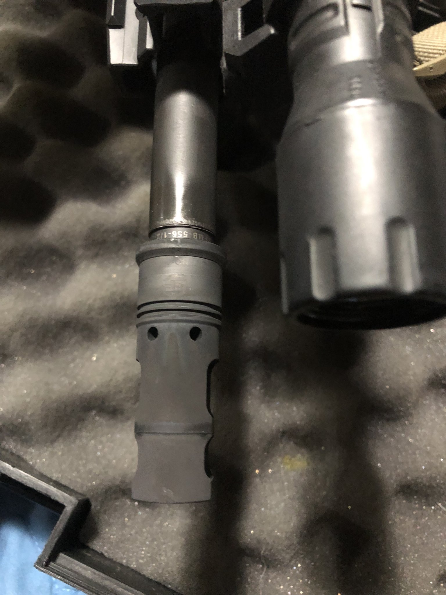

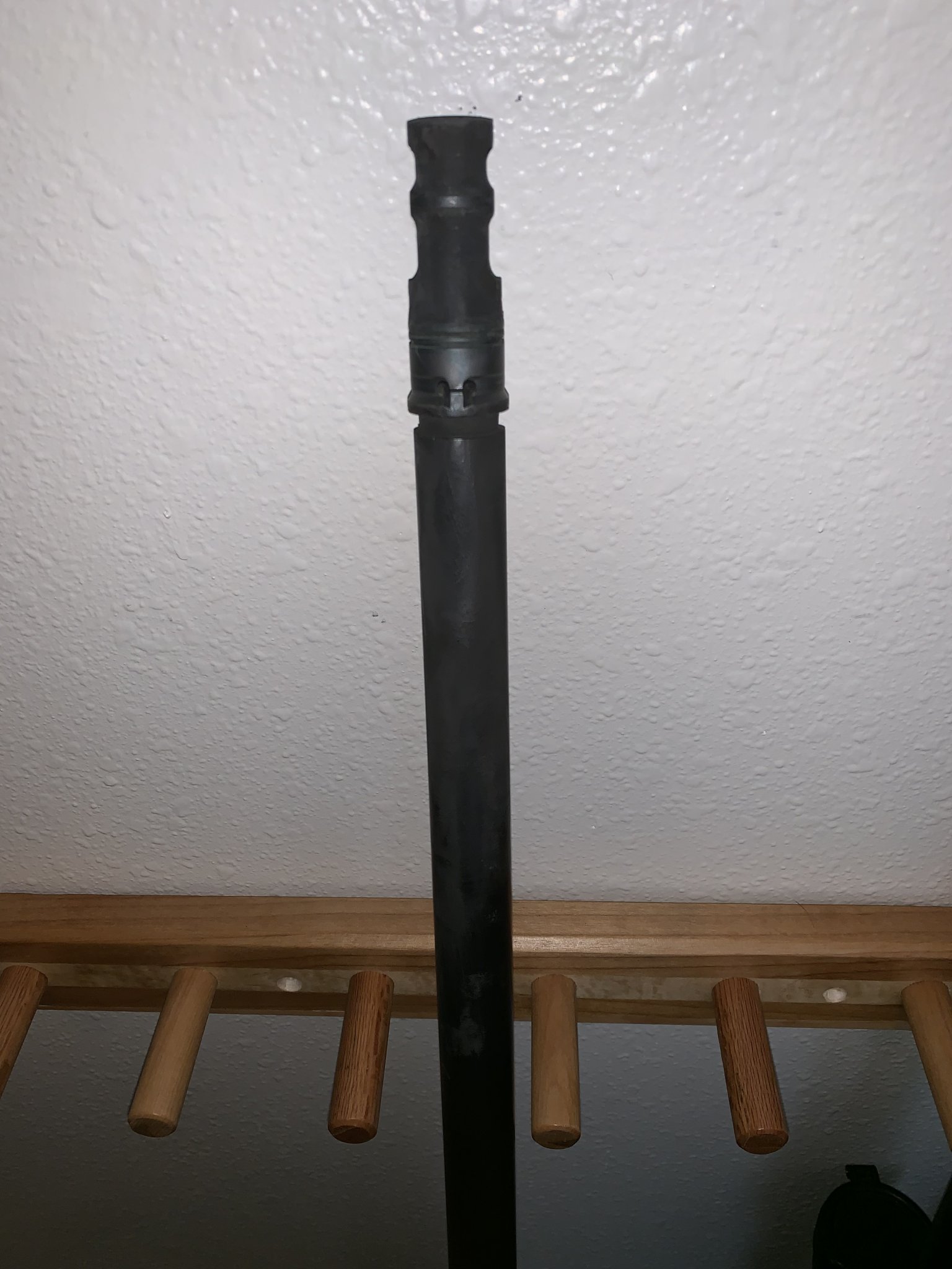

Here are some pictures sorry for the delayed response things have been a bit crazy.

Wow, that looks like a lot of gas leaking from the back of the suppressor around the mount. I have not used that particular model Surefire but have shot quite a few other Surefire suppressors and never experienced that much gas leaking.
I would try talking with other users of that model suppressor and maybe even contact Surefire about it. That honestly does not look right to me. I'd even question if it was the correct mount.

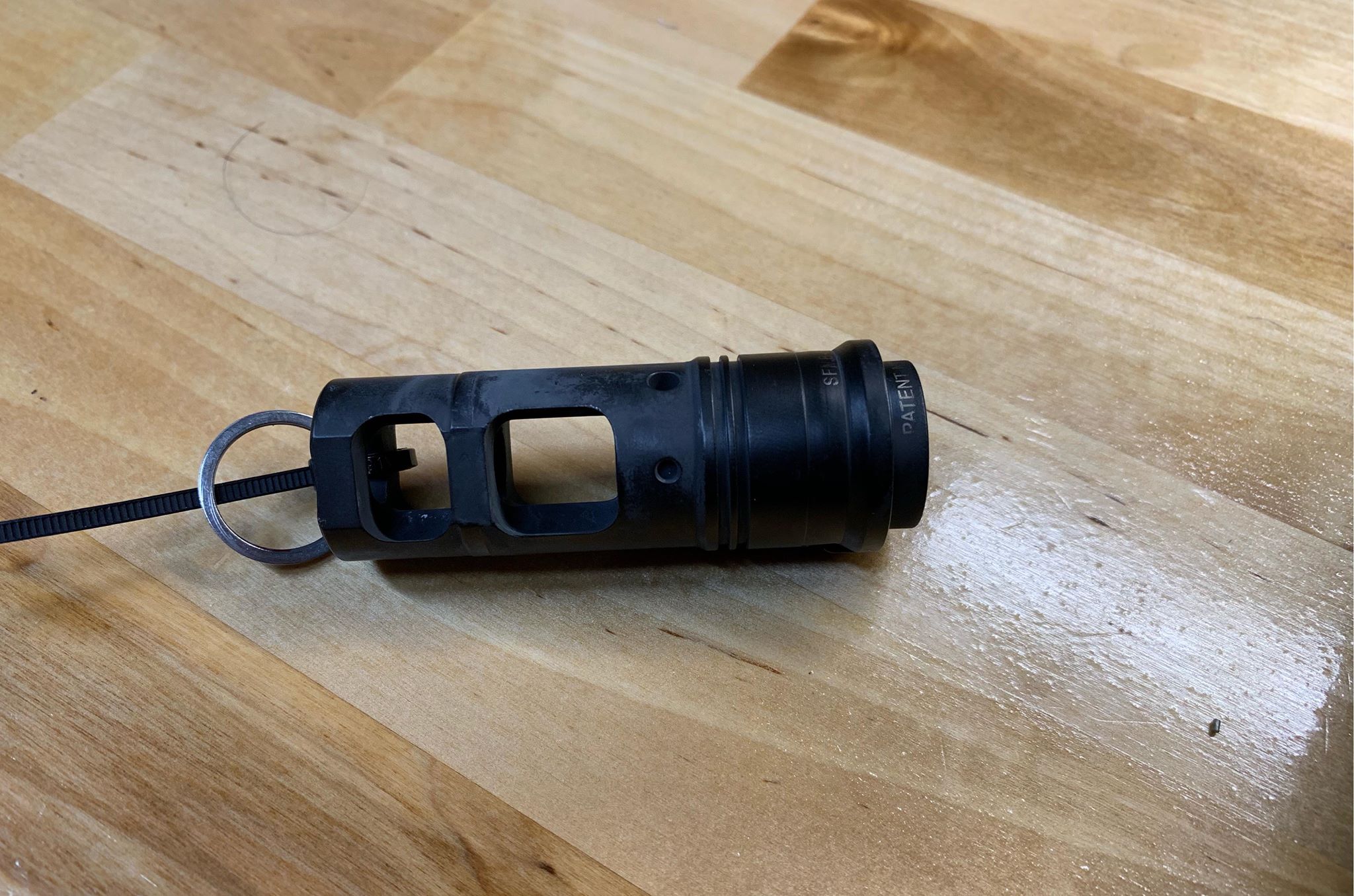

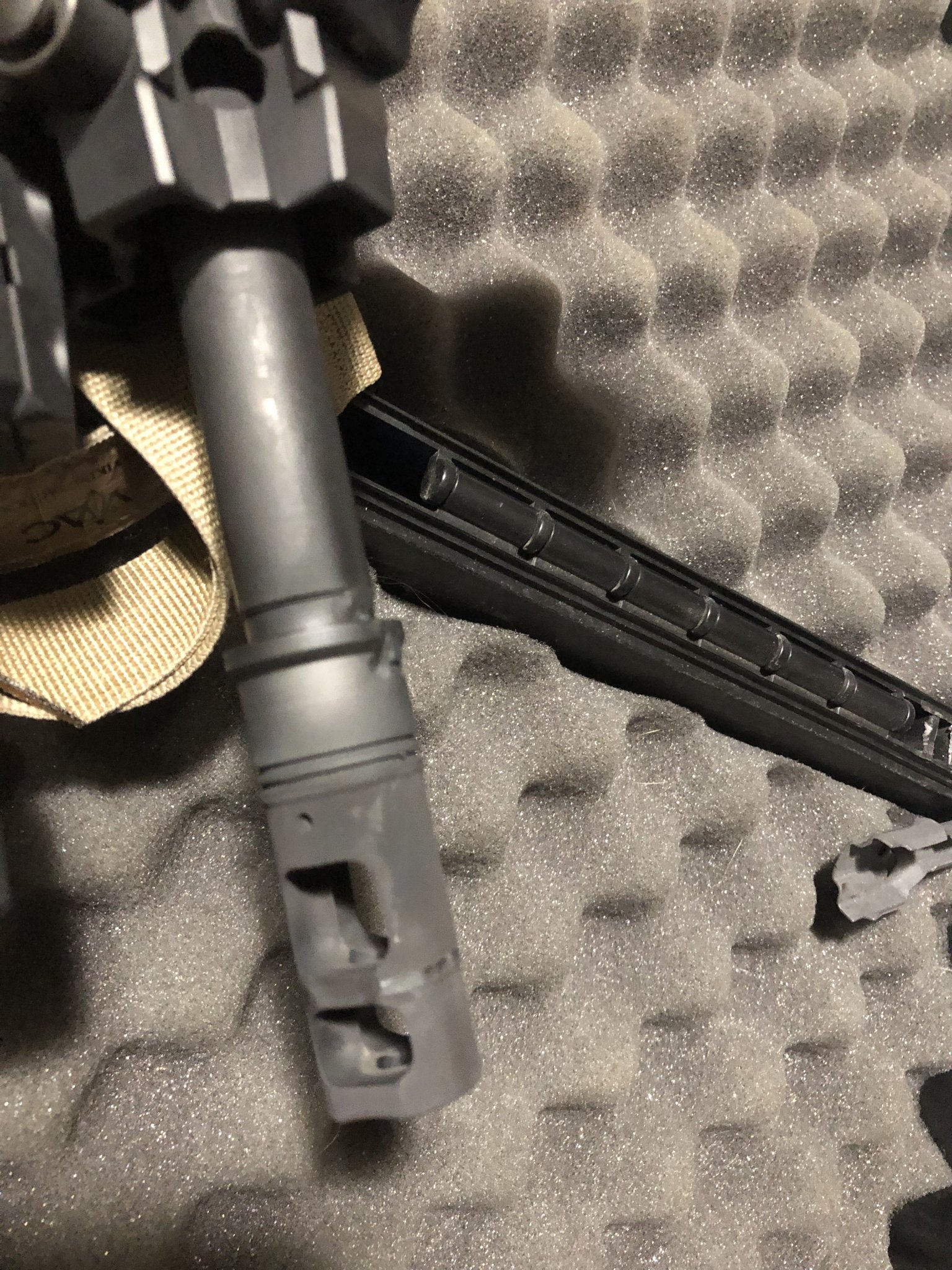

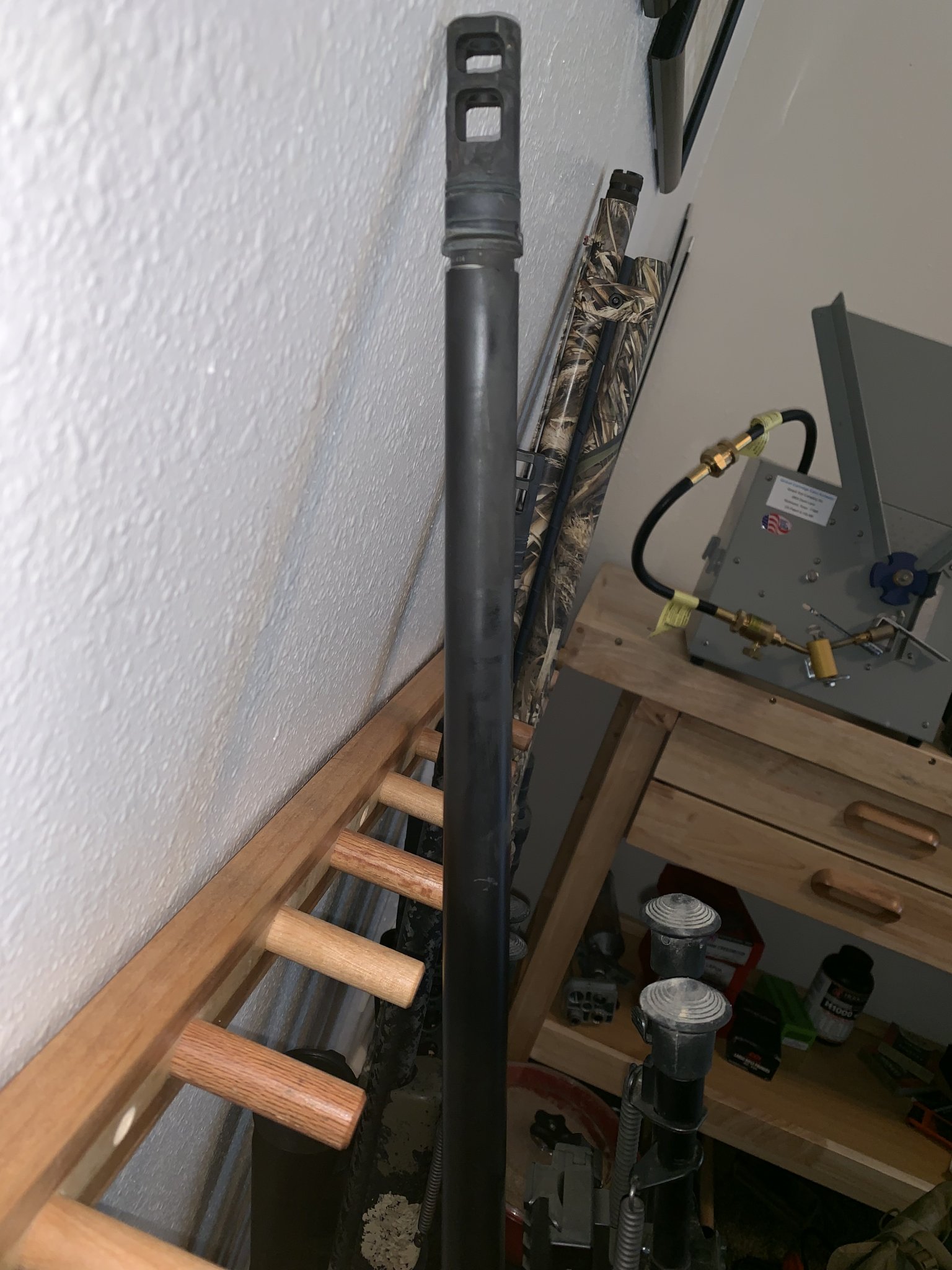

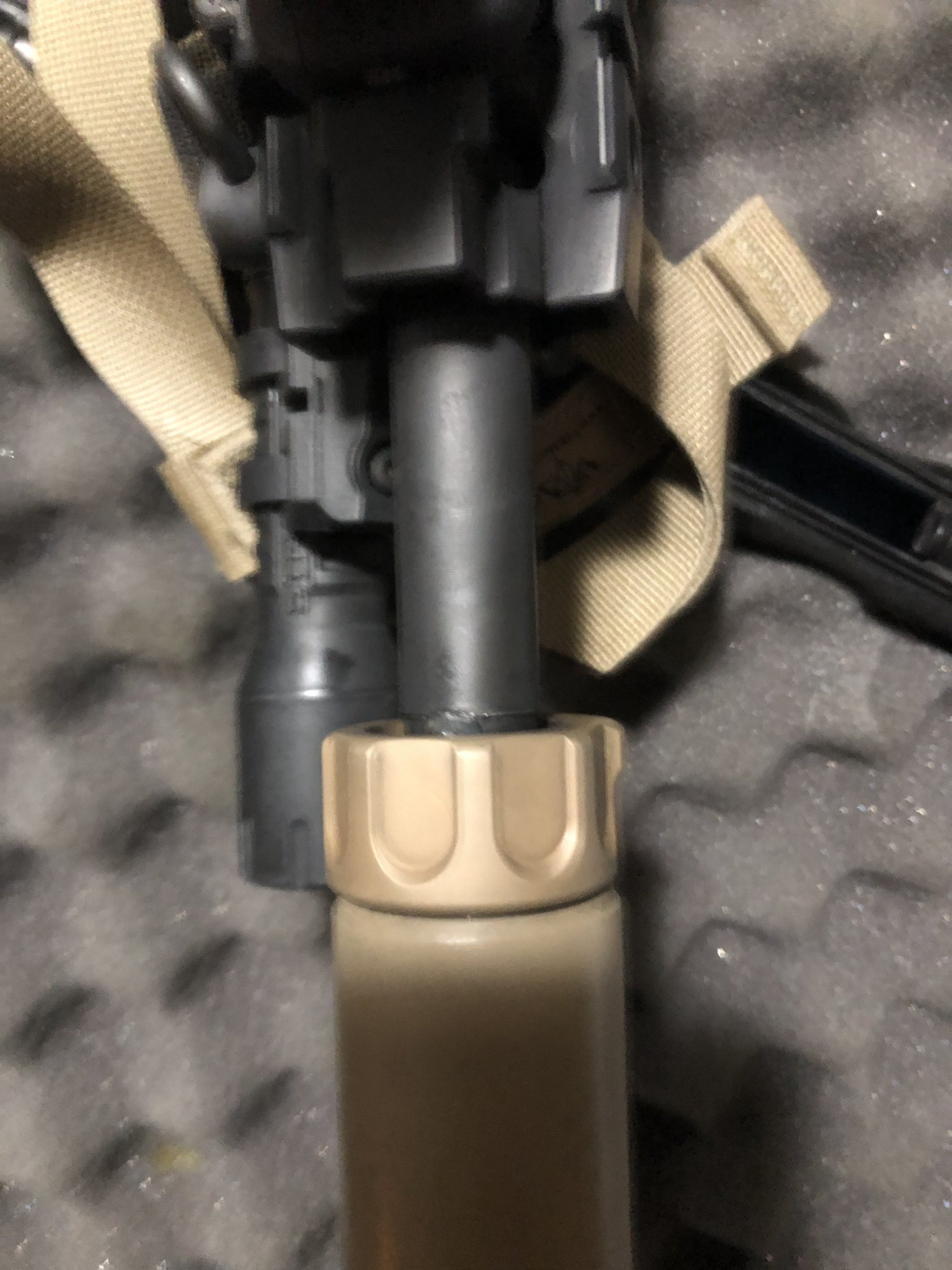

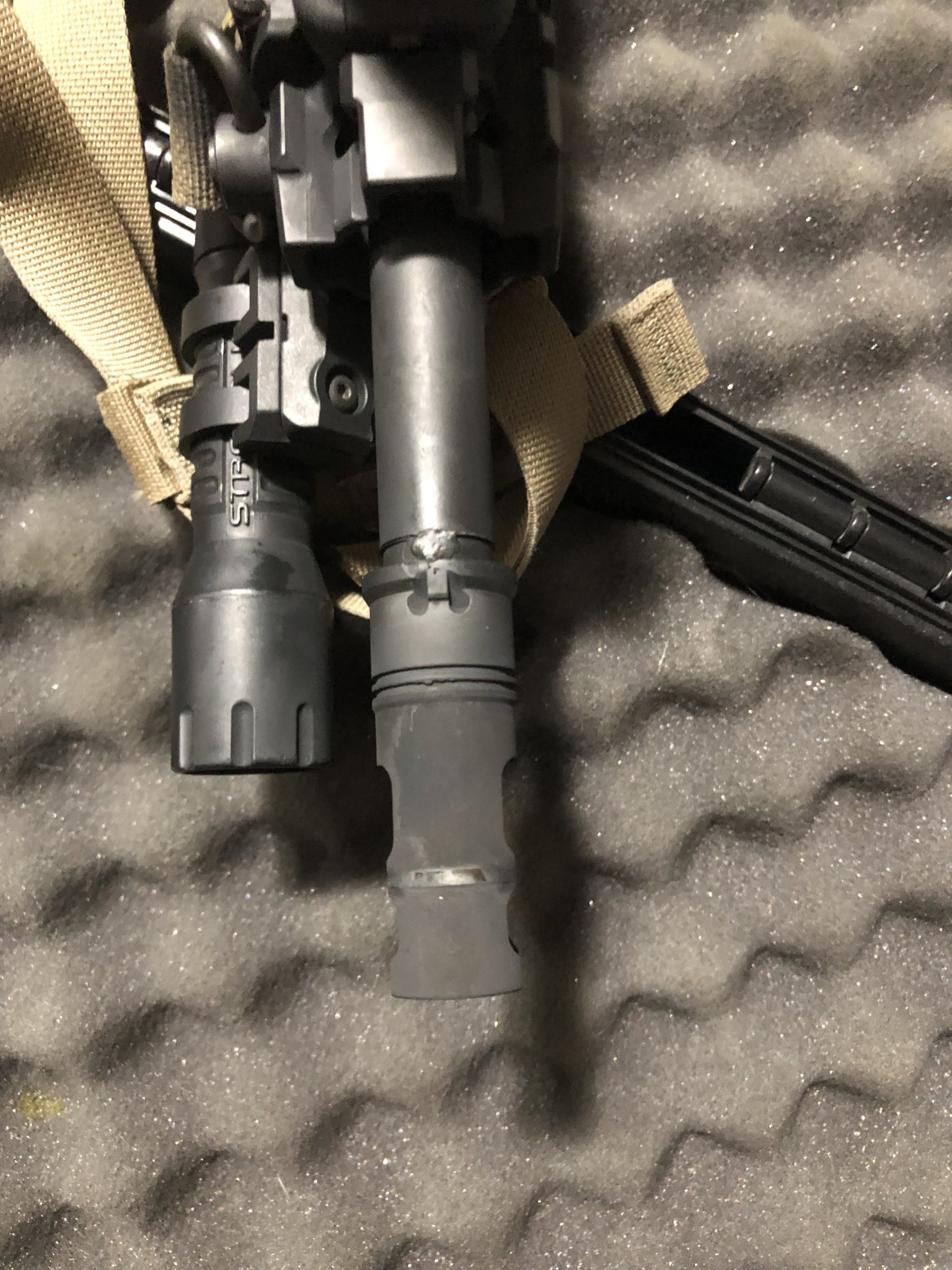

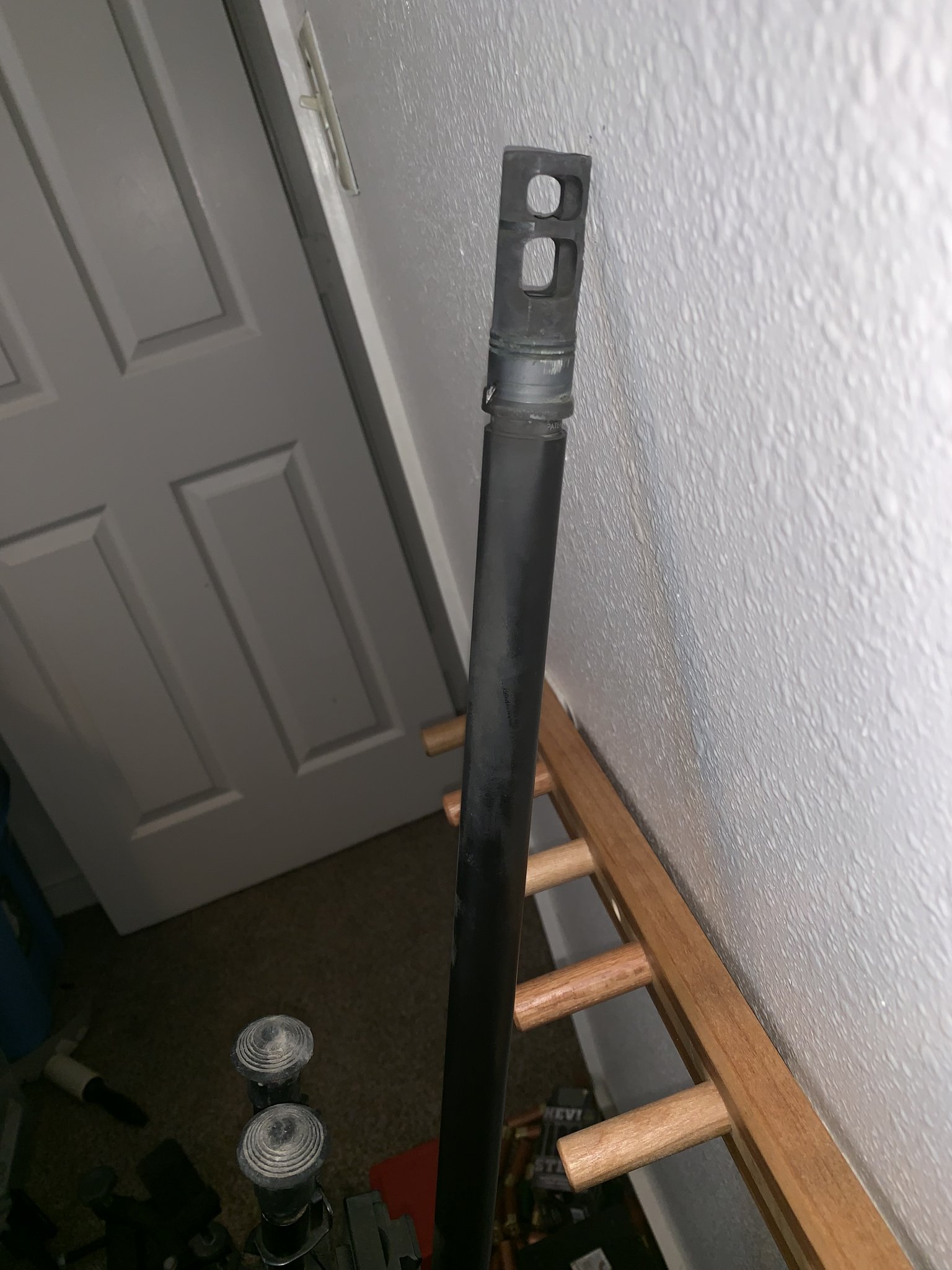

I’ll post some pics of my M4 below. I’ve had zero issues w/ mine in the last year. I cleaned this gun probably 120 or so rounds before taking these pics.
*FWIW, this is the 7.62 RC2 version.

A tiny leak, a tiny bit of carbon outside the can and behind the brake is normal. A foot long streak of the shit isn't.

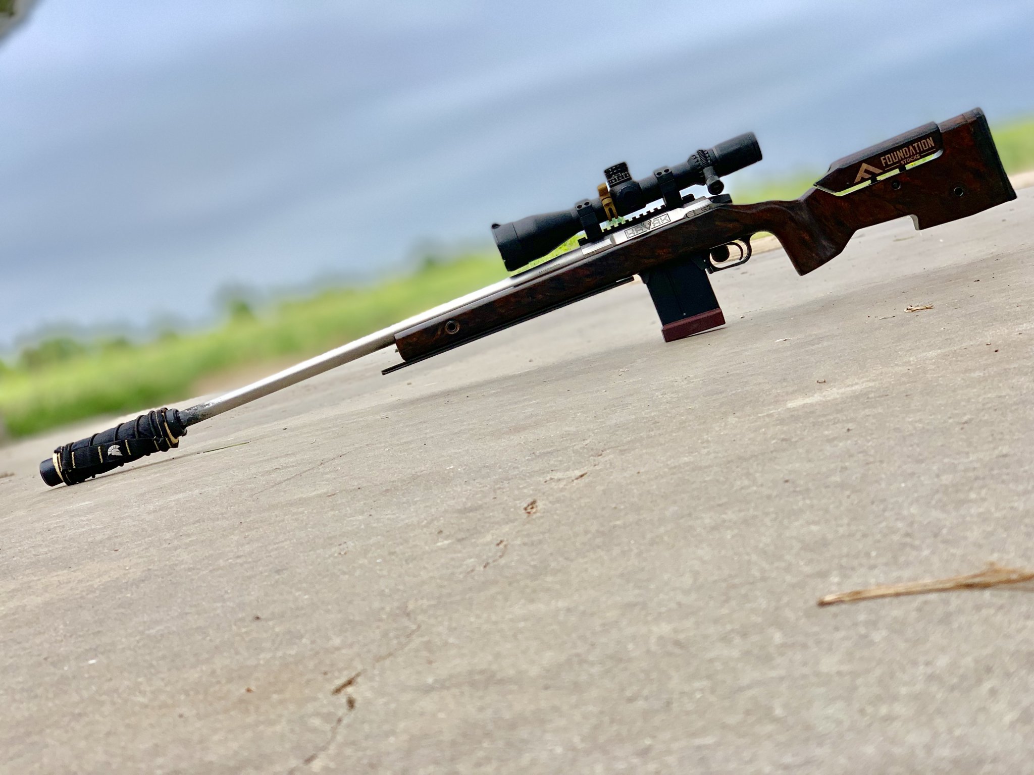

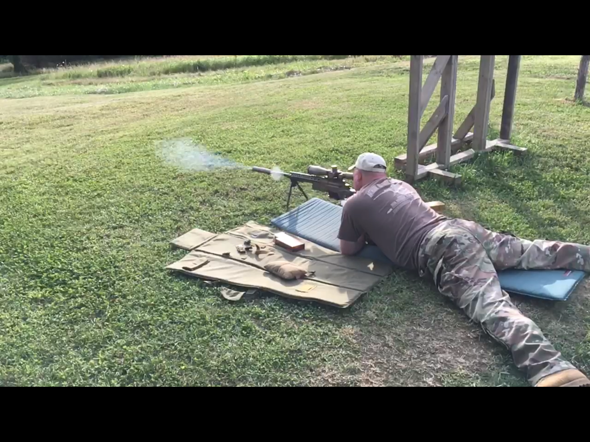

I mostly use my 20” .308 barrel on my AXMC. I shoot 100% suppressed with a Surefire SOCOM 762 RC2. It has always coated the barrel and first inch or two of the forend tube with carbon. This screen shot and video clip illustrates the leakage. It wasn’t noticeable on video until I shot this session with my .300WM barrel. I contacted Surefire, and was also told this was normal.
This is a great video and very accurately depicts the issue. I have the same rifle AI AXMC in short action, with a 6.5 CM barrel with the SOCOM 7.62 RC2. I also get a coating of residue at the 6 o’clock indexing notch stretching back a few inches on the outside of the barrel. No residue at 12 o’clock but only at the 6 position. Thanks for making the video and posting the pic.
