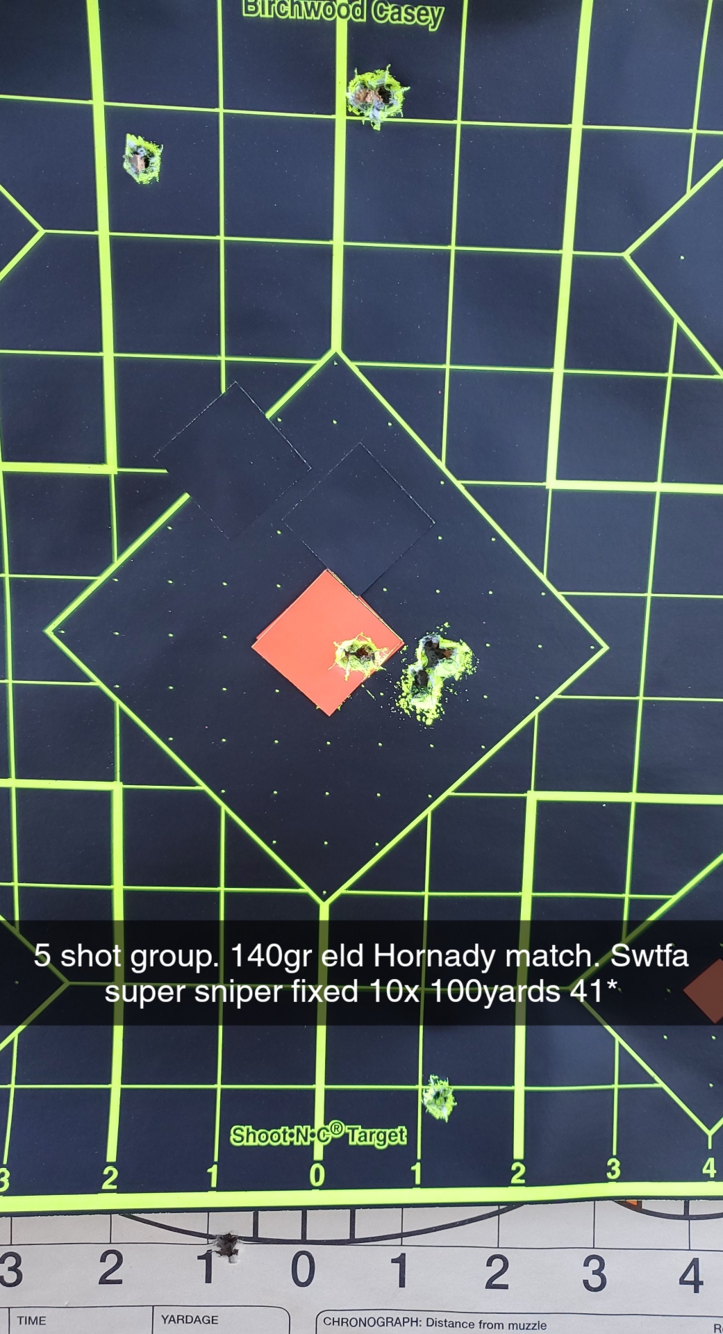

I finally have my rifle all setup. Tikka ctr 6.5 creedmoor in a krg xray chassis and have my Athlon Optics Cronus -4.5x29x56mm 34mm tube scope mounted on it. Its a very impressive scope with clear glass and great turrets. However i noticed my groups are horrible at 100 yards and I keep having these horizontal patterns showing up. After shooting a couple boxes through the gun, check all the mounting hardware, I decided to swap out scopes.
I switched scopes to my old trusty fixed 10x SWFA scope. After sighting it in, I shot some groups with it at 100 yards using the same ammo. 140gr ELD Hornadys. The groups were much better and I did not have the weird horizontal shift going on.
So what do you think the issue is? I feel like with the Cronus I cannot get the crosshairs and the image to every both be focused. Its either you get one or the other, and then after a few shots it feels like its all out of whack again. I've also noticed when i have everything setup as clear as i can, when i bob my head around on the scope i can see the crosshairs move to and I can't get them to stop moving. So I'm thinking maybe something is up with the parrallax or something internally with the scope?
What do you all think? I've called and left a message with Athlon but they haven't called me back yet about whether they will take a look at, or fix the scope. I hope it can be fixed cause it seems like a great scope with the features, for the money.
Thanks!
I've also attached pics of the groups.

Ehh, send it back, they will get you taken care of.
